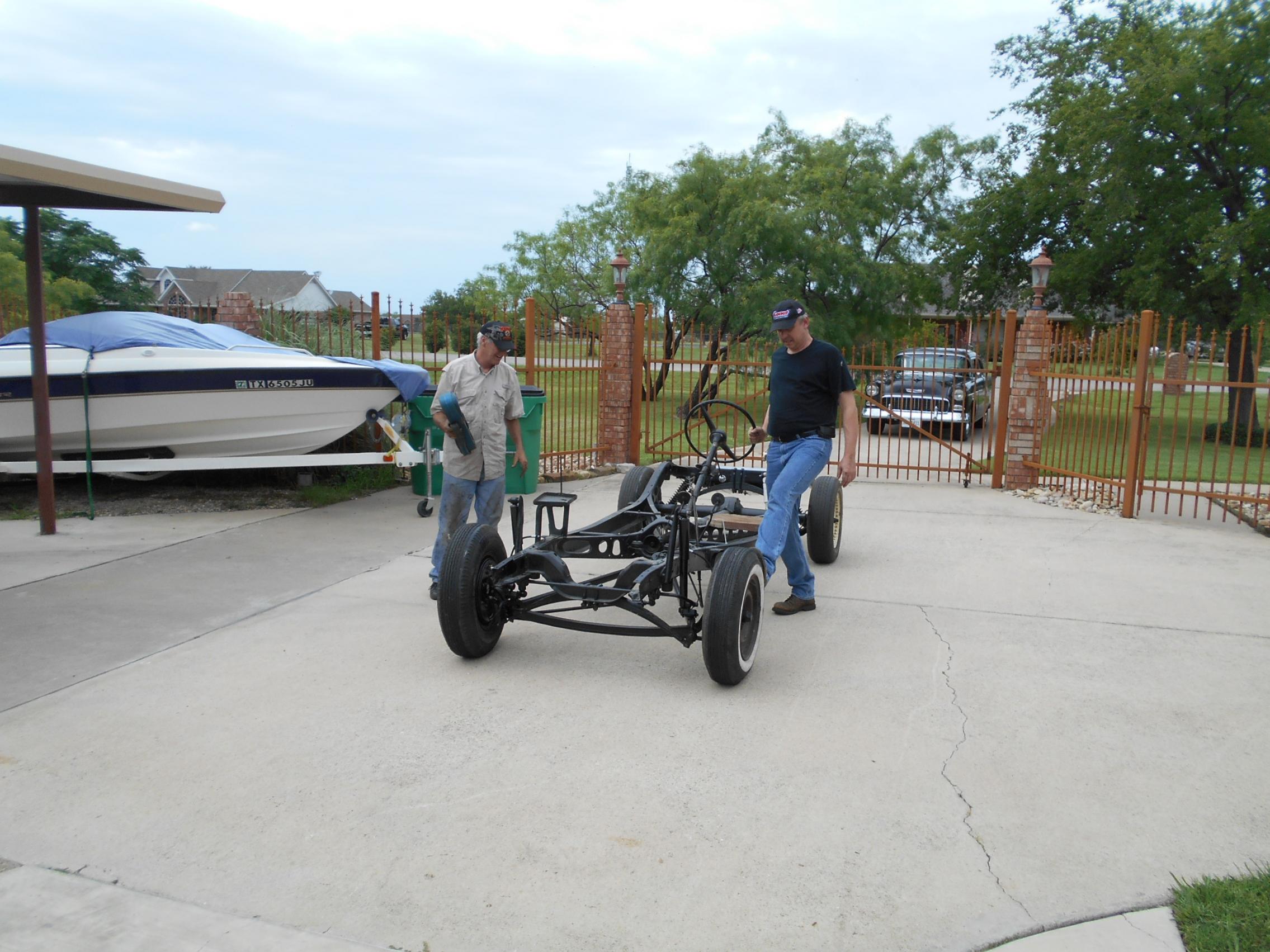

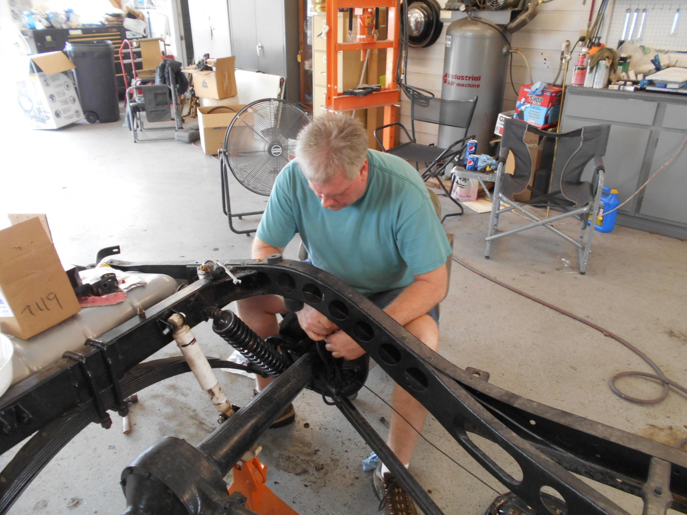

    Norm is a crew chief at American Airlines. He attracts a lot of the car guys to himself and his shop is where they sometimes "hang". This is Mike helping out with the brakes.

  6. jivin jer
    Joined: Sep 14, 2008
    Posts: 3,535
    jivin jer
    This is John (norm's pal) and Norm. John just towed Norm back up the street behind his '55.

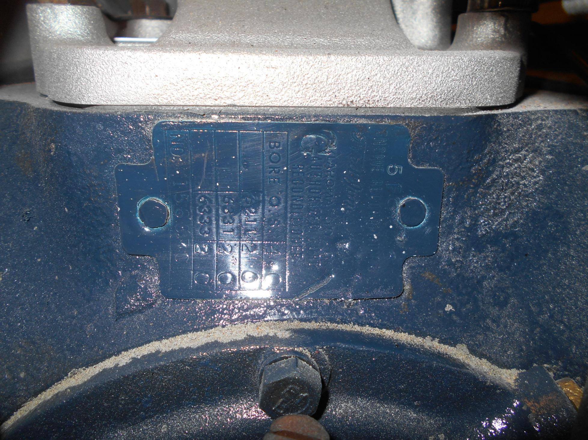

  17. jivin jer
    Posts: 3,535
    jivin jer
    At some time in it's life this 59A was a factory rebuild.

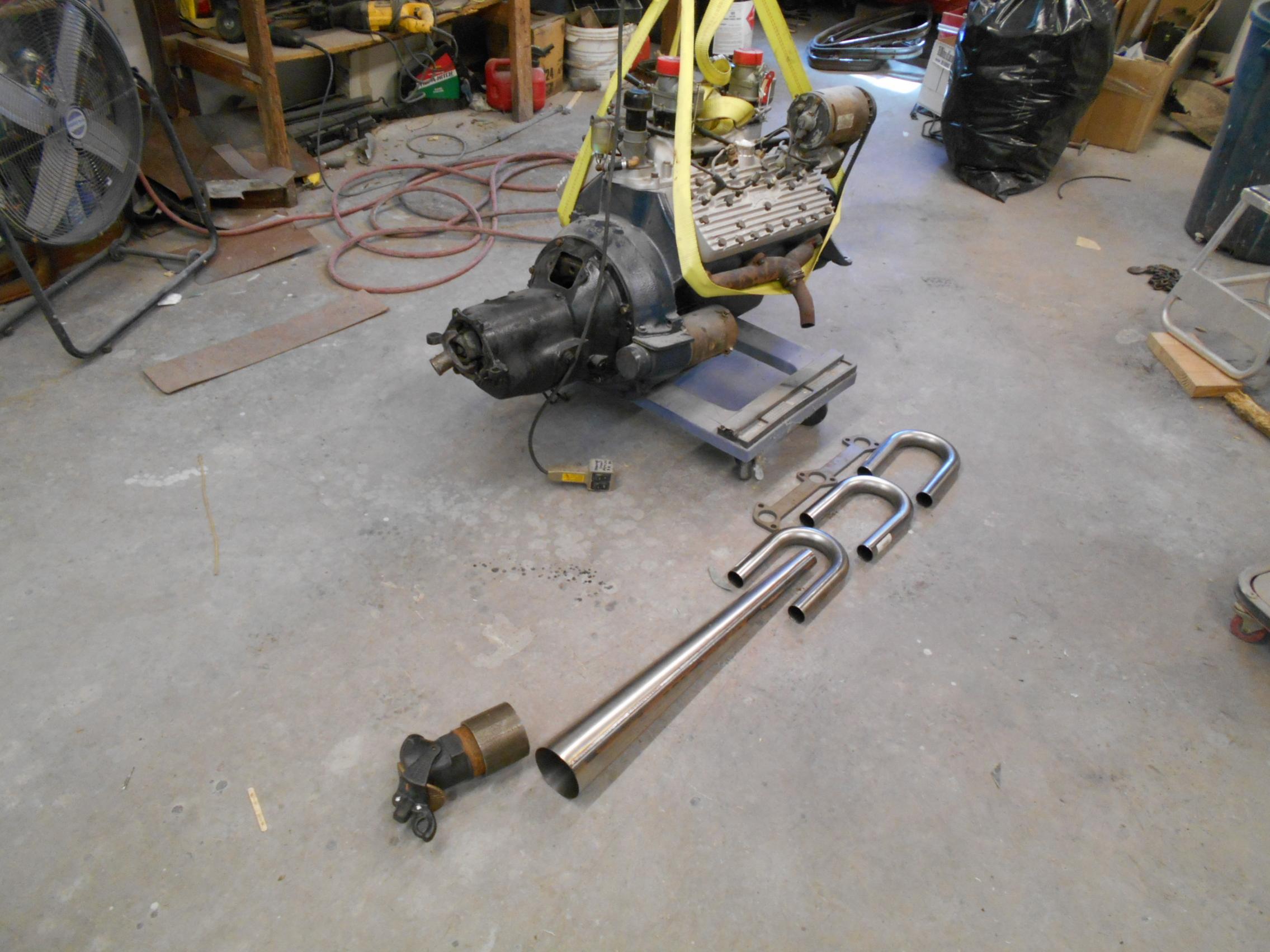

  21. jivin jer
    Posts: 3,535
    jivin jer
    Awhile back my conversation came back to that exhaust system that Jesse had mentioned at the start of all the info gathering. He said that he had a guy build lakester roadster type headers with megaphones and gate valves. This enabled him to arrive at the race site, get out of the car, reach underneath and open those gate valves which opened the headers.
    I ***umed he meant 2" gate valves (on R.) which are very common and attainable which I immediately was able to find . Oh no, he meant 3" gate valves which are huge and, I spent months finding these (on L.).

  24. jivin jer
    Posts: 3,535
    jivin jer
    With all the company's in Texas connected to oil and transferring it, I finally landed at the right one that helped with putting this together. I sawed the coupler in half which enables me to have something that I can weld to the megaphone and screw the valve into.
    You can see the valve screwed into that coupler here.
    Atwater Mike likes this.

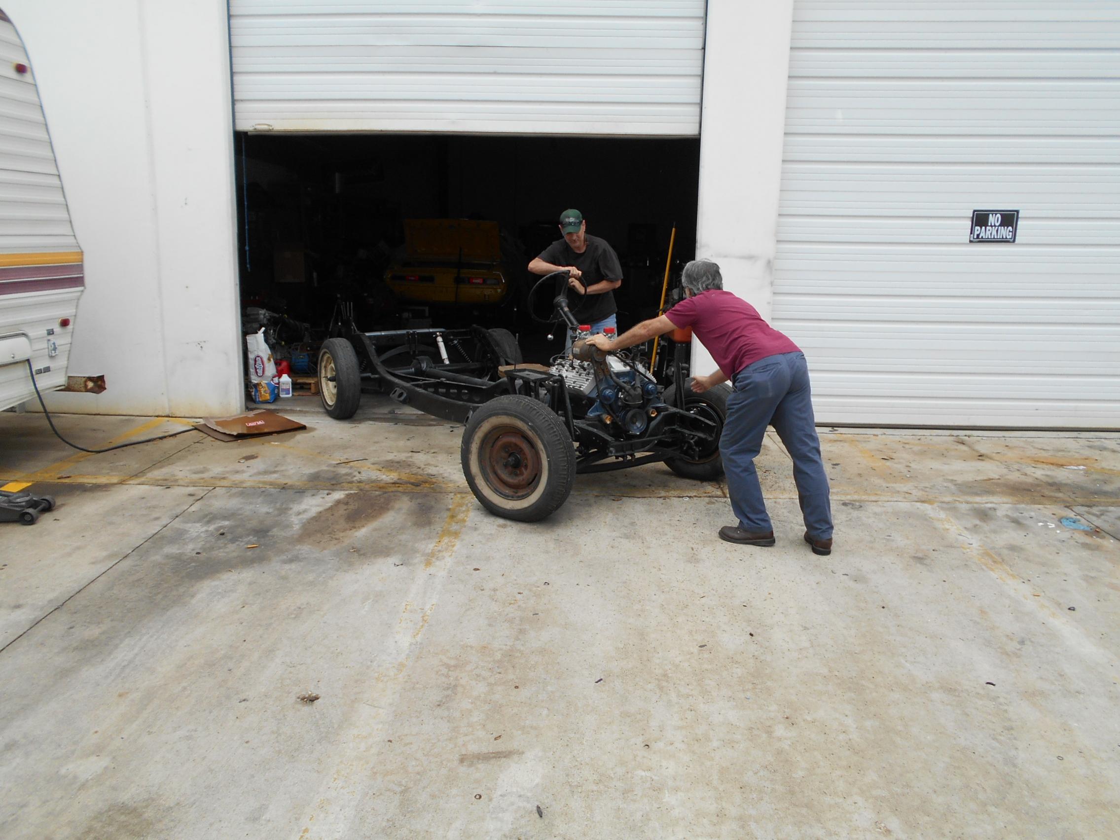

  28. jivin jer
    Posts: 3,535
    jivin jer
    I thought that finding the right person to fab up these headers would be easy. I was wrong. My traditional exhaust guy that did Jr’s car told me in no uncertain terms that he did NOT do headers.
    OK, I started looking at all the “custom” exhaust shops that are local and on the net. No luck. As I asked around I finally found somebody that had a name. A guy named Mike Miller. His business is called Miller Performance in Haltom City which is right next door. He’s in an automotive complex that has a lot of specialty shops.
    I contacted Mike to find out he’s greybeard360 here on the HAMB. A good guy with lots of experience doing a lot of stuff. I explained to him what I was doing and we made a deal.
    Here is the ch***is going into the shop.
