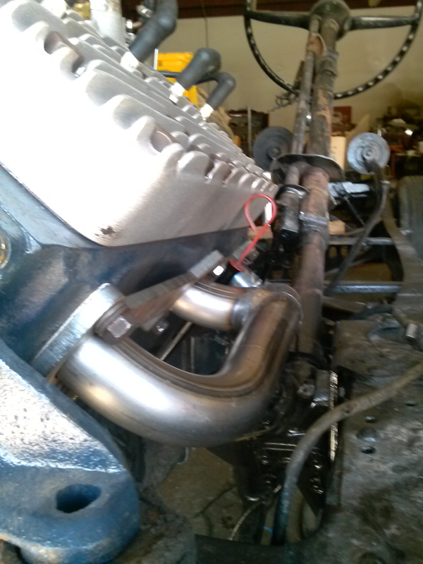

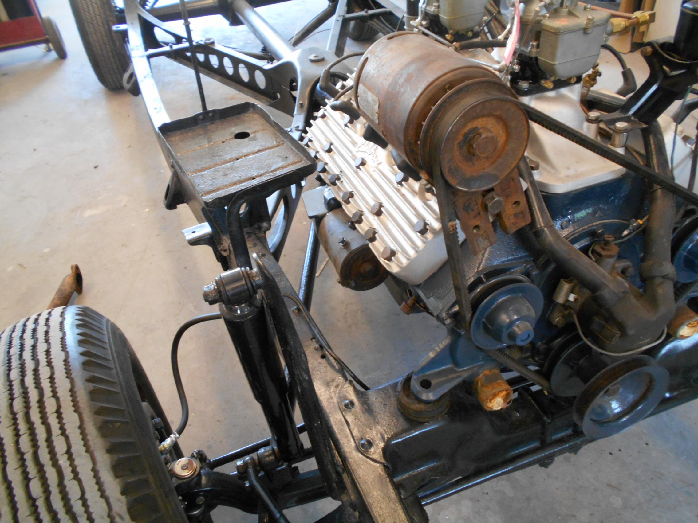

    Well, there's lots of room on the R. side, not so much on the L.. Here's a look as the mock up starts.

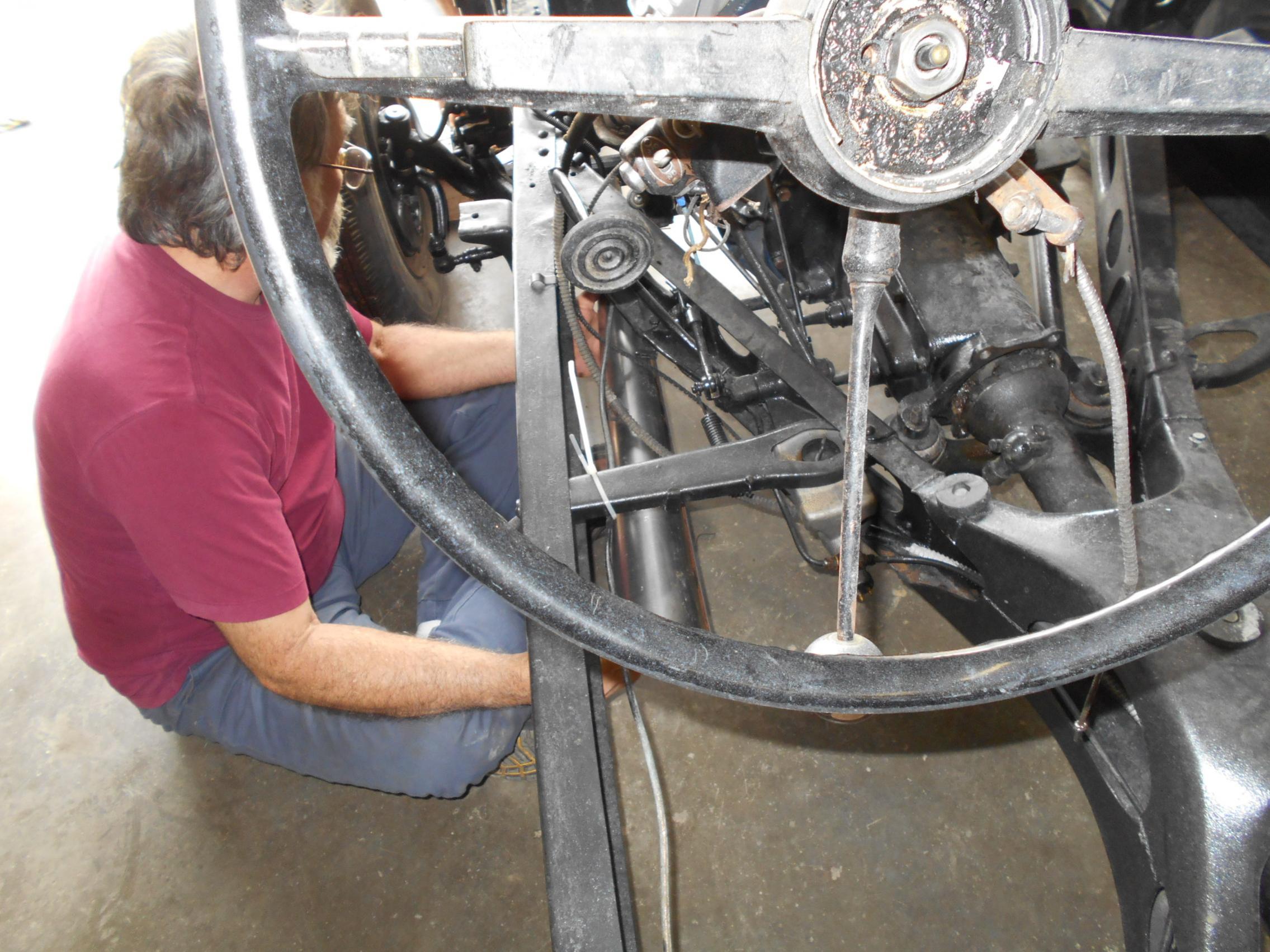

    I didn't check back with Mike for a couple of days and when I did I found out that he'd gone up and over that steering box.

    Interesting Jer. I wondered how he was going to deal with the steering box.
    What did Jesse do on the original?
    Torchie.

    I do like how this looks but, I've got to check With Jesse about this.

    Don't really see how it could nave been done any other way Jer.
    If you look at a stock 41 exhaust set up they used a kind of a Y pipe set up across the bottom front of the engine to avoid dealing with the steering box and then the exhaust ran back on the p***enger side( At least that's the way it was on mine).
    To get the pipes under the box would require hugging the block and hanging them down low then dealing with other supension issues as well.
    It will be interesting to hear what Mr Lopez has to say......

    Well, if they're going to be lakester type headers I'm thinkin' they have to go down not up. Jesse confirmed that to be the case.

    Wow, mucho trabajo, greybeard360 (Mike). Both ways look great, impressive work. Yet again, dogged determination (Jerry)to get it right, equally impressive.

    OK, that's better. I do think that I found the right guy for this. Great job Mike!

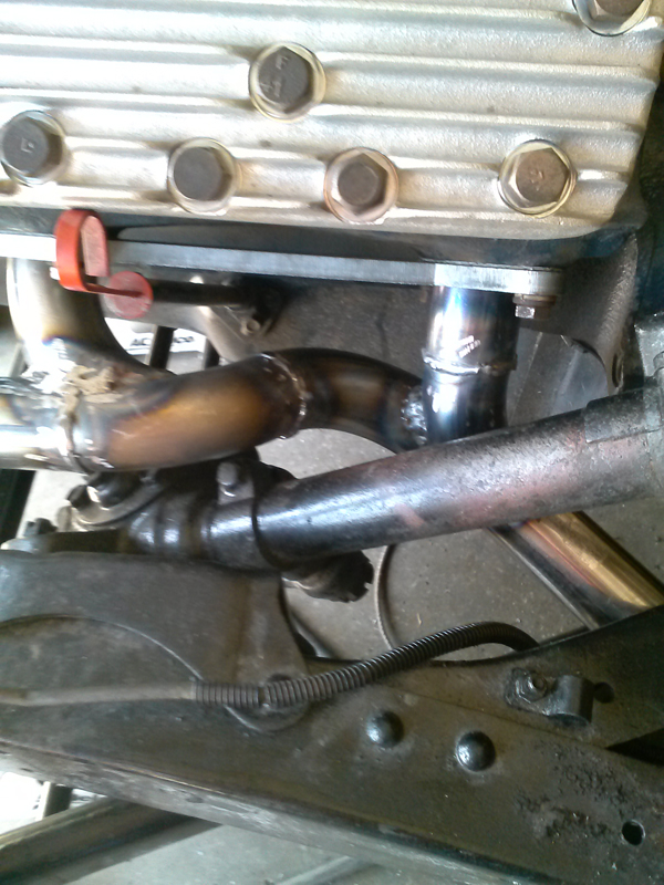

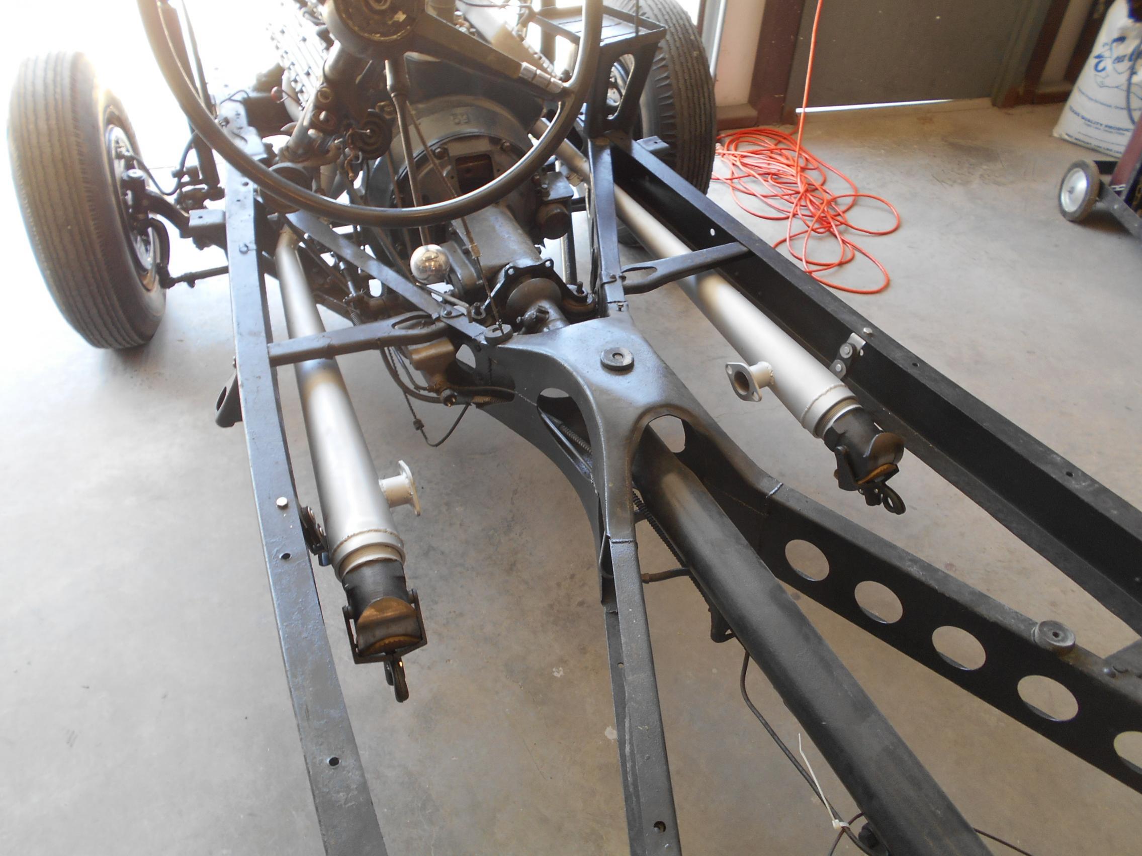

    I had a little problem with the welder on this side. The tubing came from 2 different sources and for some reason didn't weld the same. Not as pretty as I like. On to the other side!

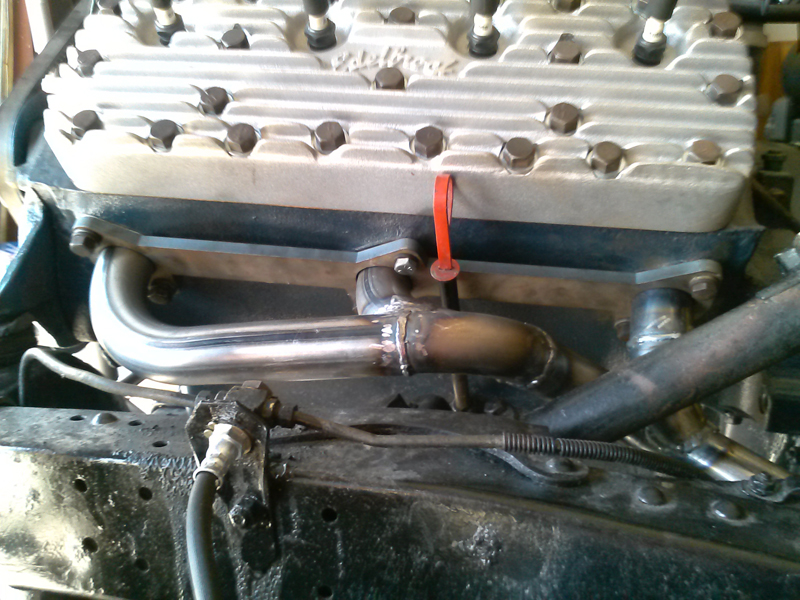

    The other side.
  13. Those look great. I've been wondering how to run lakes headers on my '41... now I know.
  14. It makes a HUGE difference when everyone involved in a project operates with the same high standards. I would expect no less with your recreation Jer. Good stuff greybeard360! I'm lovin' this project!

    It took some comparing from side to side to decide how to run them. I knew the car would set low and had to contend with the steering, clutch and suspension on the left side. Right side was almost easy !
    We didn't have any old photos of the headers themselves but did have a side shot and I could barely make out the bottom of the pipes so I knew they were tucked up nice and tight.

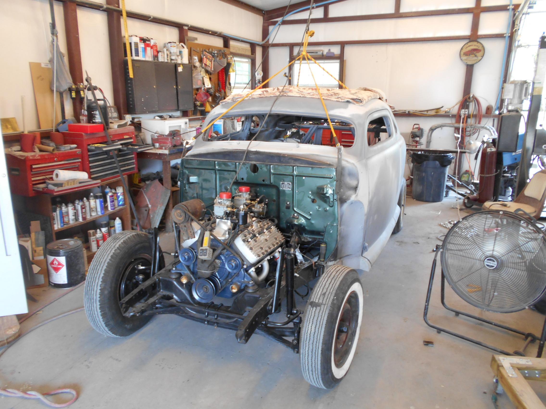

    Well. If the drive train is installed and it's time to mount the body, that firewall has to be painted the correct color.

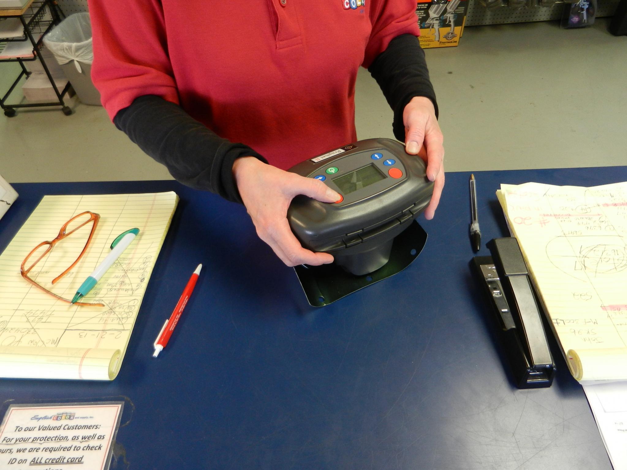

    I took those cards down to my paint company and they looked at that color with a device that could ****yze it and come up with a formula that would duplicate it. I had had these guys mix up what we thought was Andante green from a translated RM formula and sent it to Jesse earlier but it wasn't close.

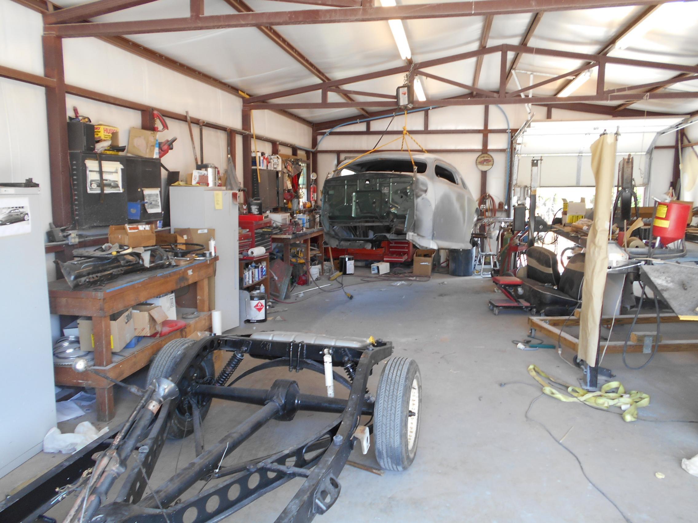

    OK, remember, this is a one man job.

    Why the "extra" white shock?

    The white shock is for mock up. Jesse had the overloads and the inner stock type. When the ch***is is fully loaded we'll see what kind of shocks (lenghth) will be needed.
    Partssaloon, I'm sure this can be arrainged. Maybe the Yellow Rose Cl***ic.
    Regarding this remount of the body- you need to stage your ch***is on a prearainged spot on the floor that will put it exactly under those mounting areas. There are only four main ones. This is VERY doable for one guy with everything set up this way. The winch is a $500.00 Grainger that I can easily take in and out of my trailer.
