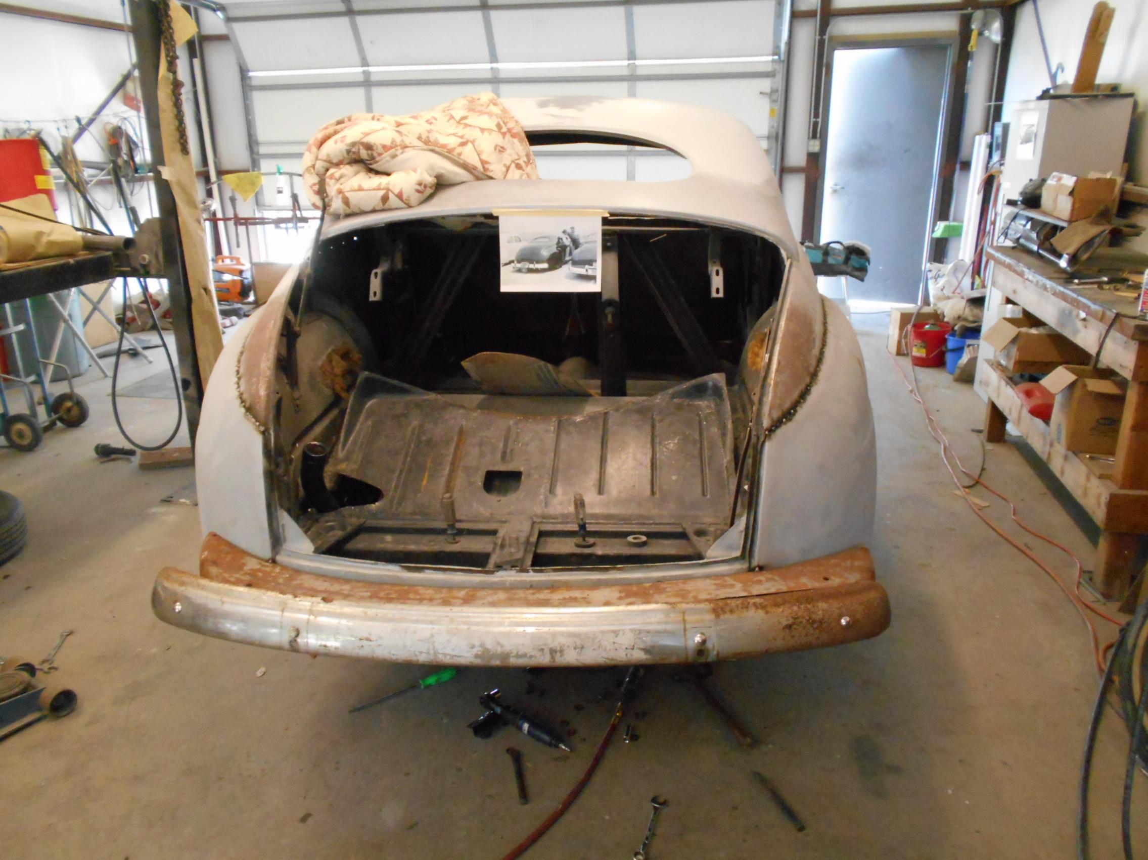

    OK, we need to get these rear fenders that have been straightened and put away installed.
      261.5 KB
      484

    Man, these fenders are huge>
  8. Karl stark
    Joined: Nov 12, 2008
    Posts: 166
    Karl stark
    Yeah, looks like the weight alone should lower the rear a couple inches.

    This is the solid rear gravel deflector that came with the '46 Merc parts (post#728). Bill Dyson's (48 Ragtop) words have been stuck in my head for months, "that gravel deflector is about an inch below that trunk opening".

    Tacking everything together for fit.

    Mocking up the rear pieces. The fenders will eventually be welded solid.

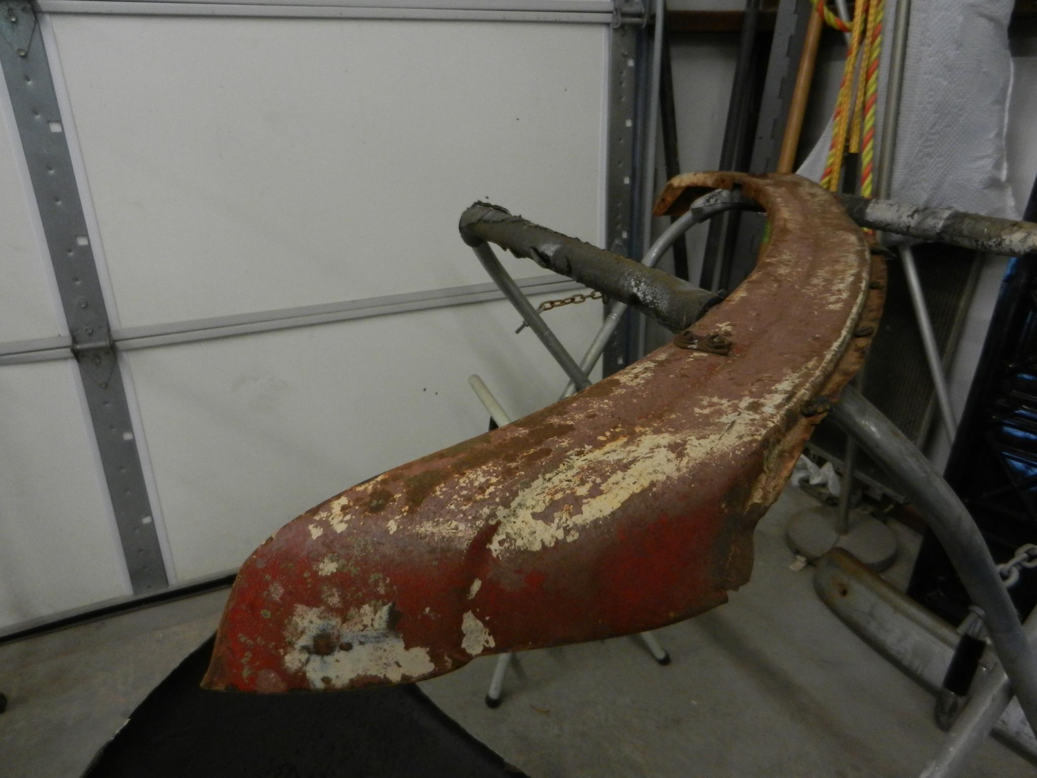

    The next task is to make that rear gravel deflector look right. If you look closely at the rear bumper tip and rear gravel deflector you'll see that there needs to be a large extension to the bottom of the fender.
