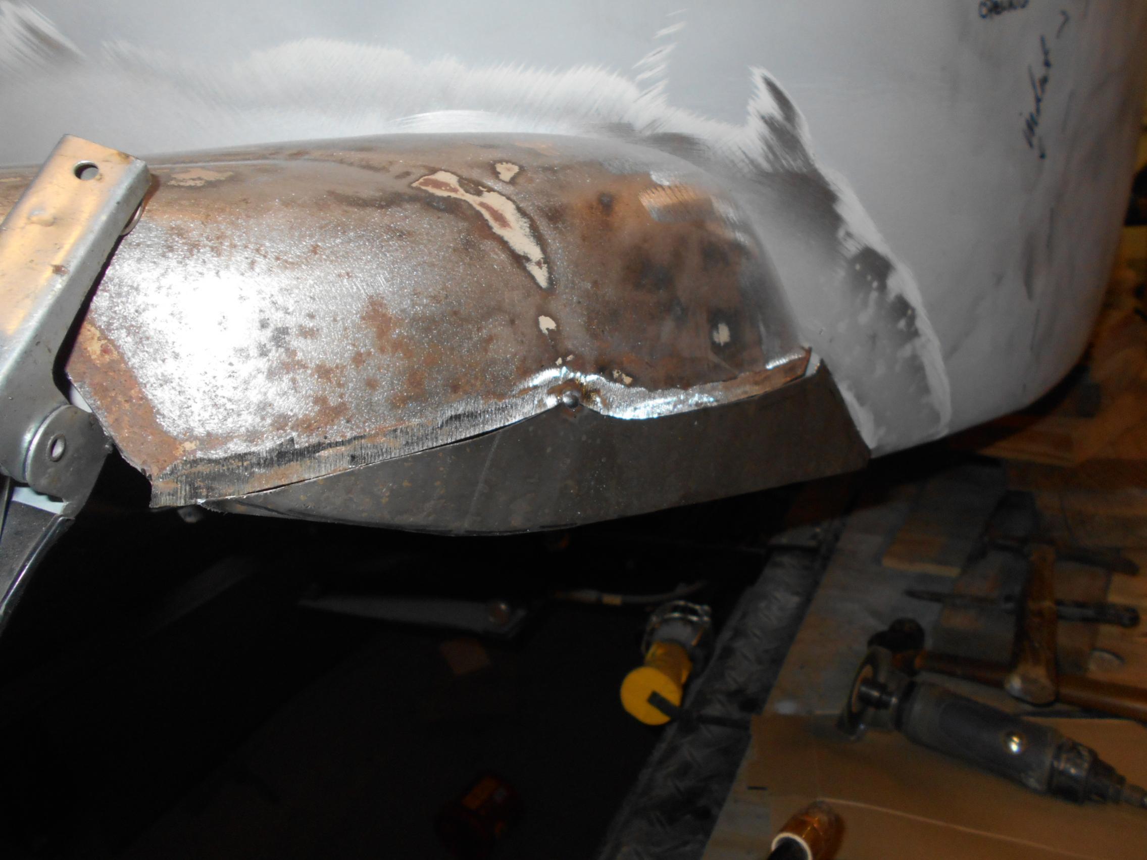

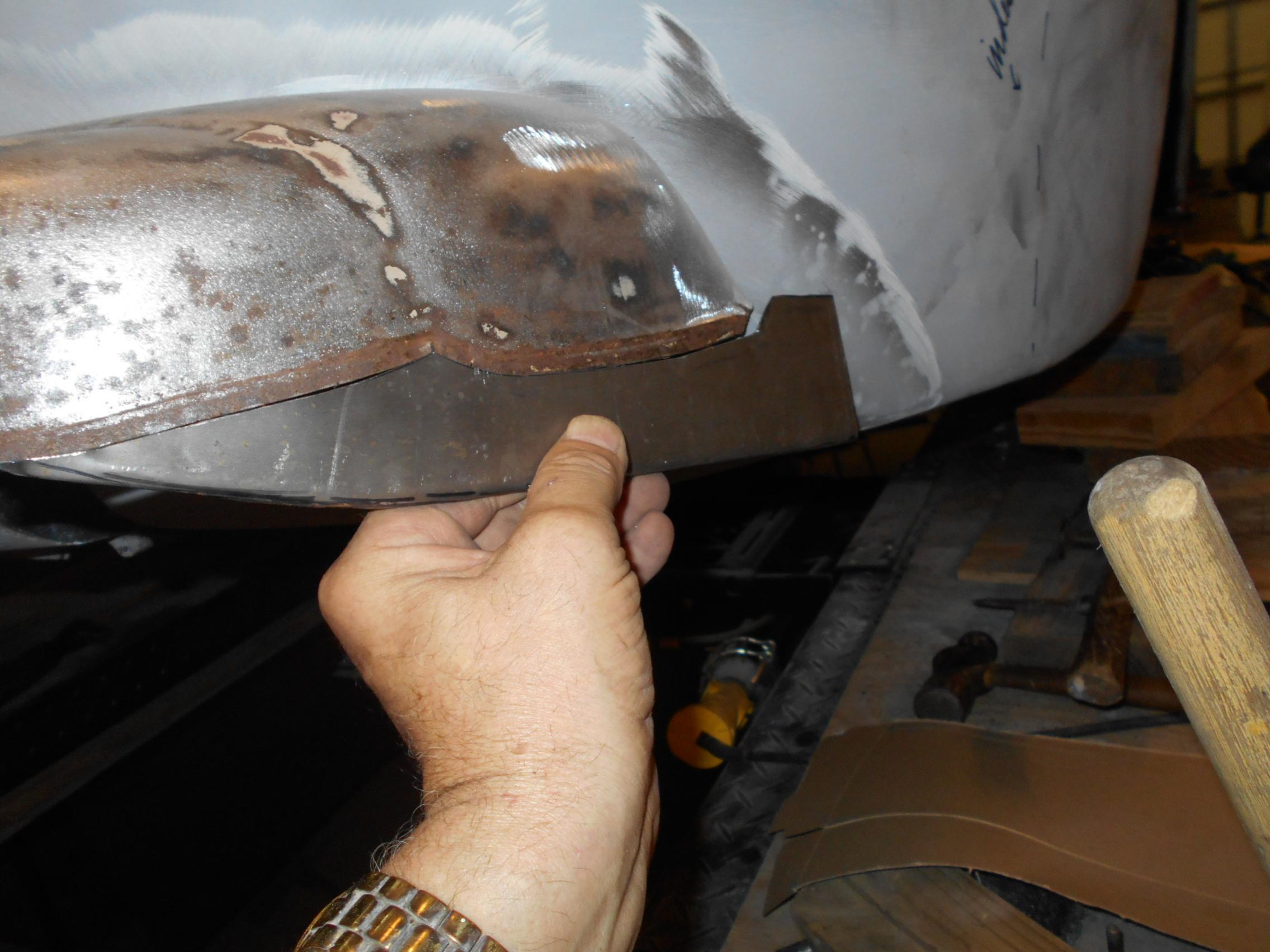

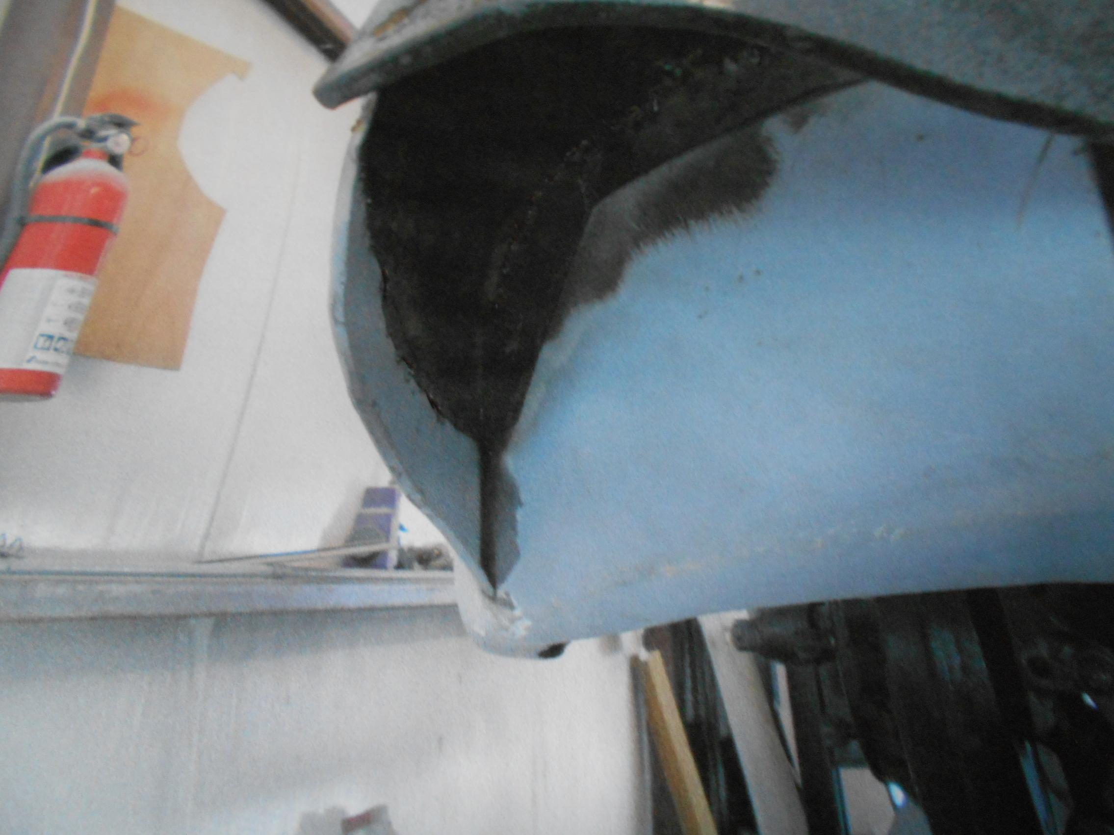

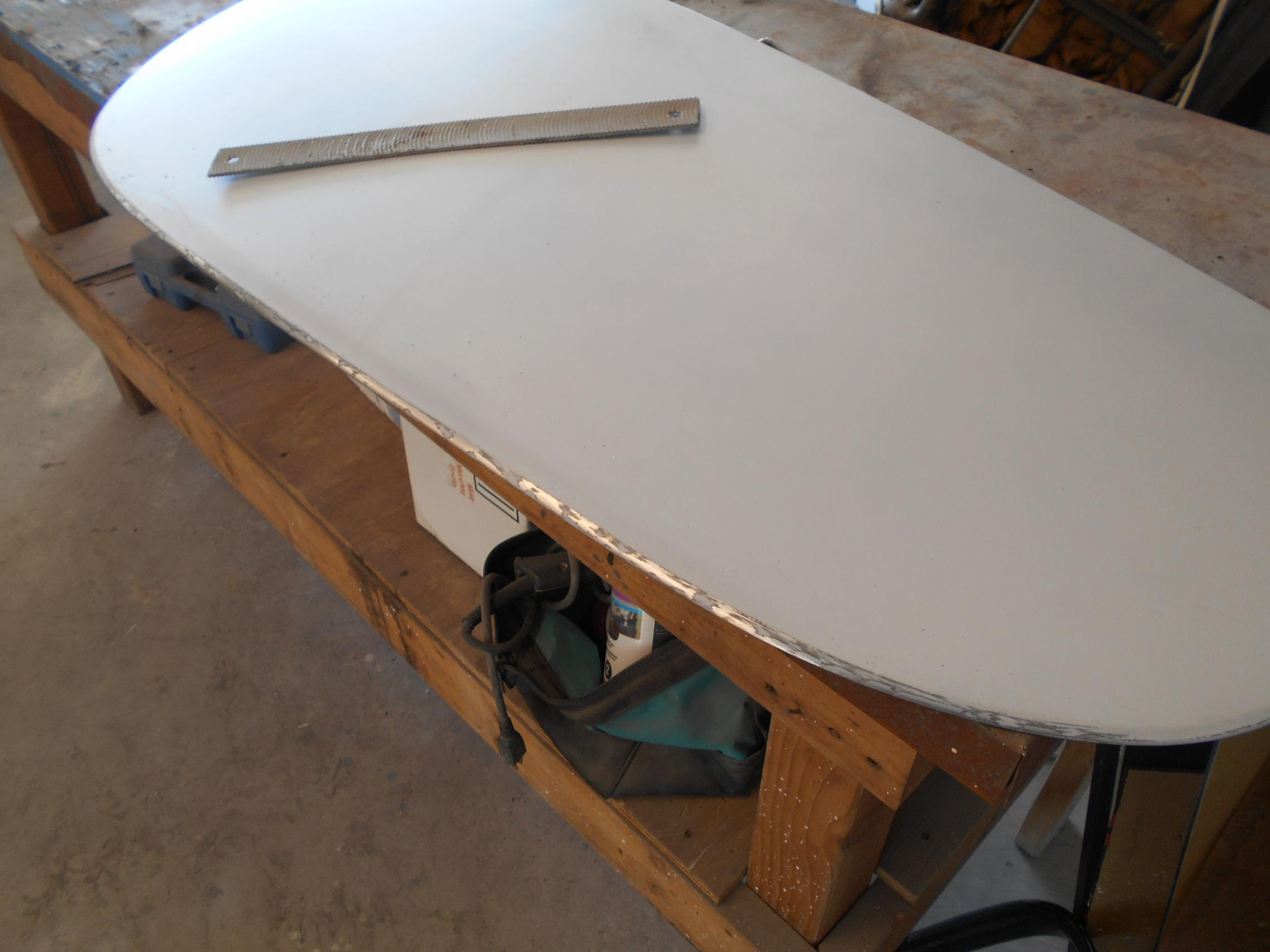

    After we're happy with the position of the gravel deflector we need to see how that extension might look.
  5. jivin jer
    Joined: Sep 14, 2008
    Posts: 3,535
    jivin jer

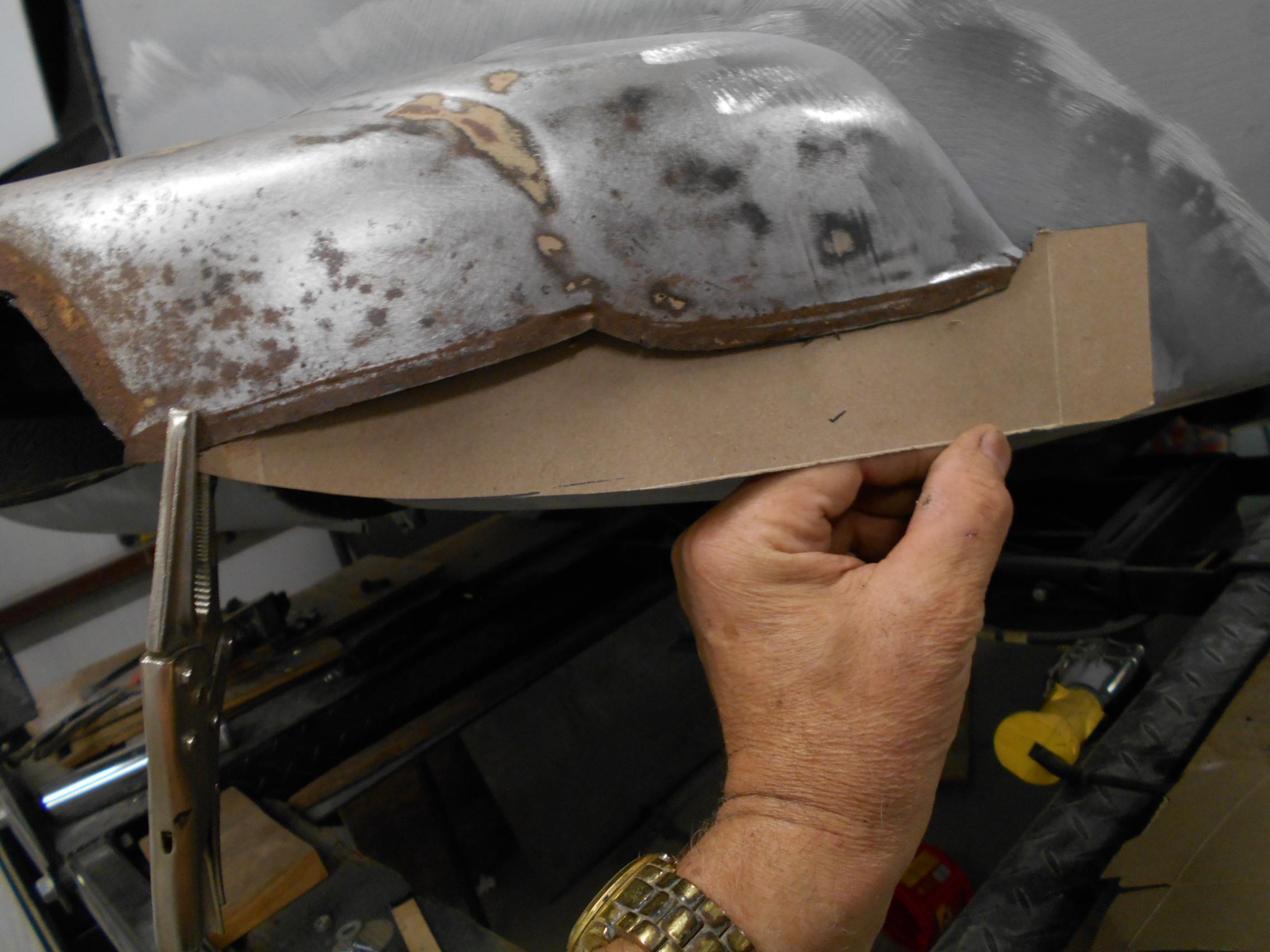

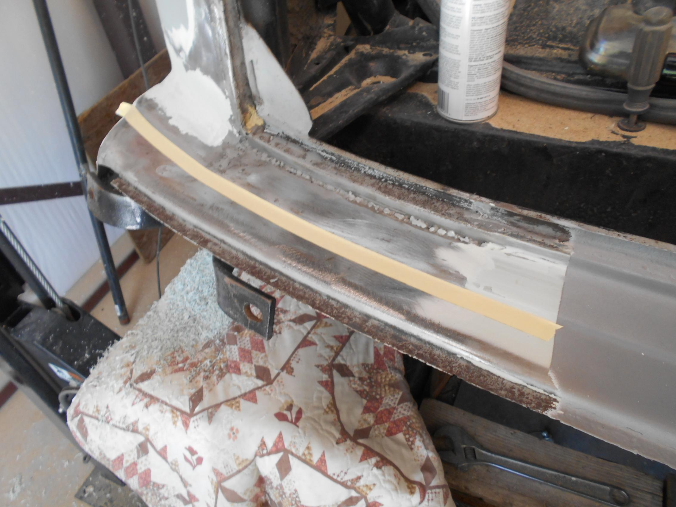

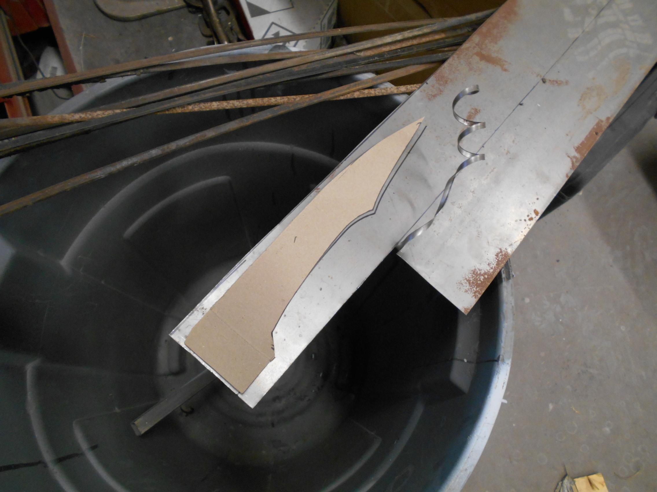

    I like the way the extension looks when I compare to the original pics. I hammered out the lip on the gravel deflector but, I'll need one on this extension so, I leave enough room on the bottom side of this template for it.

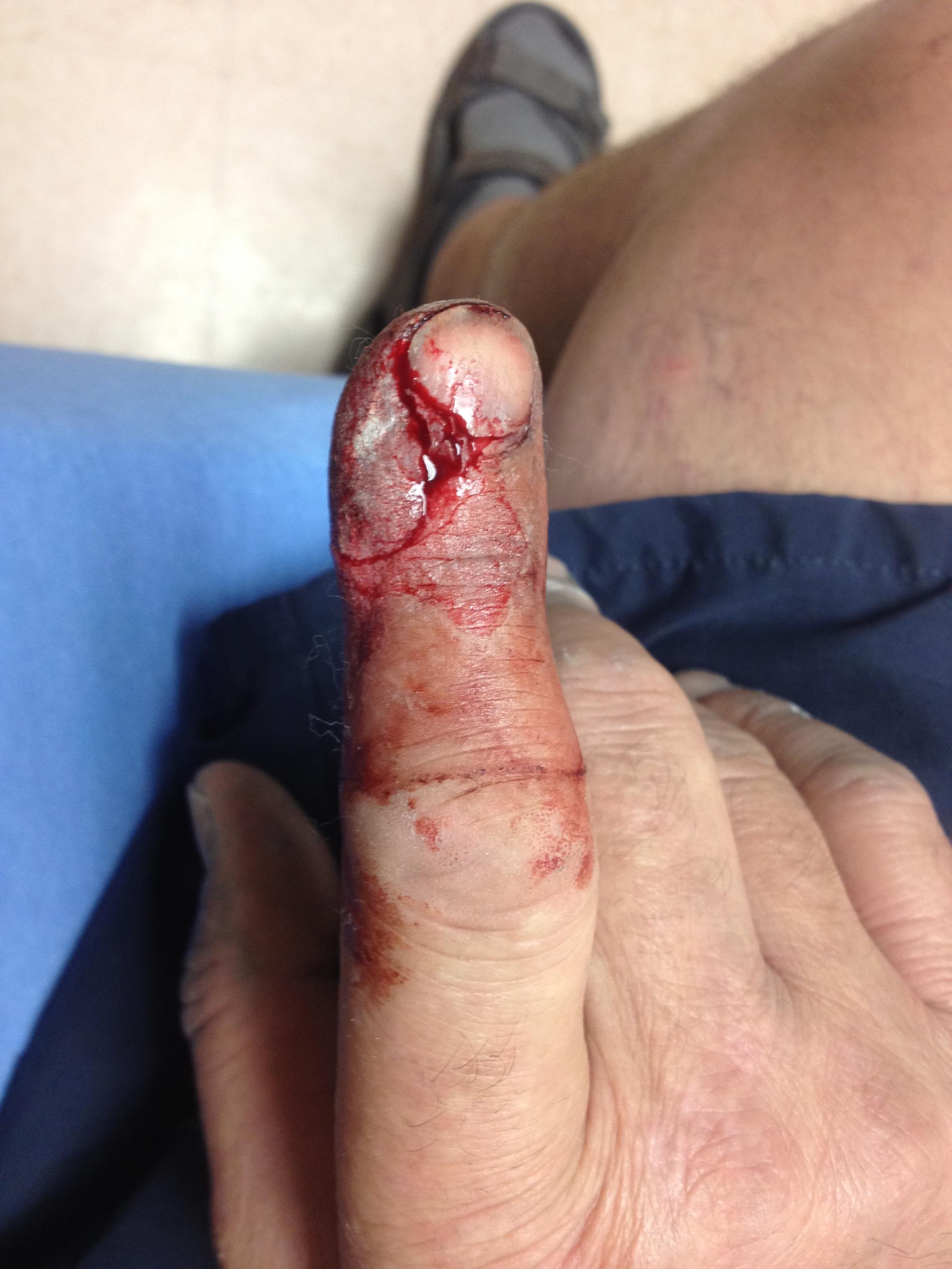

    Thanks for all the medical advice. The x-ray showed the bone is cracked. I got some s***ches and this morning there's hardly any pain. I must be pretty healthy.

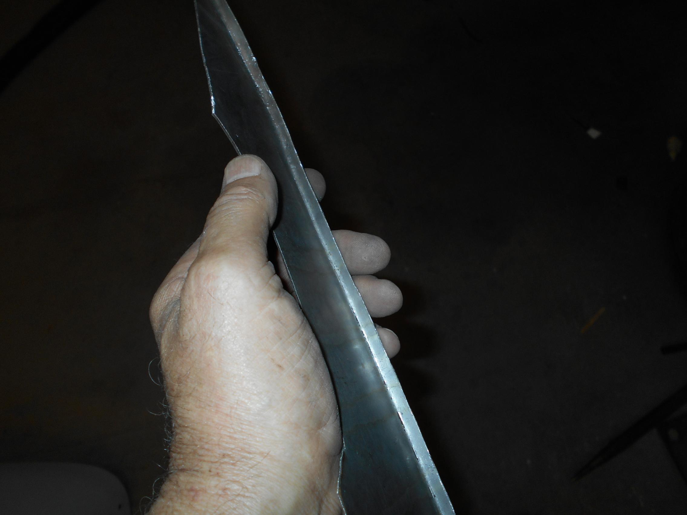

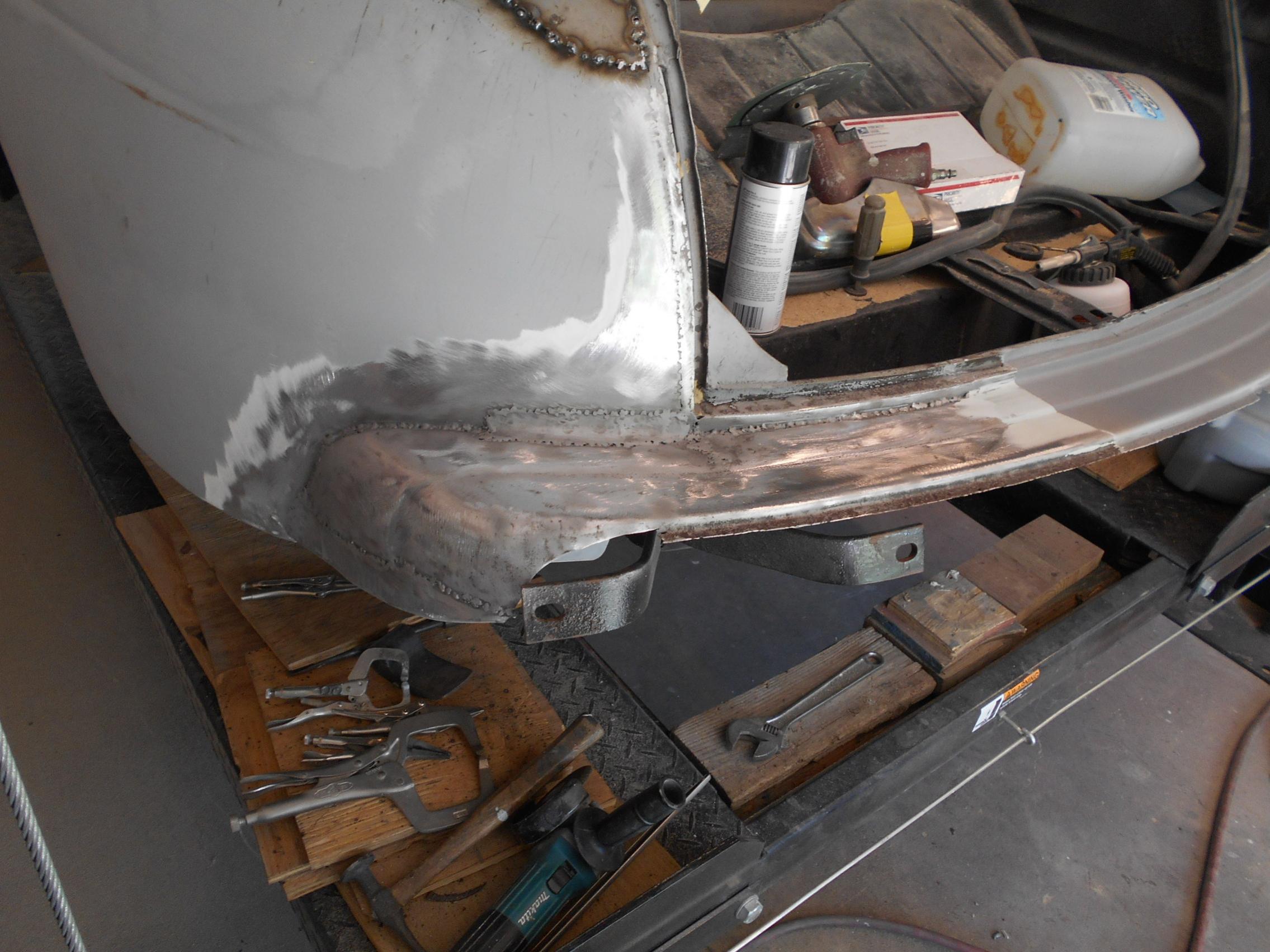

    Here is the extension with the lip it's gonna' need.

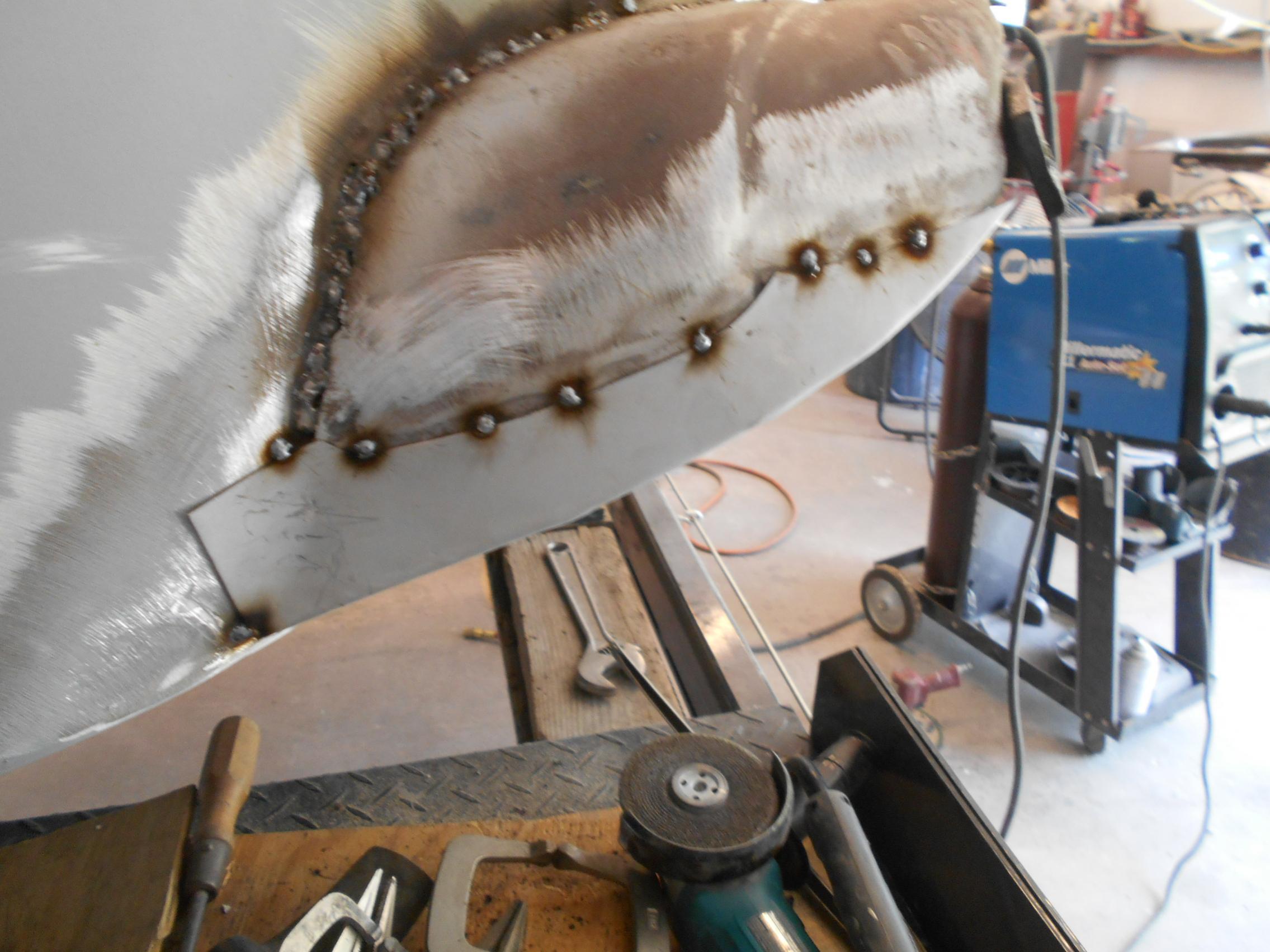

  20. jivin jer
    Posts: 3,535
    jivin jer

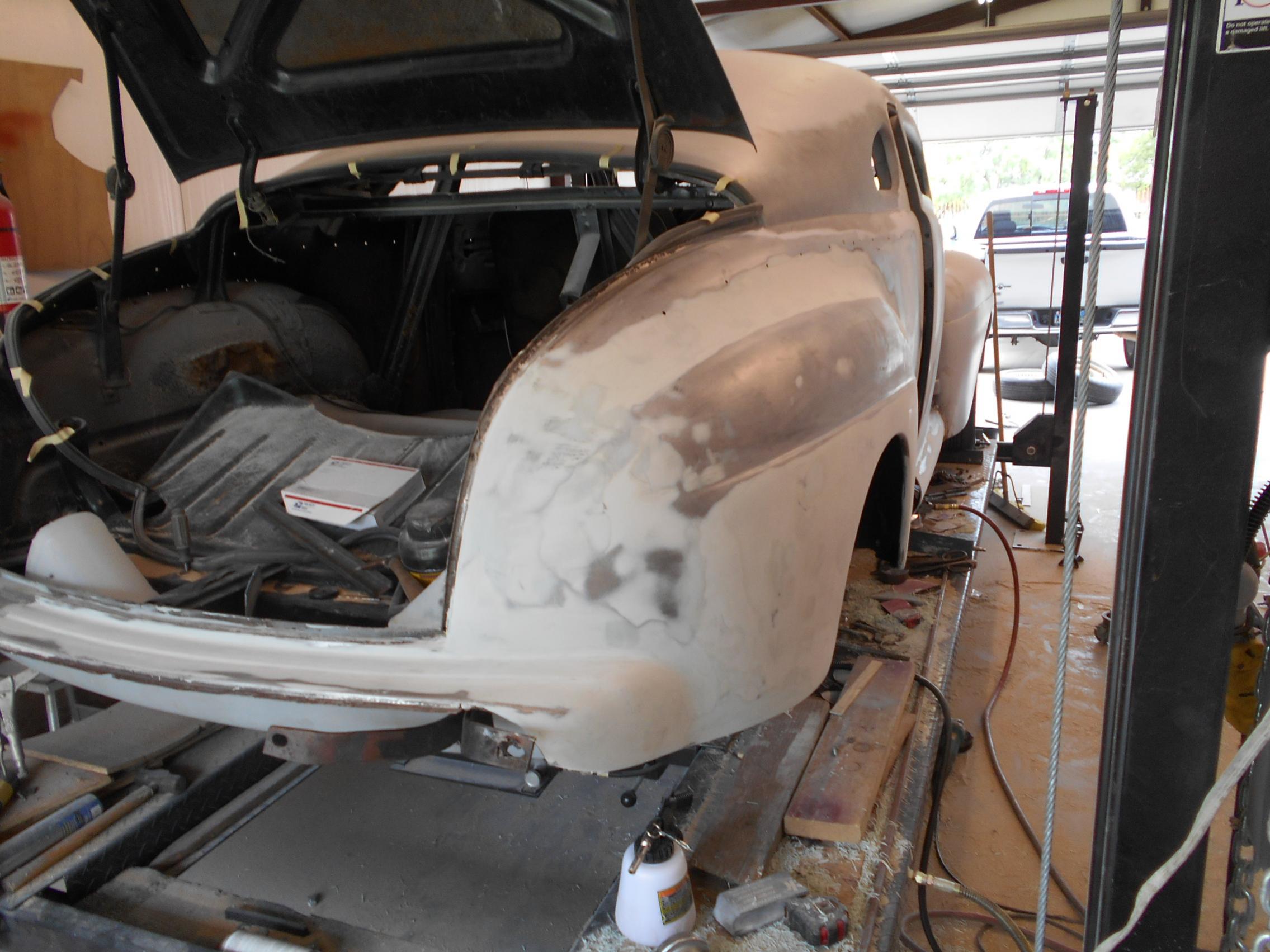

    Texas is so humid that after the welding is done I sand blast everything with my hand held blaster.

    Gettin' there.
  24. greybeard360
    Joined: Feb 28, 2008
    Posts: 2,098
    greybeard360
    I think that might work. !!!
  25. BrerHair
    Joined: Jan 30, 2007
    Posts: 5,137
    BrerHair
    That 30 year paint & body experience is showing through there, Jerry! Mighty fine.

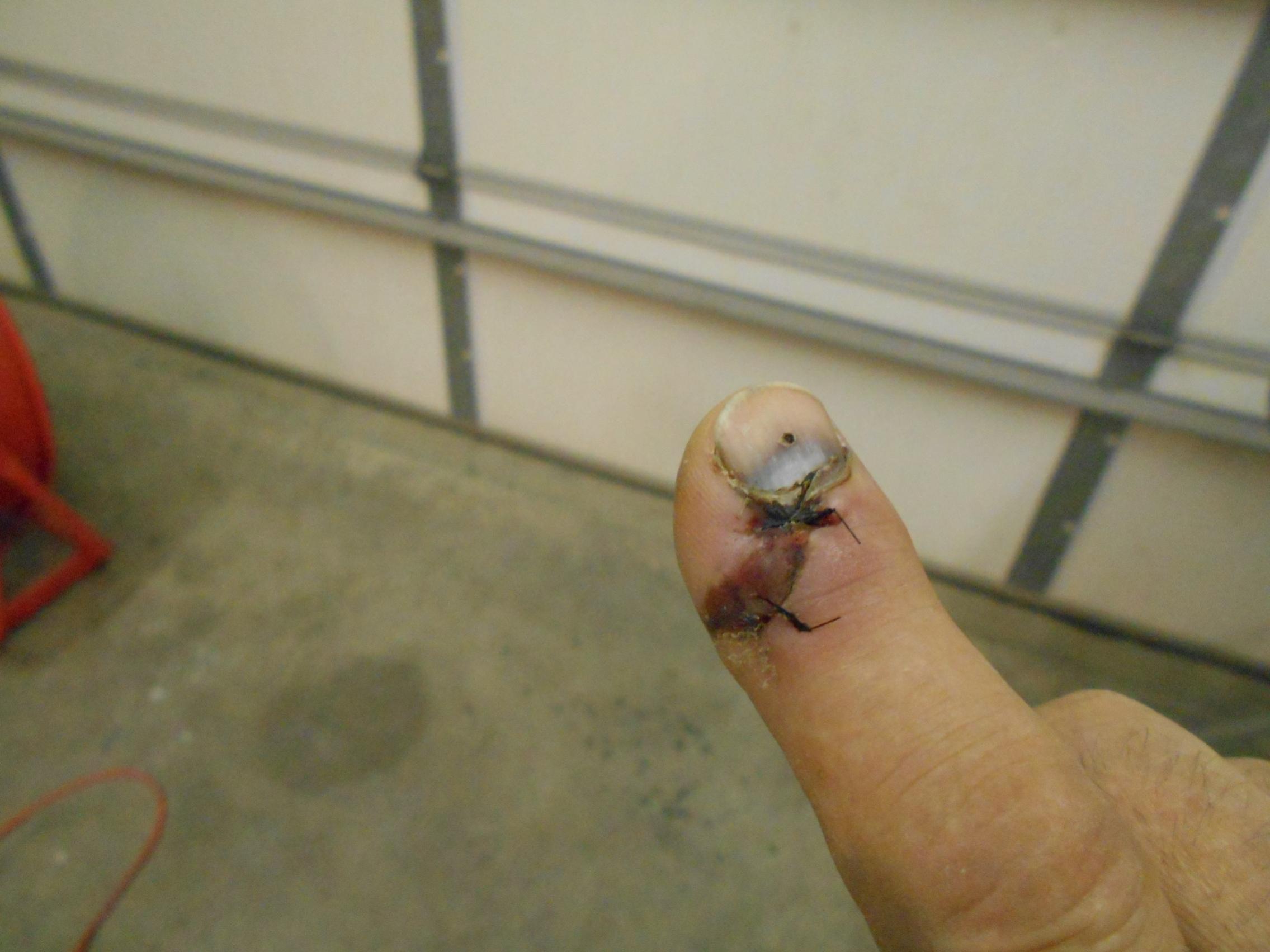

  27. jivin jer
    Posts: 3,535
    jivin jer
    OK, lets get these skirts squared away. Check post #261 where the conversation starts. After they are "contoured" a bit I rub on em' a bit with the body file.
  28. jivin jer
    Posts: 3,535
    jivin jer

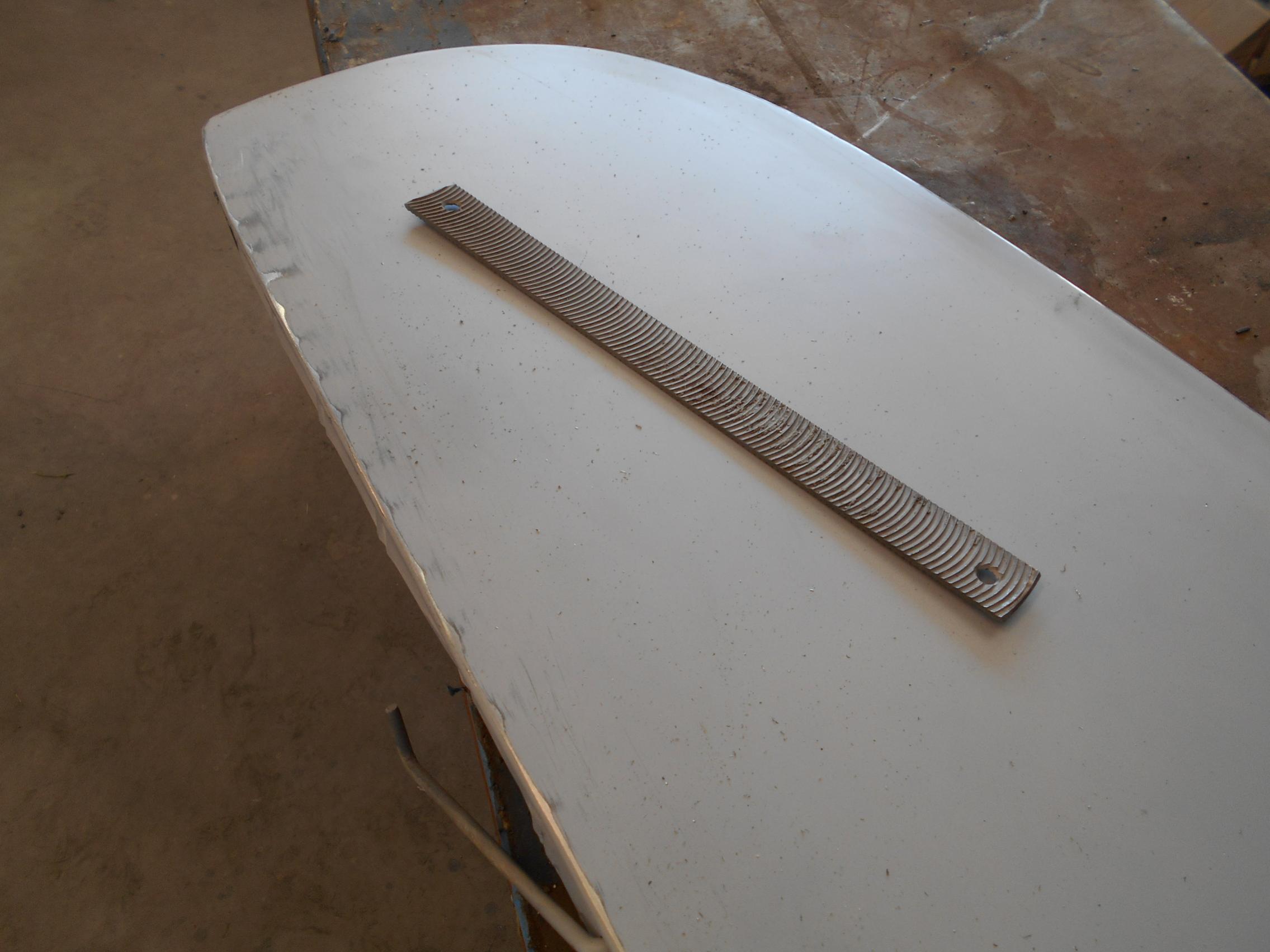

    I thought I might be able to just "shoot" these skirts after spending a little time with them. Where this could work in some applications it won't work here. They're just not up to the standard on this build.
    This is definitely an option to original long '41 Ford skirts (if you can find them). I'm sure the guy that has all his work done by someone else could be in a pair of original restored skirts at 2K+.
    These skirts get the job done but, they'll need a skim coat of filler to be right.
      269.4 KB
      425
  29. rob-redm
    Joined: Nov 15, 2005
    Posts: 6,755
    rob-redm
    looking good Jer ! how is that finger doing ?
  30. jivin jer
    Posts: 3,535
    jivin jer
    The finger is doin' good. If I try to make it work it hurts. So, right now it's kinda' along for the ride. It's stiff from the joint forward but, doesn't hurt unless...
    Here's the skirts stripped and ready for primer. The skirt pics won't upload, so all I can give you is the finger, probably not the first time.
