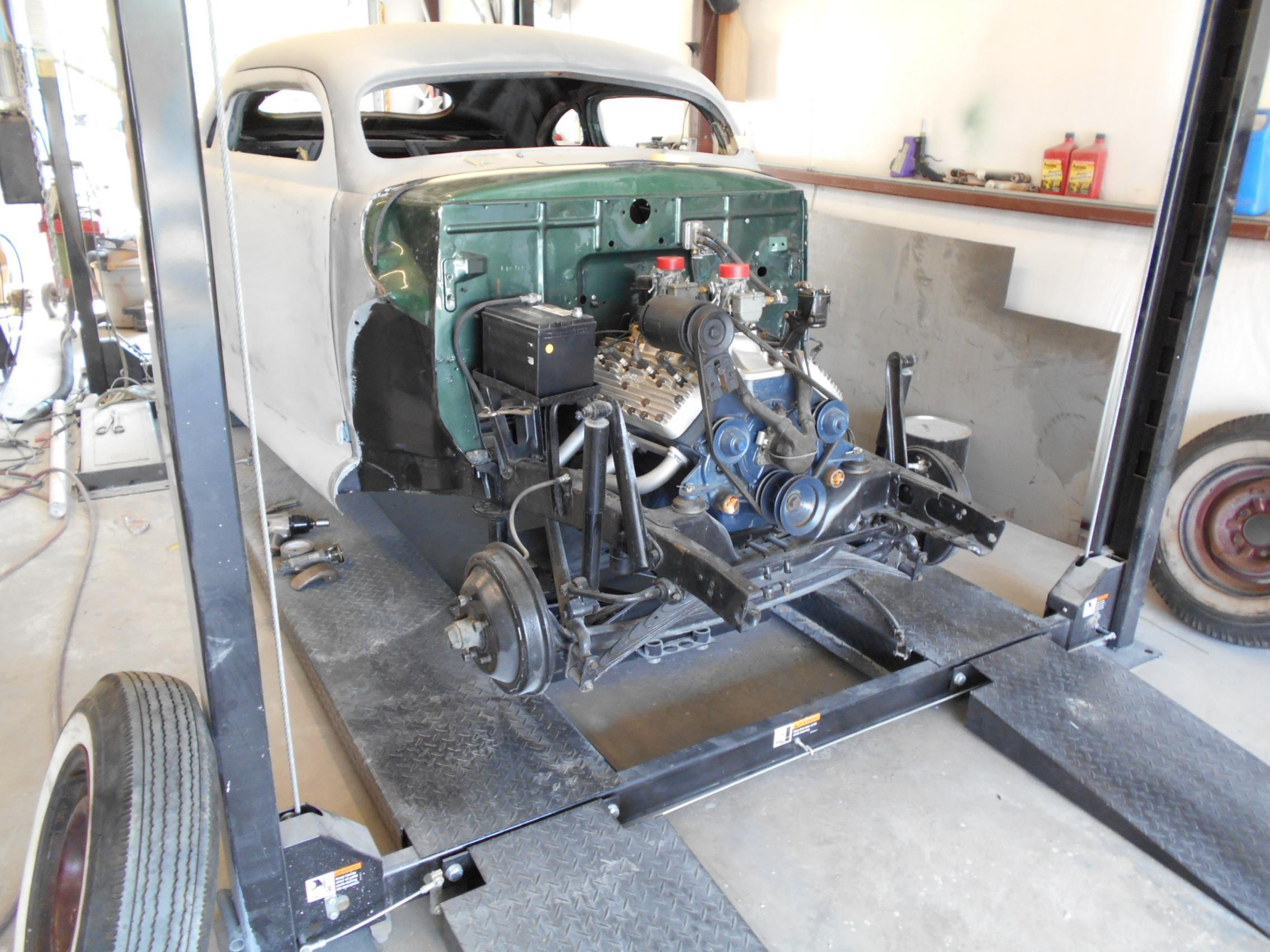

    Jesse says that back in the day you could buy oil and gas in 55 gal drums. A truck would deliver, and you would need a bench that was the right height to slide it onto. They had those gate valves on them. Jesse took notice and the wheels started turning.
    Jesse was also Fritz Voight's helper/gopher. He noticed that Fritz had some larger gate valves in his shop and they became a topic of conversation. Jesse mentioned the header dump idea, and the rest is history (as they say).
    Fritz was the local racing engine guru, but remember it's THAT neighborhood. So, Jesse had a pretty stout 3/8X3/8 59A stroker with a blower. It wasn't fair, but it still was. Fritz did build em a bit loose for power. Jesse says that he would knurl the pistons. One of the secrets to the power that Jesse made was that he didn't run an idler arm on that blower. It was just straight off the blower to the crank (no middle man with his hand out). Jesse would tip the intake manifold up in the back and set the belts. He would just lower the back of the intake down on the deck and tighten everything up.
    Fritz would go on to work with Mickey Thompson and eventually did ALL of Mickey Thompson's engine work on his Pontiac world beaters.
    So, what I've got is a stock 59A with the correct (visual) equipment that Jesse would run during the week. Remember Jesse had only one car that ran. He would whip the intake off, put the blower on, leave the hood off, and head for the drive-ins on Fri-Sat nights.
    I had Ray Marler do the valves, install all the bolt-on stuff, and slip in an Isky 400 jr cam (audio).

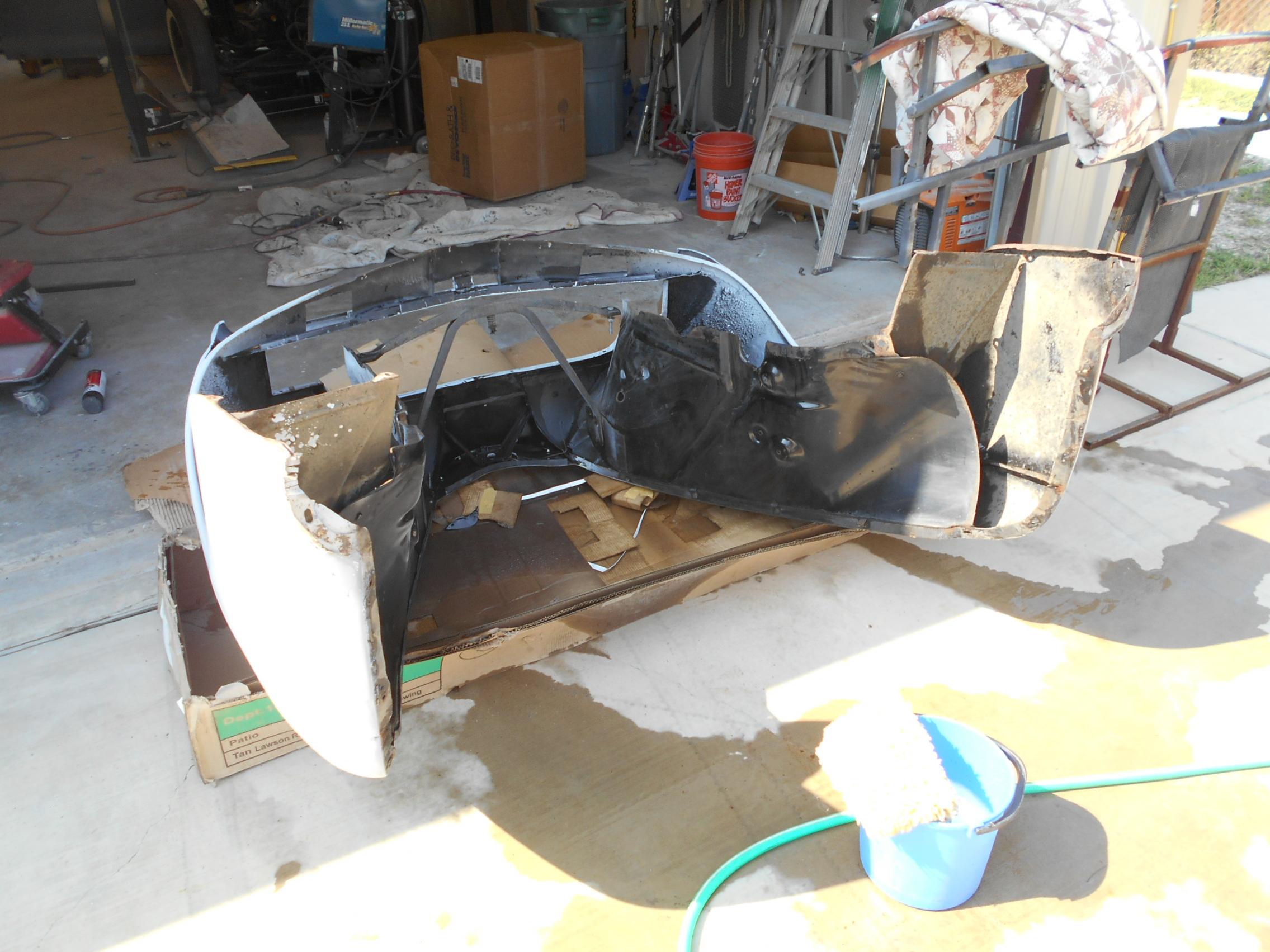

    Thanks everybody. I've been careful regarding corrosion protection so its time for some hot soap and water.

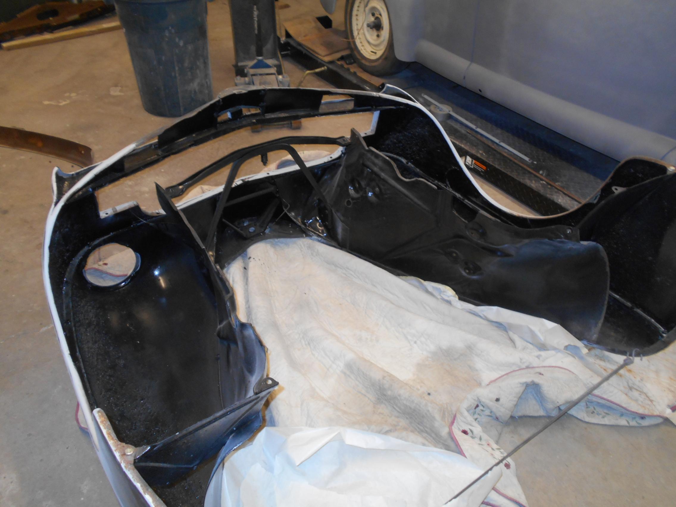

    This is the easiest way to get at this, and I can also separate it when spraying out the car. This is the base w/out the clear.

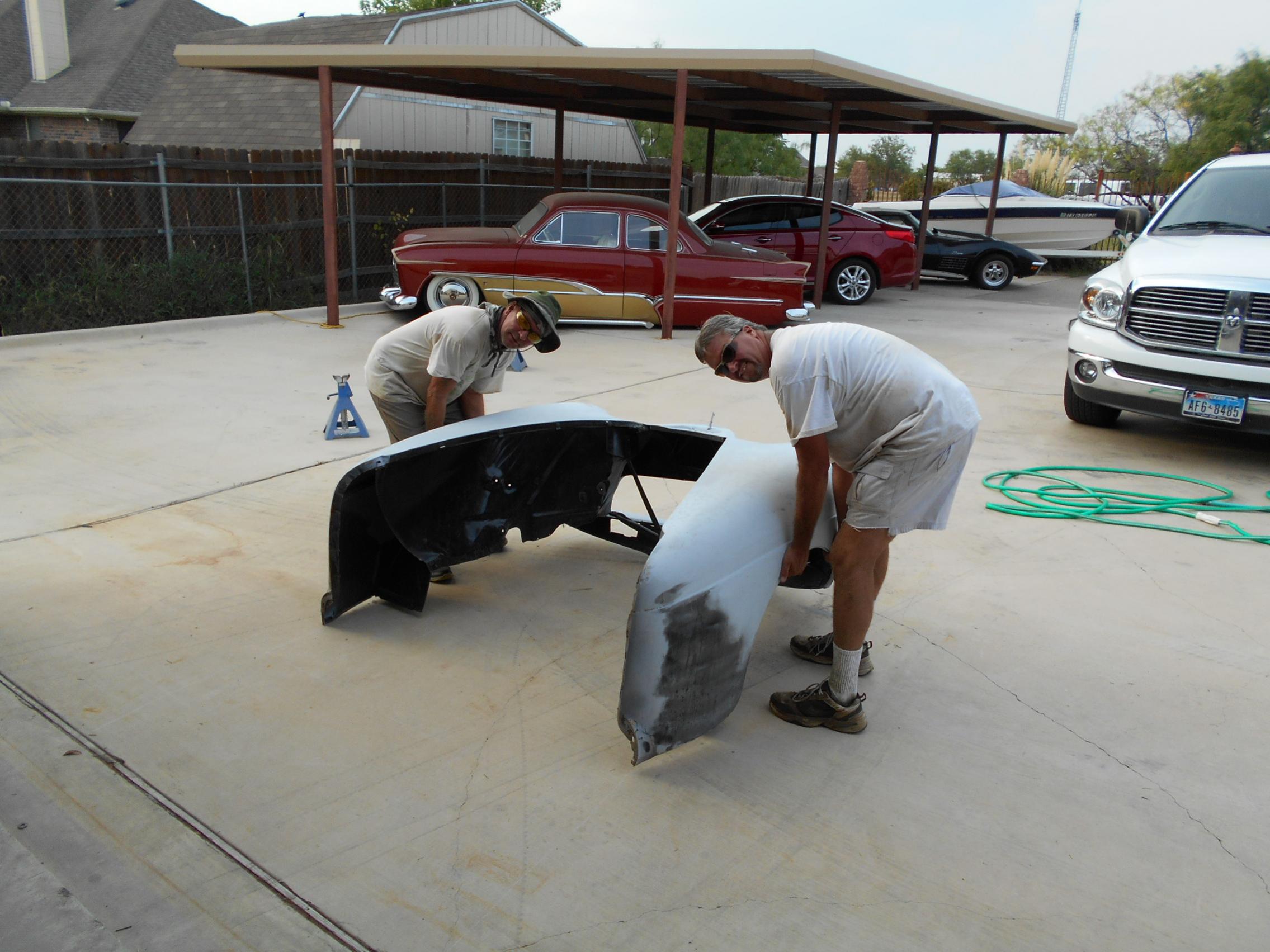

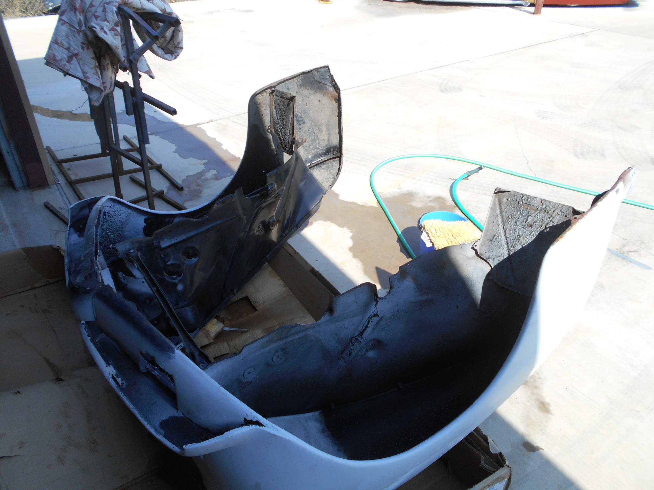

    I had to ask the lawn guys for some help.
      376.5 KB
      546
      338.7 KB
      553
      336.1 KB
      548

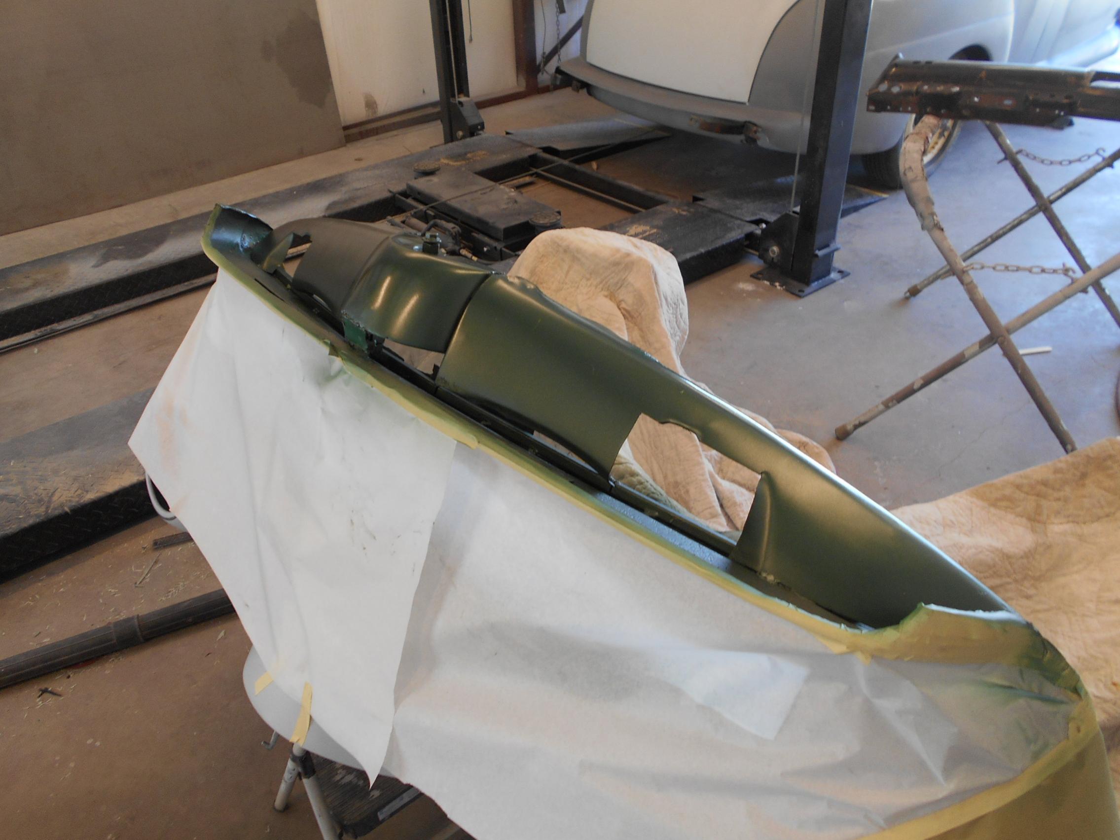

    I couldn't help it. I had to paint the hood.

    AWESOME! Does Jesse approve of the color? I'm guessing that's why you shot it, right?

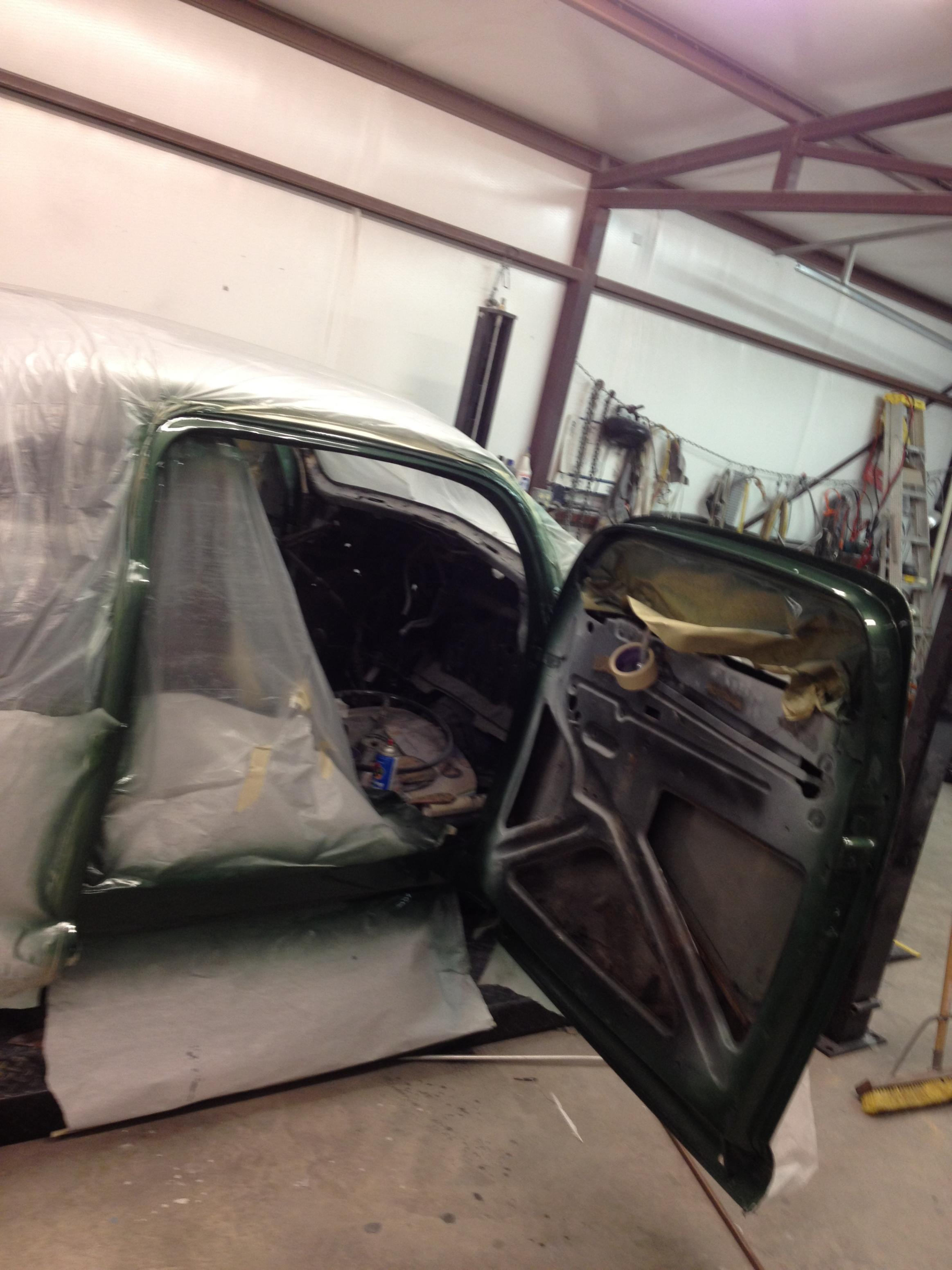

    Here's a better look at the color. More clear on the jambs.
    I have had some recent discussions with David Zivot and he is encouraging me to paint the car in lacquer. I would love to do that but, I wasn't aware that it is available. He gave me info on his source and after discussions his source can supply me with acrylic enamel only. That won't do.
    My first experience with any paint was in the mid 60's and it was with nitro lacquer. What a great paint to work with. Very friendly and forgiving. I don't remember any problems with it. Later on when I had my own shop acrylic lacquer came on the scene. I think it was the car manufacturer's that were always pushing the paint co's for a more durable product. What a nightmare until you became familiar with it. You had to really watch out when repairing a fresh acrylic lacquer job. It would want to soften everything up again and wrinkle.
    I have found a source for the acrylic lacquer and they are in the process of bench mixing a good quan***y that matches the spray out card that I sent them. Although they can mix nitro it won't work for this color. One of the HUGE pluses with lacquer is no sticky overspray. A big deal for me. The masking required is daunting.
    I don't think that the K36 primer is going to be a problem. Being a two part product it is now an inert substance. I will strip the hood (too much material). I think I can still use the existing paint on the jambs. It is the latest PPG eurethane. It will be great fun doing this in lacquer and I'm looking forward to it. After application the clock works for me rather than against me. Not so with eurethane the longer you wait to rub it the harder it gets. It is however, BULLET PROOF.
