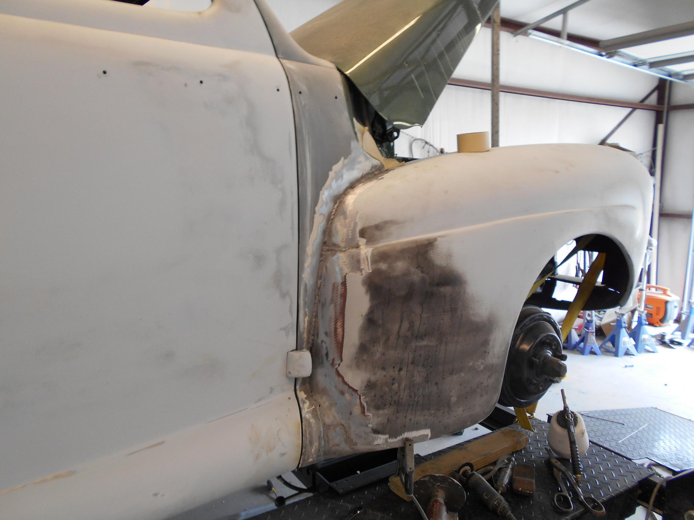

    The front end wont be coming off any more.

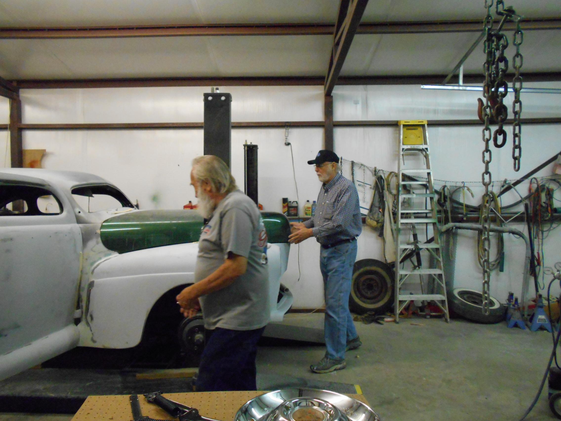

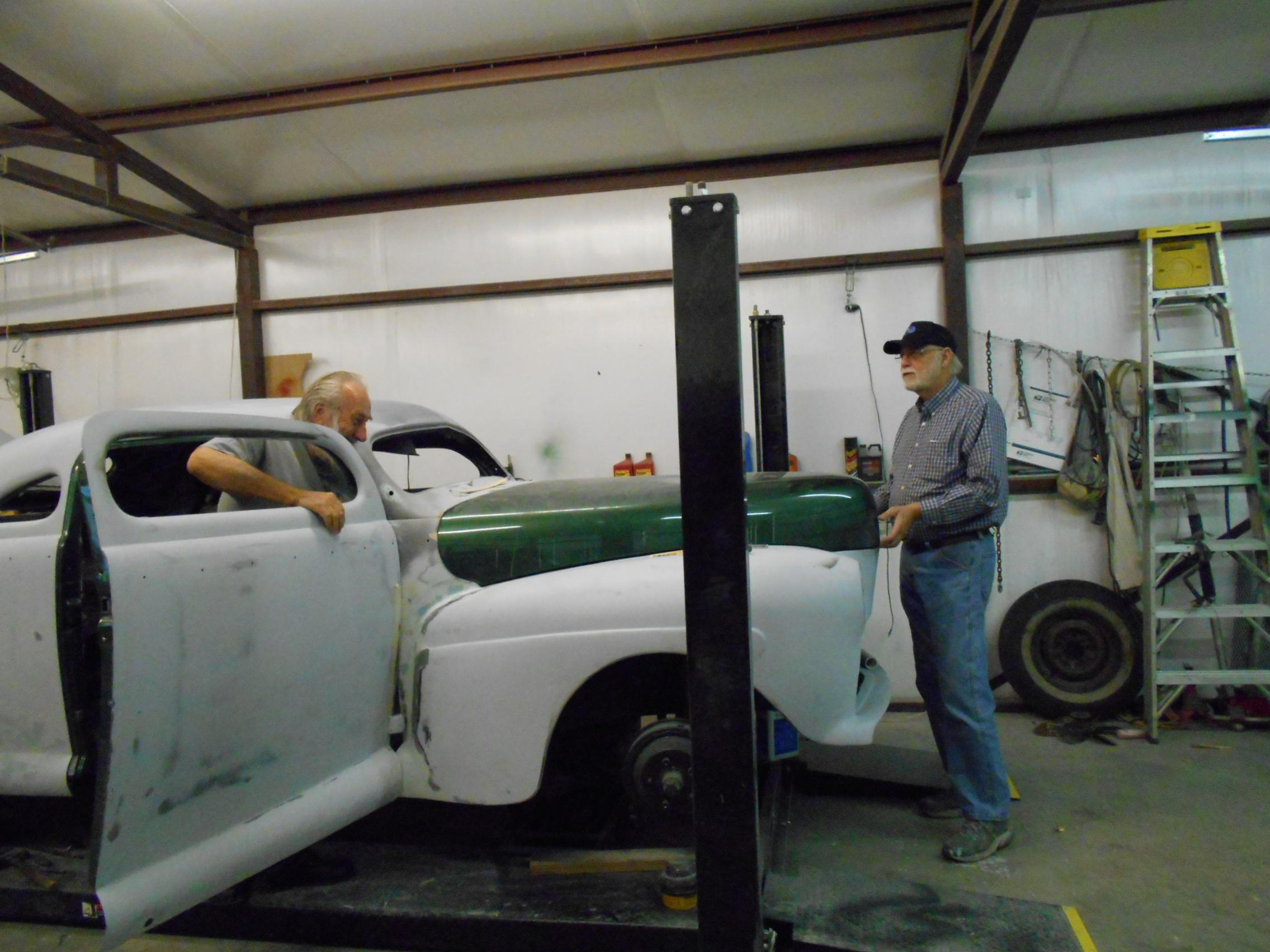

    I did all my fitting of the nose with the hood sitting on the cowl in the correct position. When it came time to bolt the hood to the hinges I had a completely different situation. Check out post and you'll see what is called a cowl kiss, not a good thing. What a night mare. To many adjustments on those hinges. I was lost. I actually joined the Early Ford V8 club looking for help.
    I thought this was going to be the little sister of unintended setbacks (#2). I spent a week doing other things while I brooded over this. I need all the (final) primer on everything before it goes to the electrician. I finally realized that my friend Bill Dyson (48Ragtop) has been around these cars all his life. He just lives about 30 mins down the road.
    To shorten this up, Bill and his wife came up to visit and we spent about 4 hours getting the hood/cowl/fenders close enough to where I can finish it. Our problem was solved when we finally realized that the hood needed to be closed as much as possible when we made an adjustment. The upward movement would change everything.
    THANKS BILL, YOU'RE A LIFE SAVER

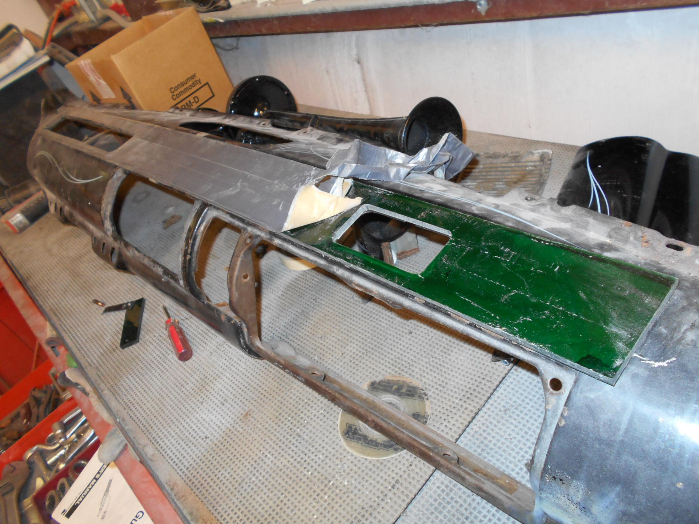

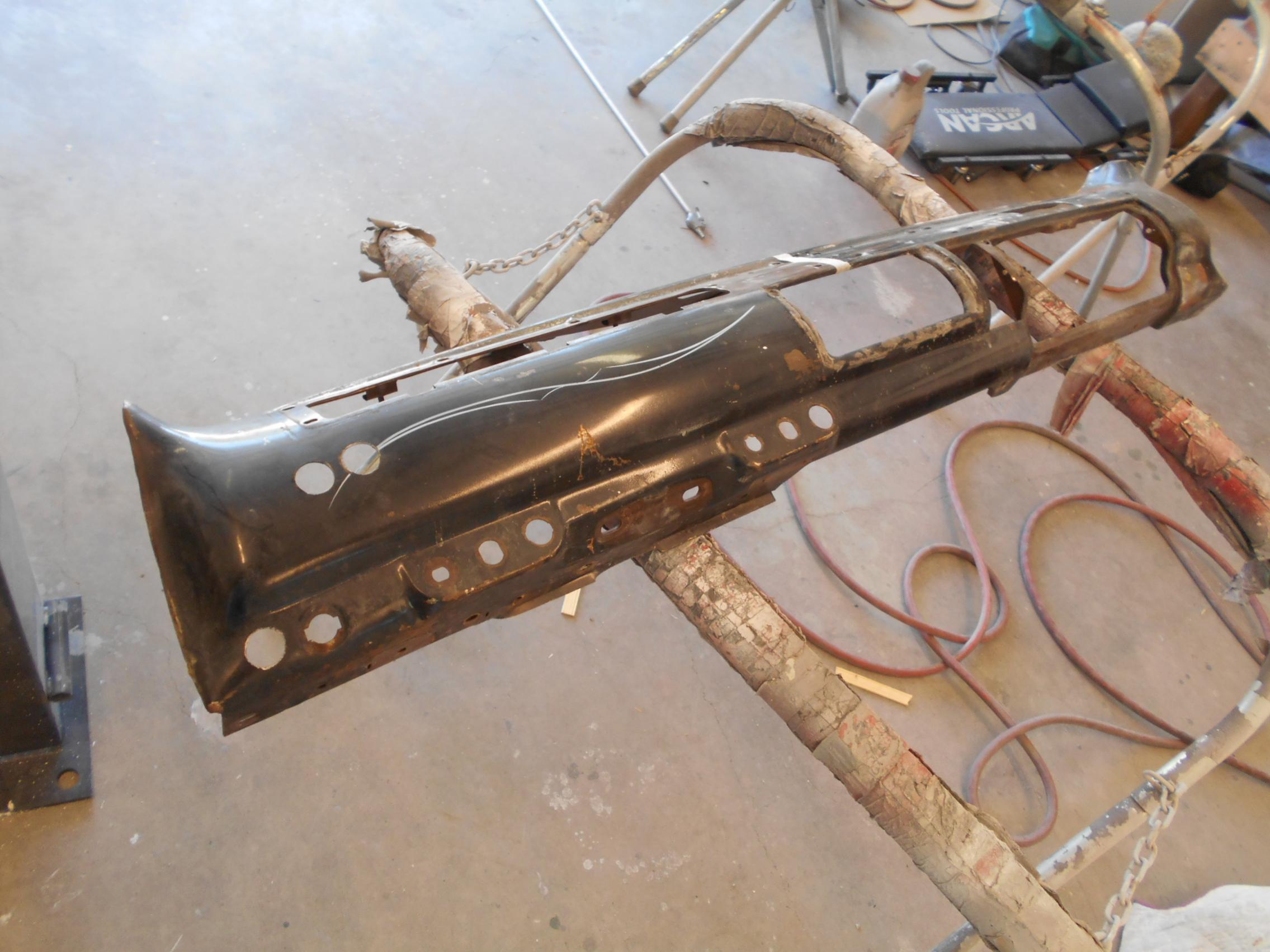

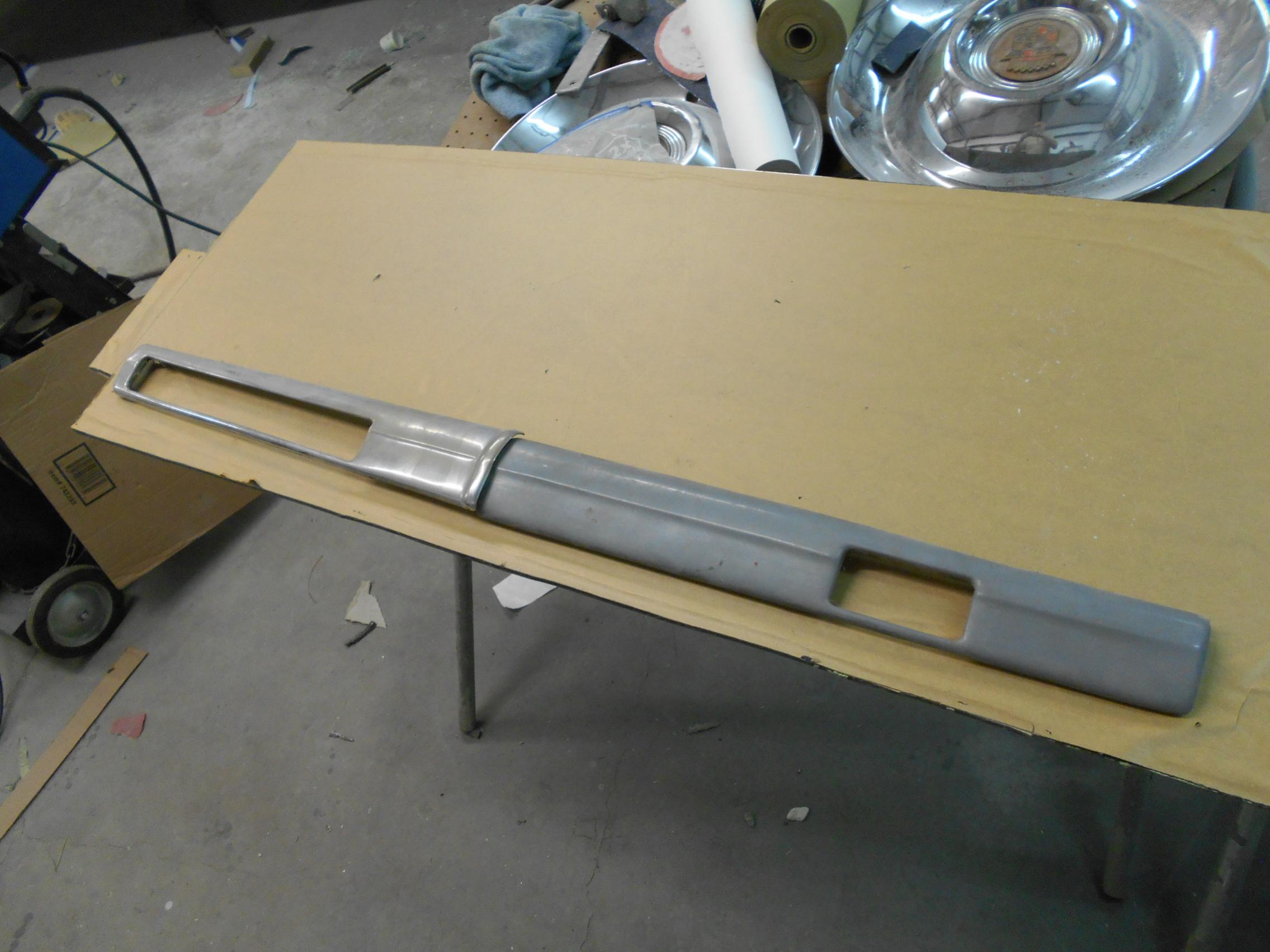

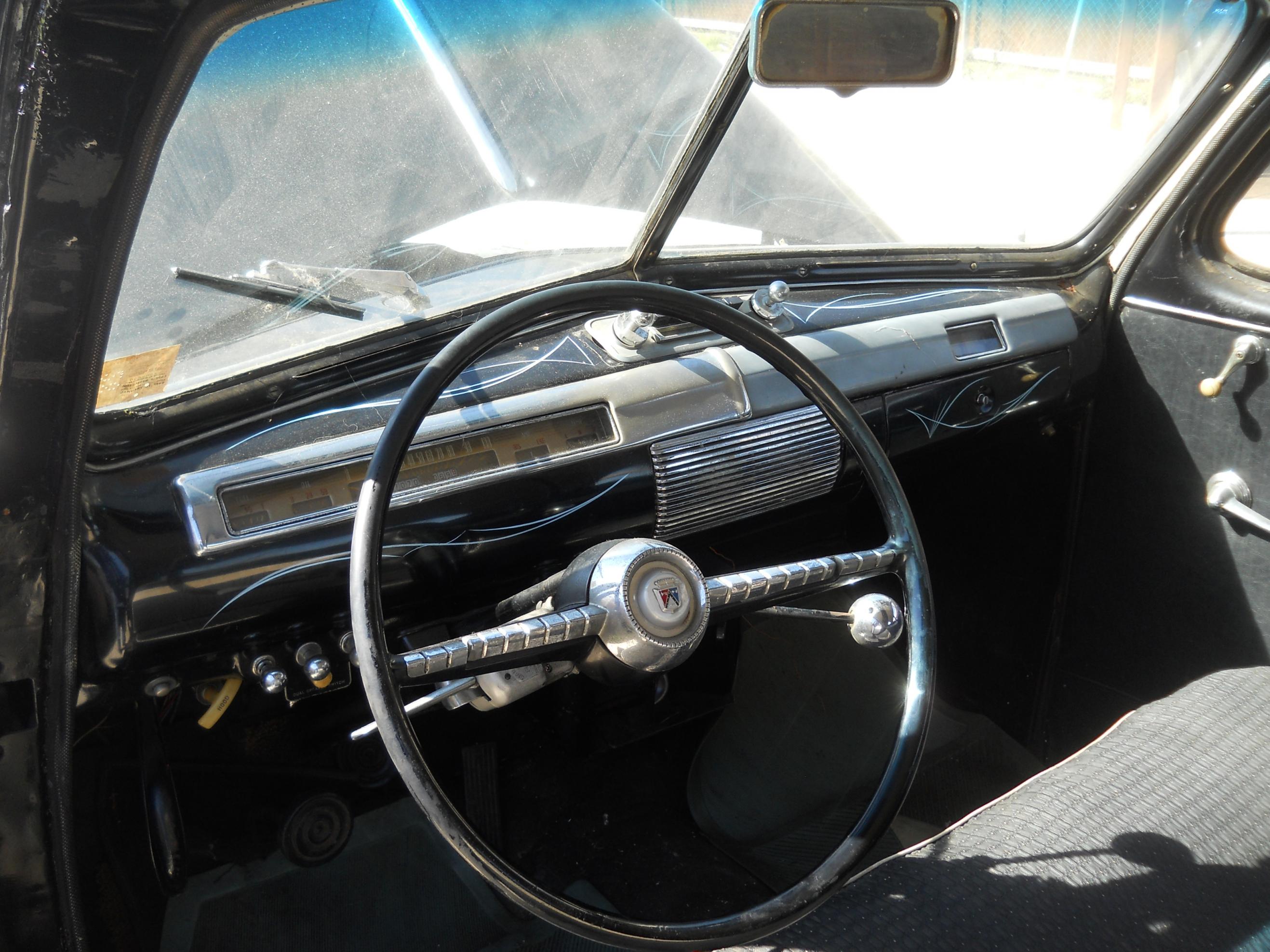

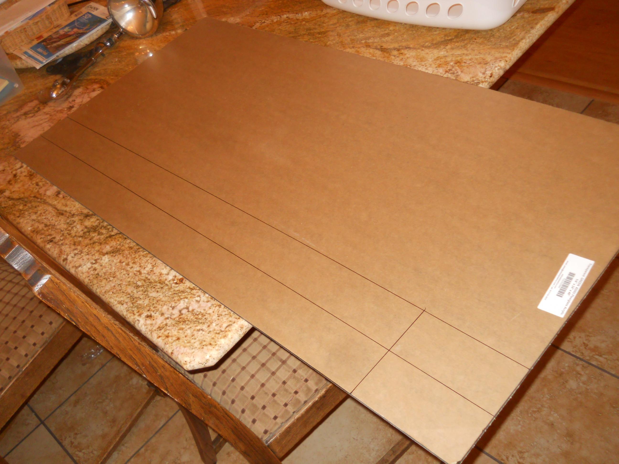

    If I'm going to send the car to the electrician with the final body work in primer, then the dash has to be dealt with also.
    The first pic shows where we start. The second, the destination.

    [​IMG] [​IMG]
    :)These pictures take me back to 1955. My 41 Ford had a soybean plastic bezel across the dash accenting the gages and clock. I spent a Saturday at ''United Auto Parts'' removing a diecast metal one. The parts guy must have recognized me as a new-future customer for he told me to just take it with me, when I told him I was going to have it chromed. I had it chromed at Franke Plating Works, which today is a 3rd generation business in the same location. The cost for plating and polishing was $9.00. That was a weeks pay for delivering the evening news paper to my 100 customers. It looked so cool.:cool::cool::D

    The first step in the dash operation is the dash removal. I used to be intimidated by this but, because of the need to rewire it becomes easy.

    Aside from the chrome dash, the big hilite is the plastic work.There are just a few greens available. I asked Jesse "is it the one that looks like Jello?", he said yes. I have since sent him a piece to be sure. I'm going to use those bezels for a pattern.

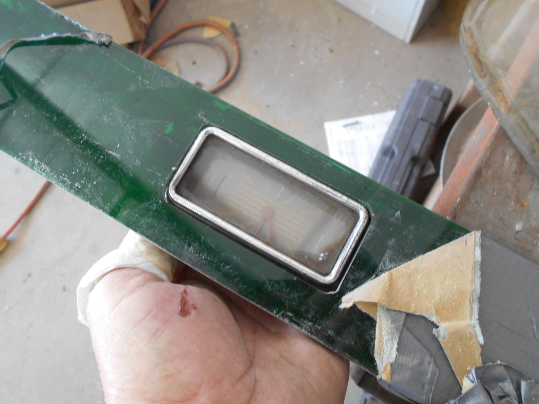

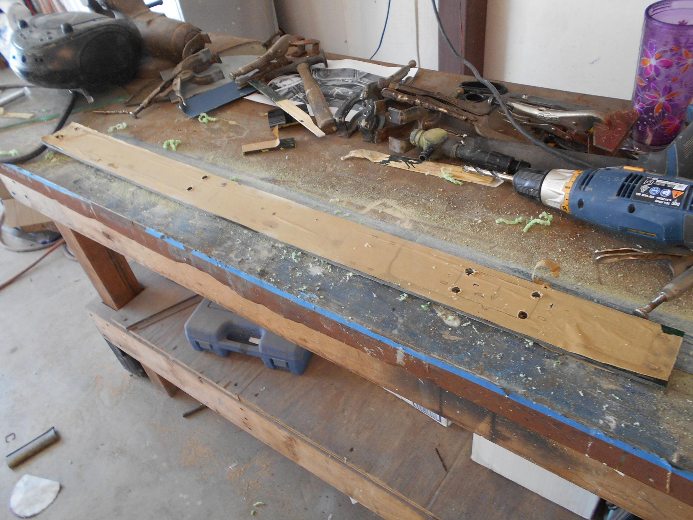

    As I've mentioned before, for the most part, these things that I have to do I've not done before. I have a lifetime of studying them and being impressed and intimidated by them. So to say that the thinking part of this takes waaaay more time than the doing part is the understatement of the year. Sometimes I'll start something and then put it aside for awhile, while I ****ysis the situation.
    I'd done a small amount of plastic work in the 60's doing some tail light lens stuff on my '55 Chev truck. Then there was the back up light lens deal on Jr's car, but this plastic work that Jesse did on his interior falls into the intimidating category for sure. Do I jump off the cliff just to see if I can fly? I think in this case it's just one part of the whole picture that gets obscured until you finally get to it. How do I get myself into these deals? Ha, I'm claimin' I was pushed. There, that releases me from some degree of responsibilty however, I still have to do it.
    This bezel has to be very carefully cut out of the panel so that the lines are straight. Those lines have got to go from straight to straight/rounded with nice rounded corners. The long thin piece below the instrument cluster looks awful fragile to me. It's real breakable when it comes time to polish everything with a powerful buffer. The only thing I have going for me is this plastic sheet. I have might have 25 pieces in it.

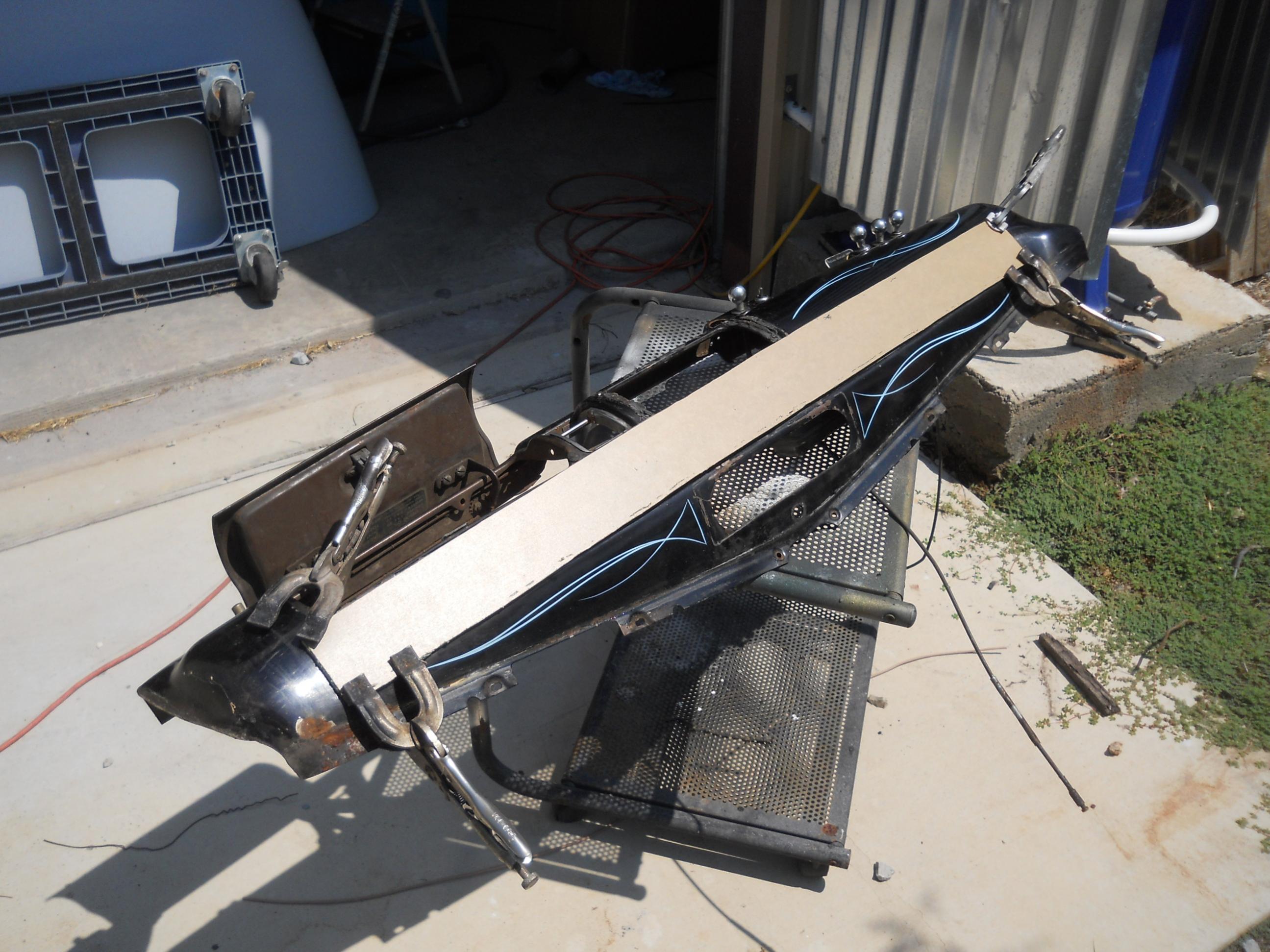

  26. jivin jer
    Joined: Sep 14, 2008
    Posts: 3,535
    jivin jer
    Trying to see what its gonna' take to get the correct contour.

    A heat strip, a copper wire with a battery charger hooked up to both ends will get the copper wire hot. The copper wire should be the length of the final piece. Find a piece of pipe with the diameter you need to bend the green acrylic over.

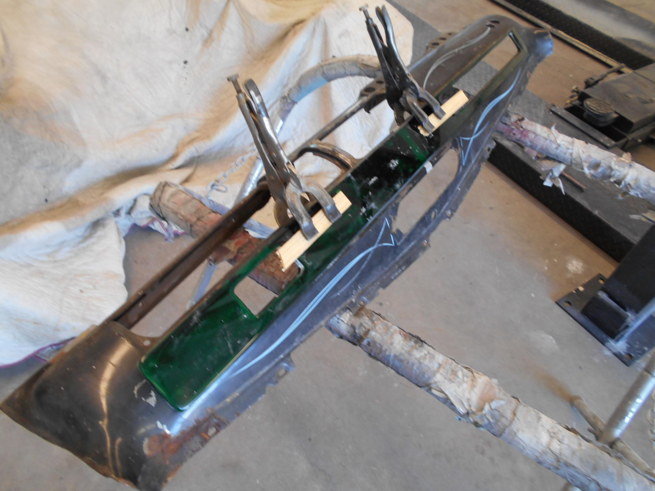

  29. jivin jer
    Posts: 3,535
    jivin jer
    More clamping (after shaping) to a hot dash in the Texas sun.
