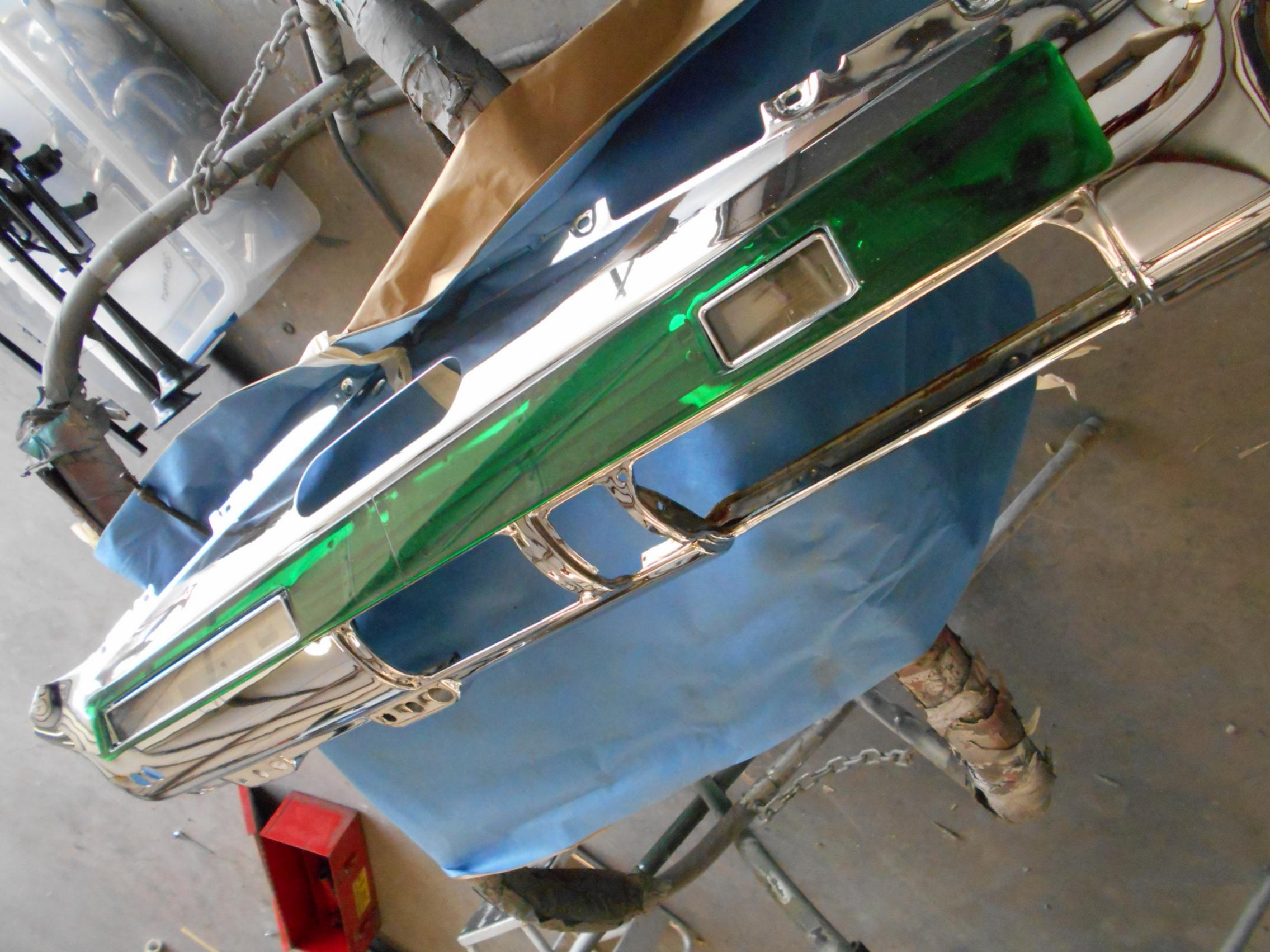

    This is the first batch of chrome back from the platers, probably 75%.
  2. As soon as you start showing pics of that stuff unwrapped I'm going to start crying. I only dream about nice shiny chrome.

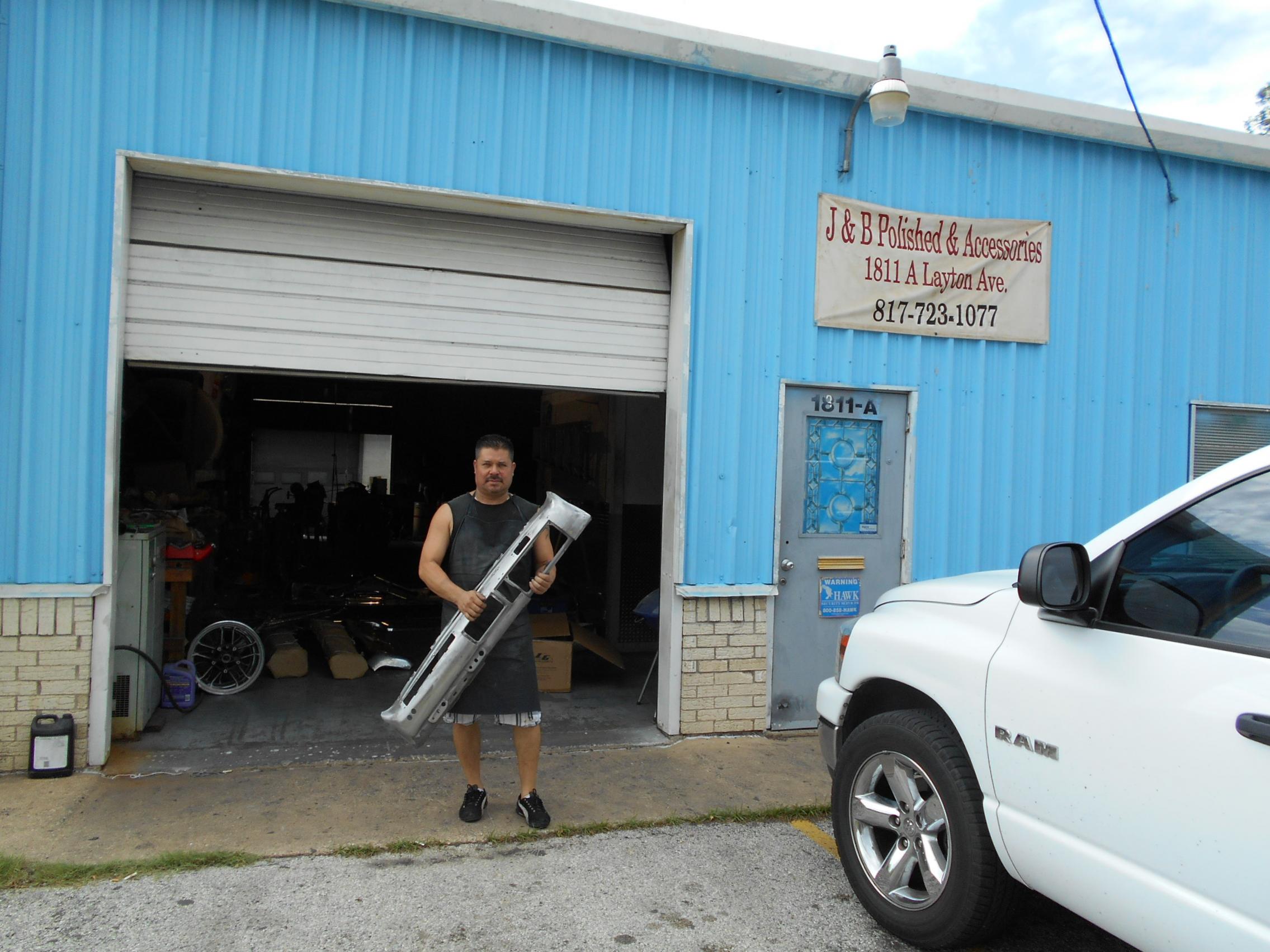

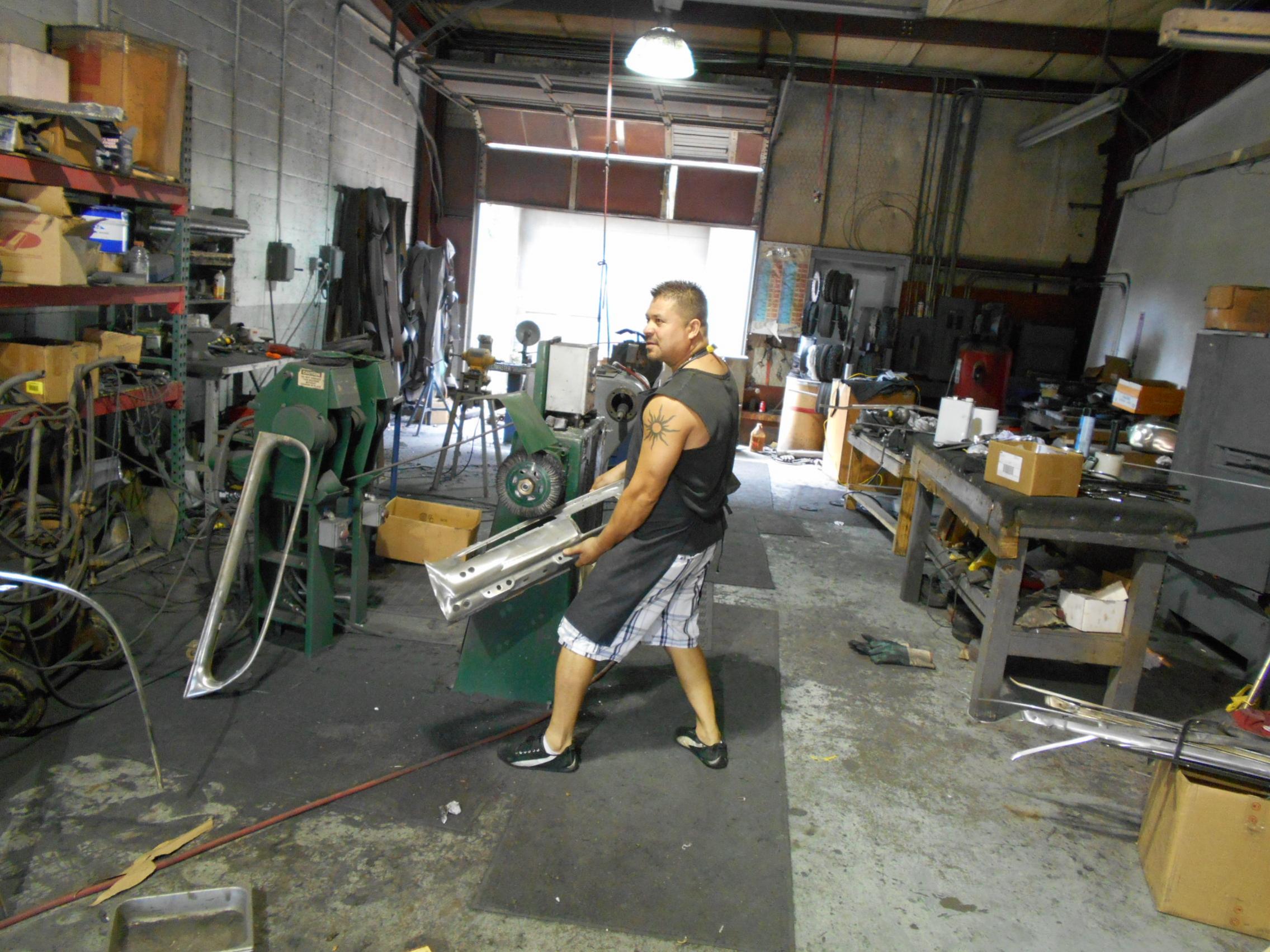

    This is Jesse of J-B Polish and Chrome. He's a poser and a lot of fun.

    Jesse and Bernie are hard working guy's. They do all the prep work and have a deal with a big chrome shop that's out of the area that does the plating. They have done a very good job for me. I've just had a couple pieces that needed a little more prep work (after they were plated). They said "no problem" and redid them.
    They've just gotten a big account at a BIG custom shop that's local by saying that they do pot metal. I do have some pieces for another build (maybe) that are really bad. They said let us look at them, you'd be surprised what we can do.
    I like these guys. They don't put on "airs". I can work with them to get what I want. Prices are friendly. Tell em' Jerry sent you.
  9. Whoa, that looks amazing.

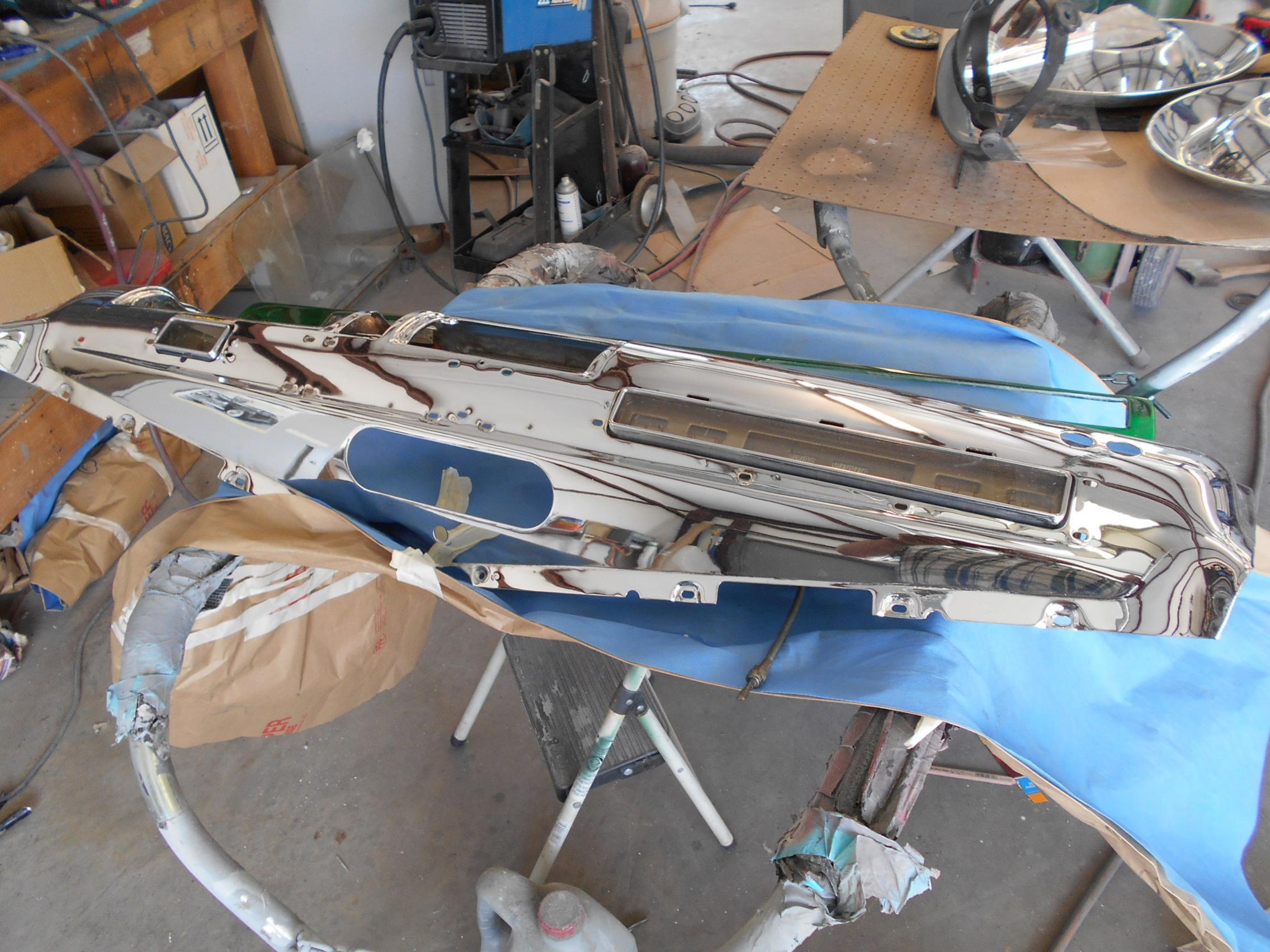

  10. banditomerc
    Joined: Dec 18, 2005
    Posts: 2,521
    banditomerc
    that dash looks sweet Jerry....
  11. Torchie
    Joined: Apr 17, 2011
    Posts: 1,099
    Torchie
    Wow is right.
    That dash is going to be blinding.

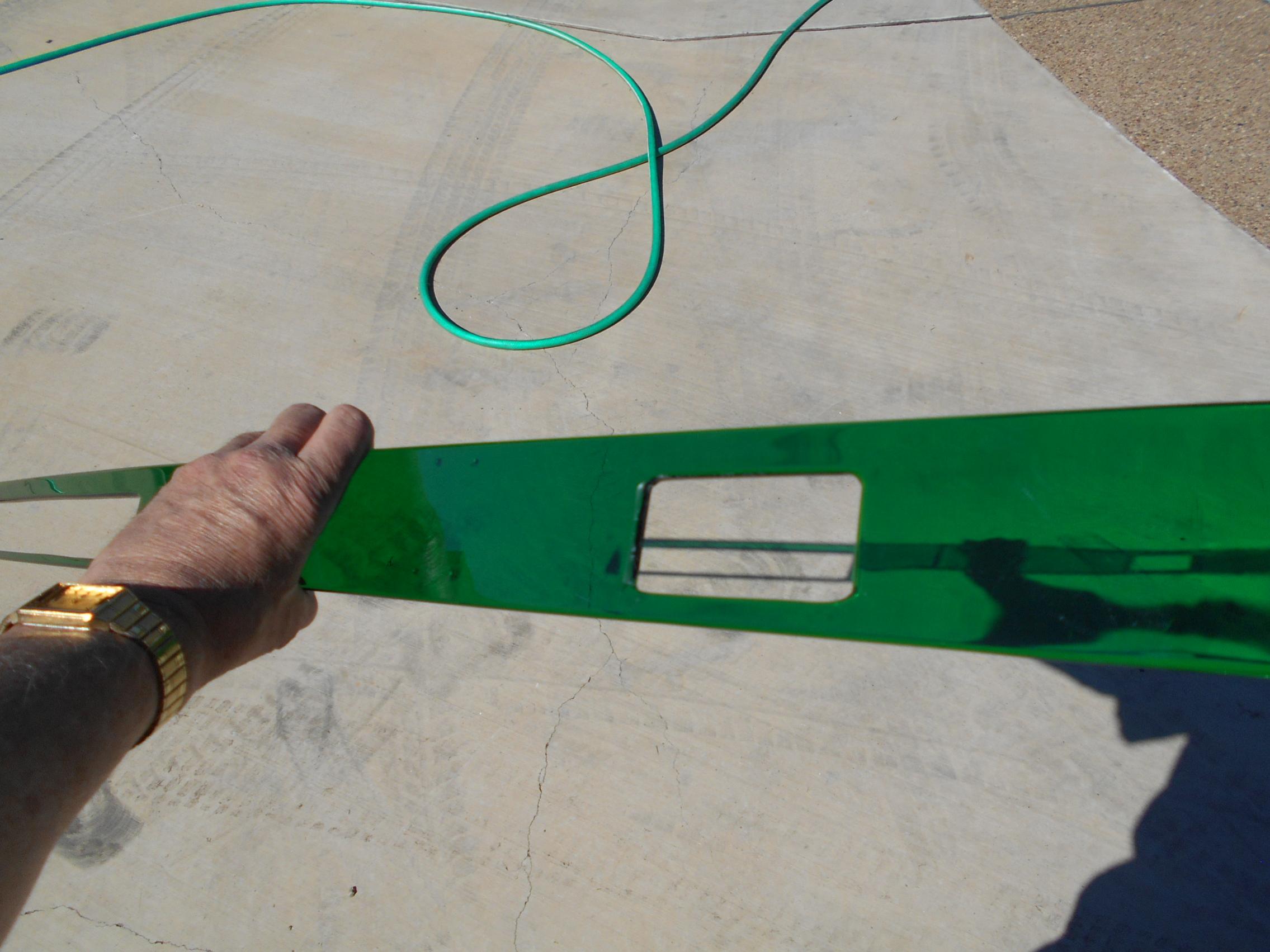

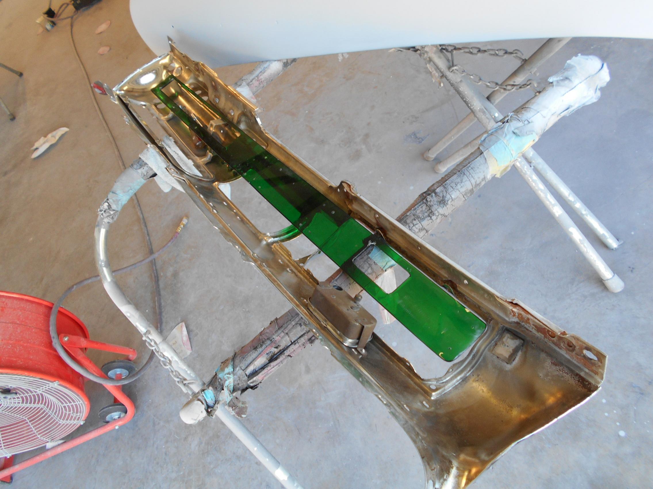

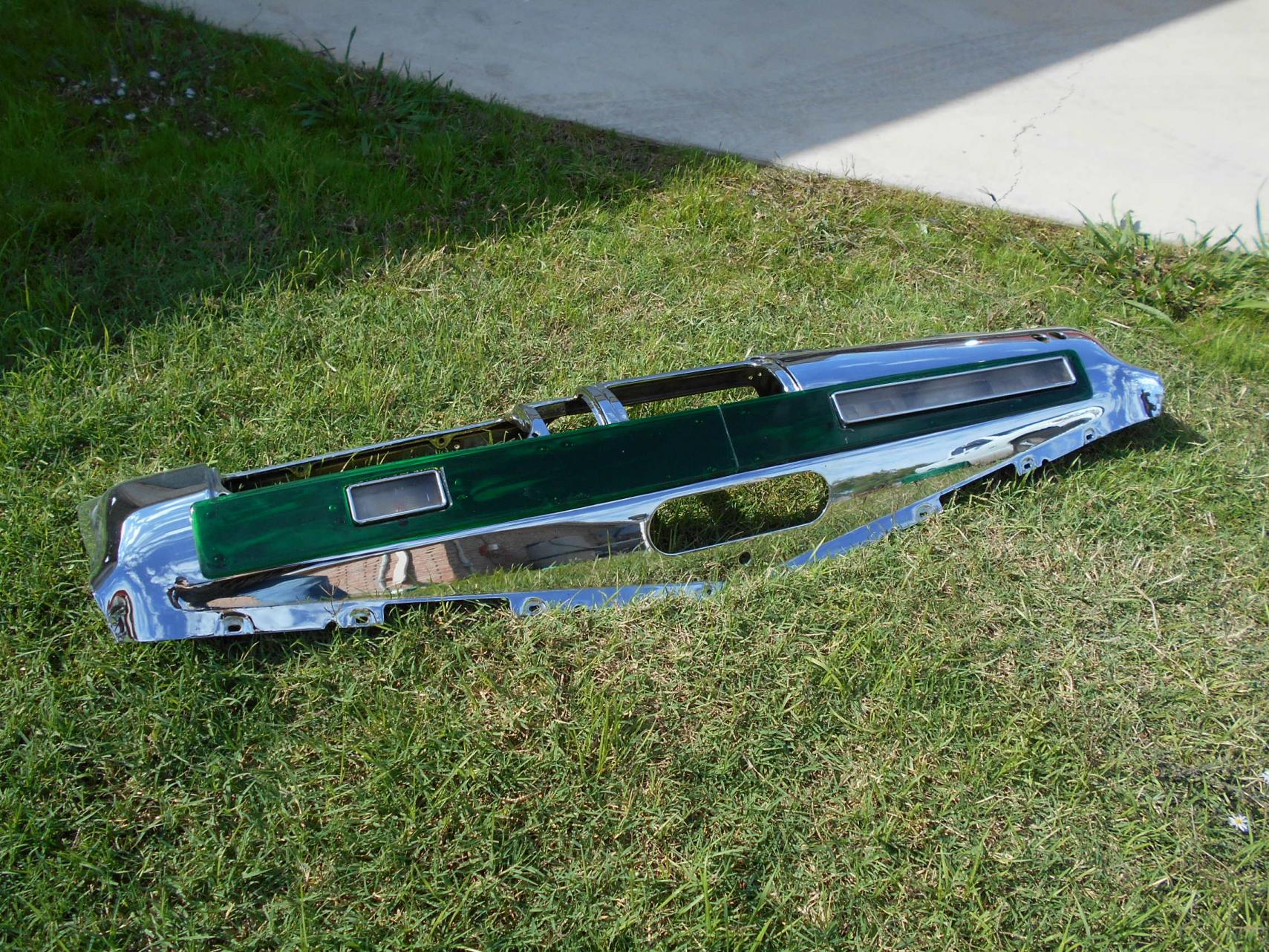

    Ready to be installed. After a couple of failed attempts at getting this shaped to the contour of the dash I got mad. Using the rosebud attachment to my oxy/acetylene welder, I carefully got it REAL hot. It did resist going molten and I was able to gently push the ends to fit and when it cooled it kept that shape. This is the original piece.

  13. Sledge
    Joined: Feb 5, 2008
    Posts: 1,733
    Sledge
    from Nor Cal
    nice! I wonder if a heat gun would have worked?
  14. J.B.
    Joined: Jan 7, 2005
    Posts: 1,250
    J.B.
    from Sweden
    I used a heat gun to form my rear tallights in the bumper guards. Had to be careful not to come to close or overheat. Then the plastic bubbled. But it was a great tool for it.

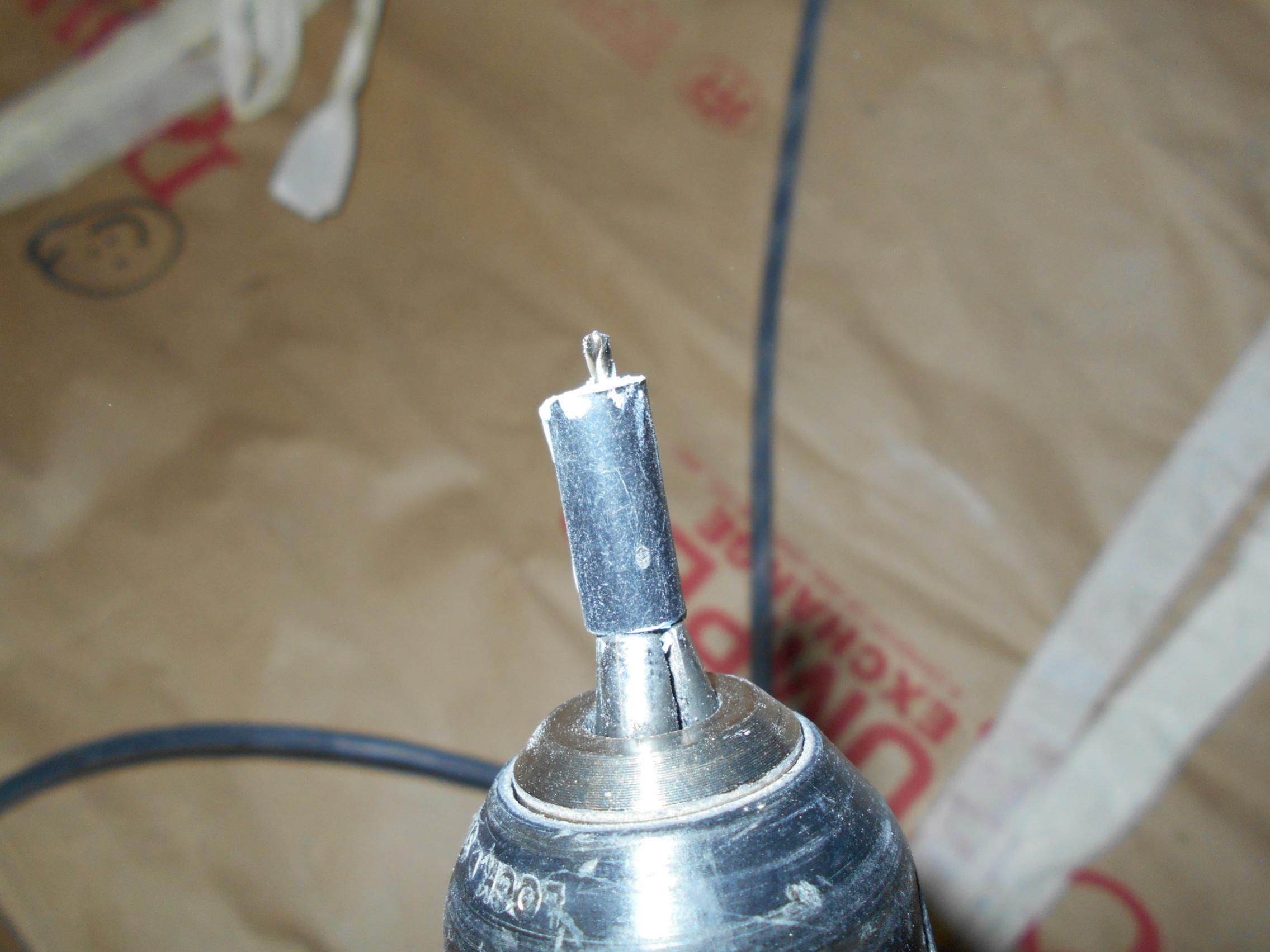

    Jesse told me that he screwed that plastic bezel on with tiny screws. I wanted to glue it on with clear double back tape. The more I thought about it, I figured out a way to do it Jesse's way. I took a small piece of plastic with a sheet metal fragment with a hole in it down to Ace hdwe. I found the screws that would work. I made a low tech drill stop to protect the bezel and I was able to get it attached Jesse's way. WHEW!

    Actually, after looking at that pic, that shows the R side attached with the clear tape (the L side isn't attached). Here's the real pic with the screws.

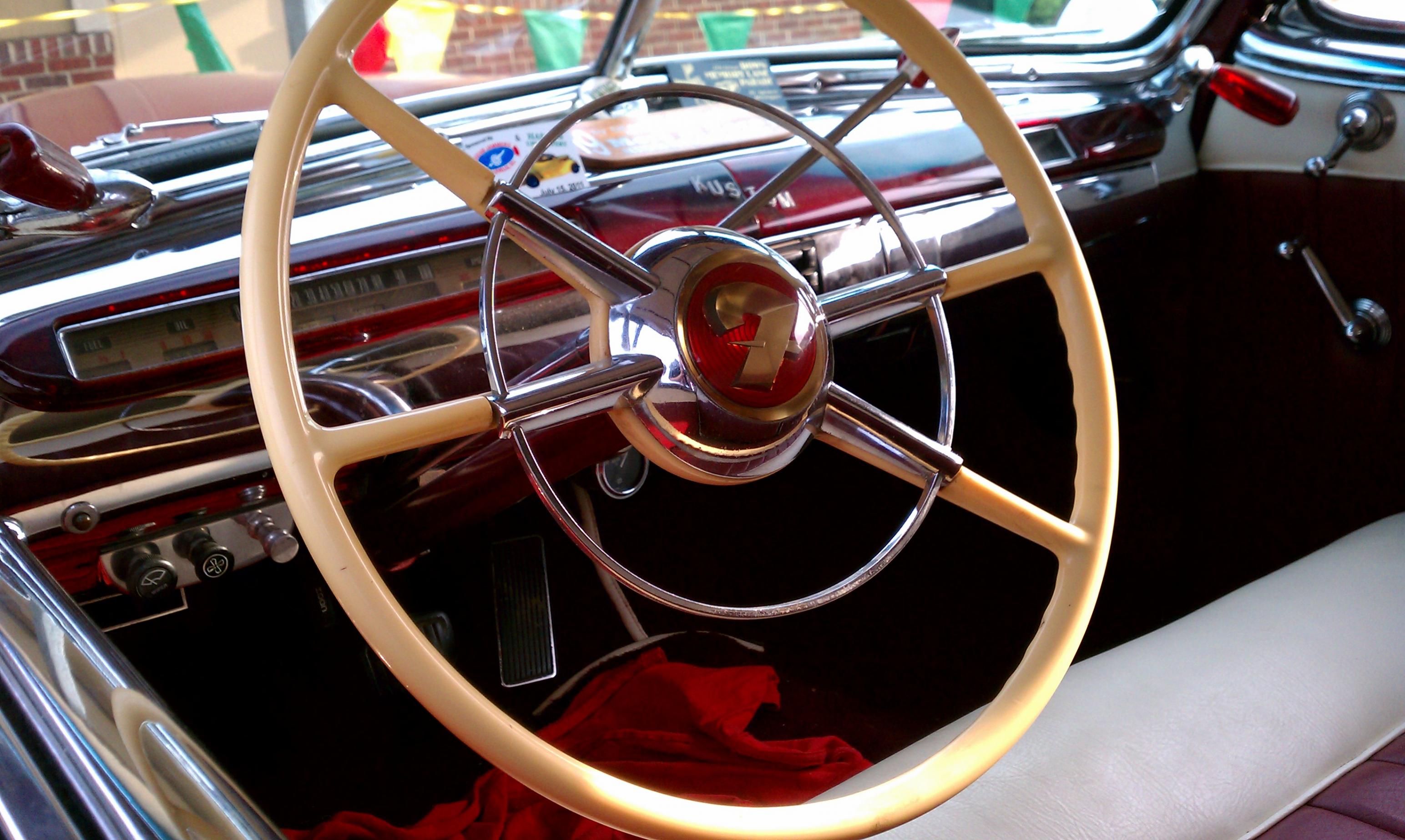

    Rik sent me this pic of the Zaro '41 Ford dashboard. This is when I was struggling with that bezel. It showed that I needed to define that groove that divides the two halves more. I also saw that my Appleton's are in the exact same place's. Zaro's ends are tapered more though. THANKS RIK
