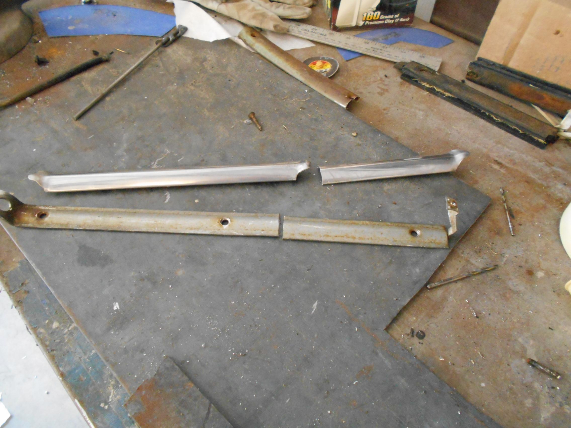

    Thanks everybody. OK, can I think my way through cutting and shaping that outer windshield divider bar so I don't have to weld it? I think I can.

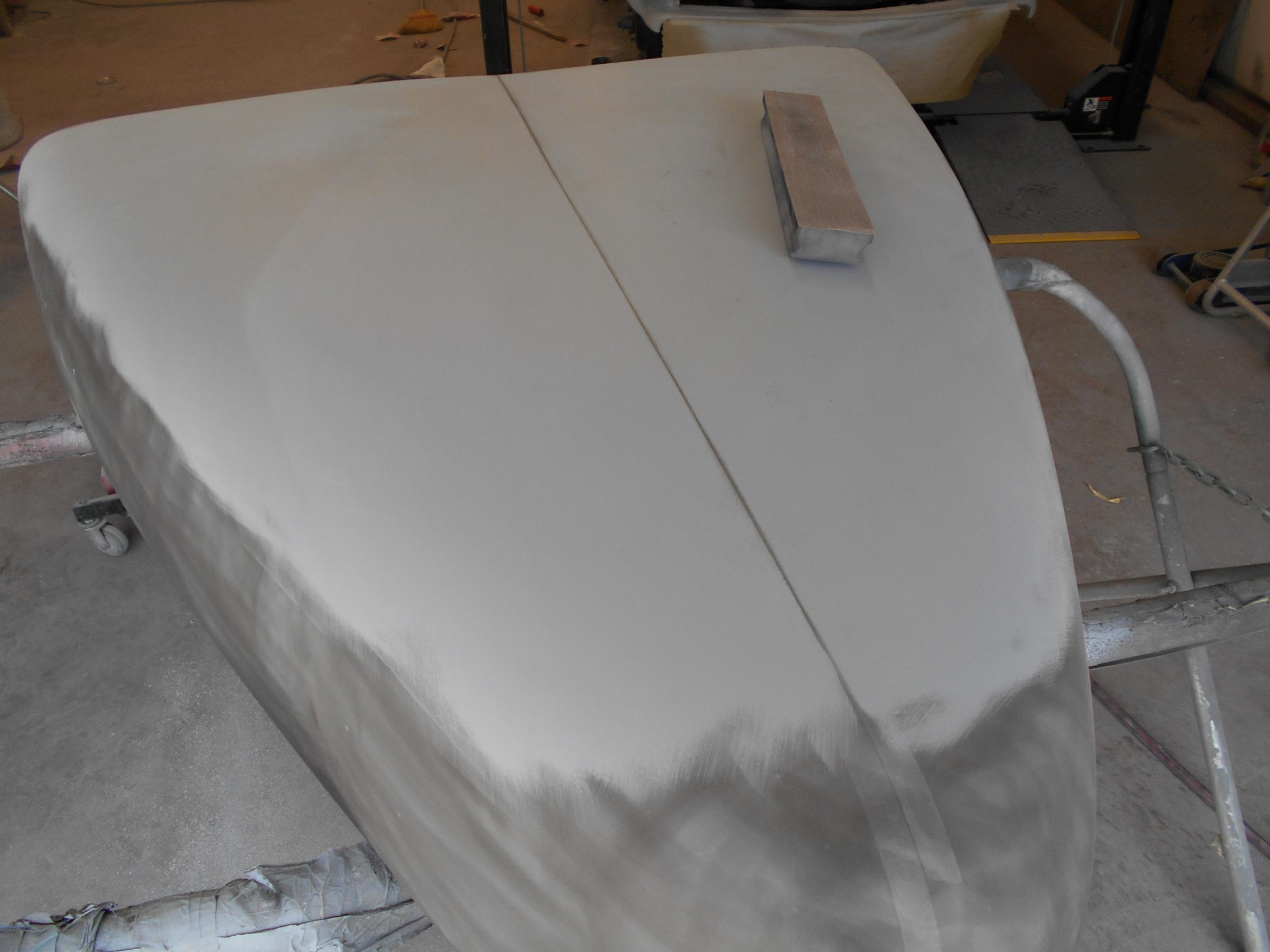

    jivin jer

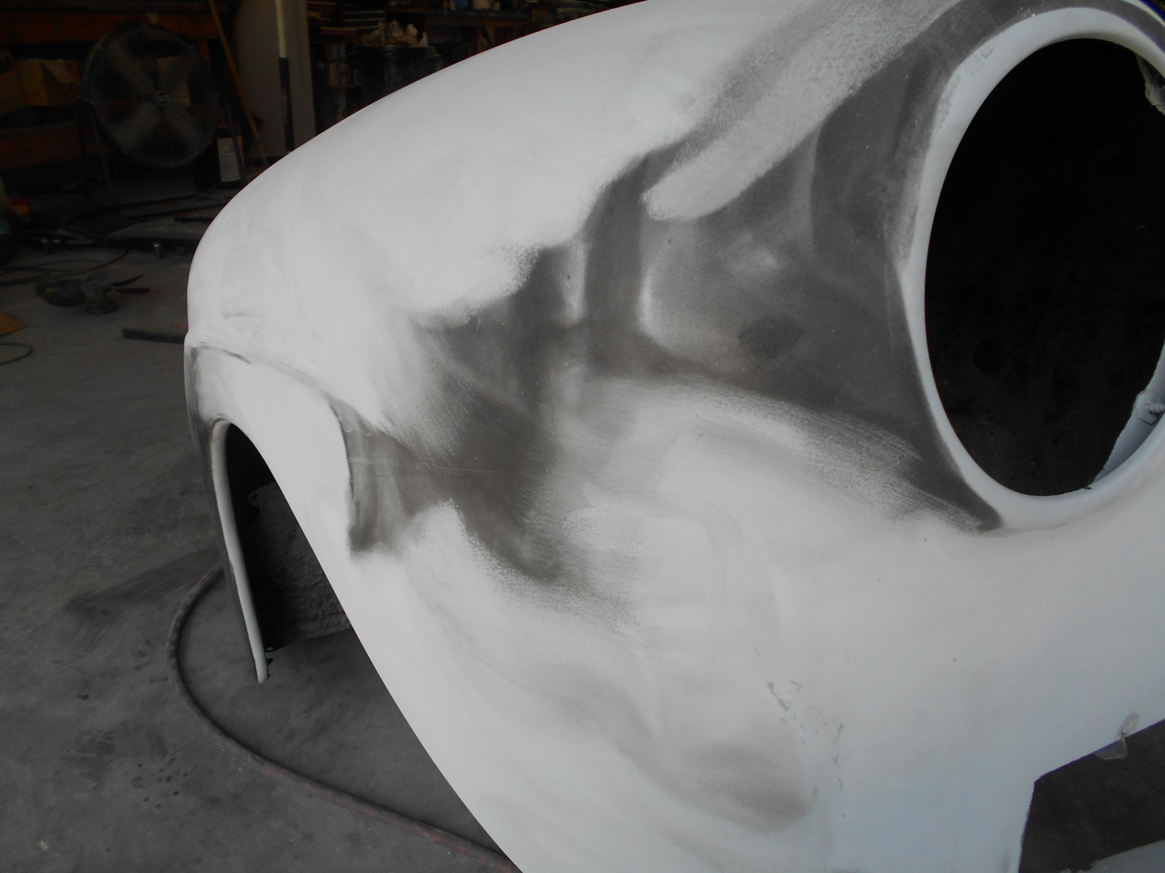

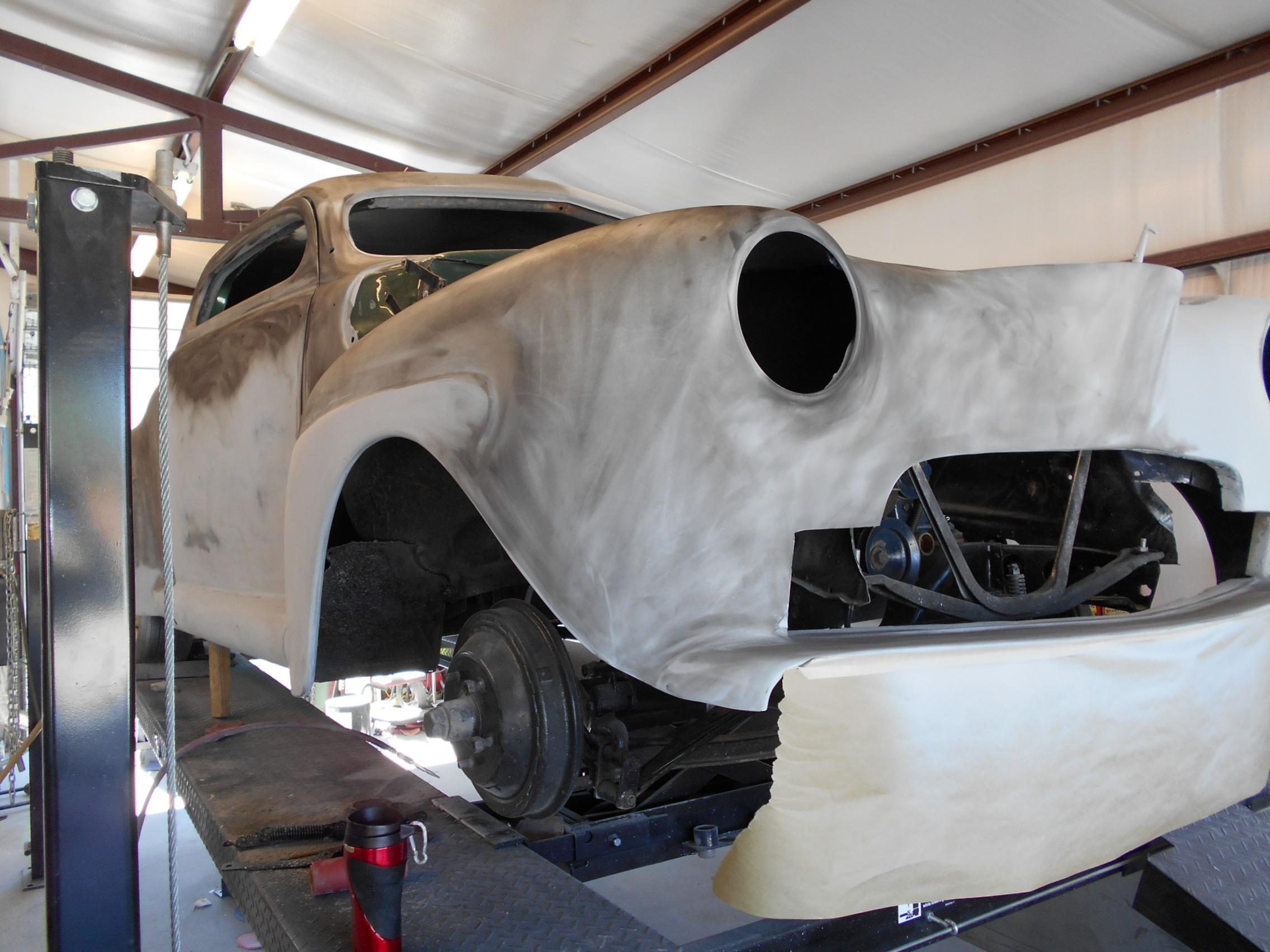

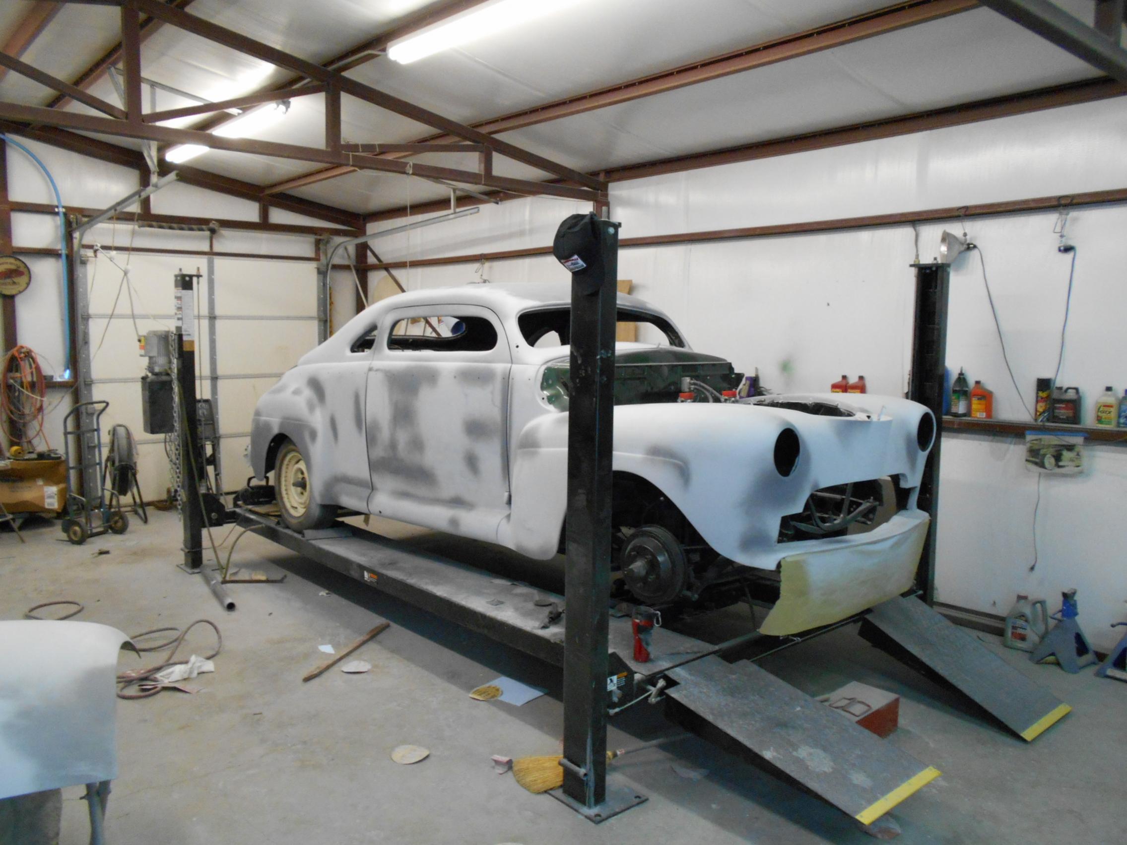

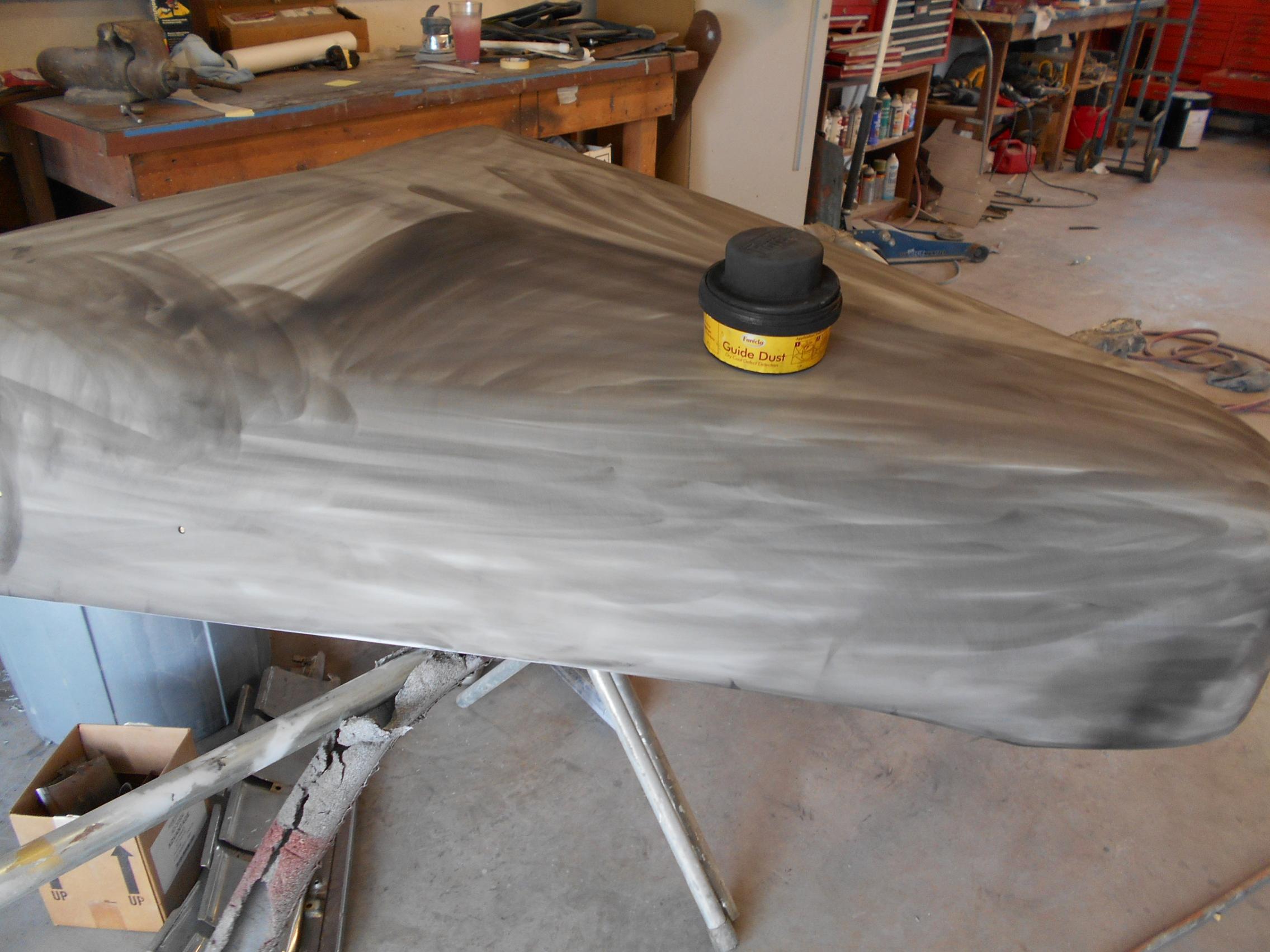

    This is PPG K-36 primer. It's been blocked many times. The spots you see are tinted K-36 on bare metal/filler areas. Final sand is with 600 grit.

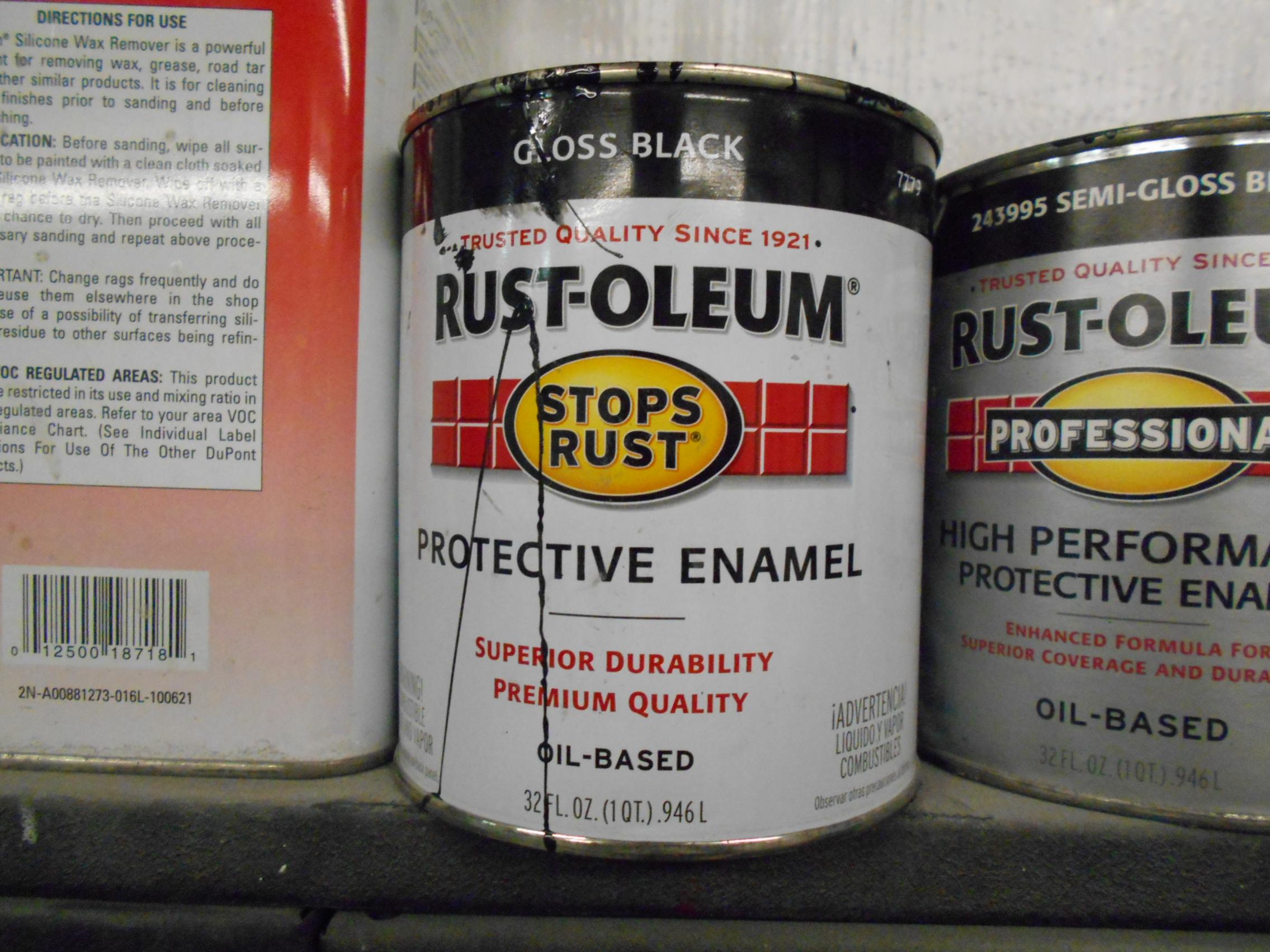

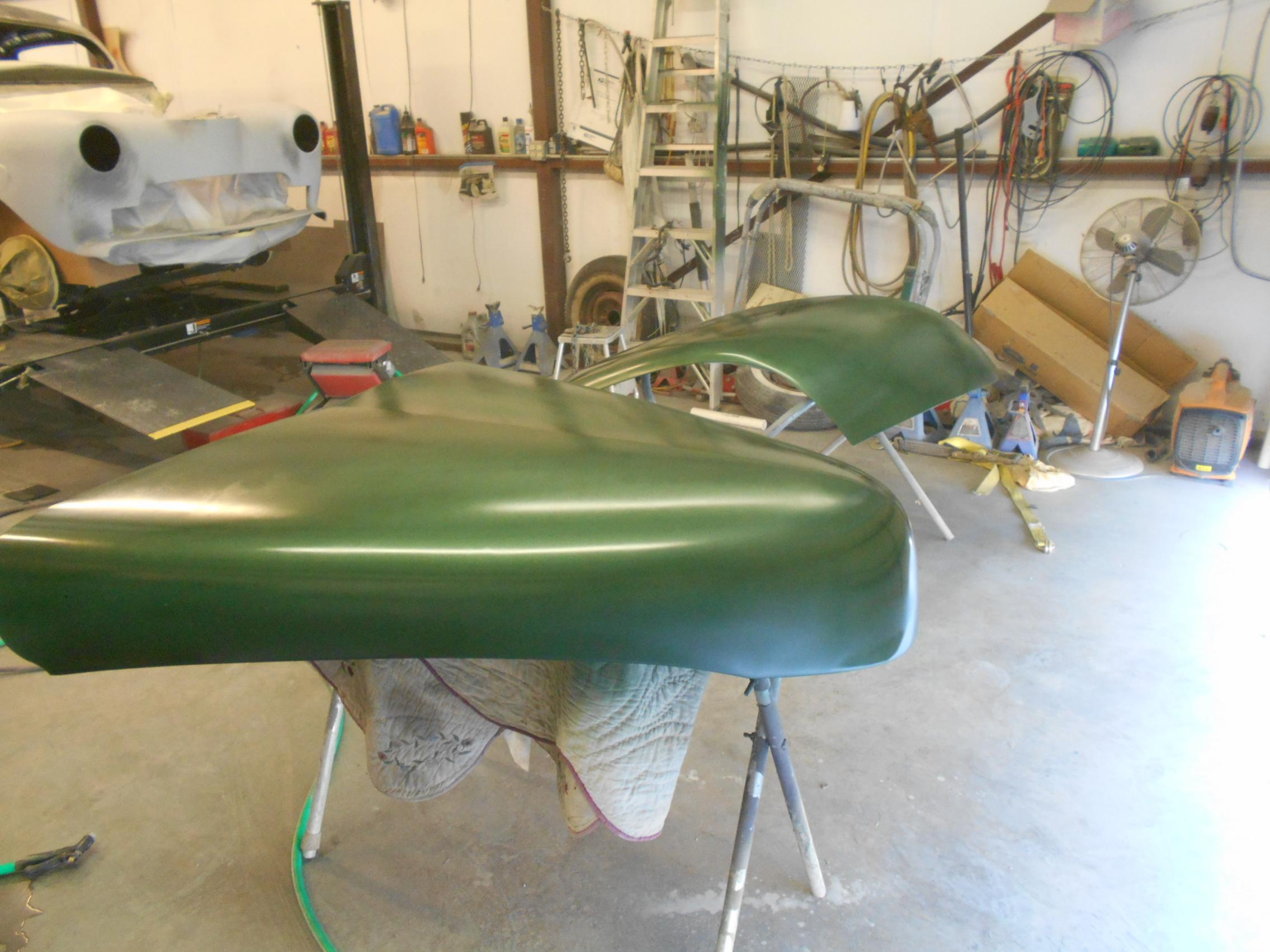

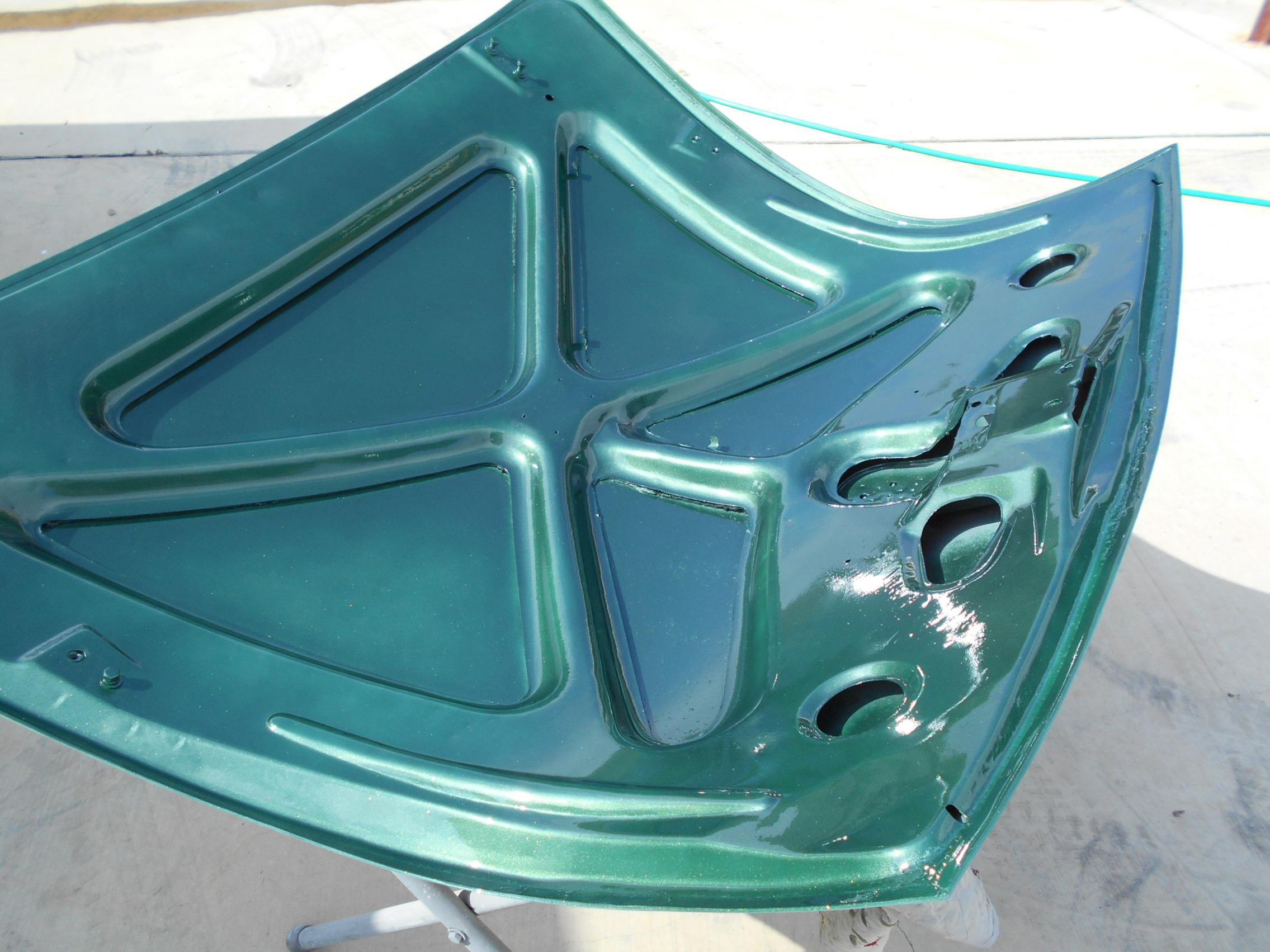

    Using up some of the (surplus) eurethane on the underside of the deck lid. Rustoleum has a product that is a dead on match for Fords underside of hoods, aprons. I call it a "soft" shine.
  9. Jer, did you use the gloss pictured (for the "soft shine"), or the semi-gloss next to it in the pic? I have always heard reference to the semi-gloss as a "ch***is black" sort of semi-gloss finish - so just wanting to be sure..
    Car is looking sensational and this near to colour stage is getting exciting!
    Dave
  10. jivin jer
    Joined: Sep 14, 2008
    Posts: 3,535
    jivin jer
    You think you have checked and double checked every thing.
    It's the white can Dave.

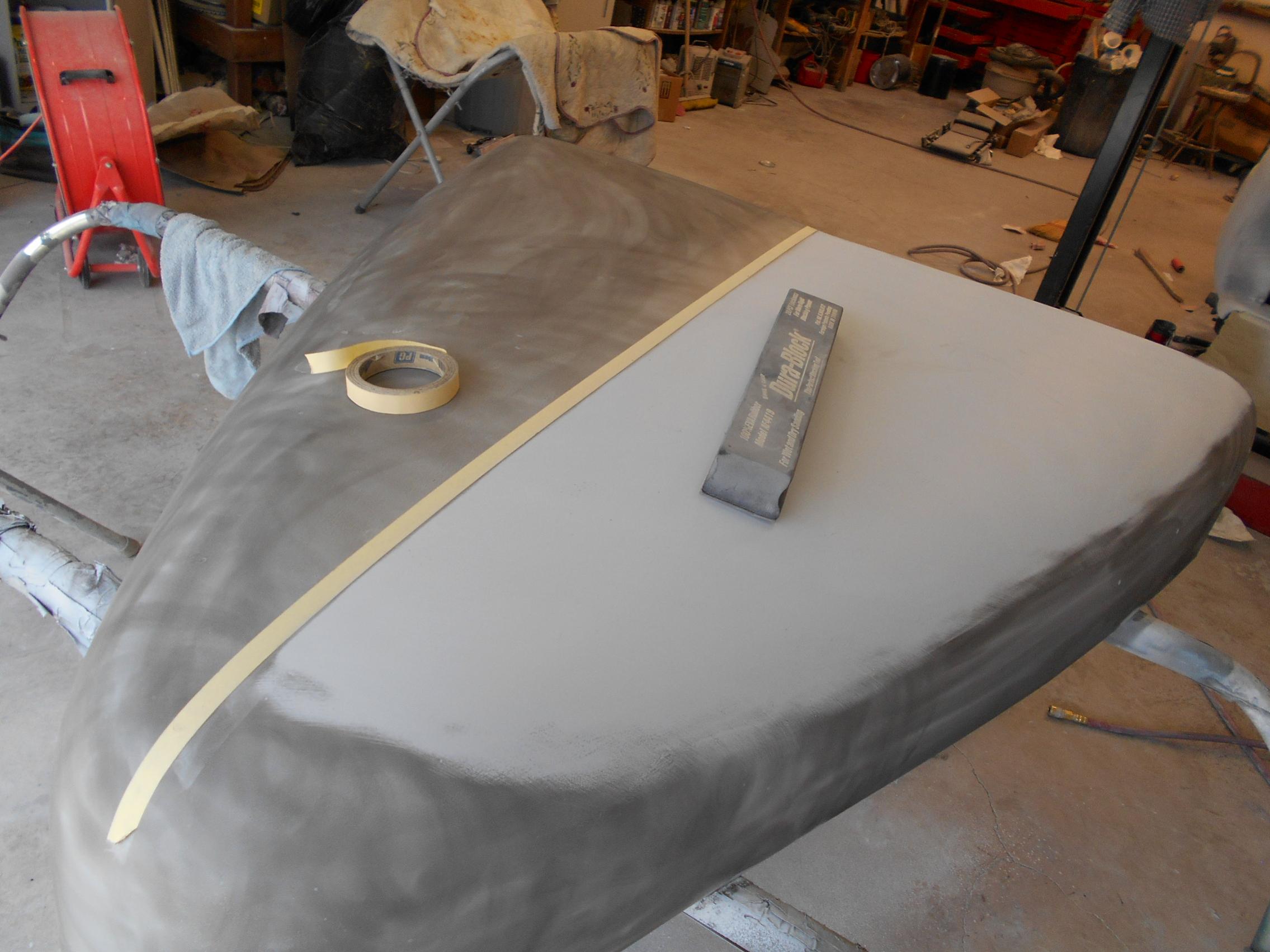

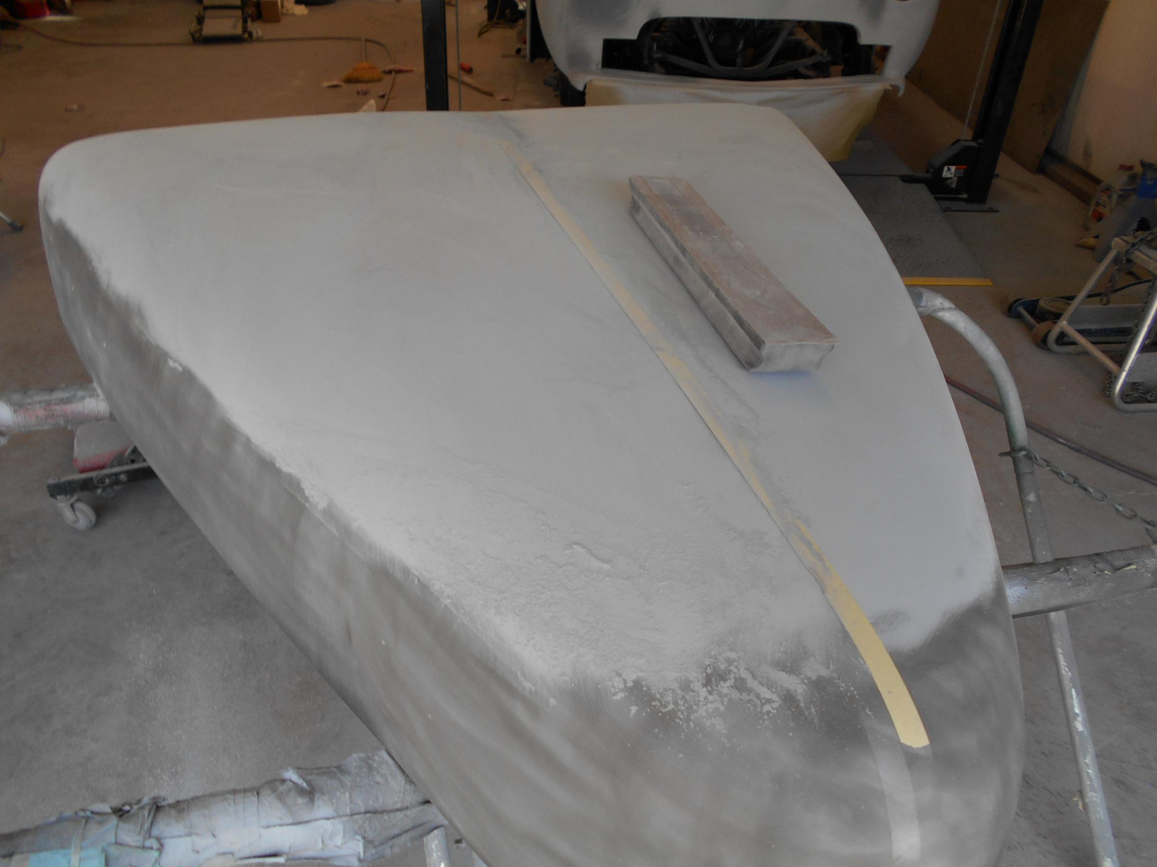

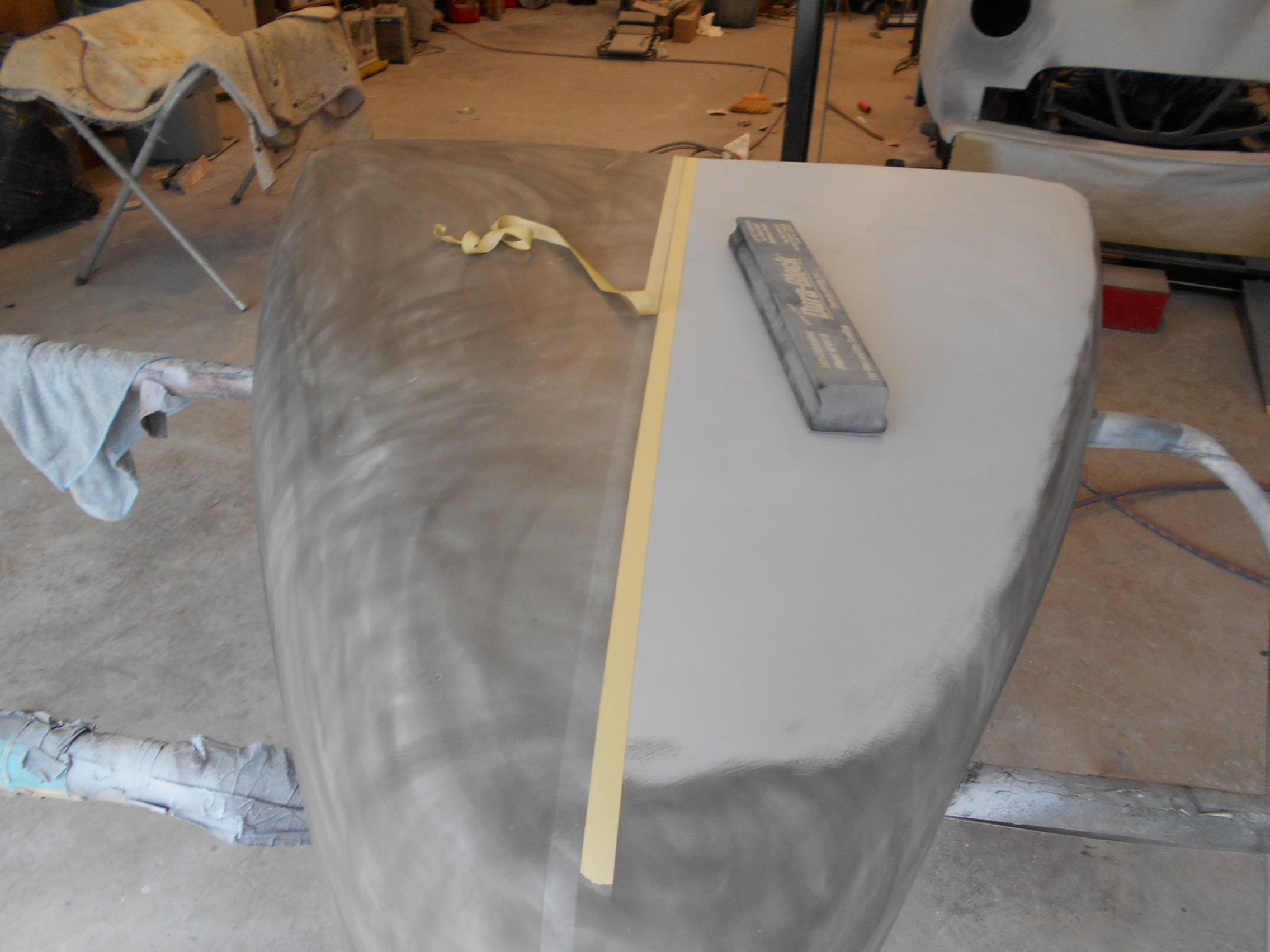

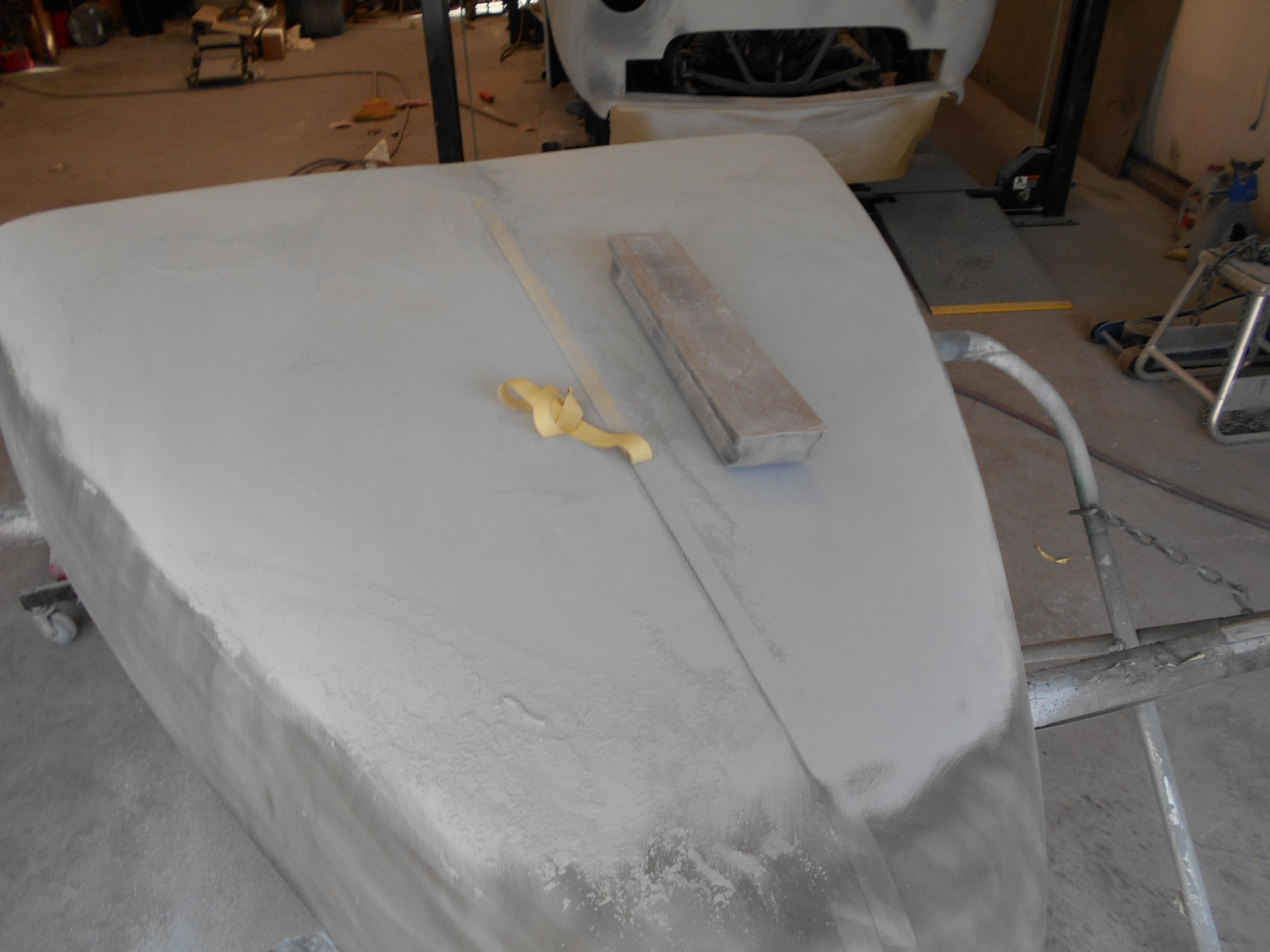

    Awhile back when I was talking about how I get that peak in the hood (using tape) I said I should have shown how that was done. I can do that now. It's pretty self explanatory (a picture is worth a thousand words). This can be done with any body line, anywhere.

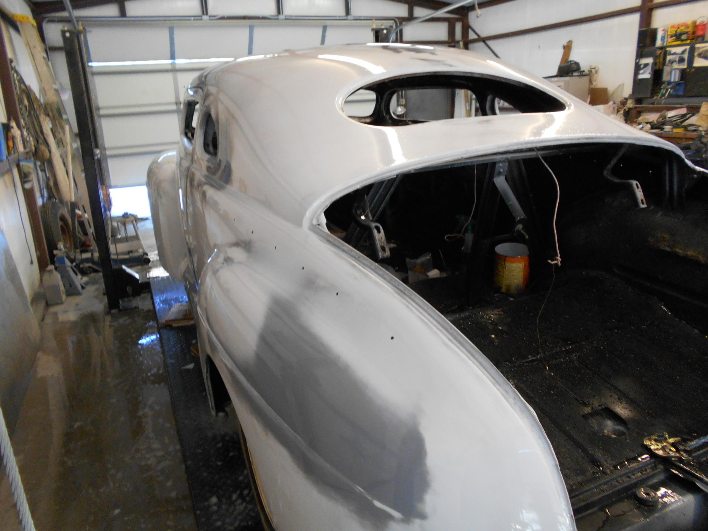

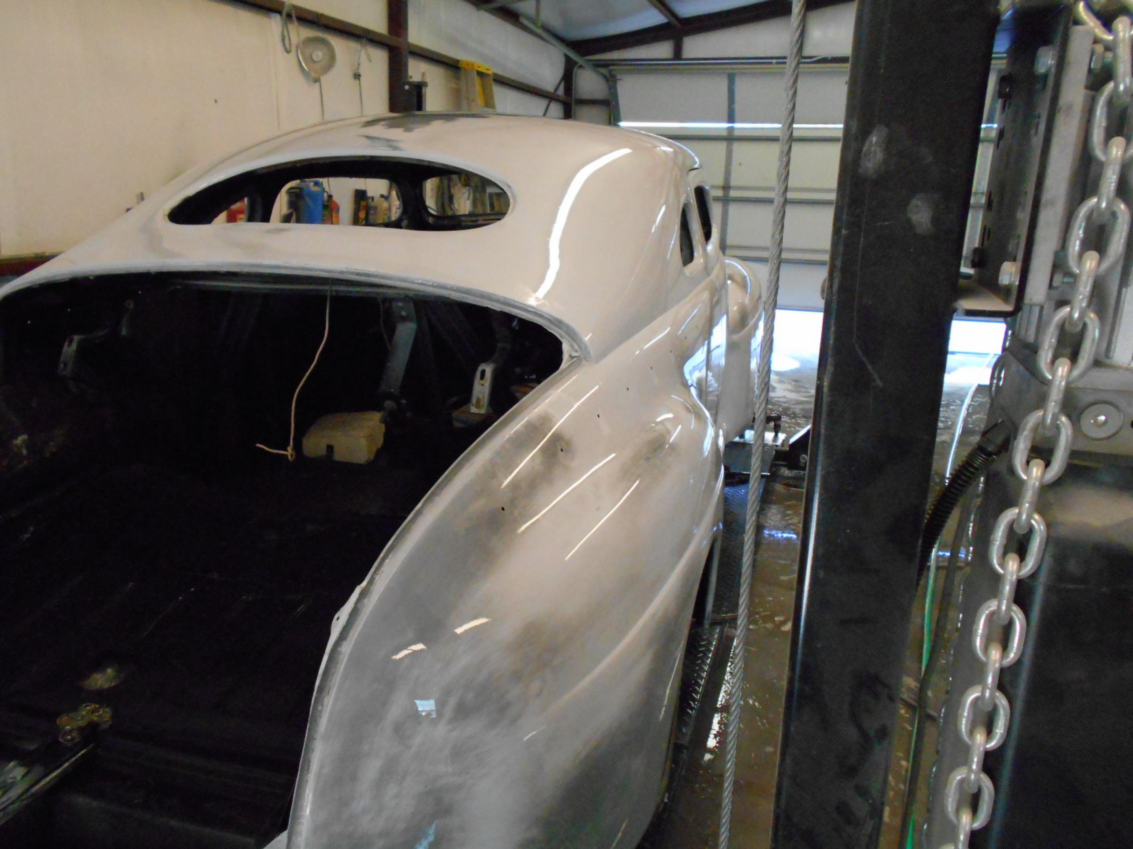

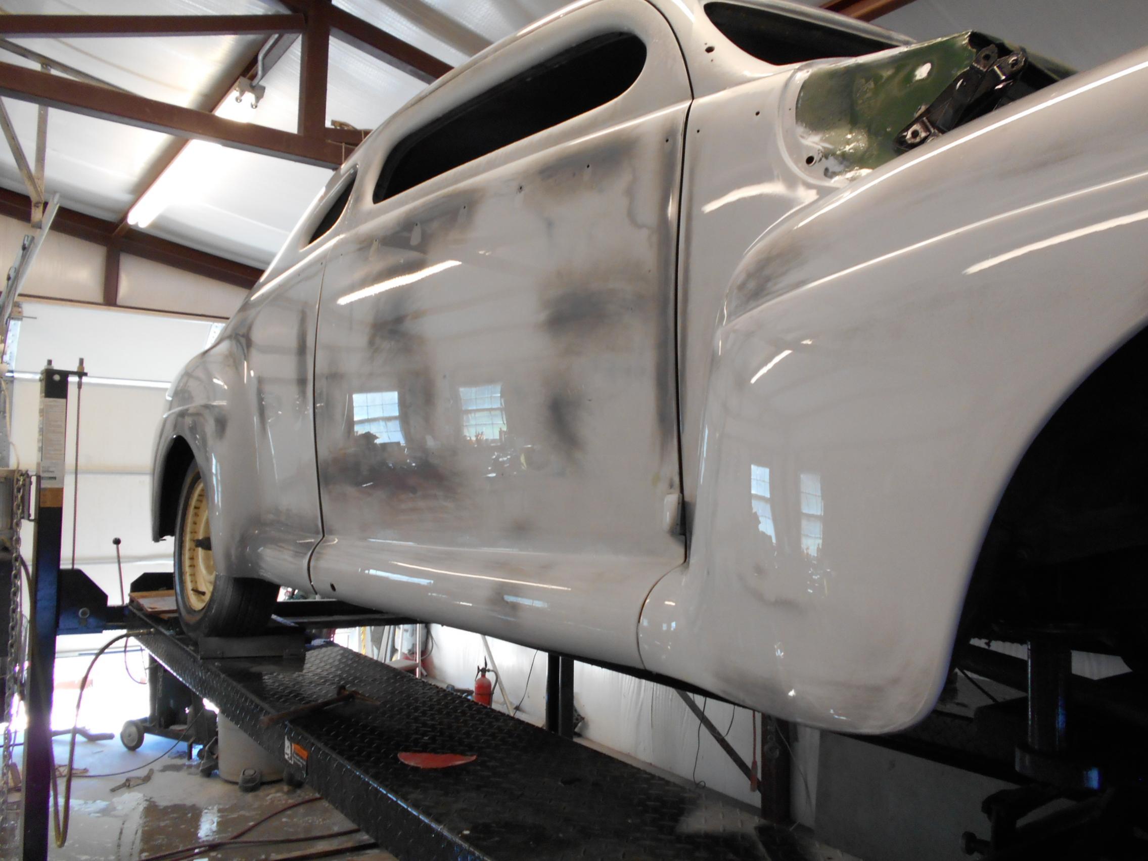

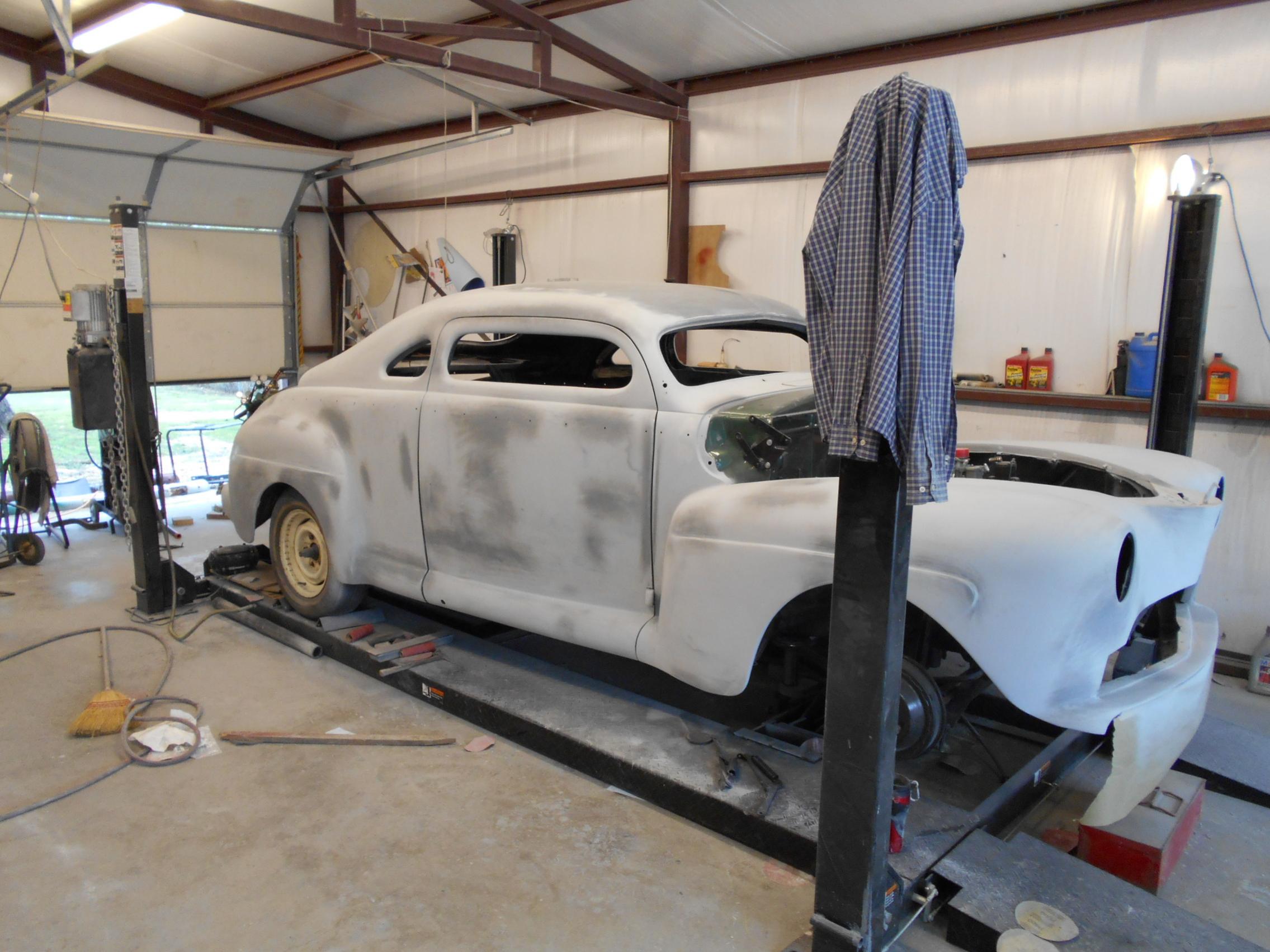

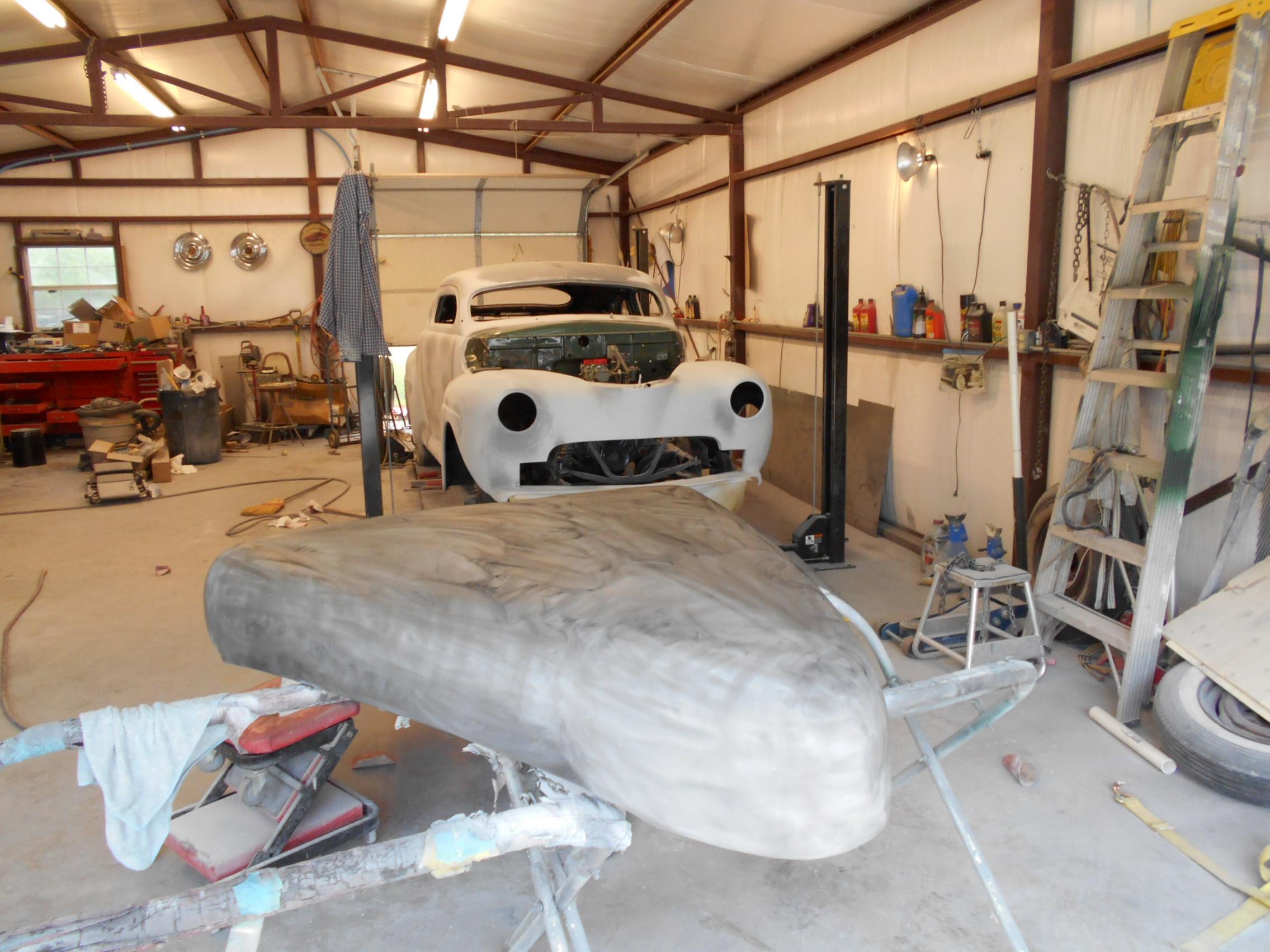

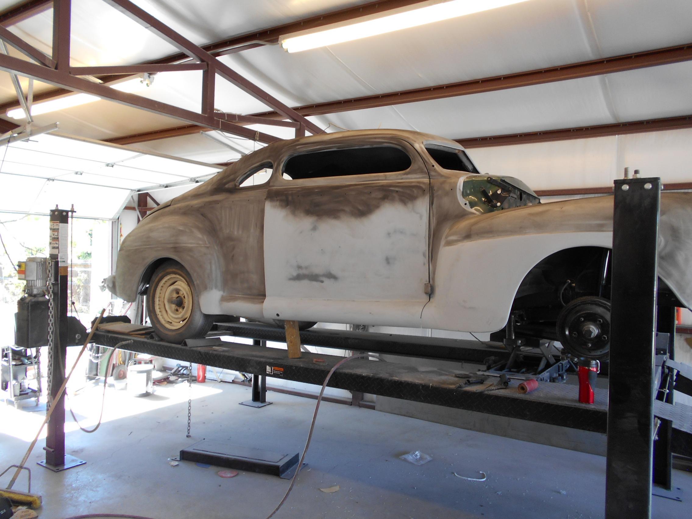

    Ok, lets get all the dirt off this thing. The 600 grit finish on the primer really holds the water. Gives me a chance to look things over differently than before and identify some problem areas.

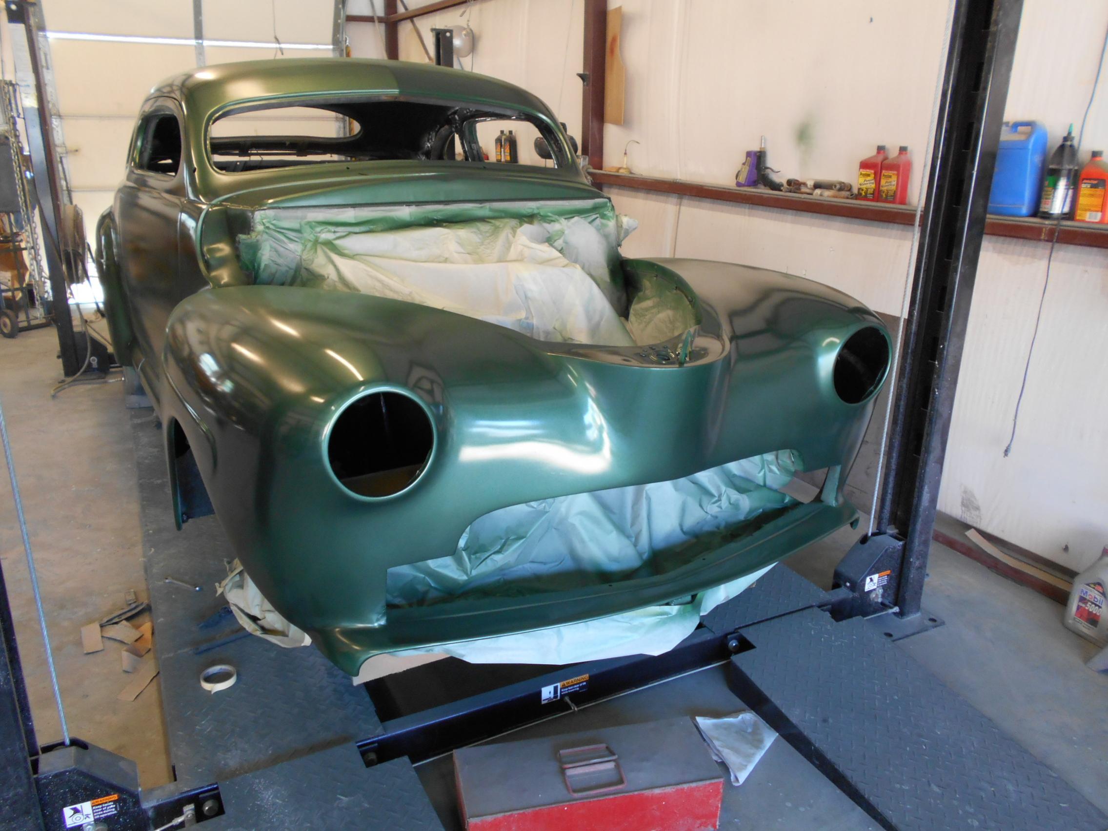

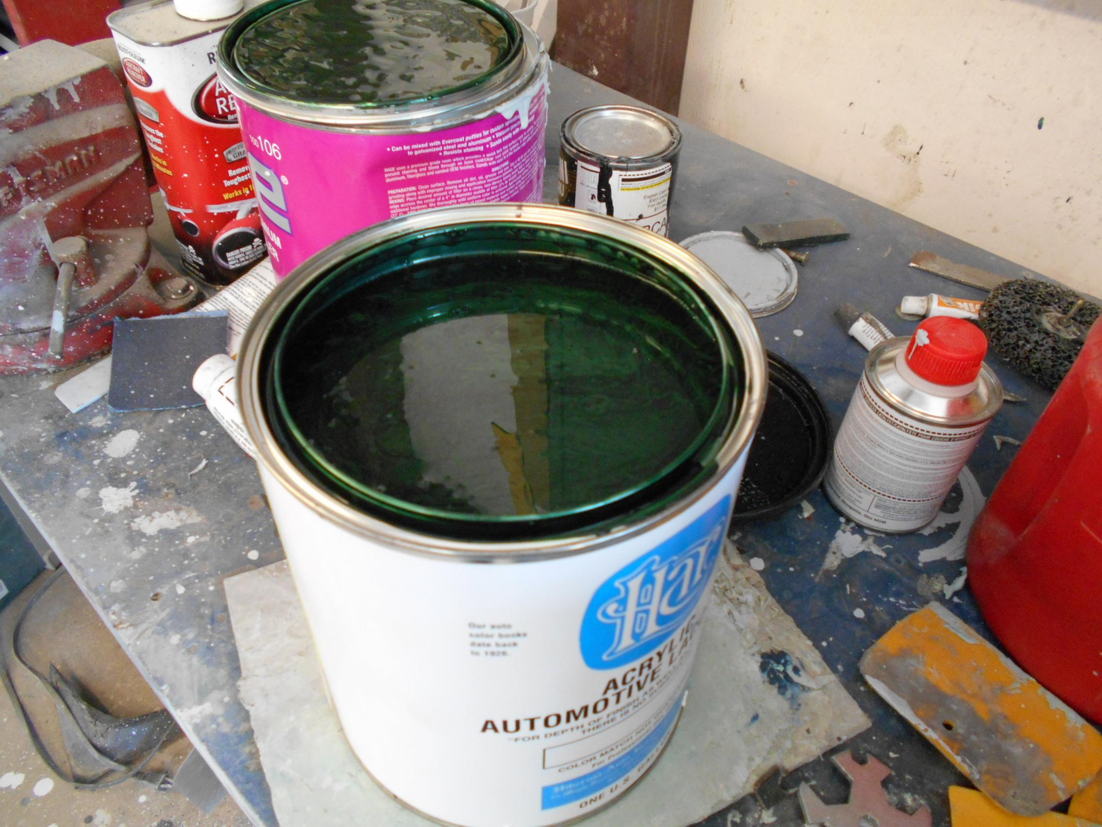

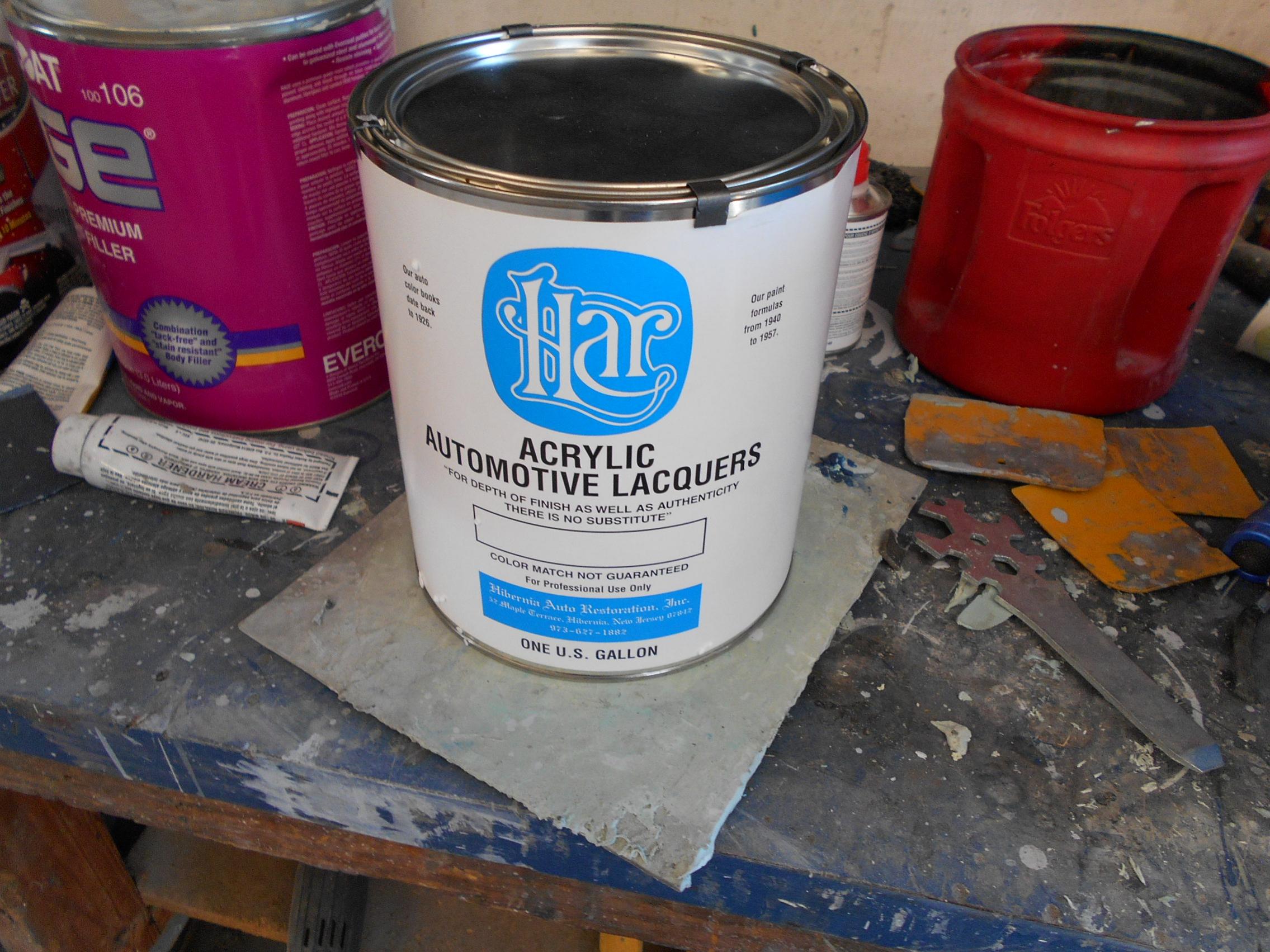

    The last lacquer that I shot was in the mid 60s. It seemed like every time you got use to and mastered one type of paint the paint manufacturers would come out with a new more durable (and dangerous) paint that you HAD to start using. We started reading labels and were not too keen on the babies with two heads that could happen if you were continuously exposed to this new stuff. They would then start to phase out the paint that you had become accustomed to.
    Because of the influence that the paint jobbers had you were sol regarding lacquer especially because of what it supposedly did to the invironment.. So I had no idea that lacquer was still available. I ended up contacting Hibernia Auto Restoration in Hibernia New Jersey. They are a high end resto shop that started doing Packard's. They since have branched out to most anything. They mix all there own paint from nitro lacquer all the way up to the current modern catylised coatings. I wanted to use nitro but they couldn't do this color because they don't have access to the lead required in the formula. I settled for acrylic lacquer. I sent them a spray out card that they matched dead on.
    This going to be great fun. I'm going to have to get the feel again on the correct mix of thinner.

  18. pimpin paint
    Joined: May 31, 2005
    Posts: 4,937
    pimpin paint
    from so cal
    Hey Jerry,
    I sure hope you bought more than that one single from them:confused: Even thinned 150-175%, you're gonna have a tough time gettin 12 to fourteen coats from that single:eek: A red oxide or medium grey sealer would probably help as a base:)

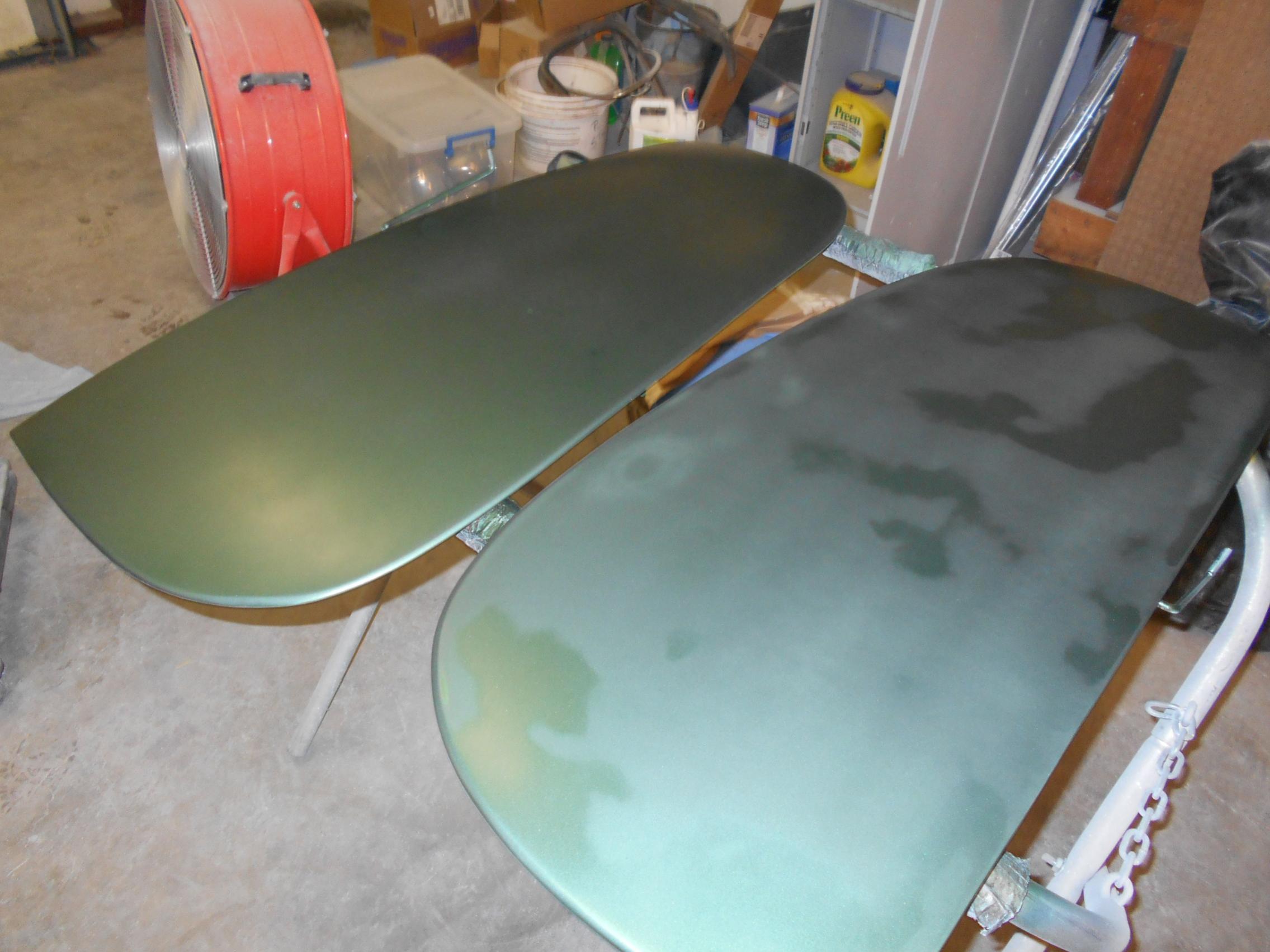

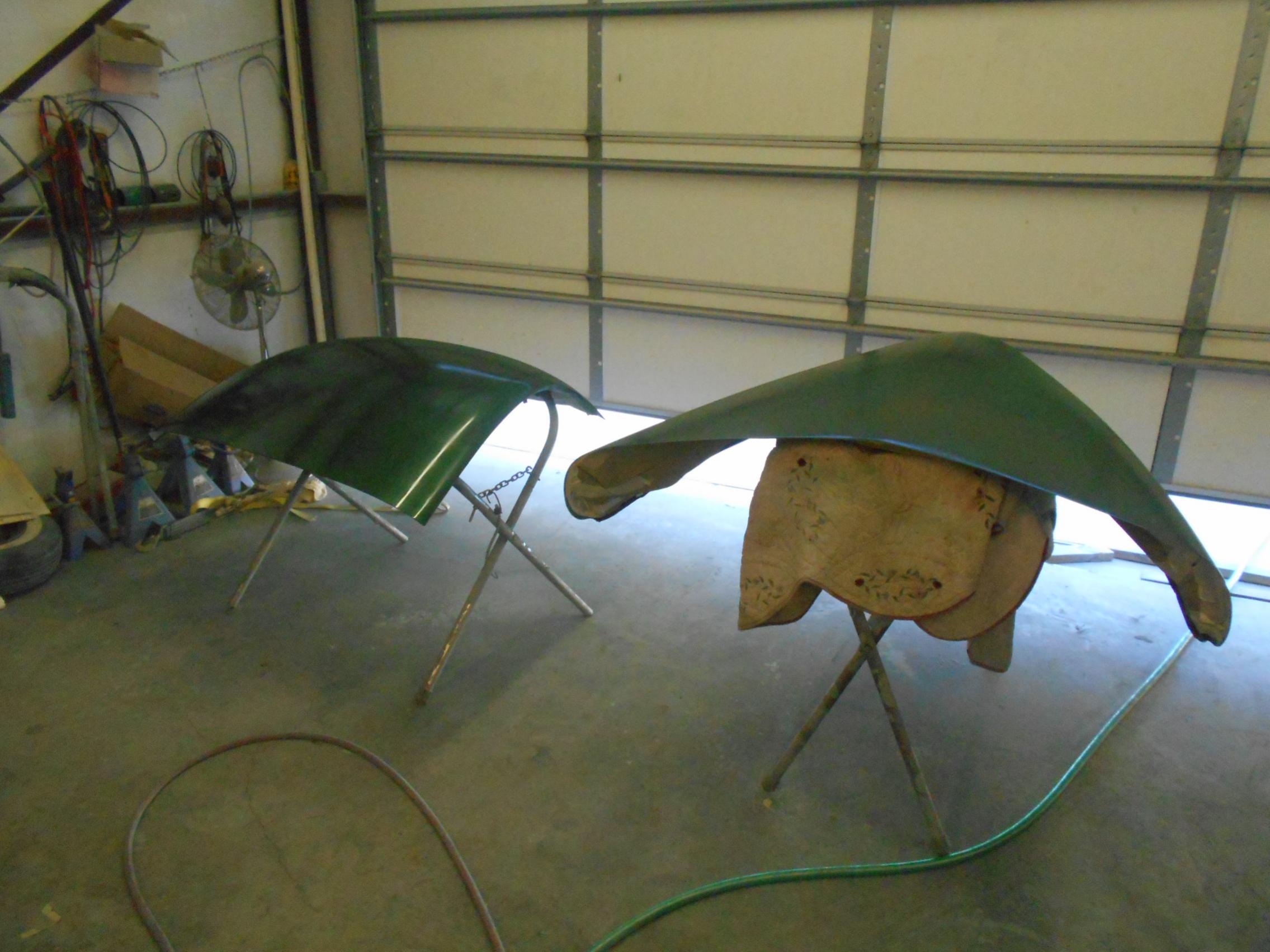

    I asked Jesse where the car was painted. He said that him and Sam painted it in the back stall on the end of the Compton shop. He also mentioned that it blushed so bad that they didn't know if they were going to be able to save it.
    I started with the skirts using mid temp thinner. Big mistake. So we start like "the guys" started. Kinda' cool in a really crummy way.

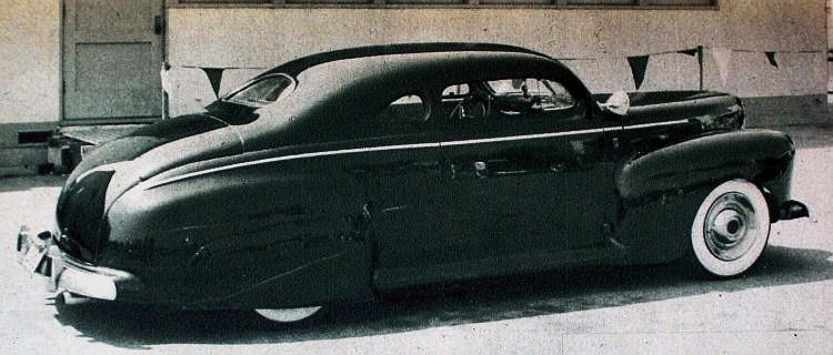

    Hey, do you guys think these two cars are runnin' the same tire's?
  22. Looks like Jesse's car has taller tires to my eyes, with maybe 1/2" wider whitewall. The wheels look like they are larger diameter as well, but that may just be the perspective of the photo.
  23. Torchie
    Joined: Apr 17, 2011
    Posts: 1,099
    Torchie
    This kind of stuff is always hard to tell with out a full straight on side shot Jer.
    Having said that, I would think that there is a good chance that they are. Some things like the sombrero's, the tire size, the white wall width, the width of the tuck and roll, the Appleton's used, ect are going to be the same from car to car from the same area and era because that was what was considered cool at the time.
    These guys were well aware of what their peer group was into. And lets face it. Isn't that why we build our cars. To be cool..........

    This might help. Pics Rik Hoving

    As for the tires size... I don't know... but I guess there are enough experts on here that will be able to tell you what they should be.
    But you should first decided which version you want to duplicate. Some of the photos shown for tire size above are from when Danny Lares owned the car (with the longer hood side trim). Those should not be looked at I think.
    Early one Jesse used Single bar flippers and not to tall white wall tires.
    By 1950 (probably earlier, but this photo was taken in 1950) Jesse had switched to Sombrero hubcaps and taller size white walls.
    This last version shows the car when it was already sold by Jesse to Danny.
    And it looks like he changed tires again (not 100% sure though) But this last photo should not be used as reference though.
    Although I have to admit I really like the tire size on this version.

    I think the 1950 ones are 7.10-15" Good Year Super Cushion. Could be 6.70-15", as well. But I think these are the ones.
