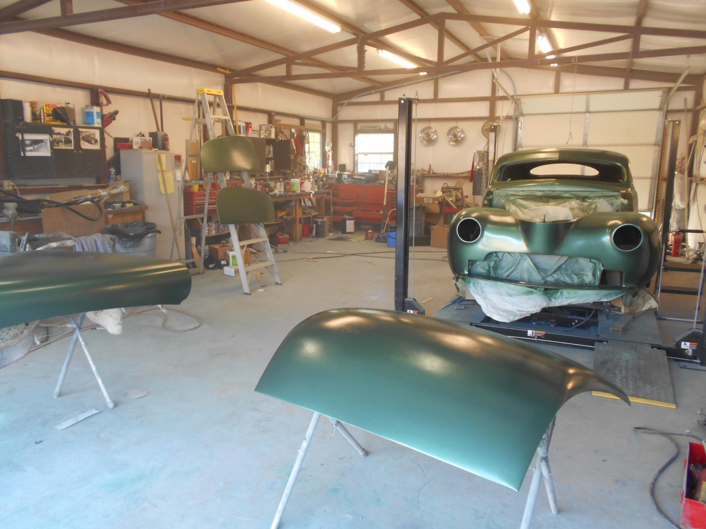

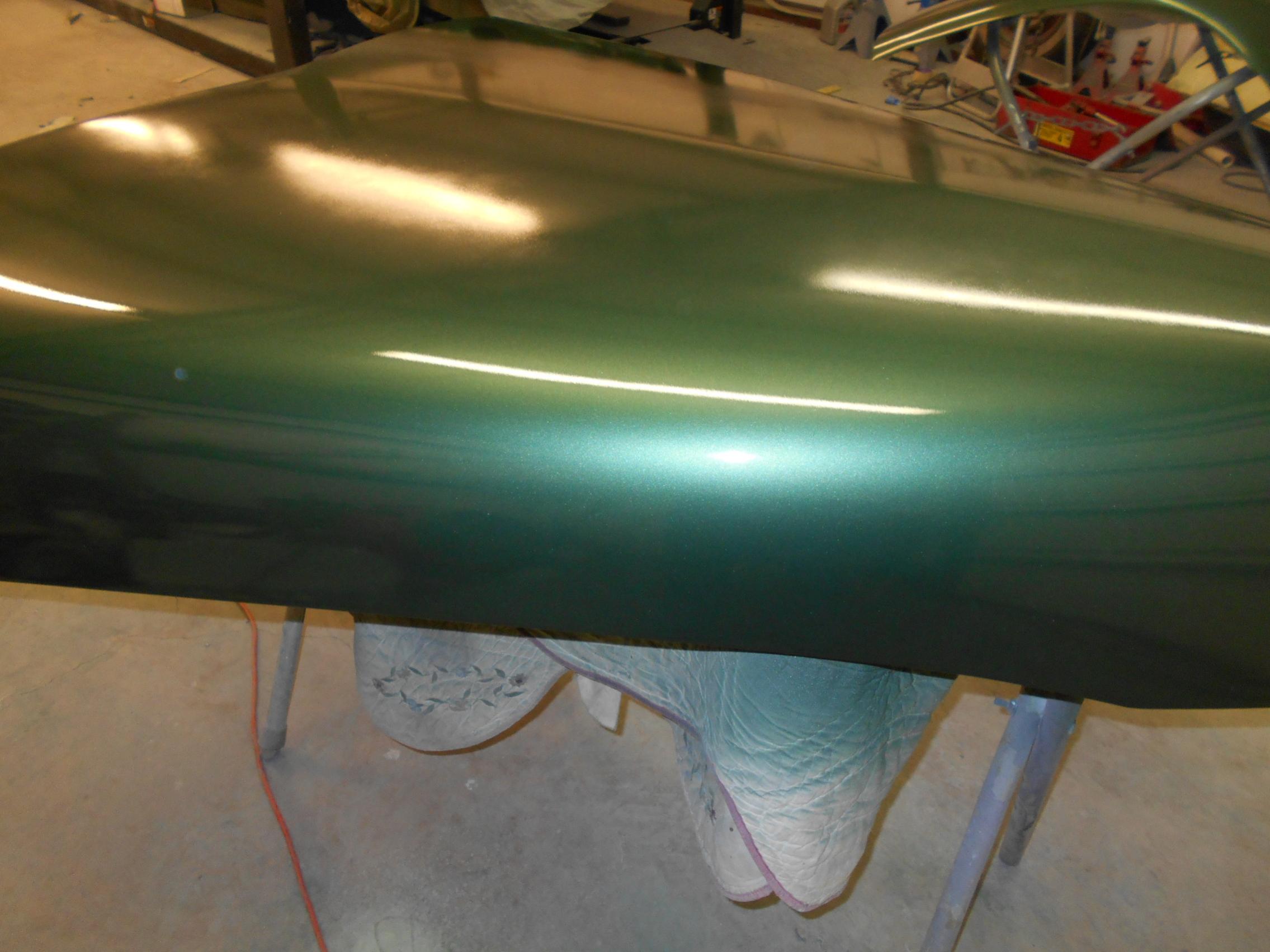

    Jer, how many gallons do you think you will use and how many coats will you spray?

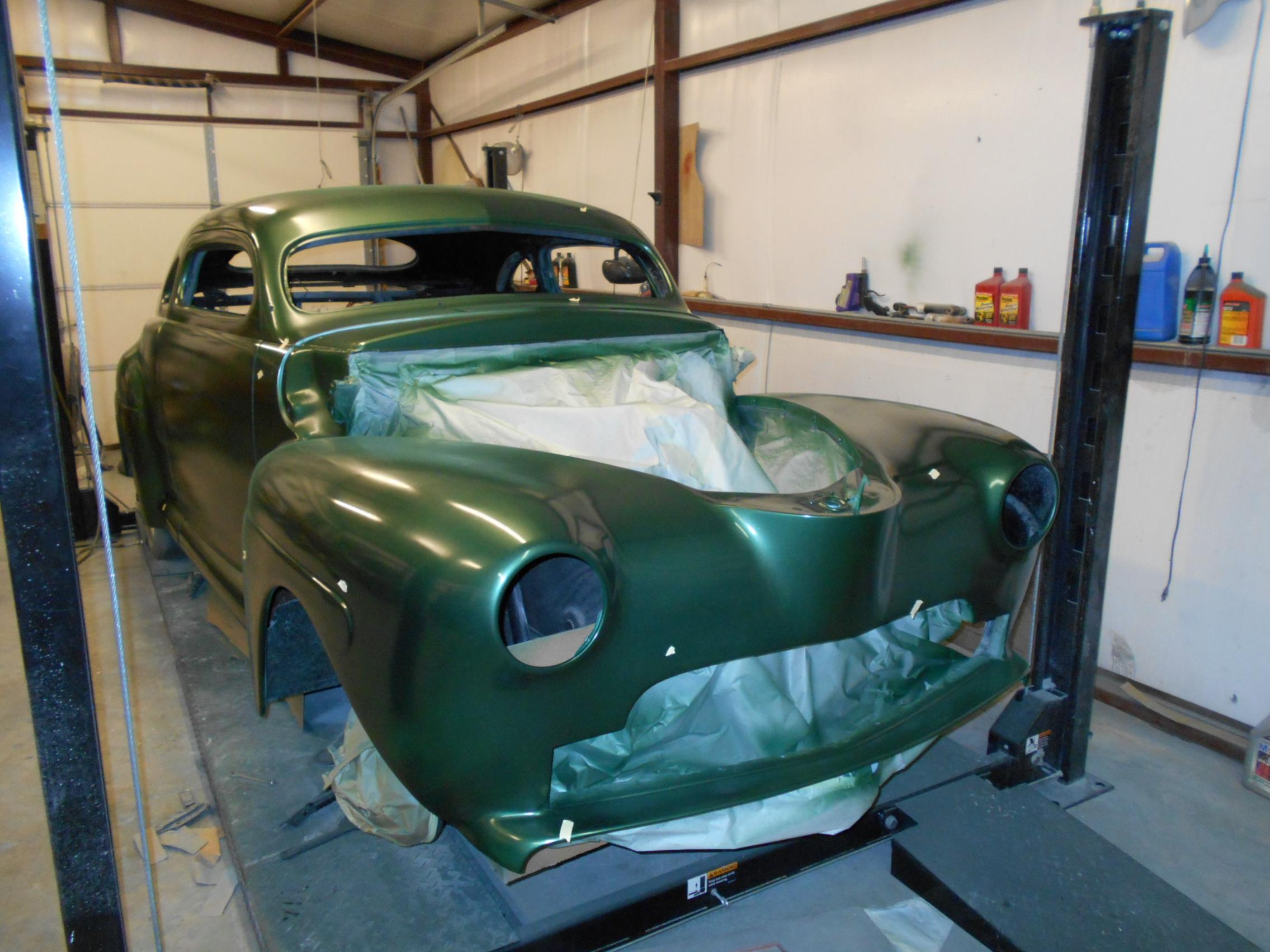

    In the process of finding the correct ratio of thinner to paint I have the first gallon on the car. This equates to about 6 double/wet coats.
    This a high hiding color so after 2 coats I have coverage. I'm going to save a quart out of the next gallon and thin it 150%. After I have coverage my concern becomes making the material even and consistant over all the panels. Overall I'll probably have 12+ coats of color on the car.
    I have 2 gallons of clear that I probably won't use up completely. I'm thinking 6 double/wet coats will be plenty to then be able to cut and buff. We'll see.

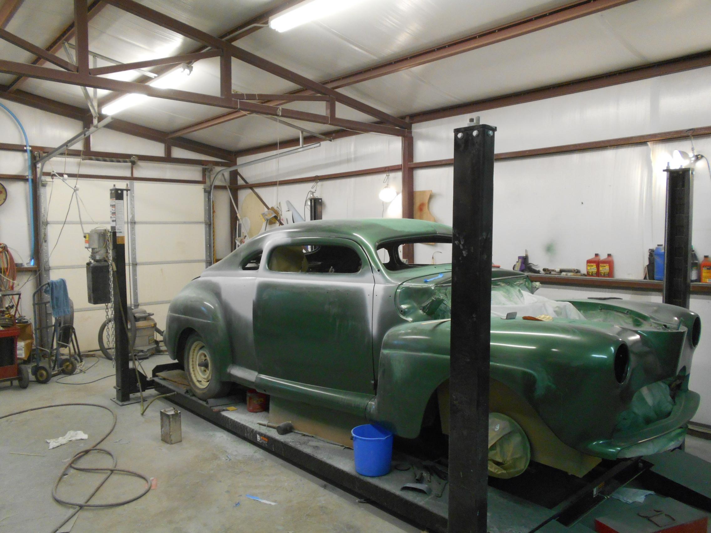

    Might I suggest that you hang and align both the hood panel and deck lid at this time! This era Ford is notorious for piss poor fit ups at the cowl & fender shut lines of the hood panels, and the deck to quarter fit ain't much better either:( These operations usually produce some paint damage, and better to repair this at coat six, then at coat 12-14 and have clear and metalic to contend with;) Too, with all panels in correct alignment, you'll have a better shot at matching the way the metalic & clear index as they hit the surface. If these panels are shot on the bench, off the vehicle, they may not match the cowl, fenders or quarters, and require additional respray work and still, more material.............just a thought:)

    I appreciate the input. The color match and body panel fit are dealt with in posts #1149-1152.

    Great work, the colour in that last photo is amazing.

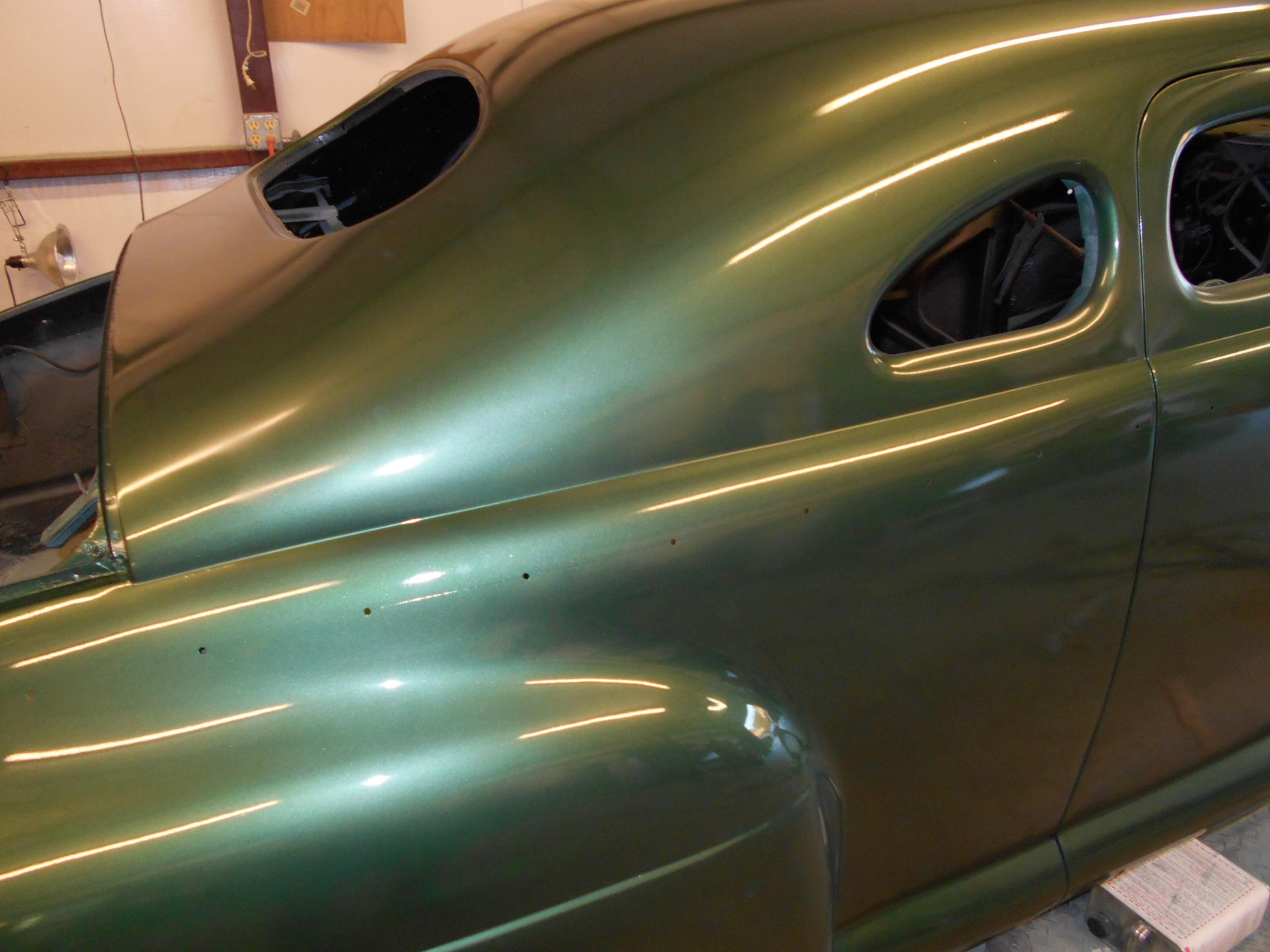

    As everybody knows, this is a big undertaking. After I had color on the car I could see things much better than I had before. There are some very treacherous holes you can step into if your not careful with these body shapes. I now think I'm ready to put the final color coat on. I'll let it sit overnight and clear it the next day.

    NOW DON'T TOUCH ANYTHING, I'll get the clear on it in the morning. Wait, I gotta' go to work in the morning, oh man, I'm retired, this is my work in the morning. I'm DEFINATELY going to wear a mask for the clear.

    This is like painting three cars! Seven gallons of material.

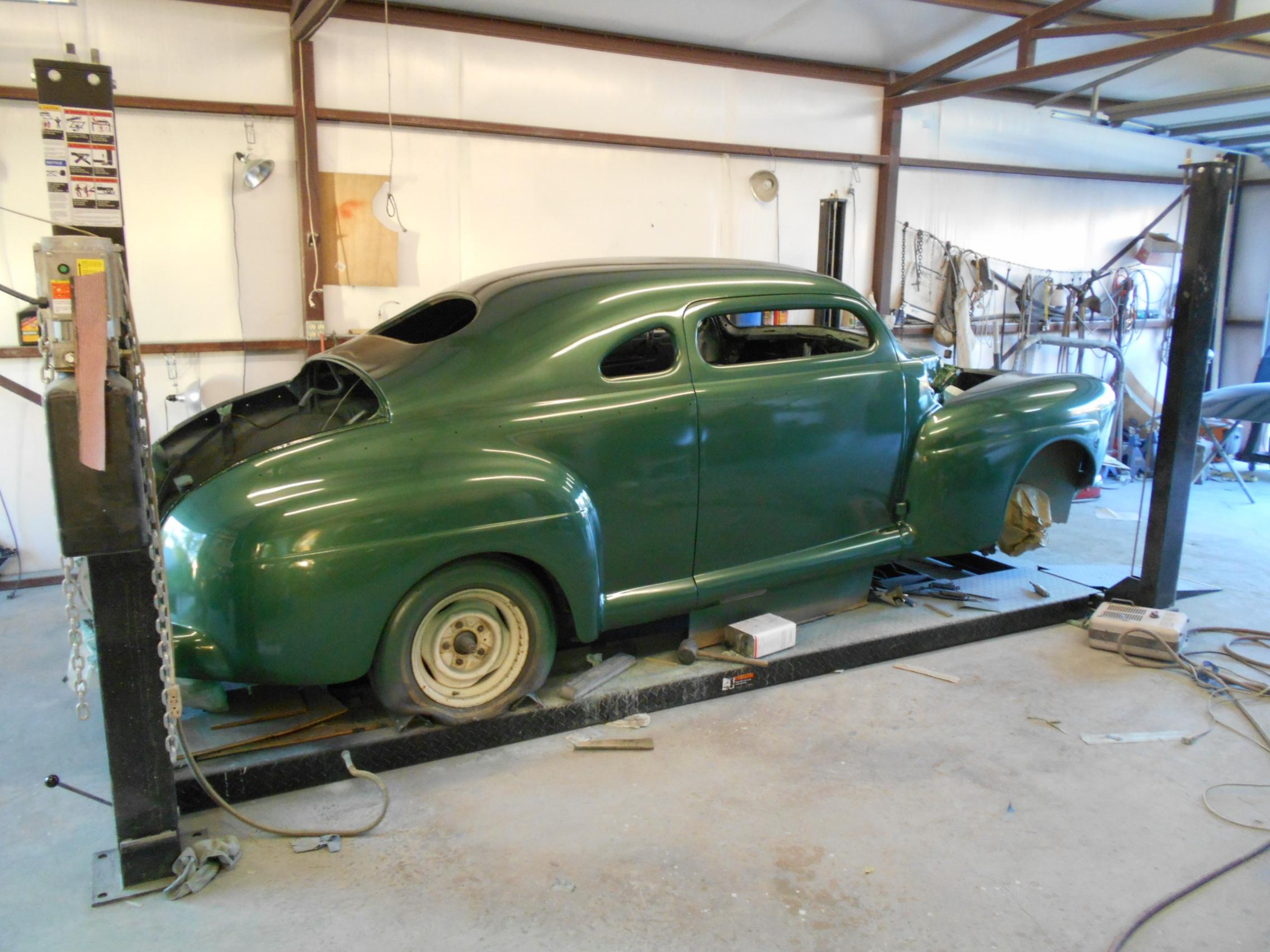

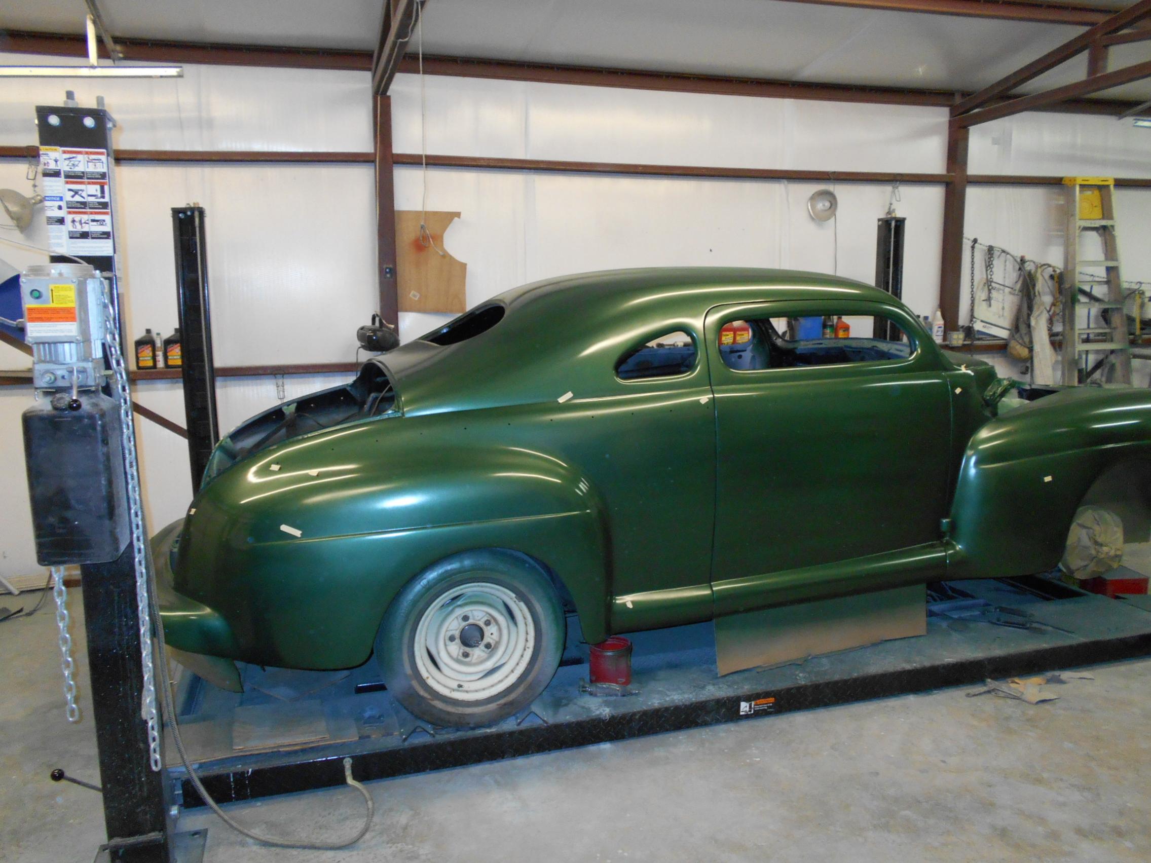

  26. That looks amazing...I was imagining the wrong shade of green as well.
  27. daddio211
    Joined: Aug 26, 2008
    Posts: 6,012
    daddio211
    Kind of has a bronze tint to it, doesn't it?

    Thanks everybody for the kind words. Down the road I'll reveal the methodology used on this color selection. I'll compare it to how I did it with Jr's car.

    It looks like the overhead lighting in your shop has a slight yellow cast to it, I don't think we're seeing the true green color that it is. Out in the sunlight will give the true color.
    Body & paint look GREAT!

    Your right Craig.
