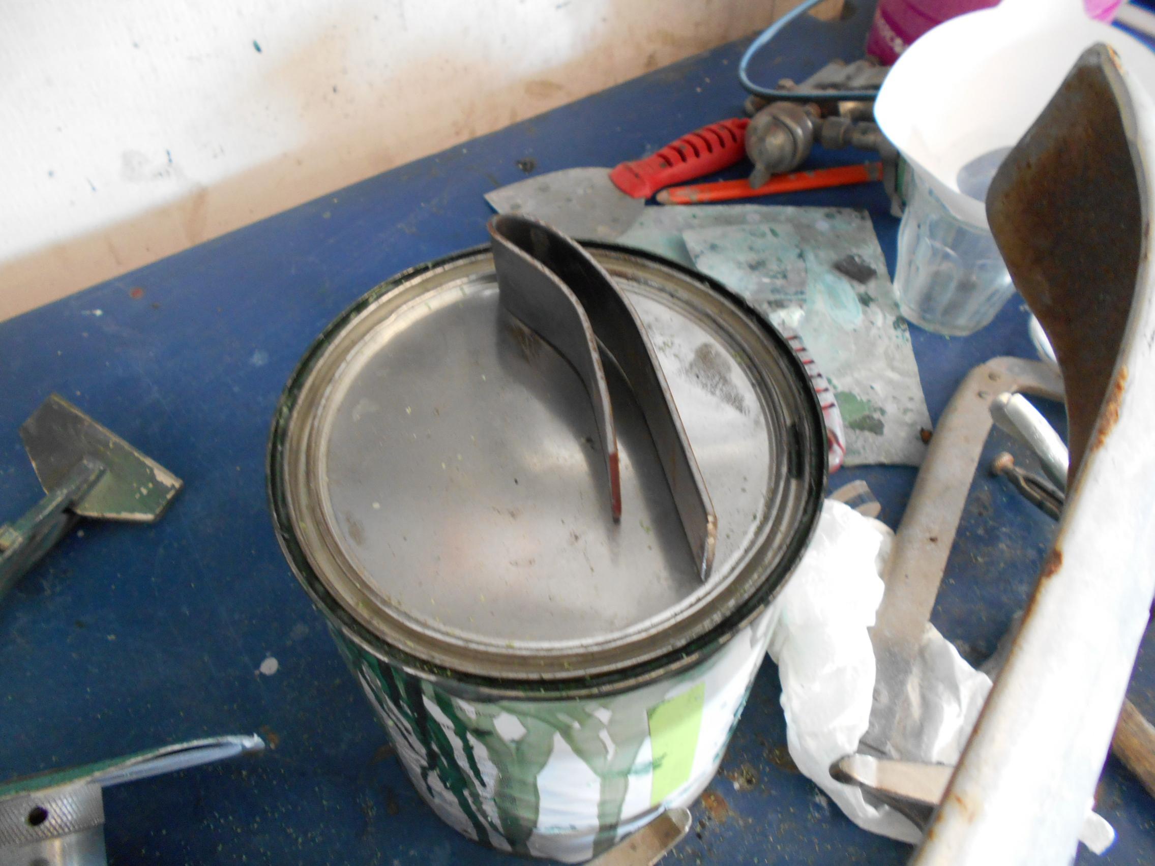

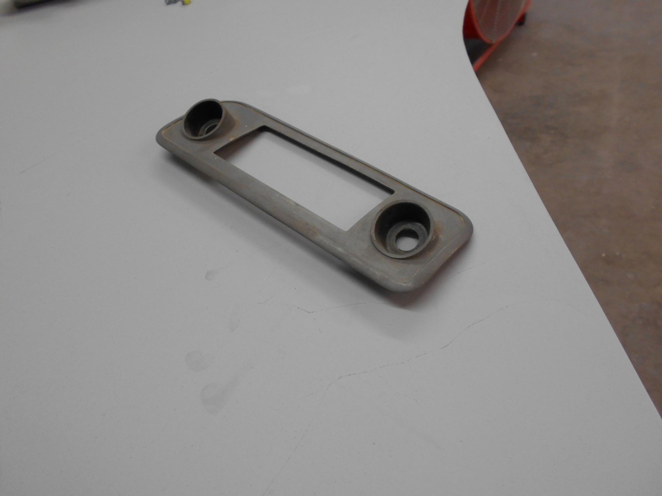

    While the paint is cureing I've got to get ready for the electrician. Before the car goes, the dash has to be installed. That means that I've got to get the radio bezel fabbed up and installed to cover this hole.
    I discovered that the car came with a non genuine radio. So, I don't have to duplicate this bezel. That's not all that bad.
    Straight lines again on the new bezel.

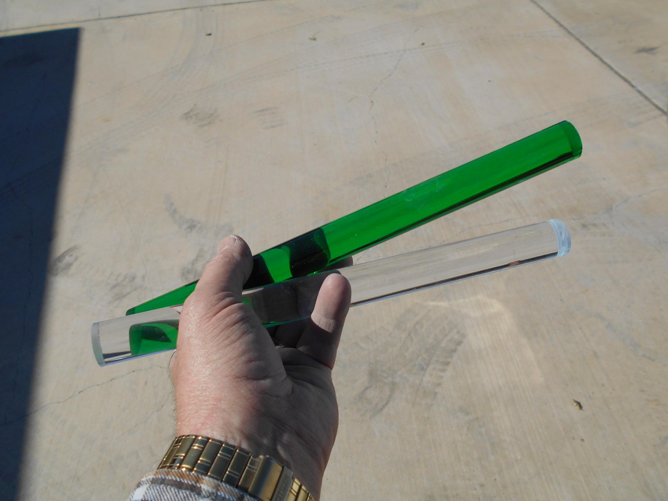

    These sticks will become the knobs.

    Gettin' there. The ends of the sticks have to be beveled (rounded) and polished.

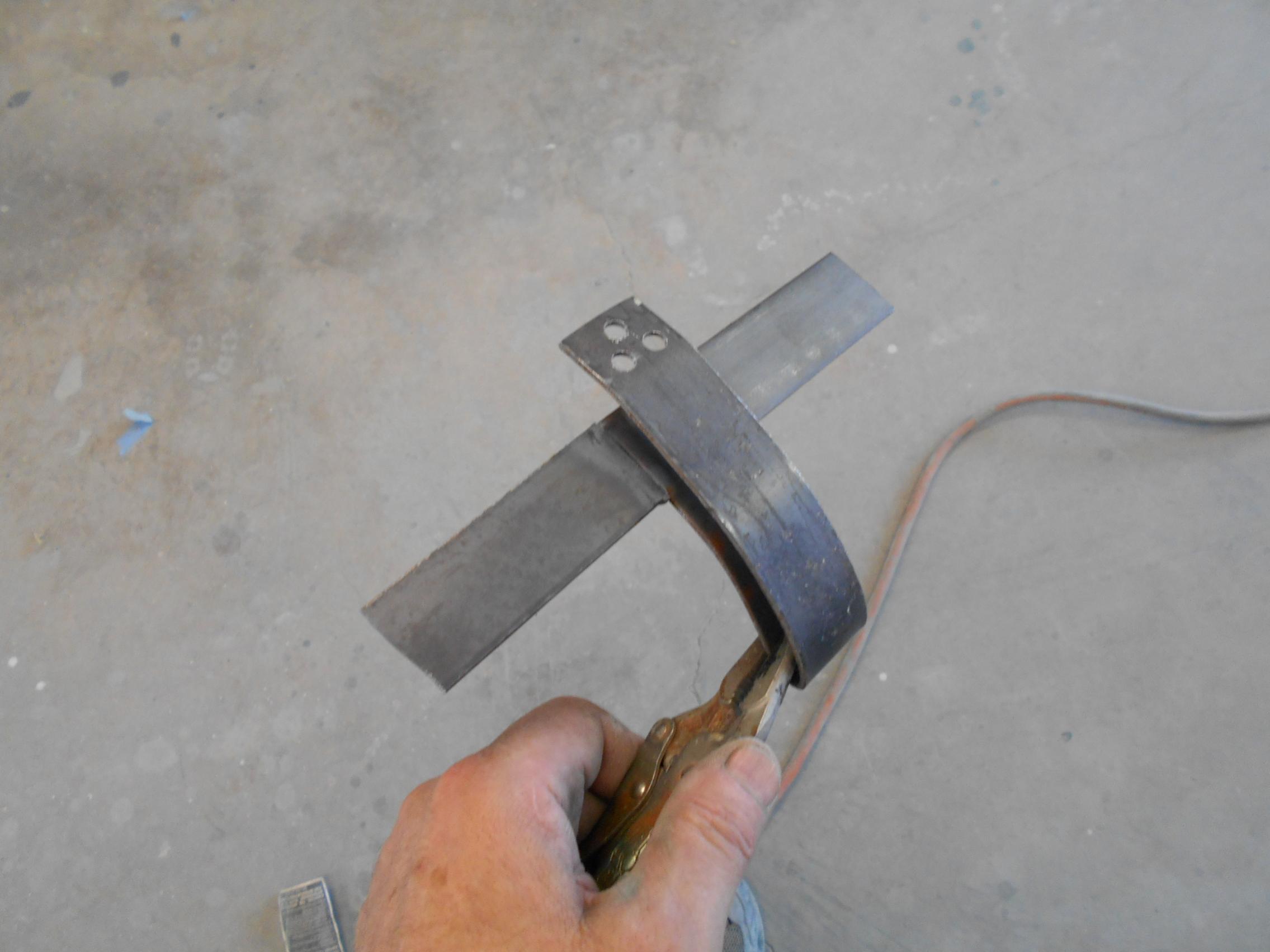

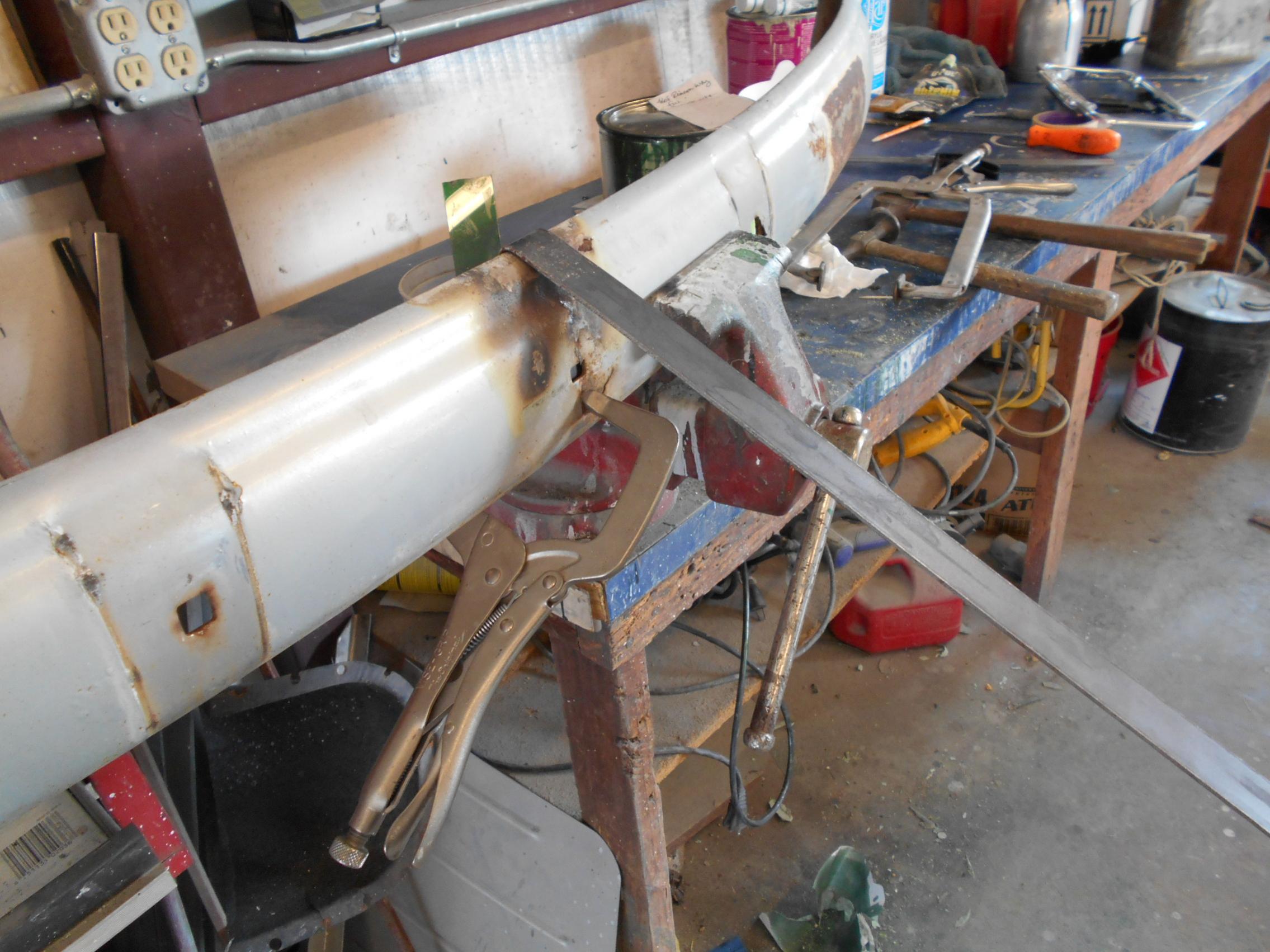

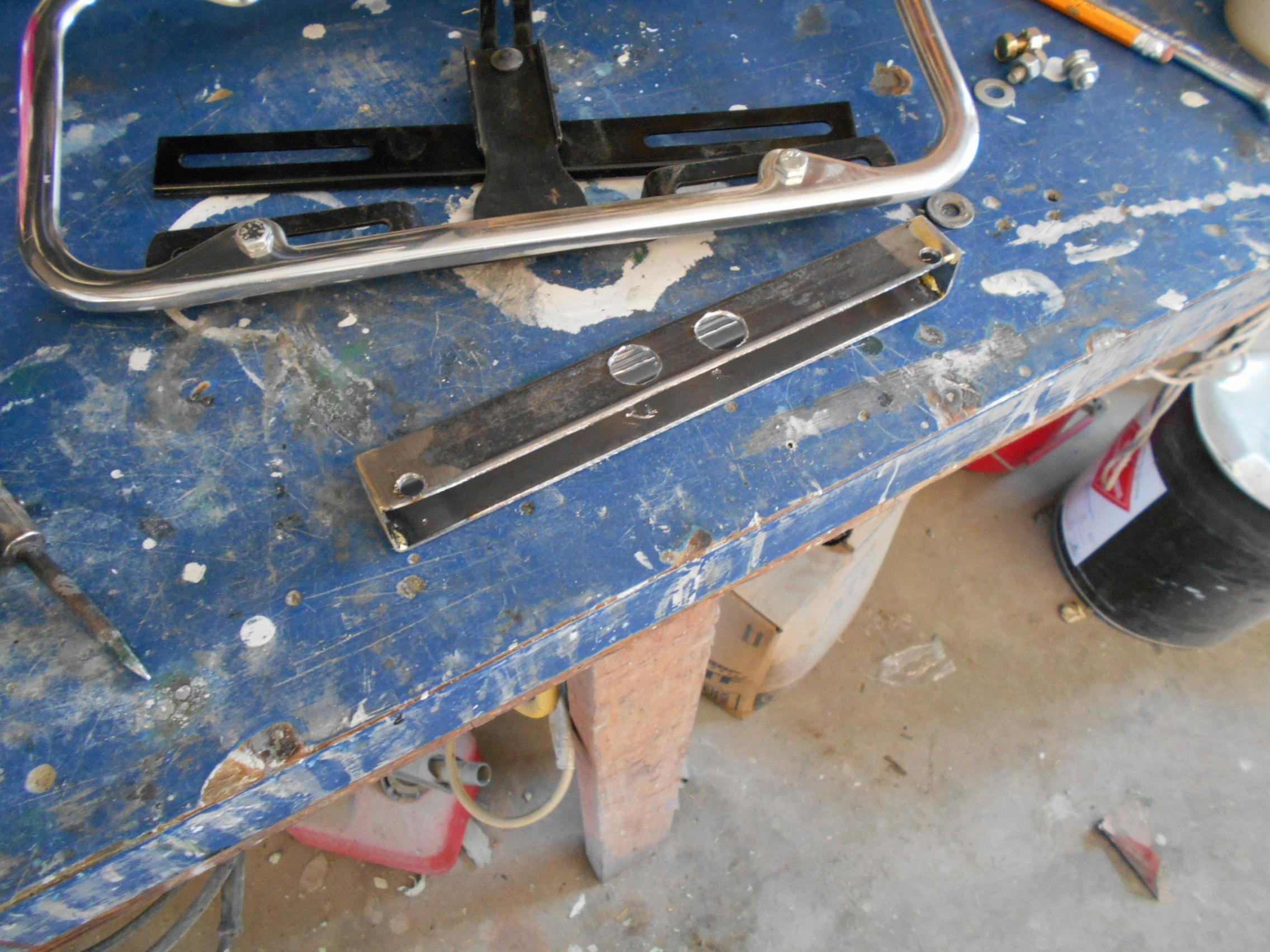

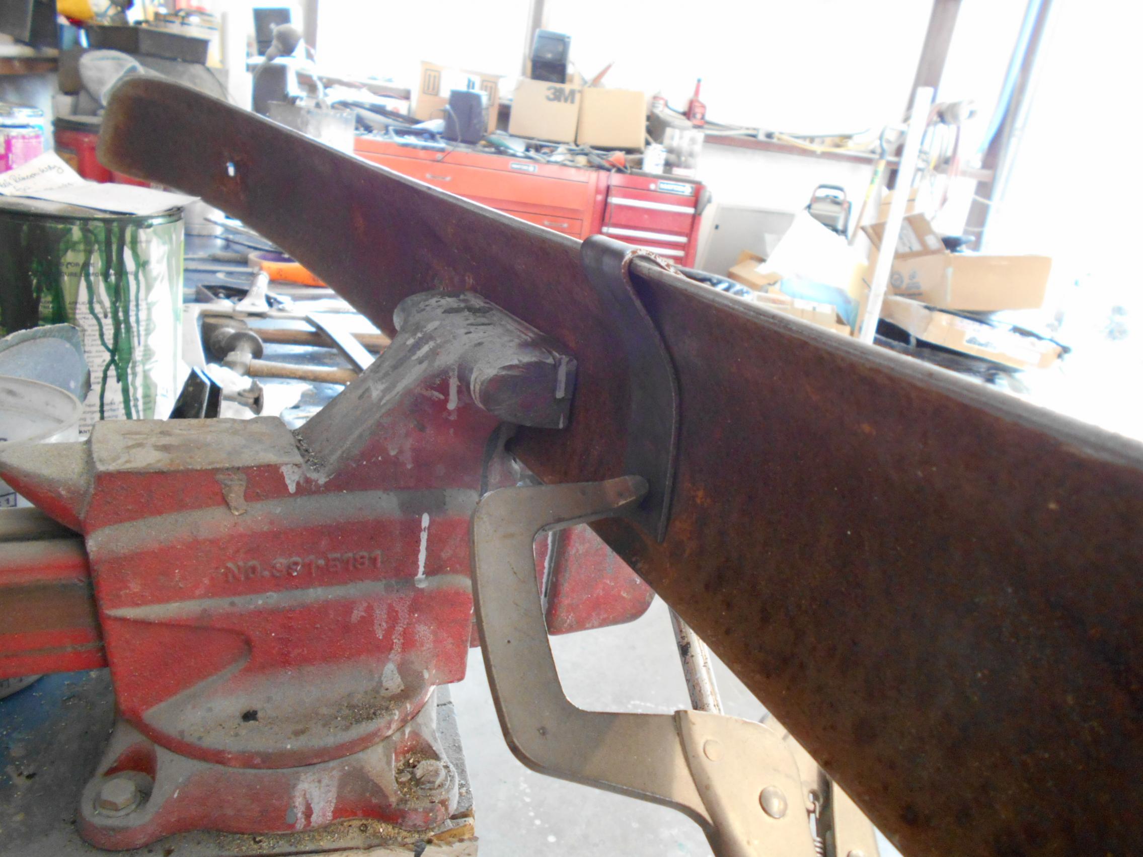

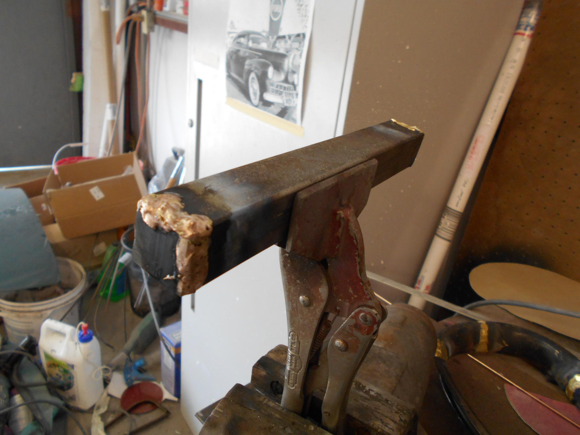

    Jesse has a great memory but, sometimes he's not up on specifics. This is one of those times. I want to make this clean and still capture that spirit. So, we use 1/8" strap and mold it to the bumper. This is startin' to look like Ryan's money clip.

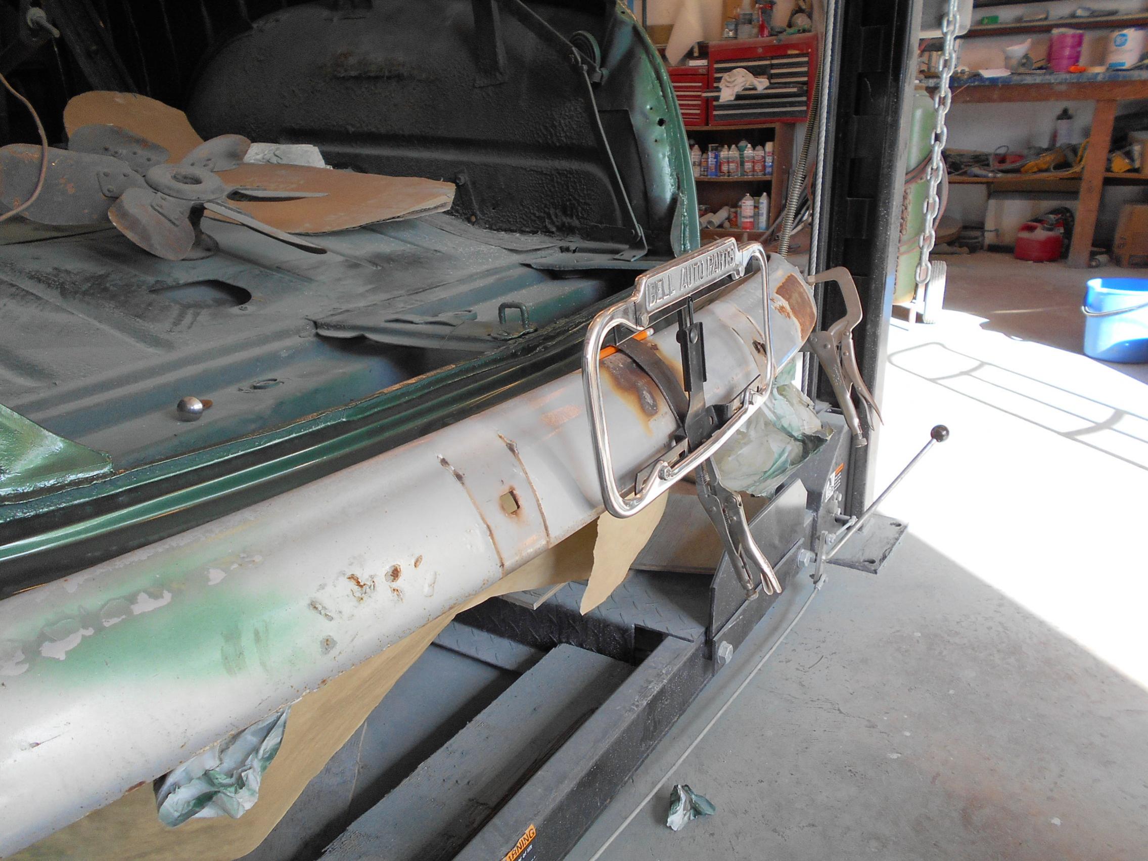

    I should have shown this one before the "money clip" one. Checking the angle on the vice.

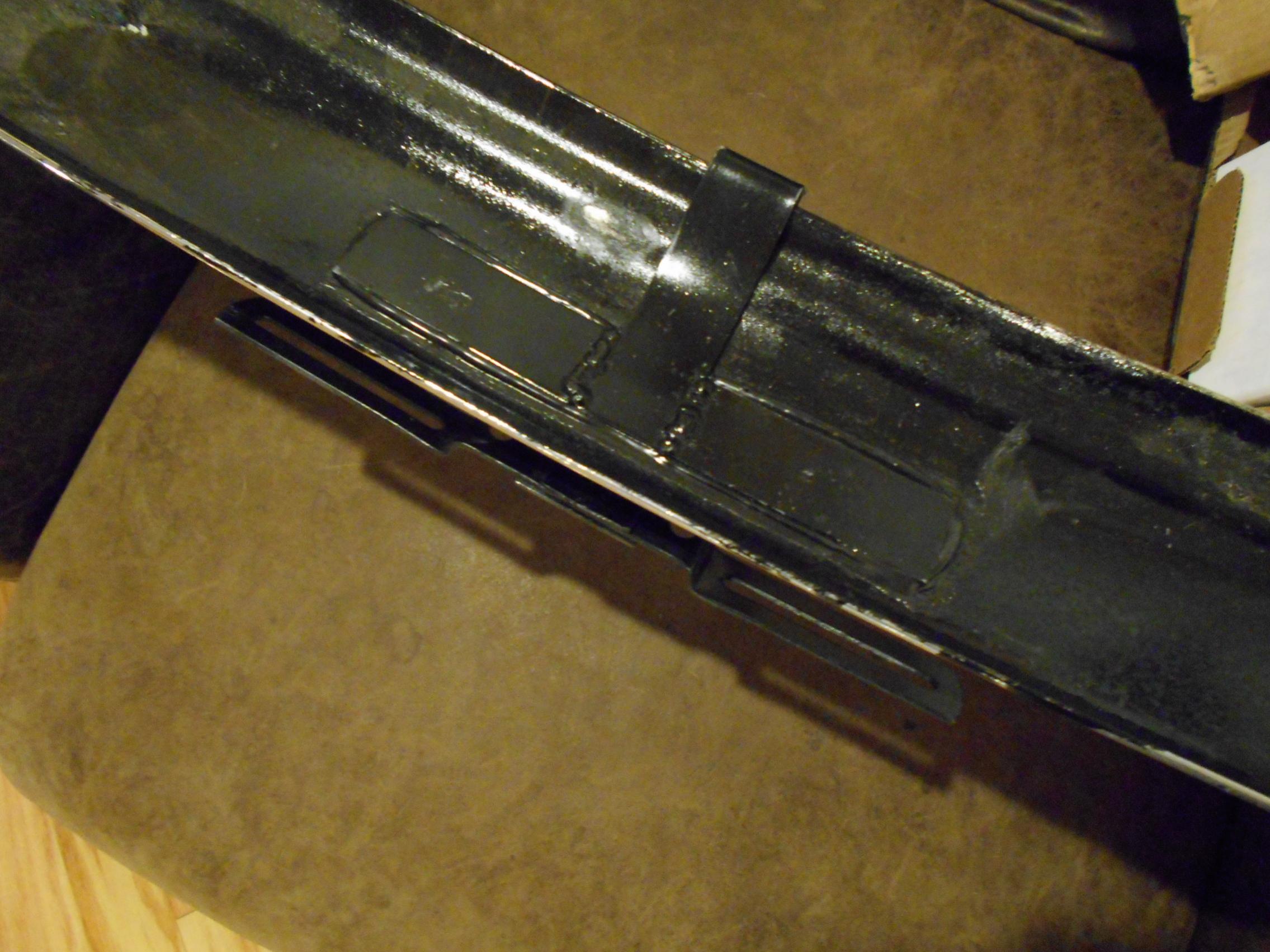

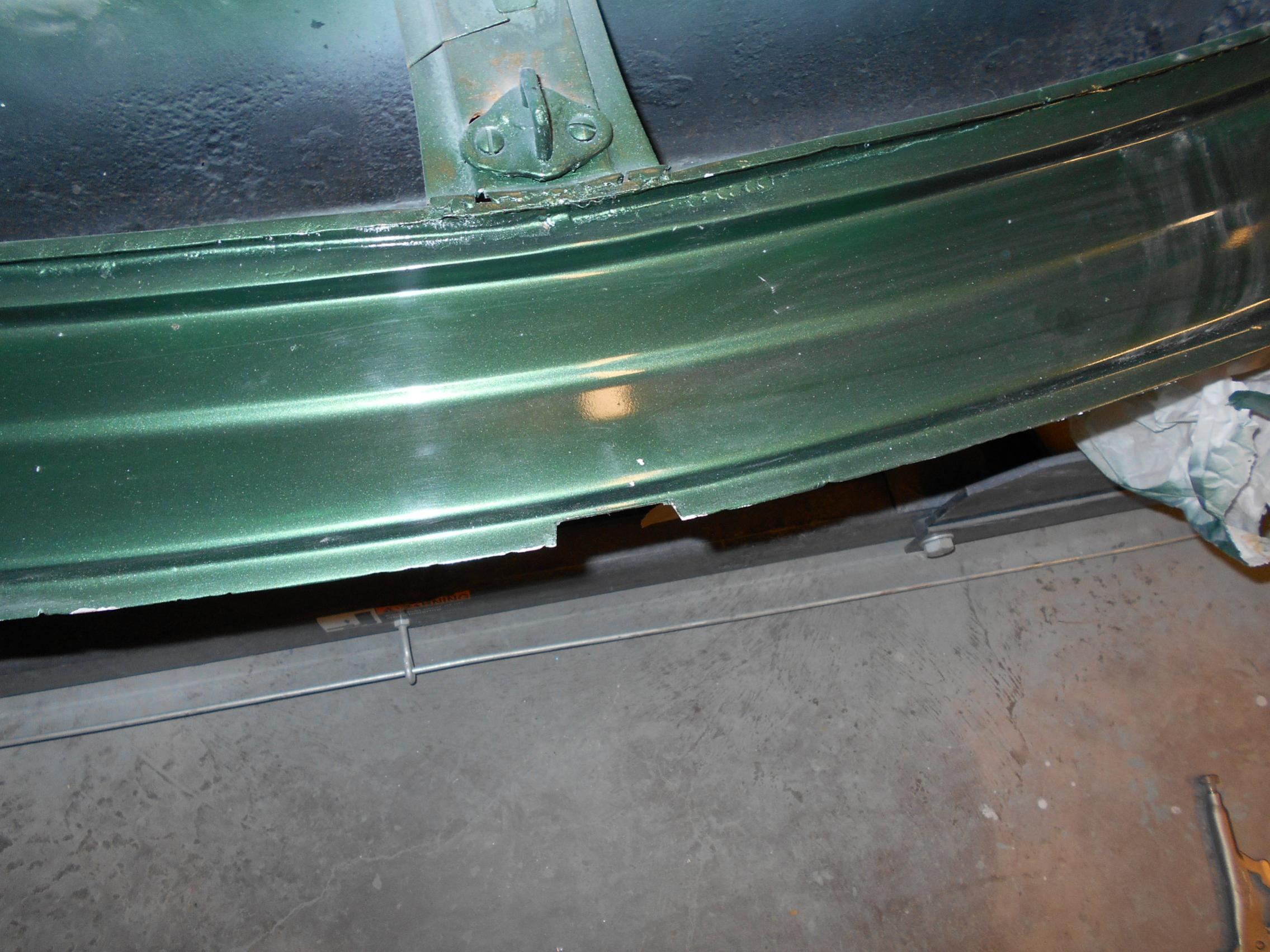

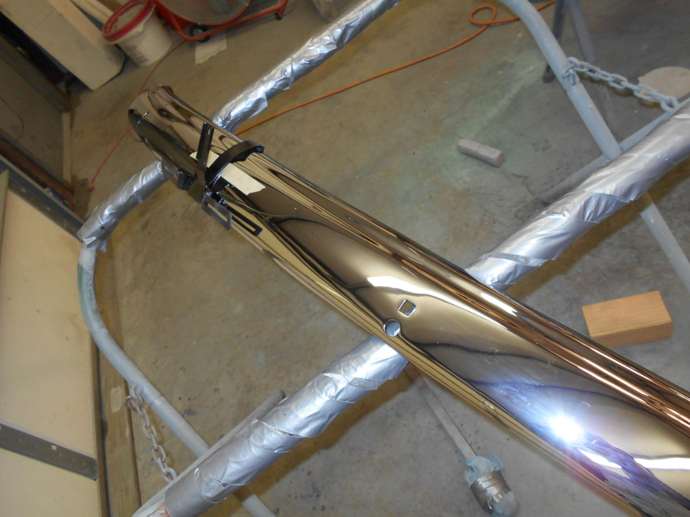

    Checking the angle with the bumper on the car. With the bumper already chromed I'll have son Dan take the bumper and the bracket to work and glue it on using the structural adhesive that they glue cars together with. Here's the notch in the gravel shield and, another look at the color. It's still in the shop.

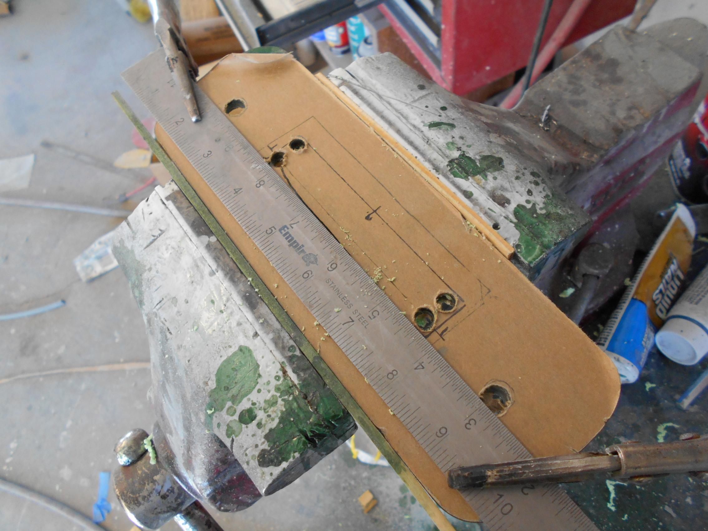

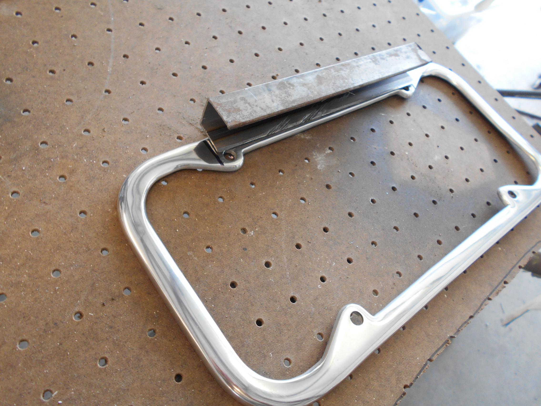

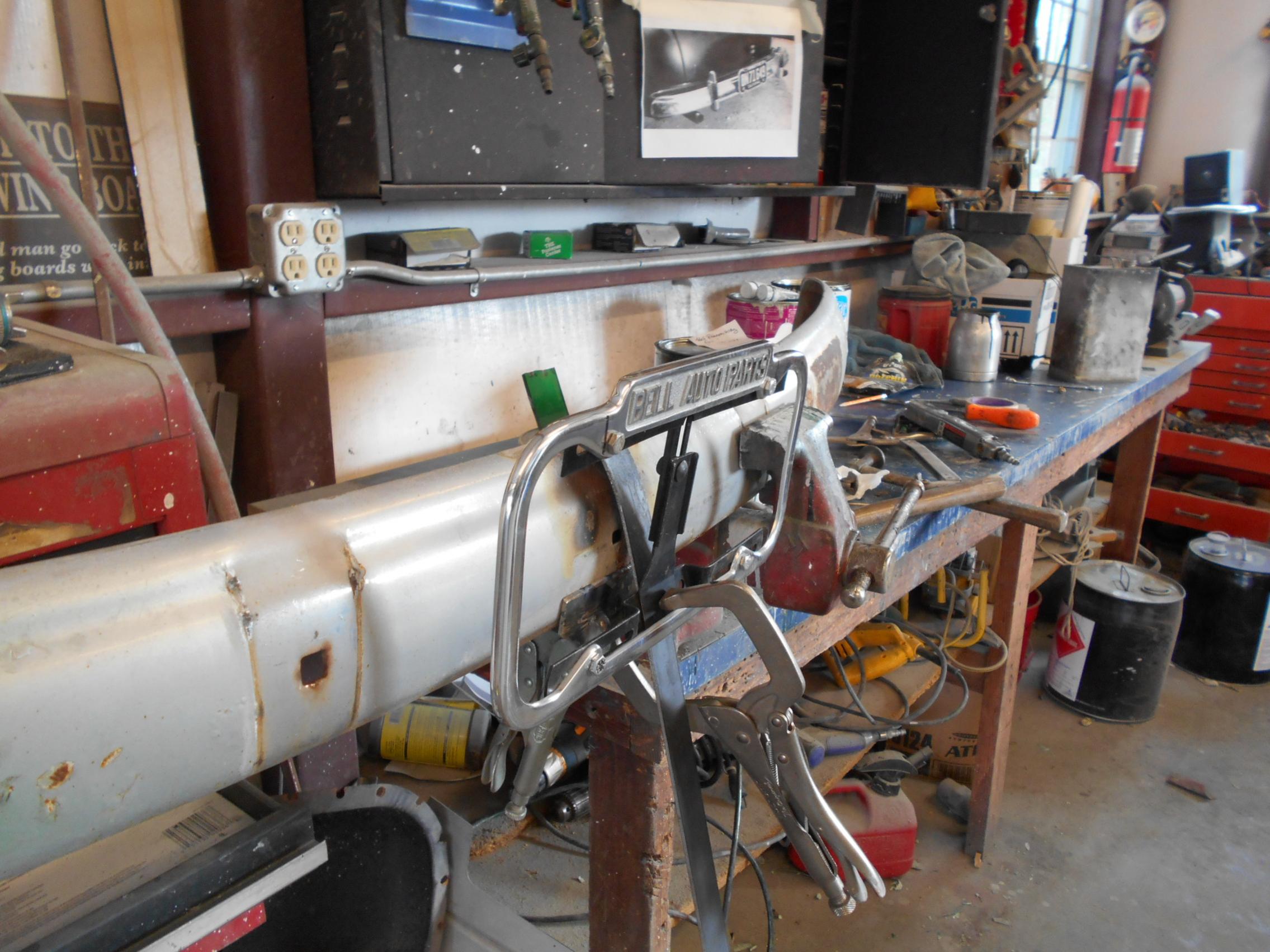

    If we're doin' the license plate bracket, we gotta' do the license plate light also. Jesse says that he bent up some metal on the bench and put some ends on it. Well, I don't know about that except to say, this has to look right. I think I can use some of the bracing I used on the chop.

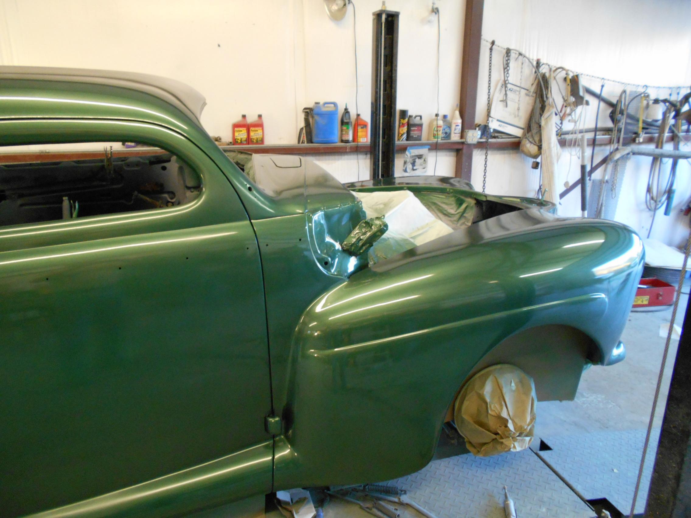

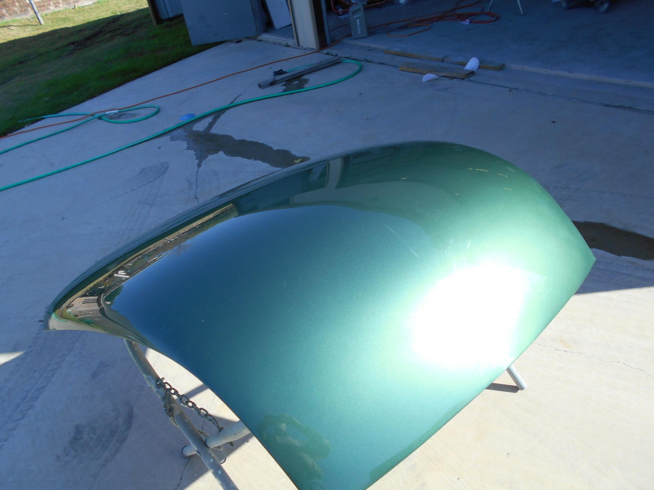

  19. Damn, what a great color. Looks wet...

    I've gotta' make that "window" for the lights and braze up the ends.

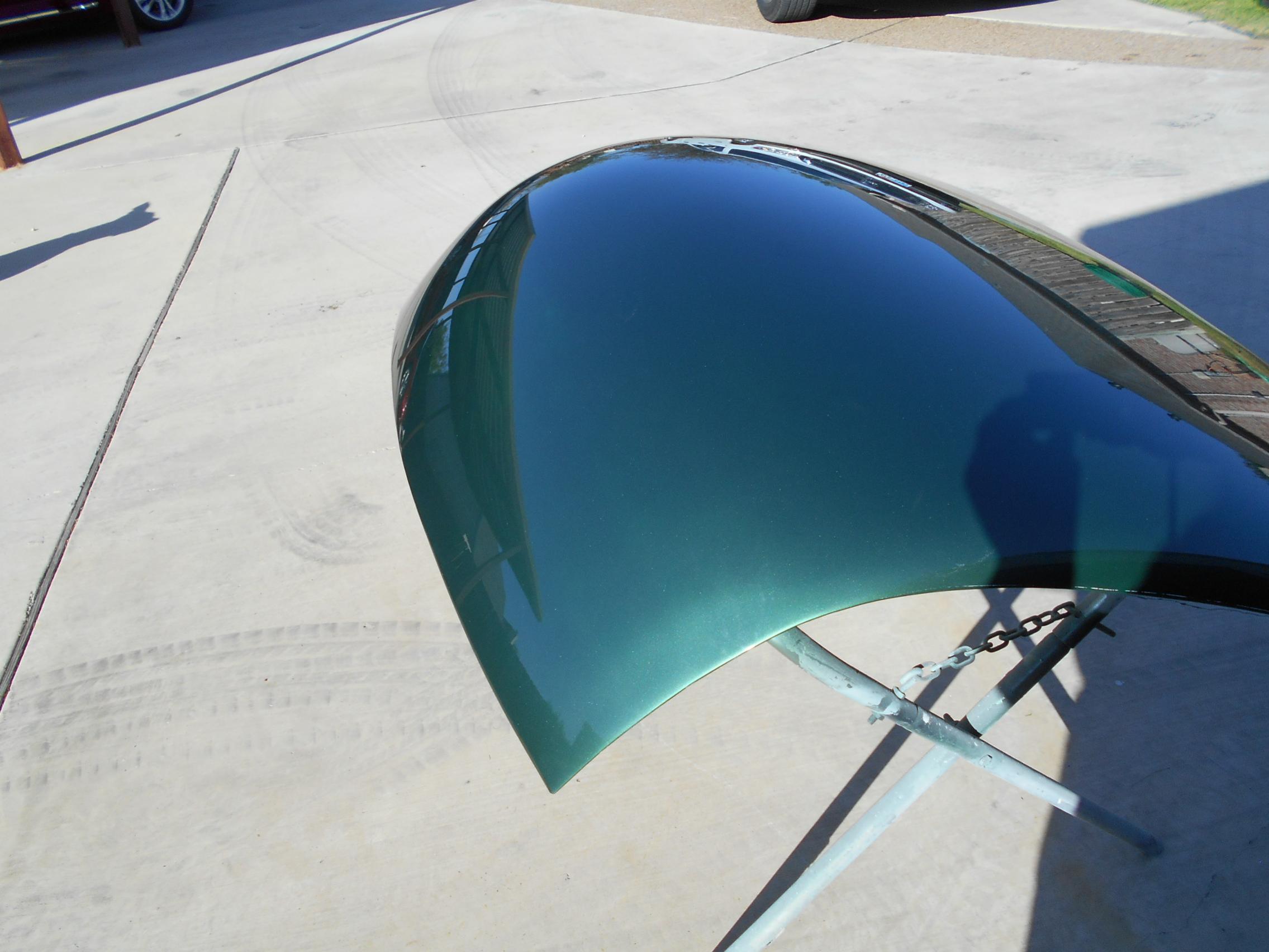

    WOW...that color looks soooo much better out in the sunlight!!
    LOOK'N GOOOOD Jer...........

    With all the young GI hot rodders in SoCal, the municipalities saw a way to pad the city coffers with money for anything that they could come up with to pull you over. Jesse’s response to this was to get creative. He figured if one of his license plate lights burnt out, the other one would be his cushion to keep from getting pulled over. He said he used some small lights. I’m using two repop glove box lights.

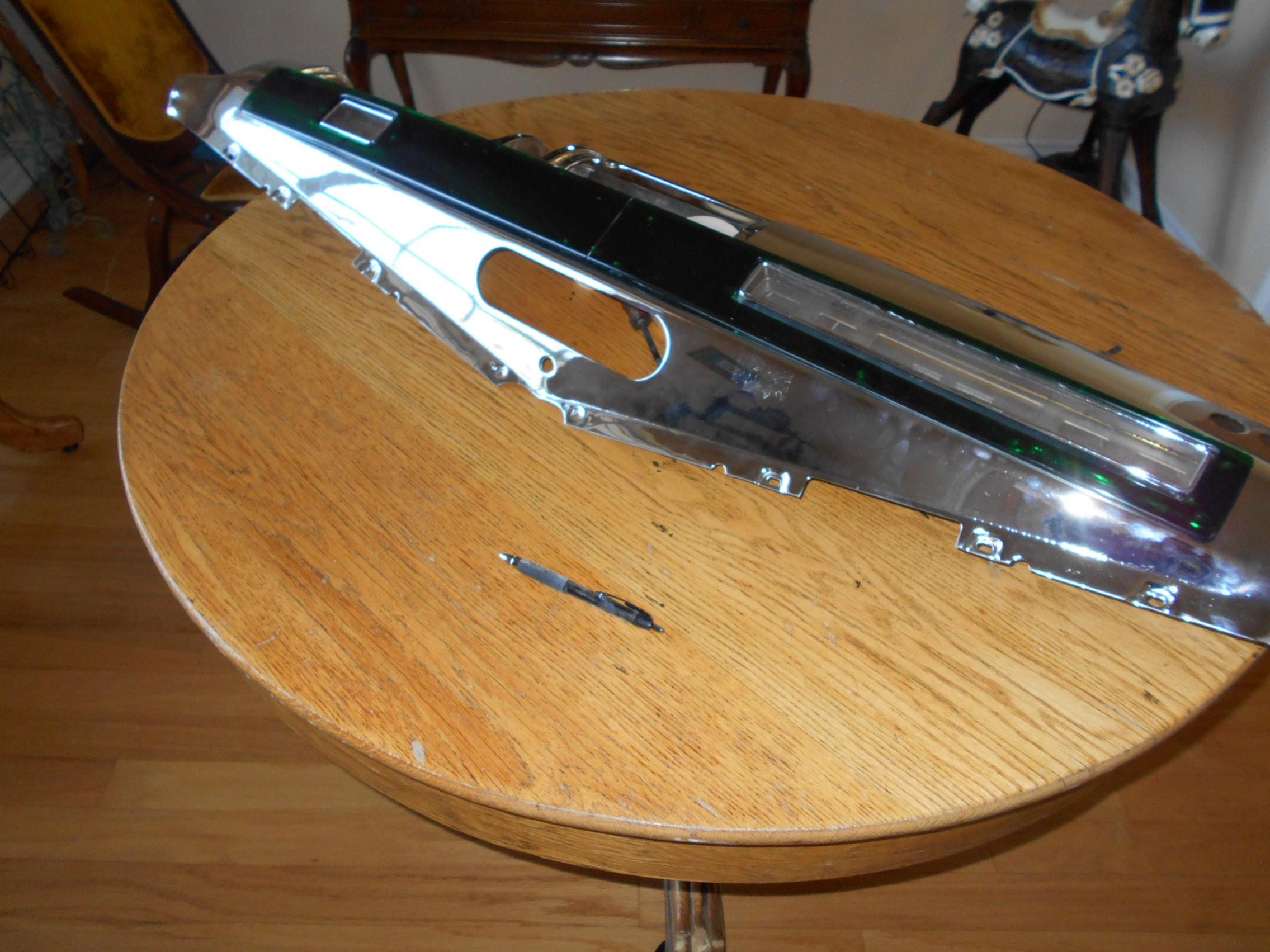

    Adventures in garnish molding land. The platers have told me that they will work with me to get the welded seams filled and polished. Oh goody.

    Here's the bumper/bracket (glued) back from Dan's shop. I painted the backside before he took it.
