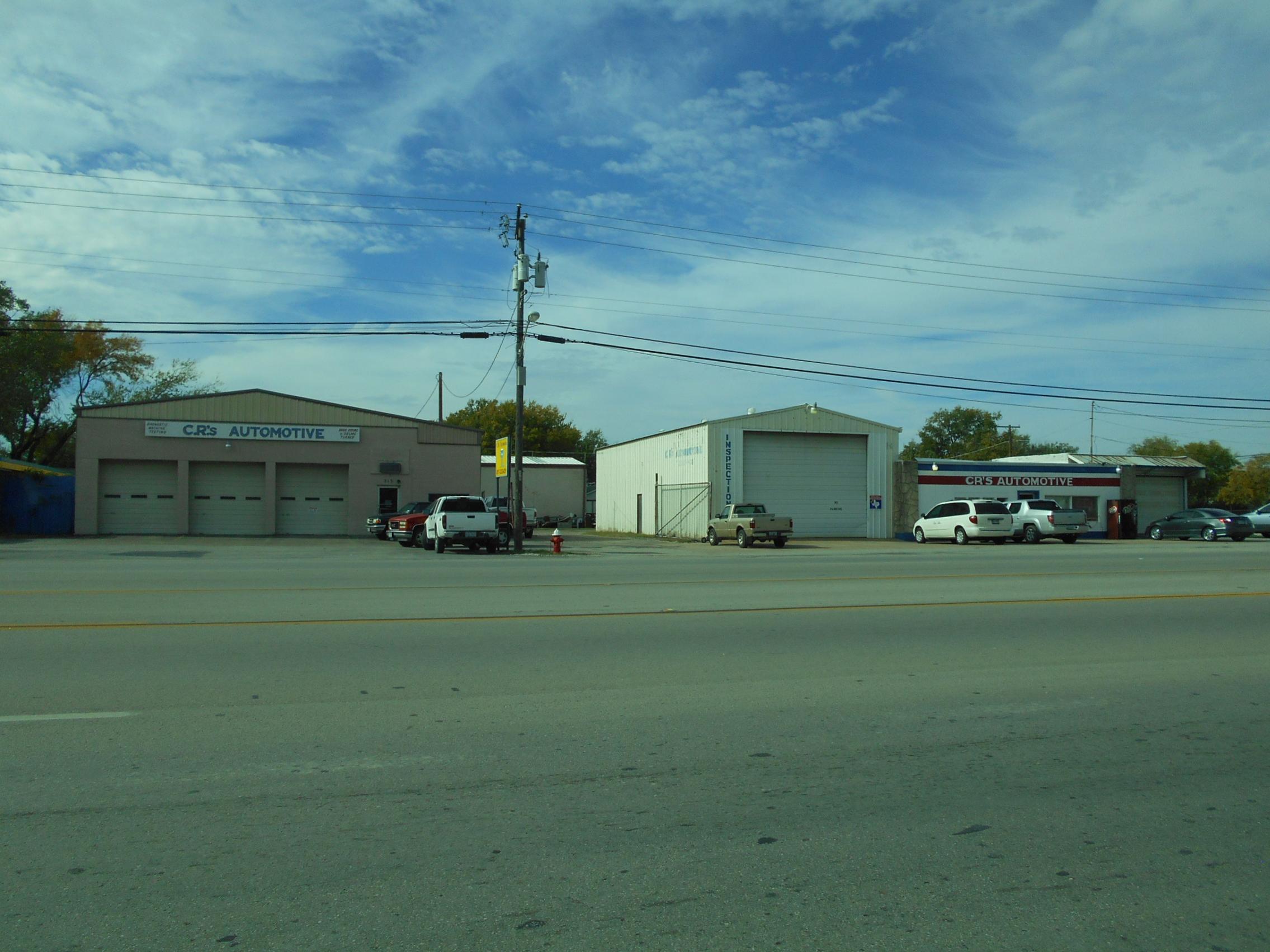

    This is Allen from CR'S Automotive in town. I dropped off some spotlight parts and asked him, "can you take these apart for plating?" I came back the next day and he had em' all apart, no problem.

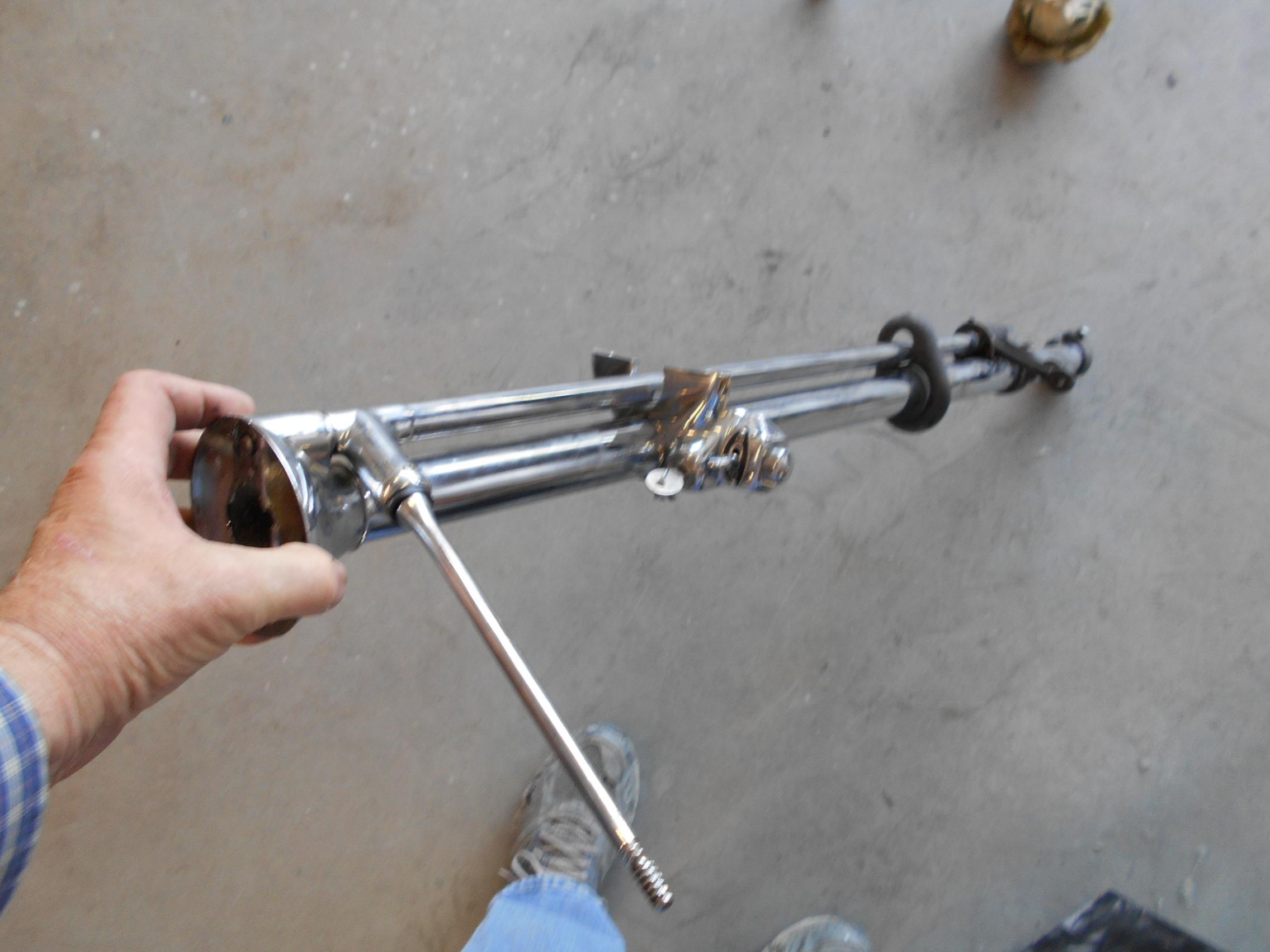

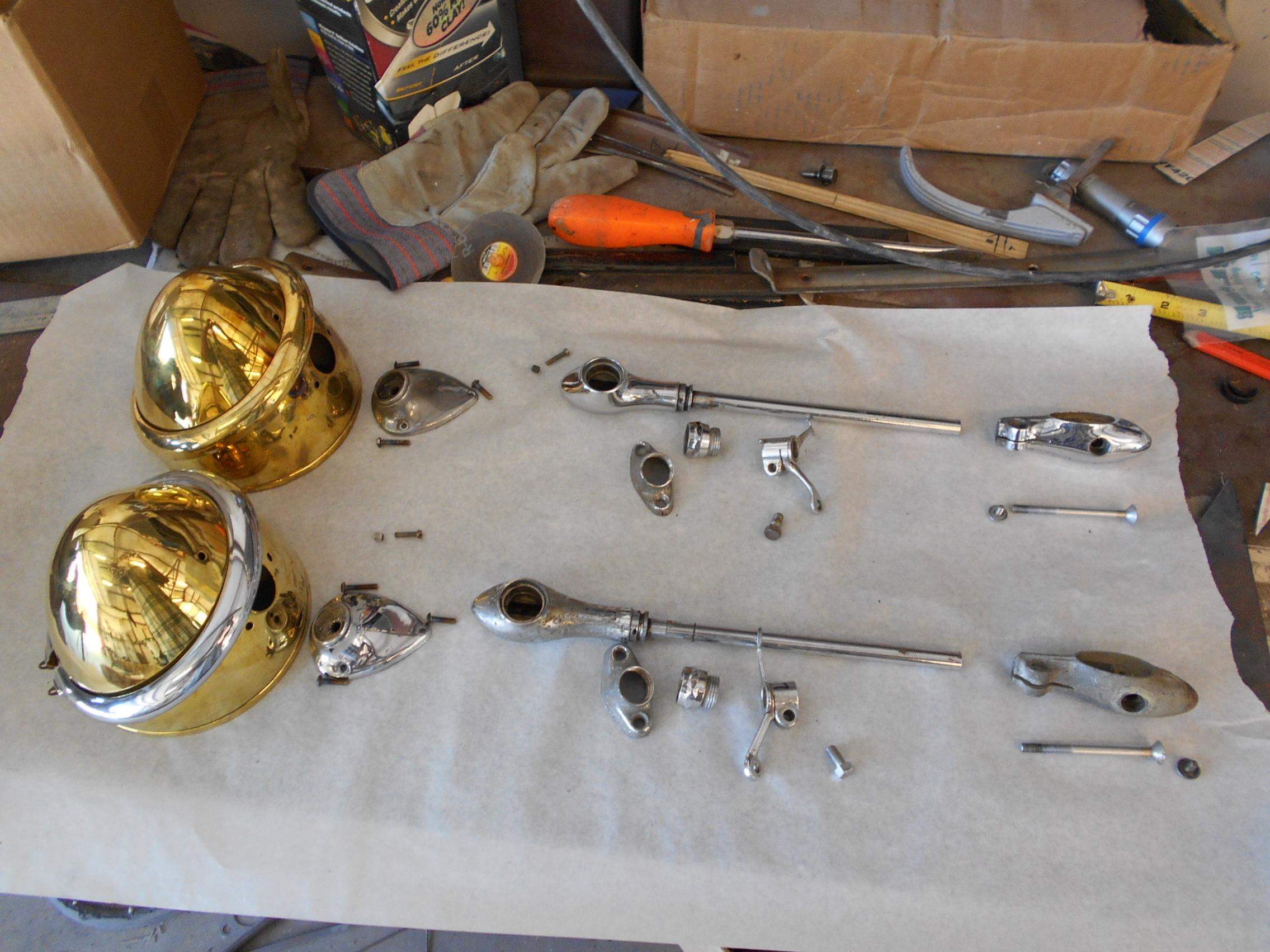

    Thanks everybody. Are you seeing the small Phillips head, polished, stainless, machine screws being used in the restoring of these spotlights? I took my machine screws and sanded off the Phillips part and, had them chromed. Now, I can't put a nut on it because of the plating. I can't force a nut on it because its too smooth to be held in a vice.
    Here's the parts at the platers.

    Looking good Jer! I figured a nice machine screw would work well to replace the Appleton rivets...can't wait to see them re***embled

    I don't know if there is enough room on the appletons to use these, but we have used them to replace previously riveted chrome parts to re***emble after plating. They come in stainless and can be polished easily. When installed, they look like the original rivets. These fasteners are 10-32 x 3/8" long (from under the head) and have a 7/16" diameter domed head.

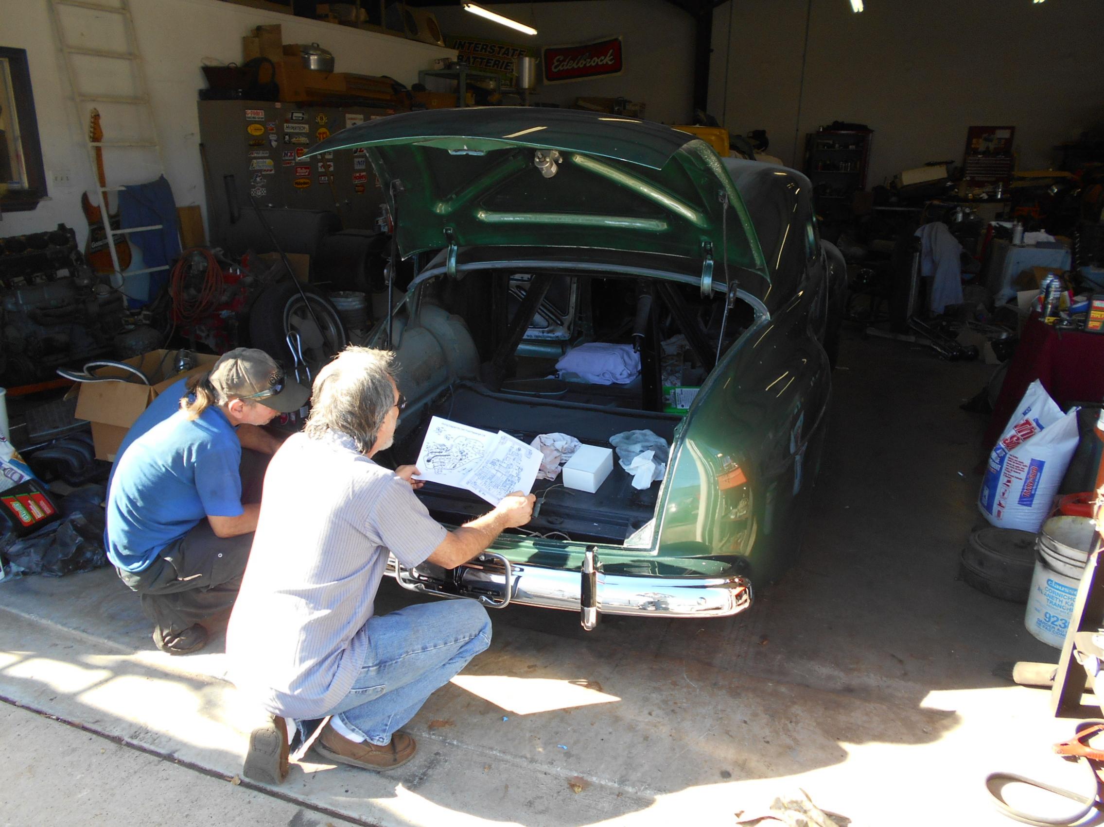

    OK, here's the chromed spotlights (I havn't looked at 'em'), with all the parts to put em' back together again.

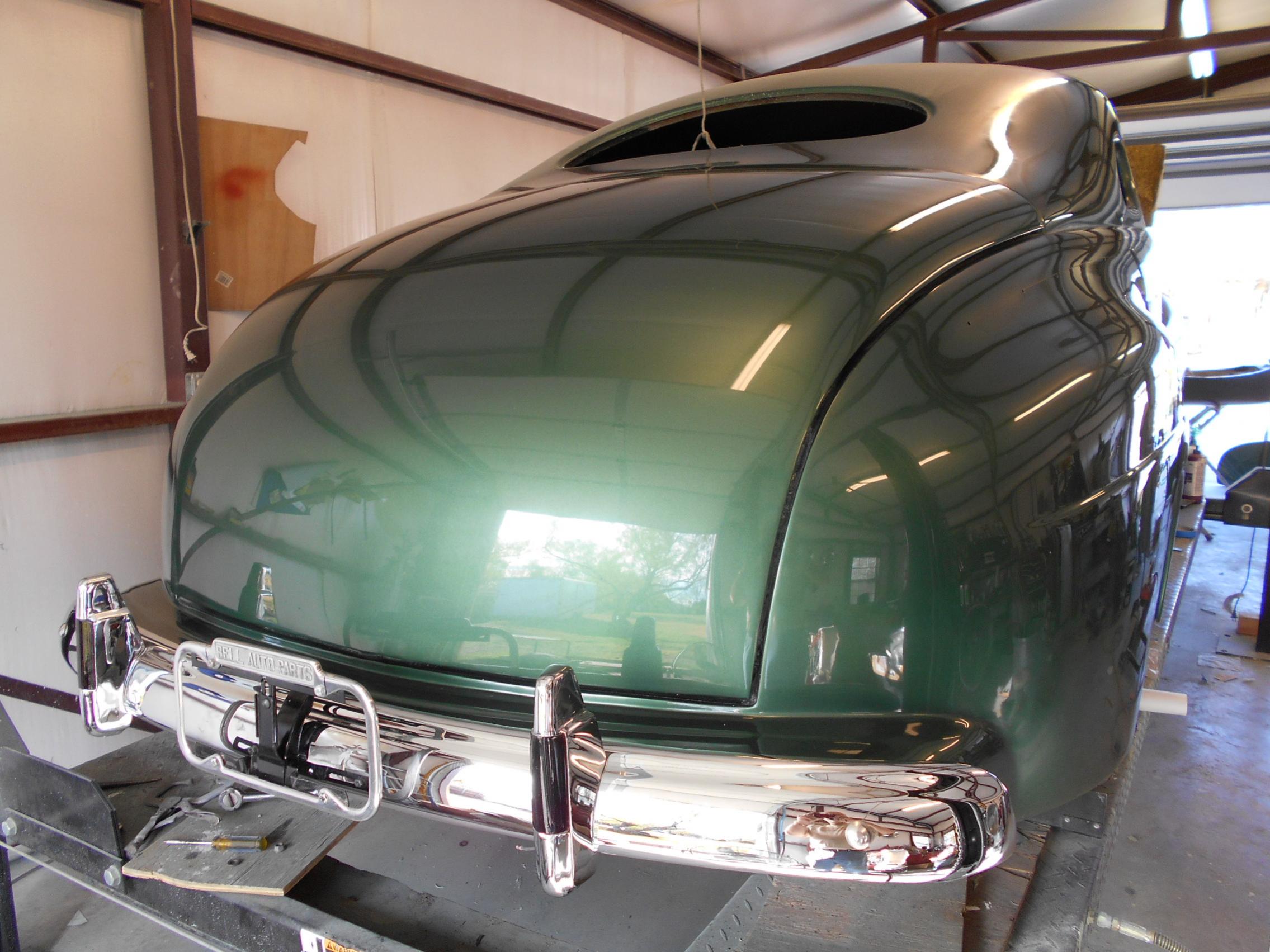

    Here we go.

    DAMN....that bumper, taillights, license plate bracket......EVERYTHING looks so AWESOME!!!!! Beautiful work Jer!!!
