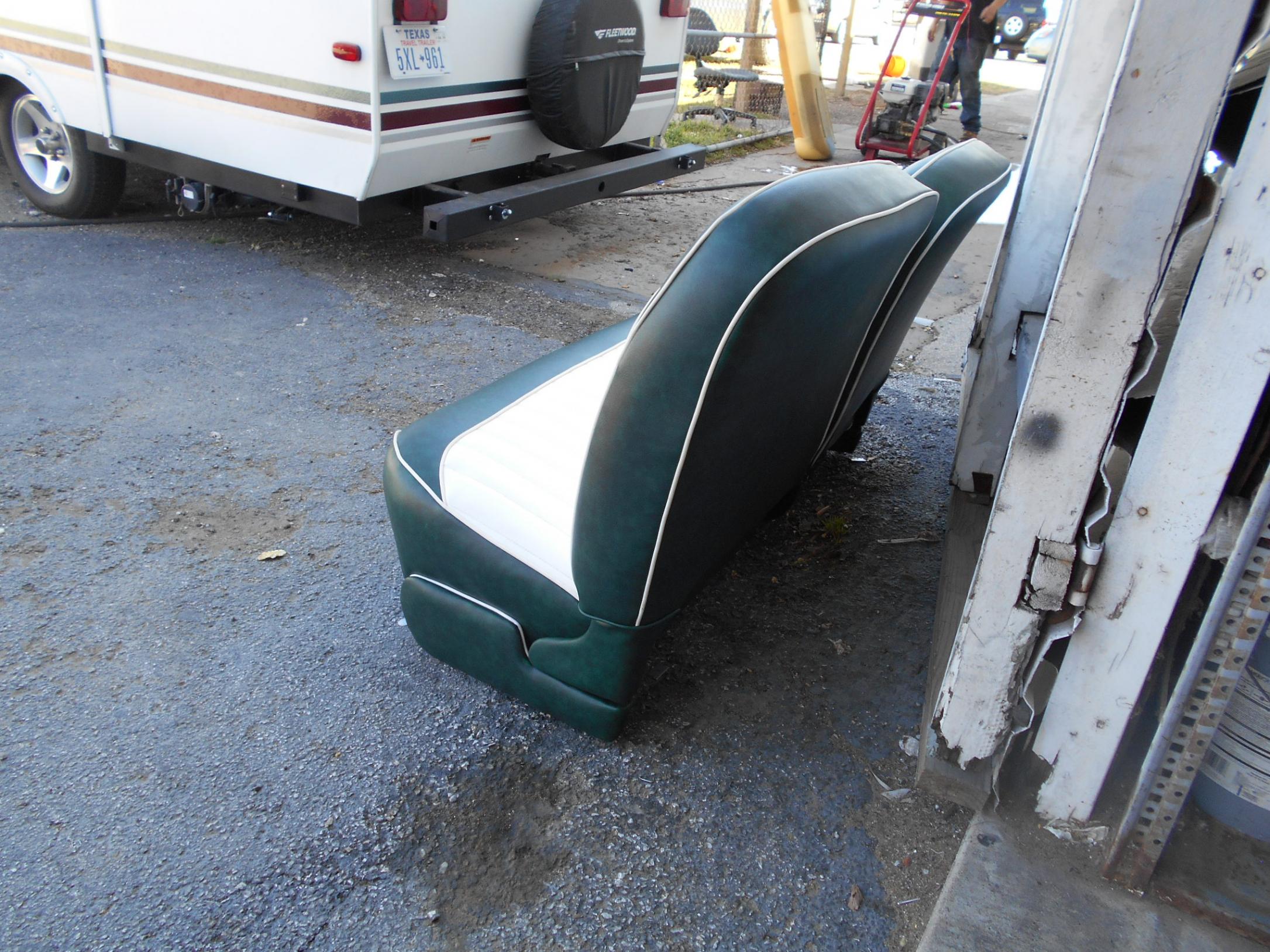

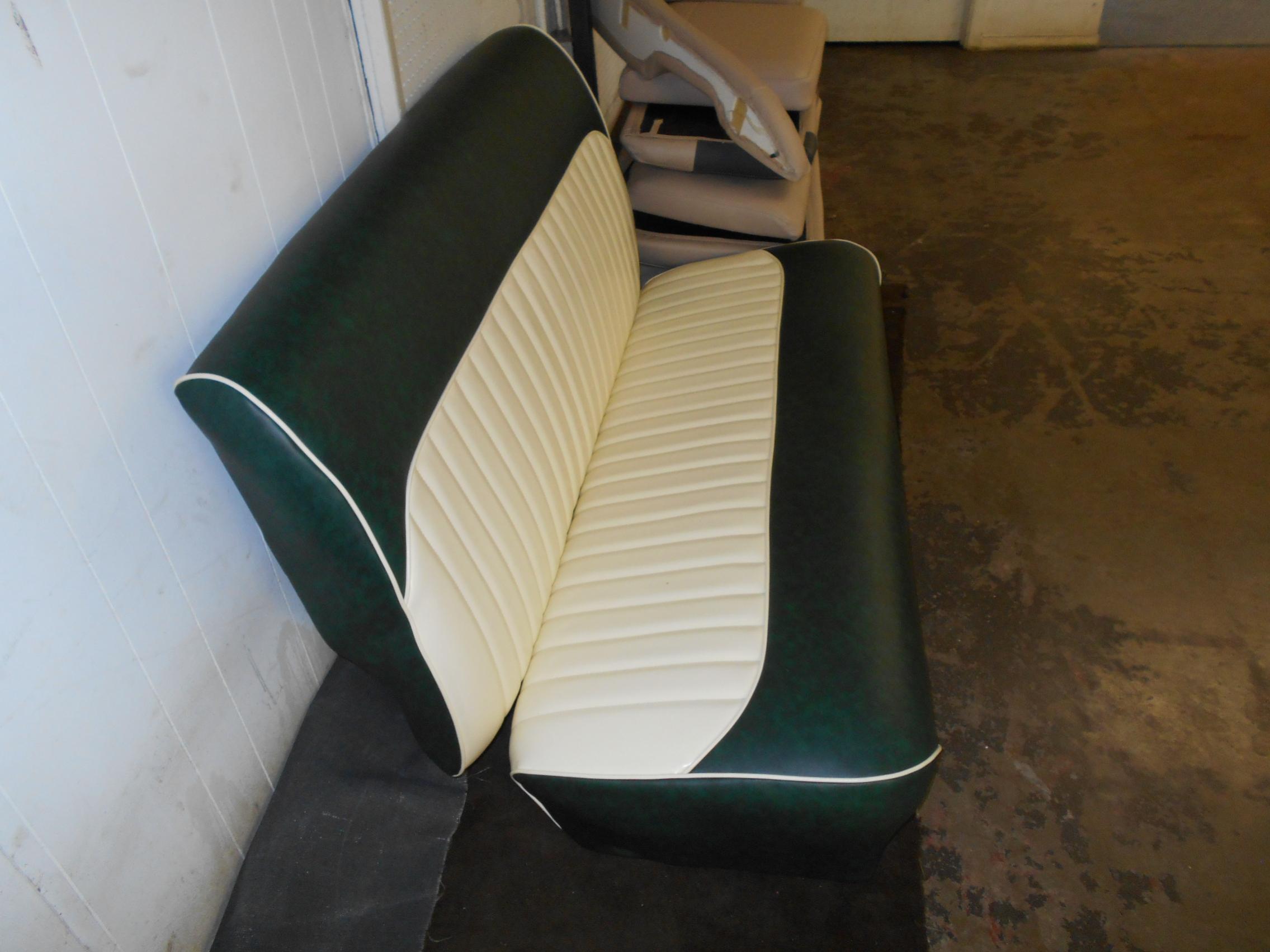

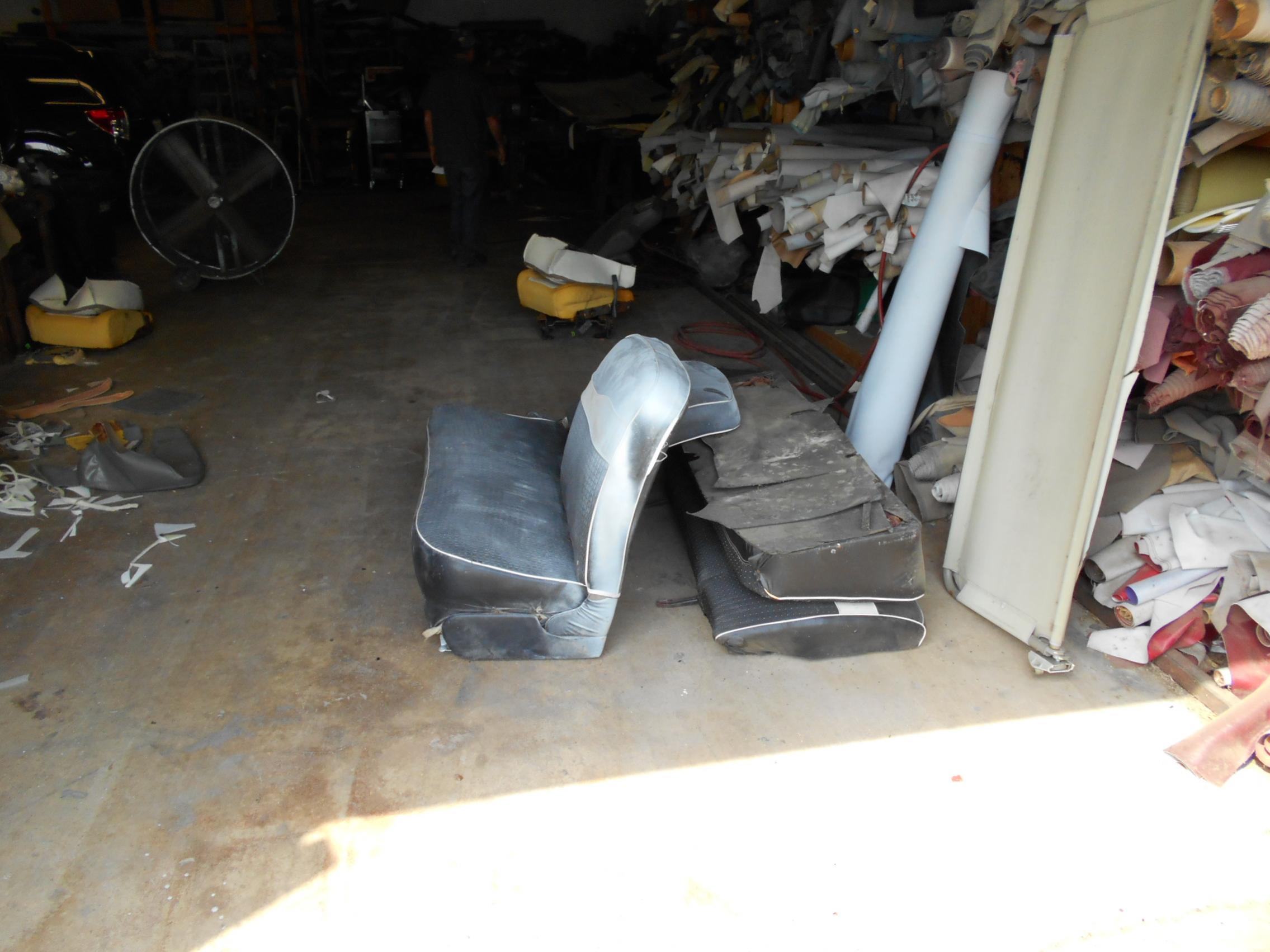

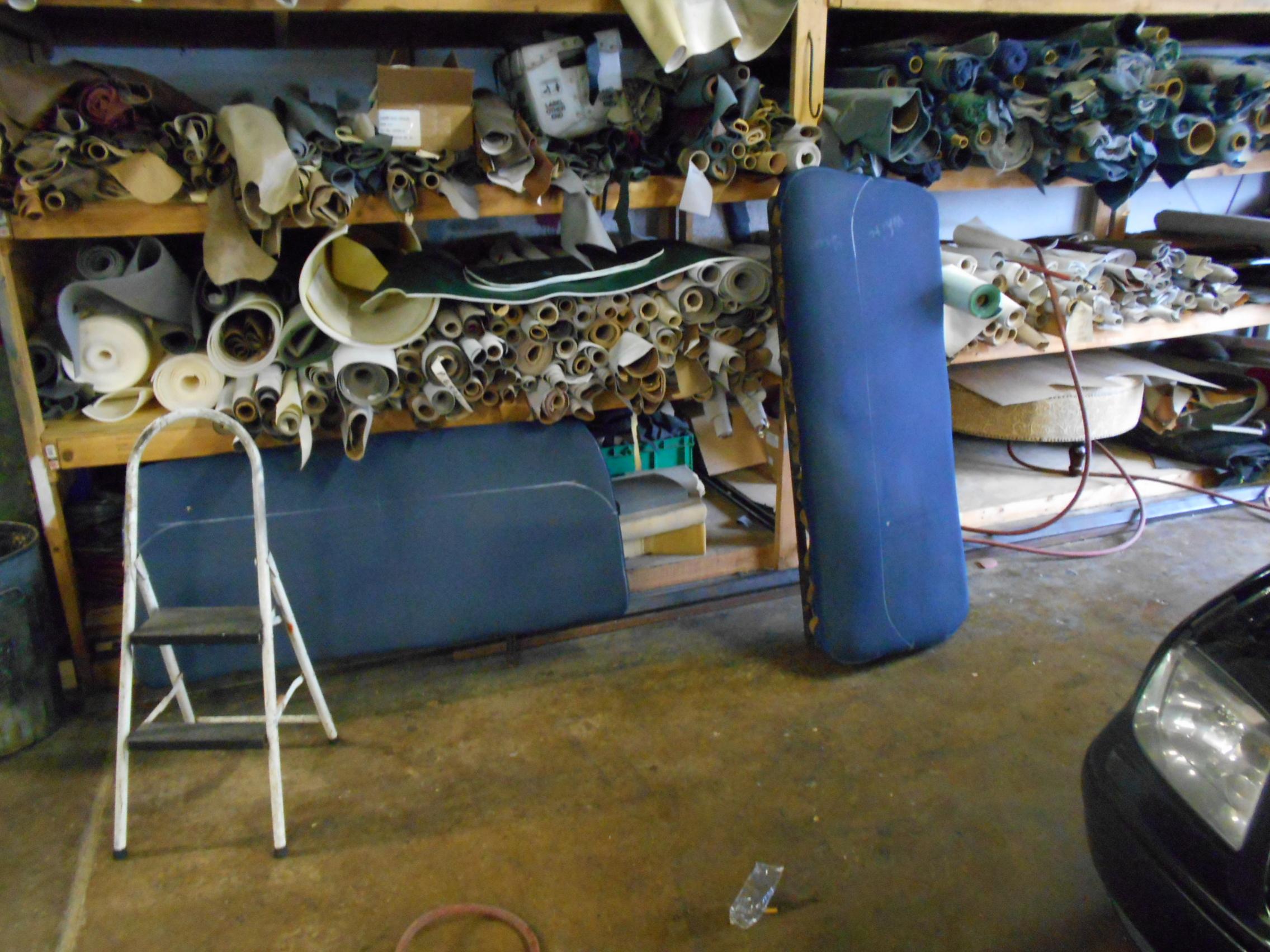

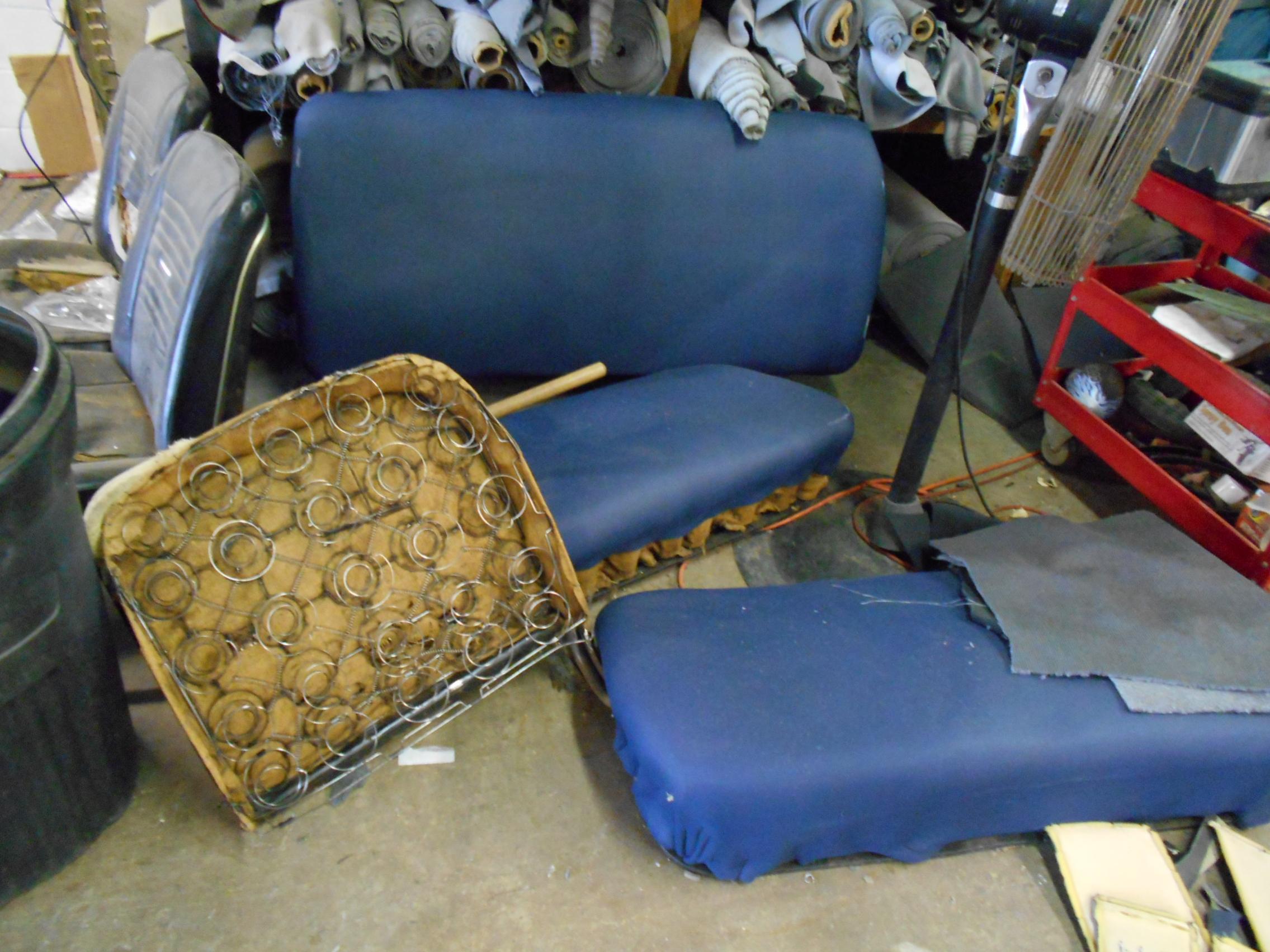

    Some months back I dropped off the seats at the trim shop that's going to do the interior. I wanted to get them out of my shop and, I wanted them done before I brought the car over. This would put the car there for as short a time as possible. Chris just called me to come over and look at where he's at. HORAAAY!
  9. Tnomoldw
    Joined: Dec 5, 2012
    Posts: 1,563
    Tnomoldw
    Hmmm! Wrong pictures . :(:confused:
  10. jivin jer
    Joined: Sep 14, 2008
    Posts: 3,535
    jivin jer
    That's when I dropped them off. Here's what He wanted me to see.
  11. Every stage generates more excitement.. This build is just plain thrilling to watch unfold! Thanks Jer!

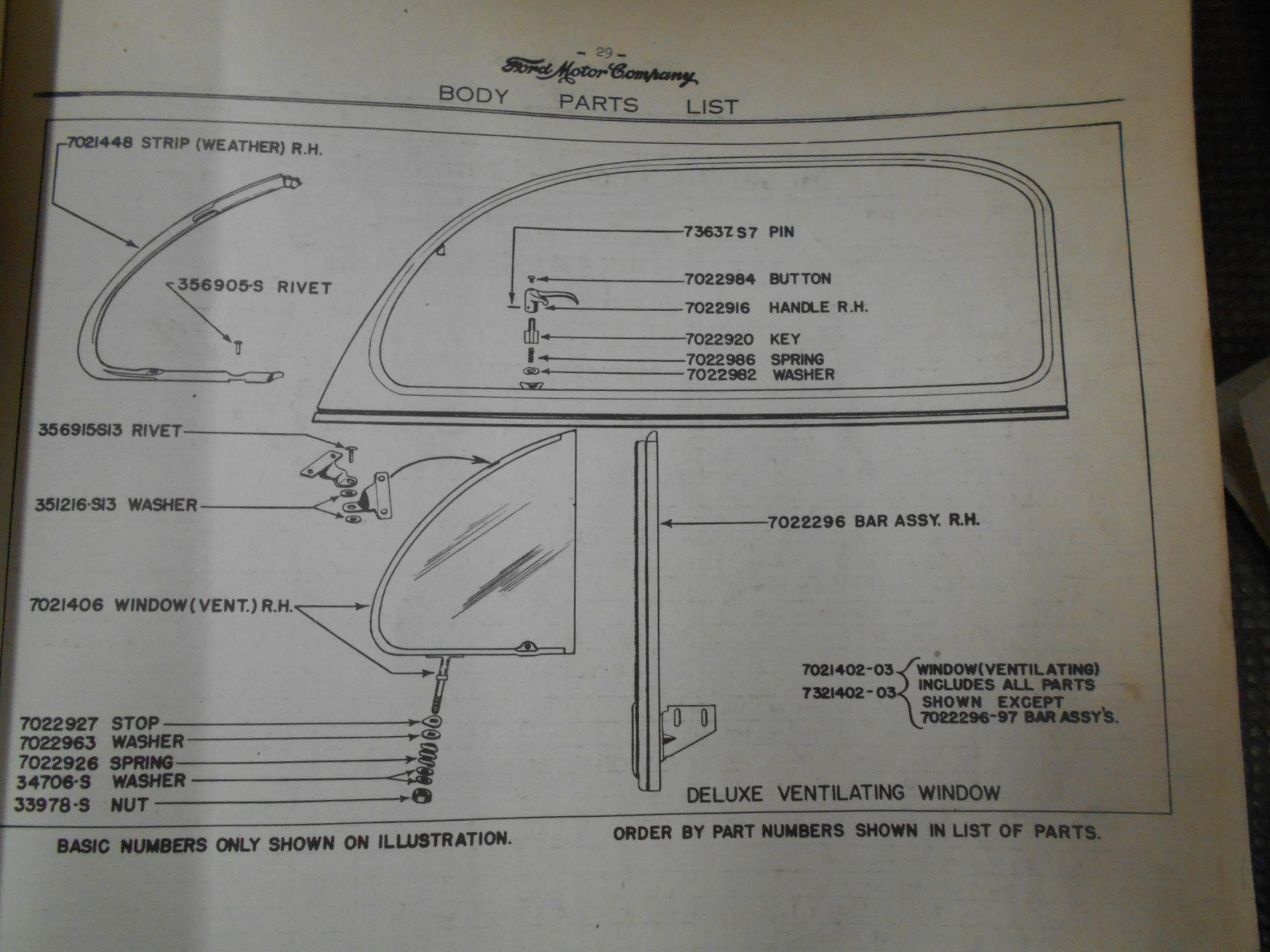

    I should tell you what's going on right now. I'm trying to get the car over to the trim shop next week. I need to figure out where I'm at with the door gl***. I've had the doors apart from the very beginning and I can't remember where all this stuff goes AND, where some of it is. I wish I knew where to go to see a blow up of the the door gl*** components, with part #'s.
    I'm going to try for that video next week end.

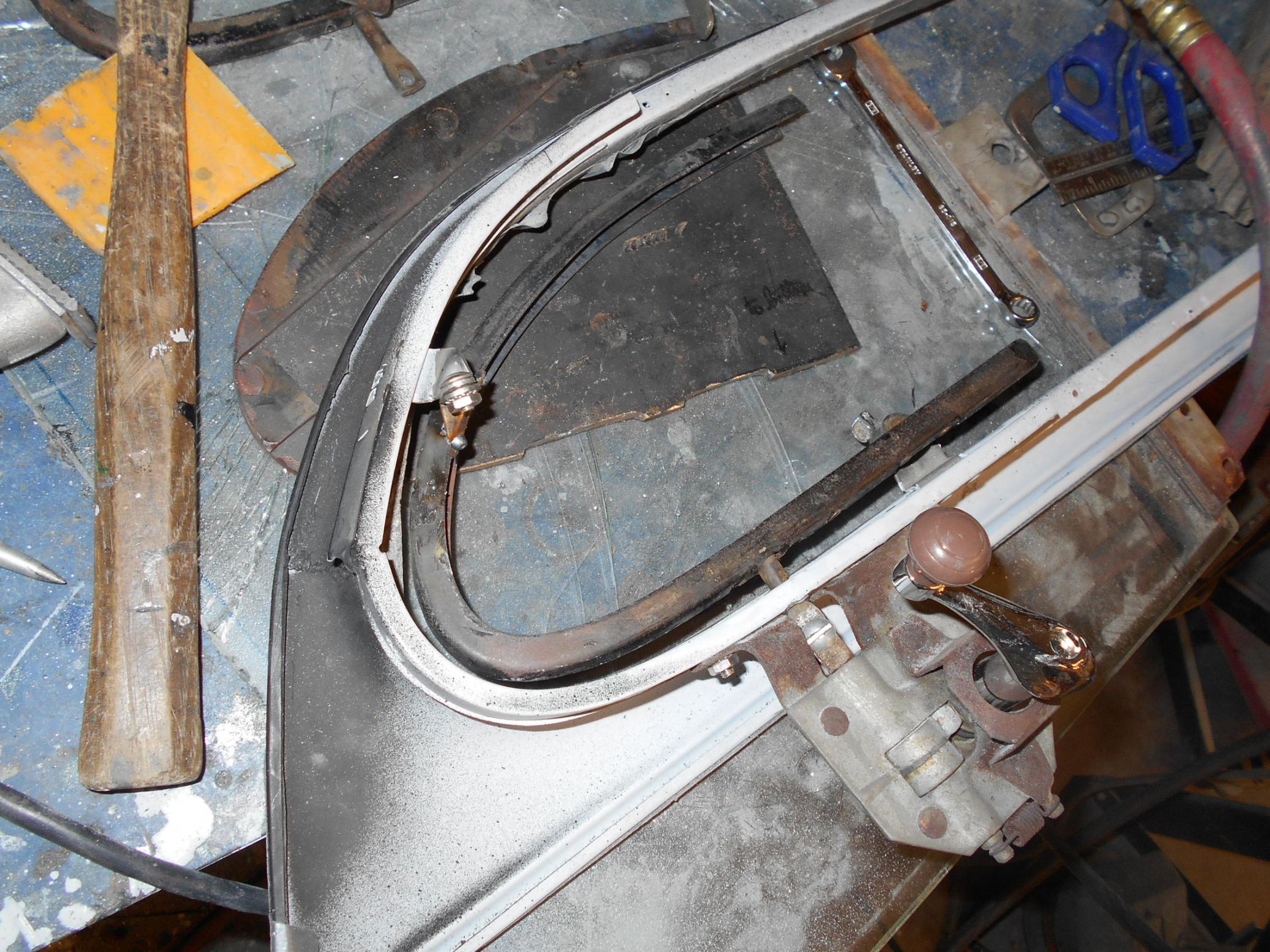

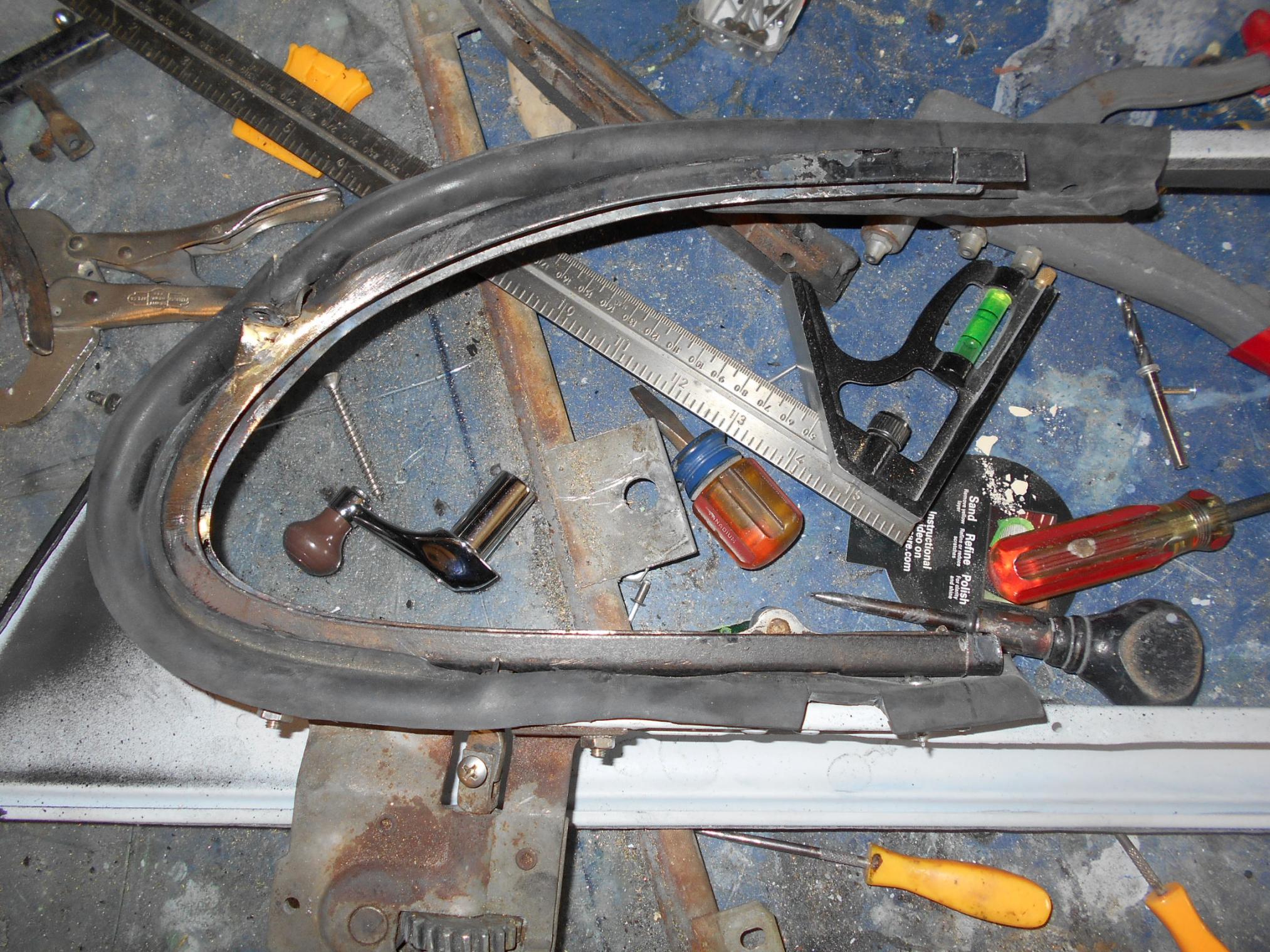

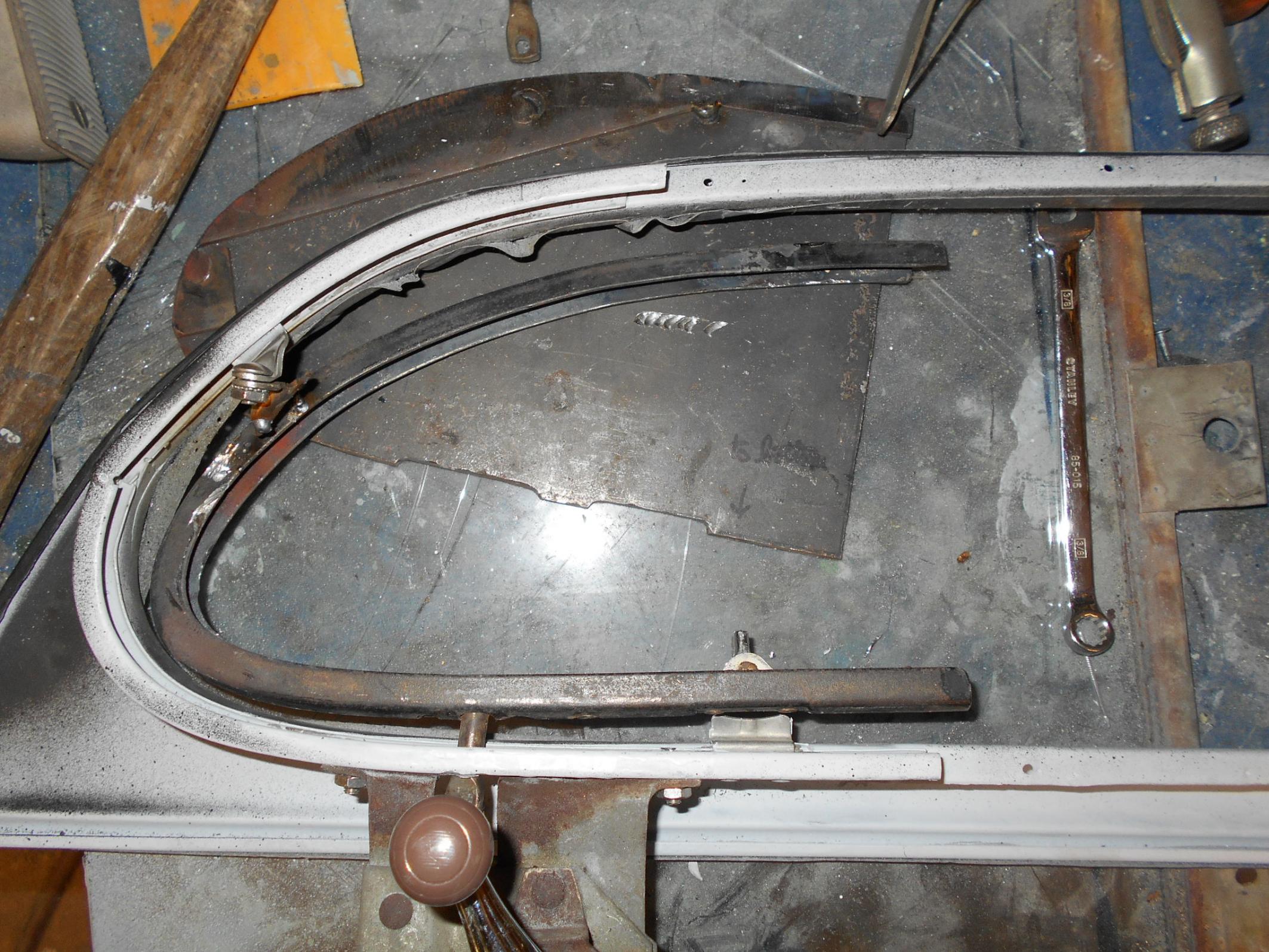

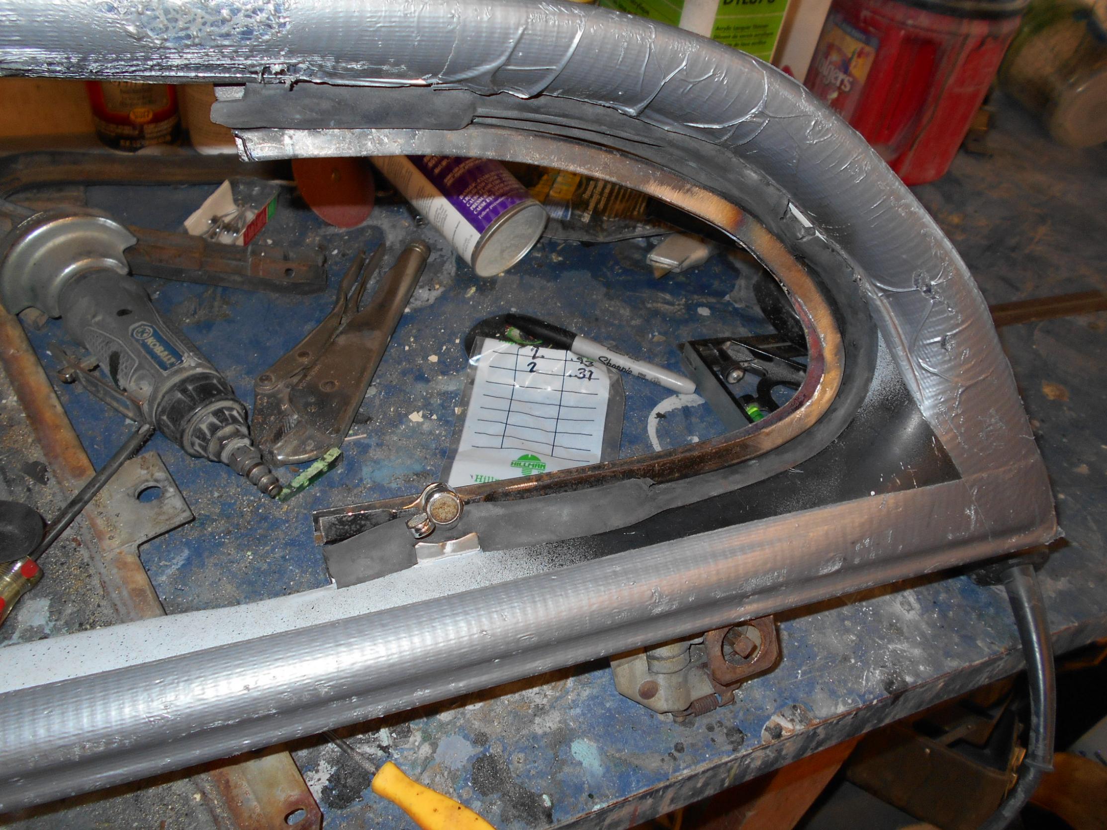

    I've got two sets of vent wing frames. One is black steel and, one is stainless. I'm using the black steel frames because they're easier to work with. I've made a buck that mimics the gl*** width with the seal. I'm using heat to form the correct shape. I will have them chromed. I sure would appreciate any pointers/tips on getting the upper pivot geometry correct so that the window will pivot out like its supposed to.
    Anybody?
  16. Torchie
    Joined: Apr 17, 2011
    Posts: 1,099
    Torchie
    I remove the upper pivot, shape the frame as necessary and reposition the upper pivot to where they will work correctly and then re-install the pivot.
    That seems to be the common way of doing it.
    Hope this helps.
    Torchie.
  17. jivin jer
    Posts: 3,535
    jivin jer
    Well, I can take all day and do a lot of damage trying to do this. I know that the guy's that have done this more than once or twice have a way that they set things up to figure this out. That's who I need to hear from. Barry, David, Miguel I know your watching this.
  18. clean cut creations
    Joined: Feb 8, 2005
    Posts: 1,352
    clean cut creations
    I don't know about anyone else's opinion, but I would just cut apart the top pivot from the garnish moulding, remove the mounting screw, run a long length of rod down through the top pivot mount to near the lower pivot and adjust until true vertical, then reweld. That way you can pivot the window frame and check for binding.

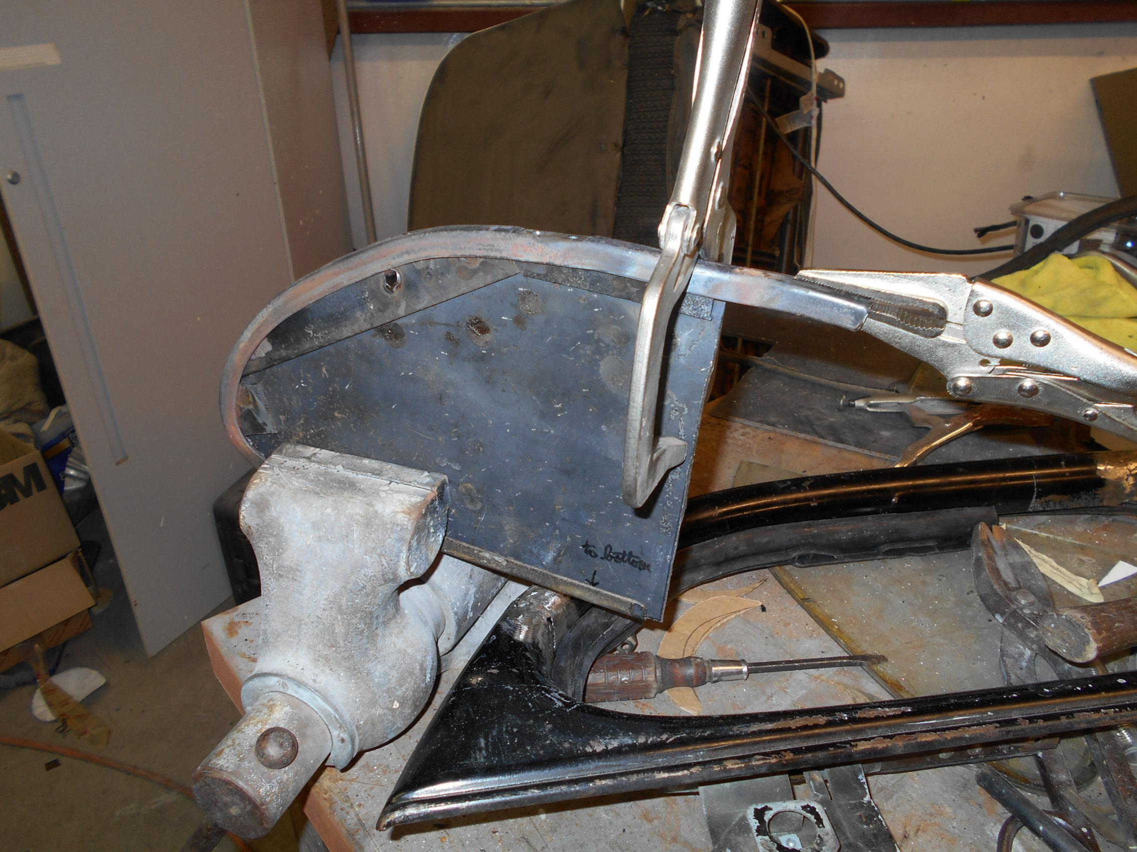

  19. jivin jer
    Posts: 3,535
    jivin jer
    Ok, I left enough room to r***il' the big, bulky, W/strip into place. There's lots of choppin' up, t*******, adjusting and destroying done in this process. The vent frame has to be shortened on the ends. The garnish mldg has to have the screw retainers positioned and spot welded. The garnish is "roughed up" as well as the outer door window opening. I should have done this before I painted the car.
    I can't take the car to the upholstery shop until all this is done, what a h***le. The best thing that happened was that I thought it was Friday when in fact it was Thursday. I gained an extra day. Don't tell me old age doesn't have built in perks.

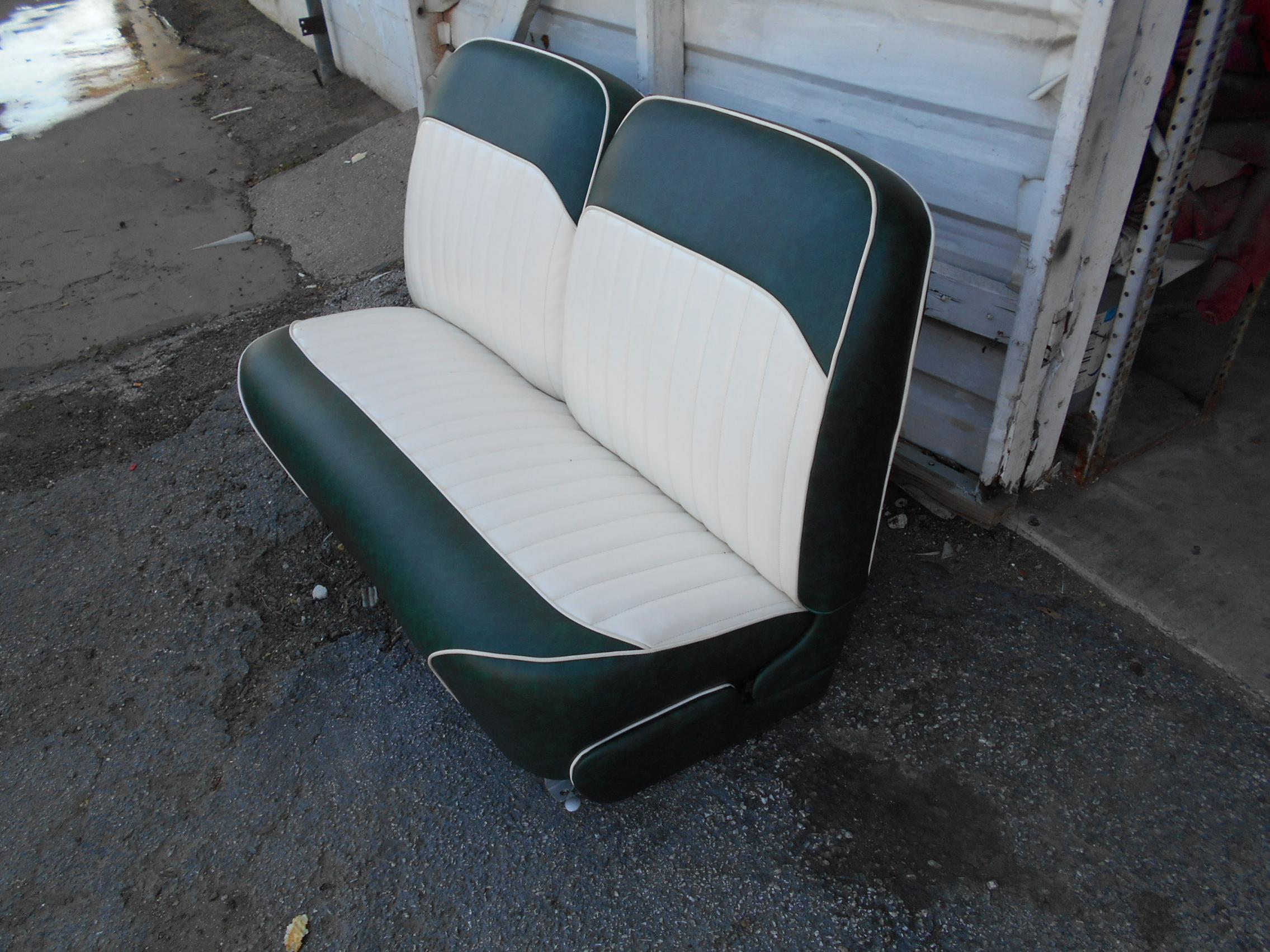

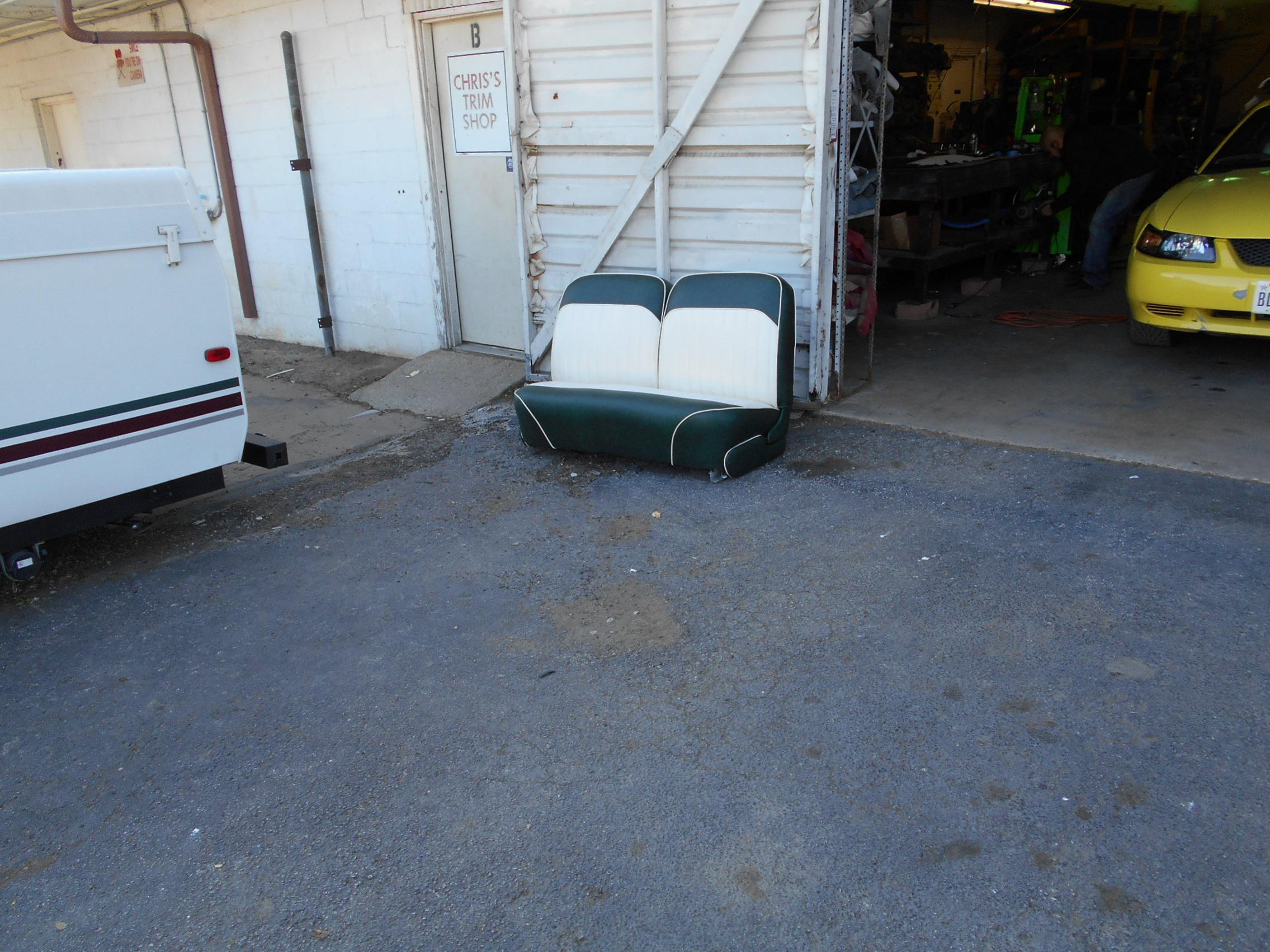

    Chris at Chris's Trim Shop called and told me that the seats are done. I hope to have the car over there this week.
    I'm very happy with the effort to get these right. I'm looking forward to having the car done.

    That flathead sounds great Jer ! The seat is the ***s !
  26. K13
    Joined: May 29, 2006
    Posts: 10,016
    K13
    Seats look great Jer!!
  27. Looking good Jer,loving those seats.
  28. LeadSledMerc
    Joined: Nov 29, 2003
    Posts: 4,106
    LeadSledMerc
    Those seats look great...I can't wait to see more! :cool:
