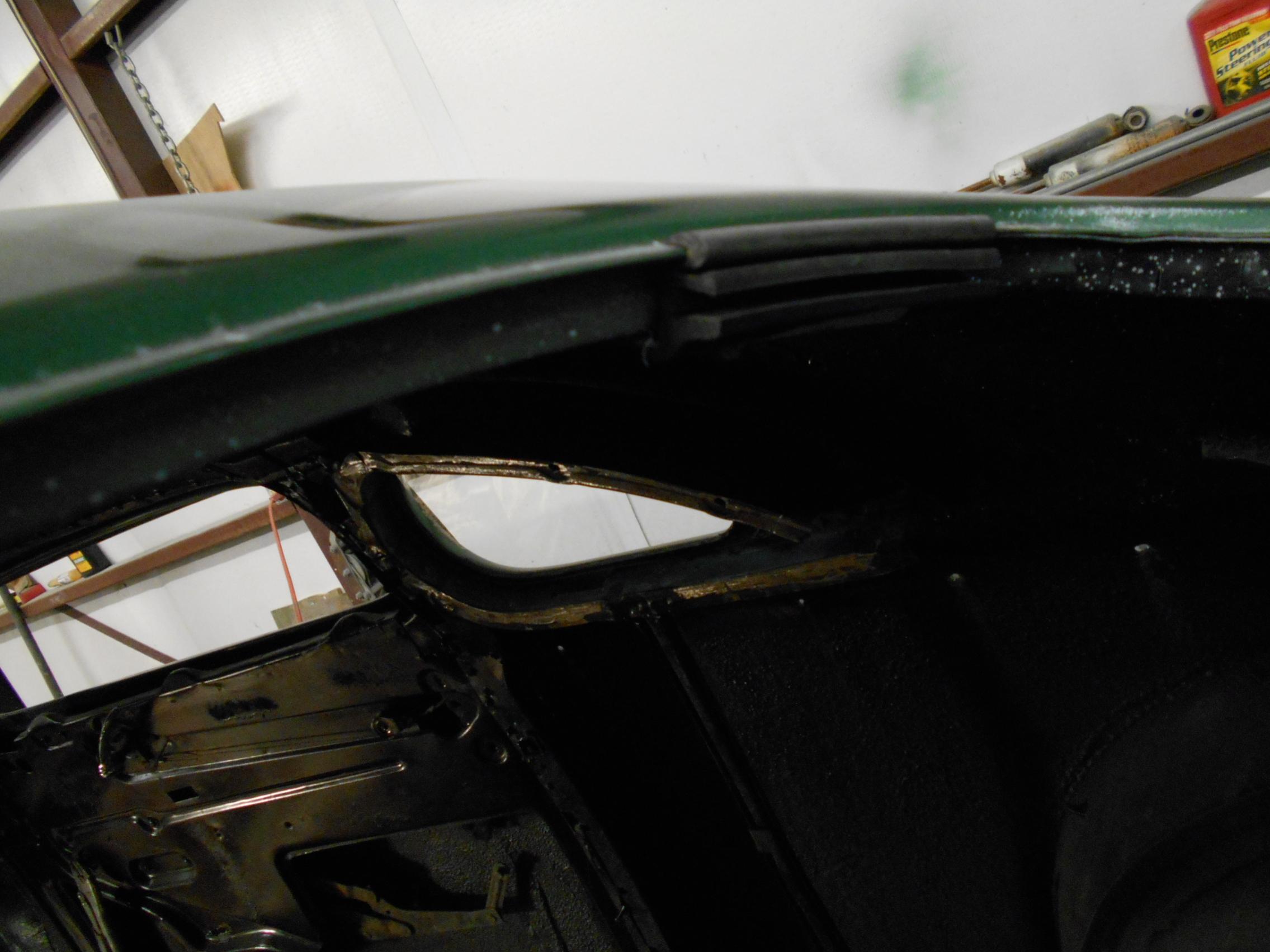

    I want to have the garnish/vent windows done, a big job. I have wthe windshield gl*** cut, the gasket has to match perfectly.

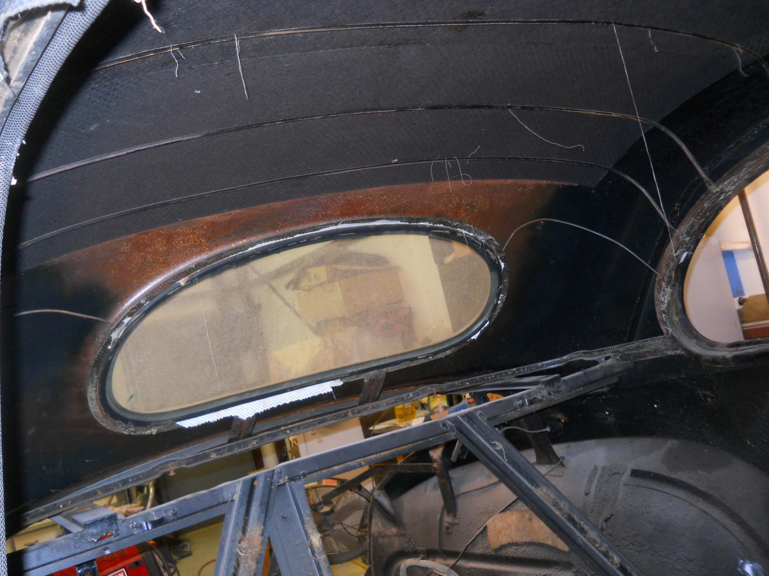

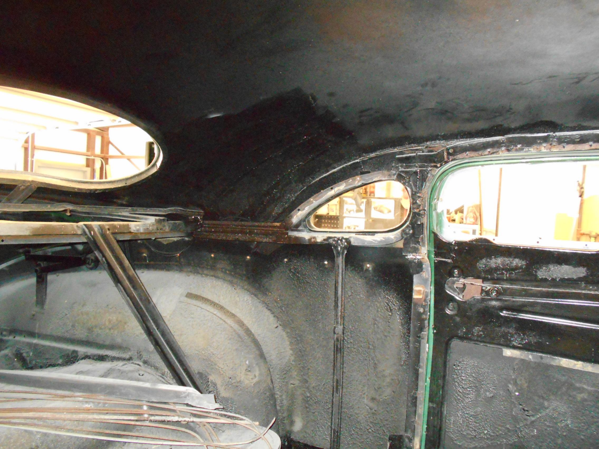

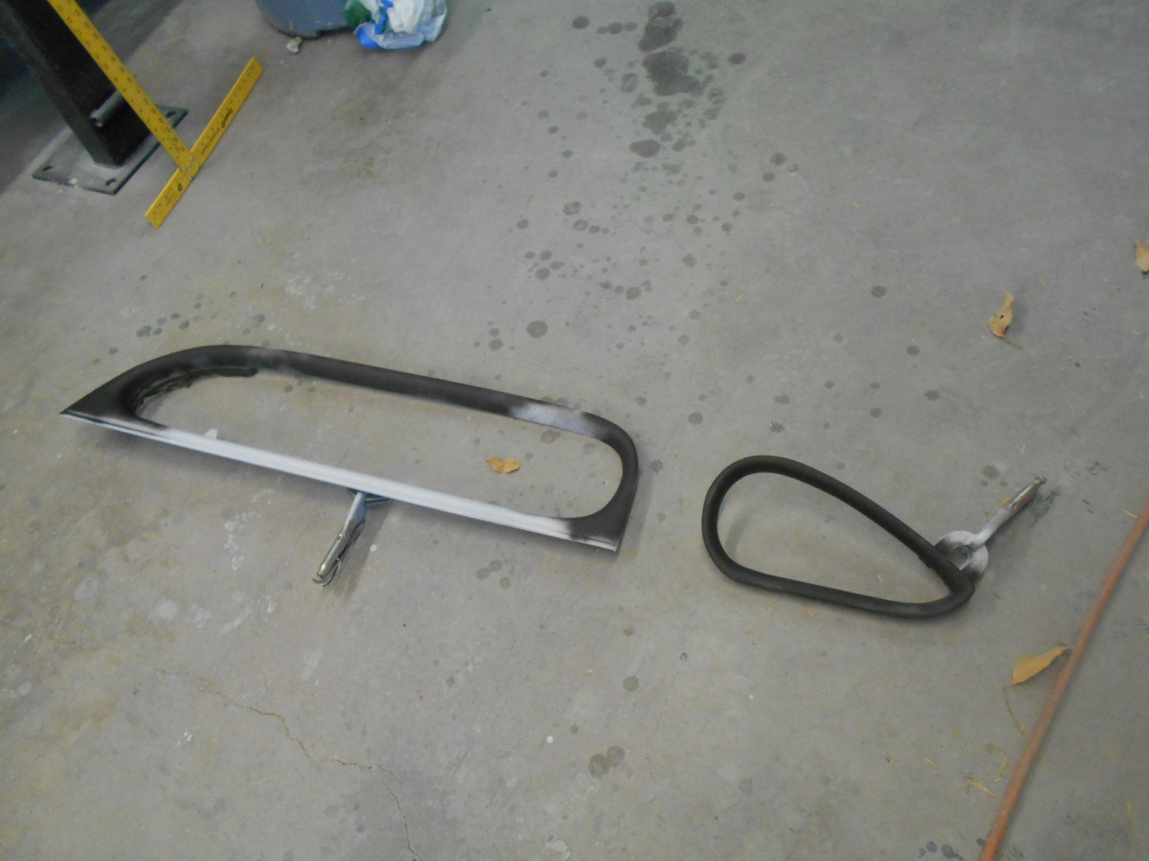

    The back gl*** has to be dealt with before it goes to the trim shop. By looking at the old cut up gasket, the gl*** (plexigl***) turns out to be an 1/8 of an inch larger than the new opening.
      247 KB
      538
      280.9 KB
      645

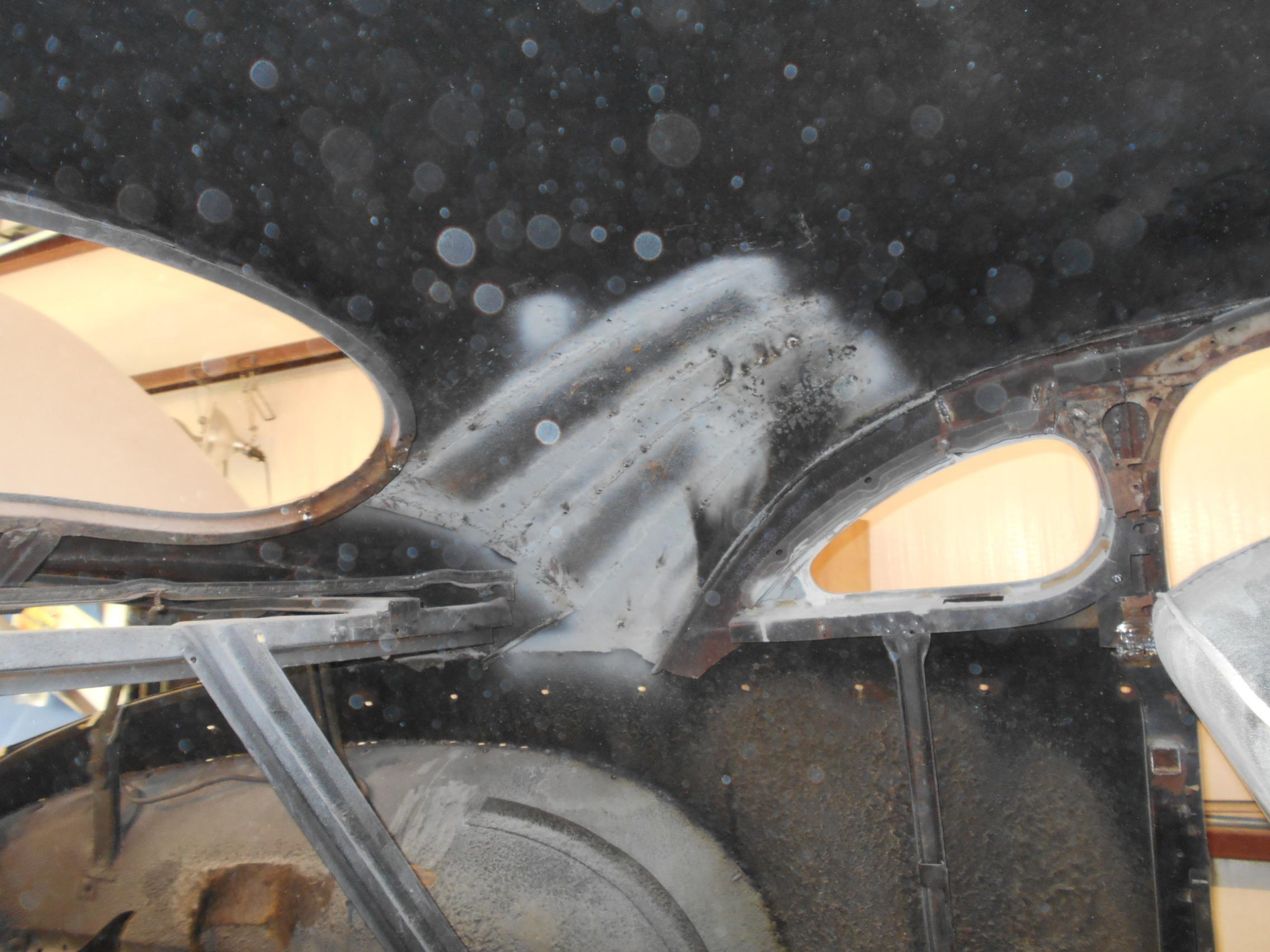

    Looking good...aren't you worried about your inner structure not being attached where the C pillar and rear of the quarter window matches at the beltline? :( ???

    WHOOH, WHOOH, WHOOH, DROP THE ANCHOR.....STOP!!! I'm not aquainted enough with these cars to notice this MINOR detail. I've found some pics in this thread that helps me see this problem. Does this connector (gulp) weld to the inside of the outer panels or just to the inner structure pieces?

  14. cleatus
    Joined: Mar 1, 2002
    Posts: 2,277
    cleatus
    from Sacramento
    It welds to the inner structure piece only, not to the outer (body) panel.
    If it connected to the outer panel, you'd end up with a wave in the body reflection if the inner structure ever got a big jolt (like a big guy flopping down in the back seat).

    Thank you very much! The HAMB, there ain't no place like this place.

    OK, we're back on course. Thanks guy's, good save.
  17. shoebox1950
    Joined: Jul 17, 2008
    Posts: 1,221
    shoebox1950
    There ya go, Jer! I have to say though that that's not a minor thing...it's a very important structural piece. Anyway, your Ford is looking great and I can't wait to see it finished :)

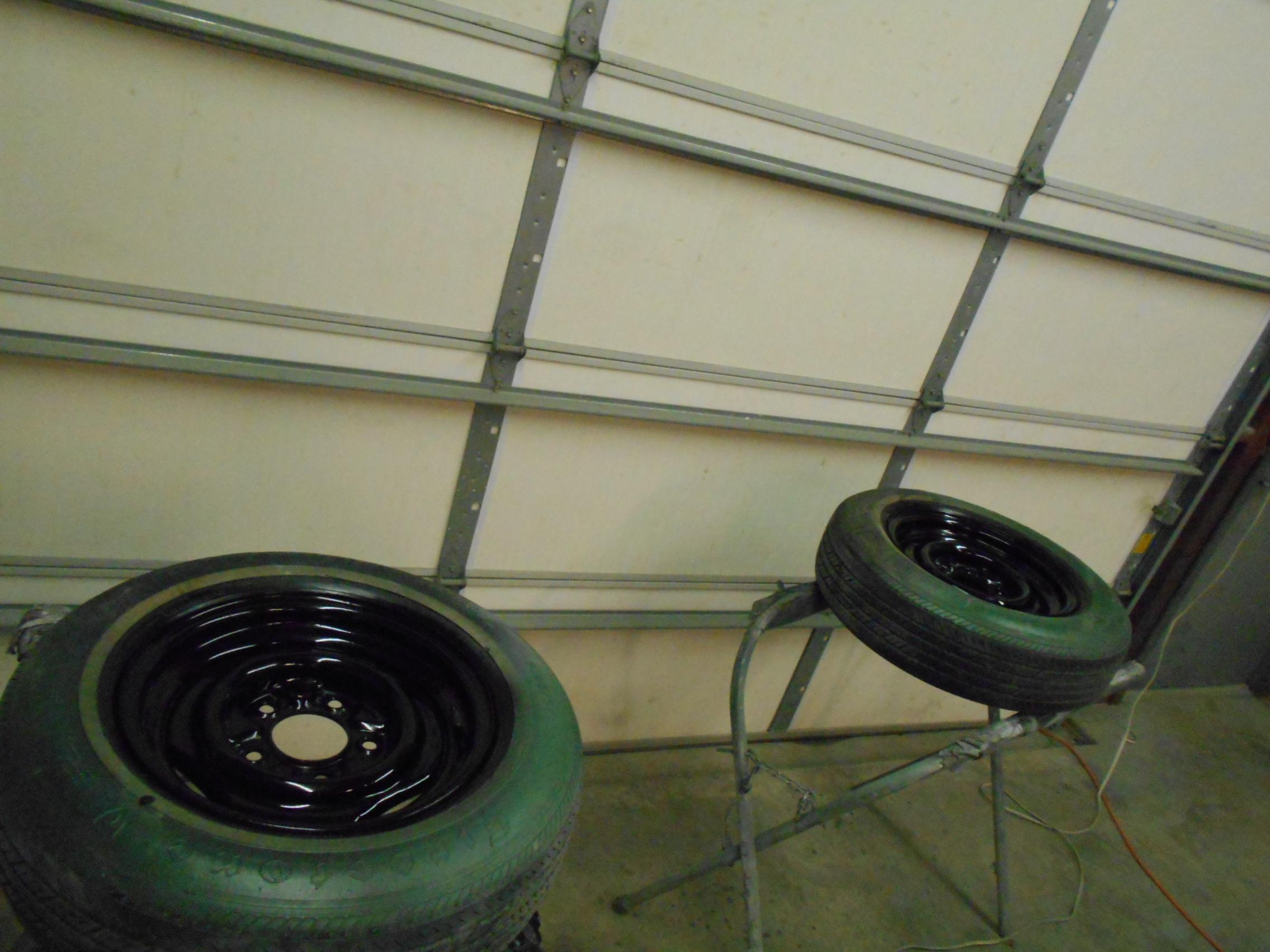

    I CAN do more than one thing at a time. I might as well get the "booties" squared away. Jesse said that the wheels were black.
