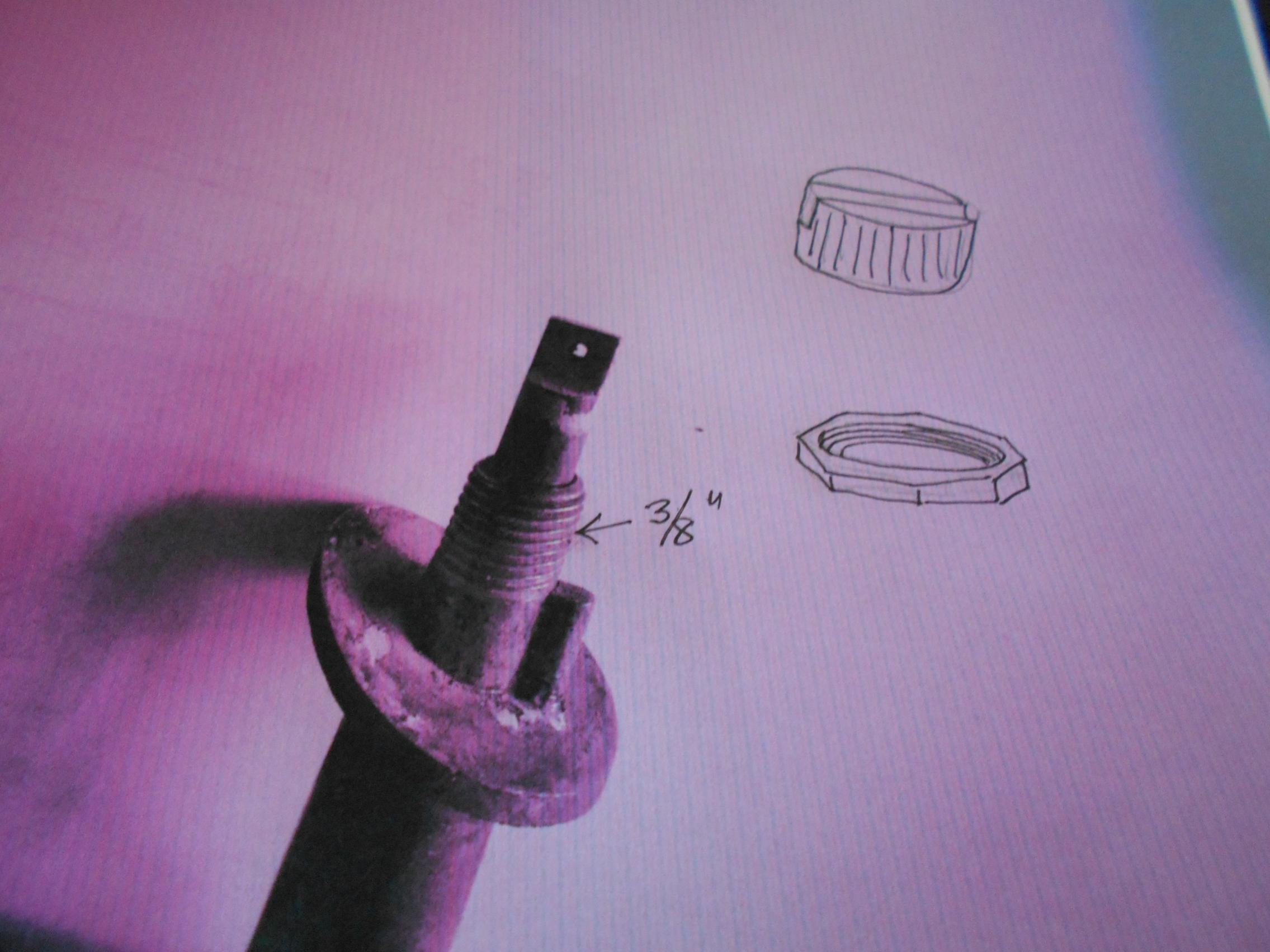

    Hey guy's, I need some help. I've been trying to find these two items without any luck. I know they're out there. It's the wiper "head" on the pivot shaft that comes up through the cowl. It's the grooved "head" that the wiper arm would push onto to be installed. Also the retainer nuts. What I got from Dennis Carpenter is too big. I need them for both sides. HELP!

    I've got a a set of the splined heads that the wipers push on to. I might have the nuts you need too. I'll have to check. BTW your build has really been an inspiration for me to finish my 46 coupe. Mine is going to look a lot like Snooki's 41 when its done. Any tips on chopping the garnish moldings, or vent windows/

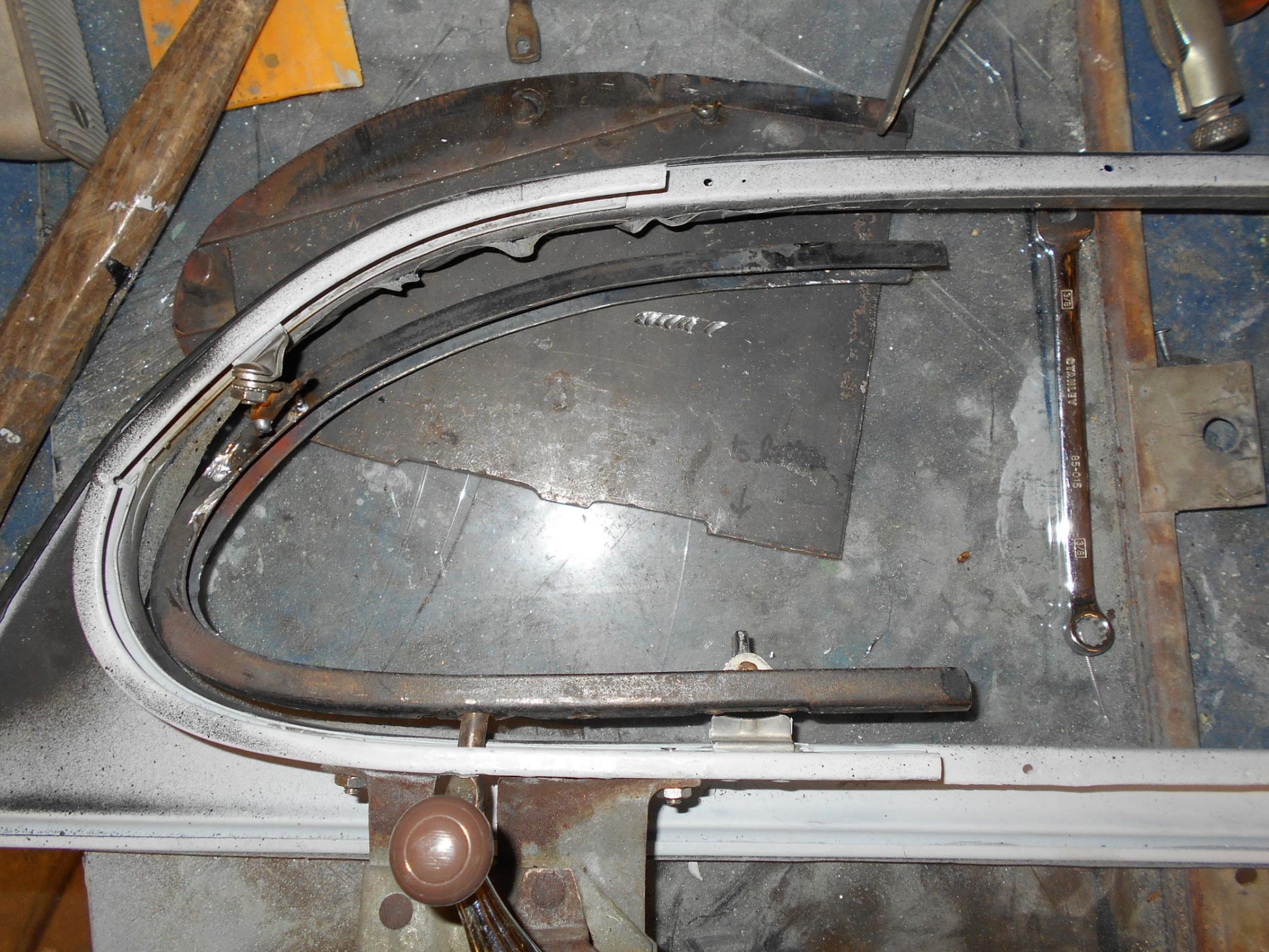

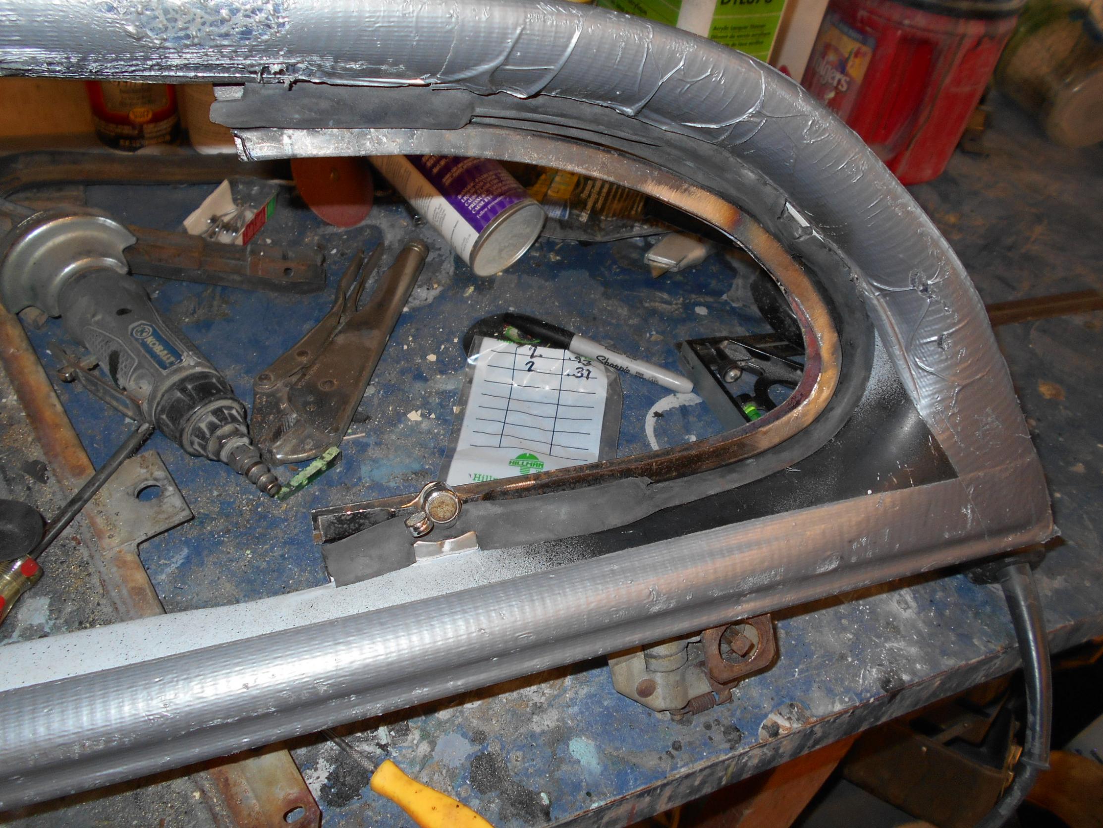

    MATT! (ol' buddy). I made a buck out of 1/4" plate that was the shape for the gl*** in the vent opening. It has to be double thickness where the vent frame is going to be stressed as it's pulled (while hot) over that shape. This means no chopping and fitting and welding on the vent gl*** frame. Worked really well. You'll have to cut the ends to fit at the door gl*** to fit.
    The more radical the chop the more work. If your going to paint the garnish moldings you got it made. If your going to chrome them, not so much.

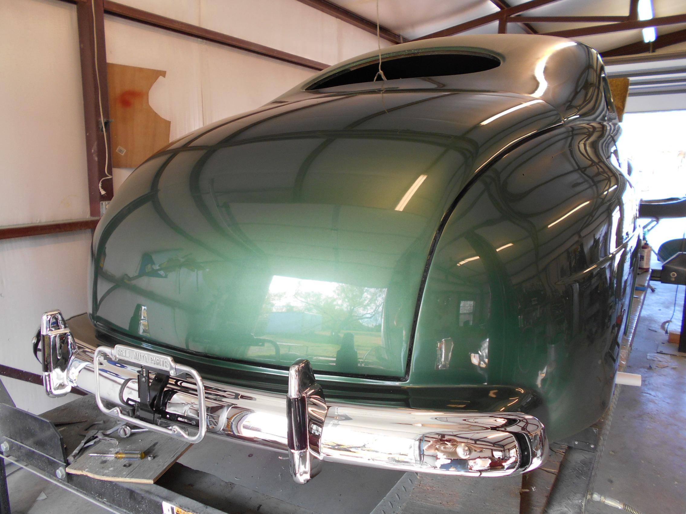

    There's been some rumblings ( grumblings?) about how light-dark this color is. I do wonder when stuff like this happens if the whole thread has been read.
    When a person takes on a project like this (historical do***ent), many things have to be considered up front: how much info is available about the prospective car being considered? What is the quality of this info. first hand, second hand, third hand, etc.? If there are no original pictures, I dont think you have a project worthy of the time and expense (enormous in both cases) unless its just a styling exercise in your chosen time period.
    If you have access to the original builder (and youre careful), you have an excellent opportunity to capture the original vehicle. It doesnt get better than that. This is what is called objective information. In this case it means youre dealing with facts/info., or conditions without being distorted by (outside) personal feelings, prejudices, or interpretations.
    If you dont have access to the original builder, your data falls under the subjective category. That would be interpreted in this case as personal judgments, modified or affected by personal views, experiences, etc.. Sometimes all you have is subjective info, but if objective is available, its the best, most useful and, safe (a huge consideration). For me, at this point in my life, I wouldnt attempt this with just subjective info. I dont think the time and expense is worth it. That is my subjective opinion.
    If you are fortunate enough to have access to people that were there, they can be a tremendous help. If you find yourself being moved by the group, you have to be very careful. The group DOES have value and occasionally comes with its own theme songs for background effect. The one that comes to mind at the moment is Tied to the Whipping Post (Allman bros.). IM JUST KIDDING, I LOVE YOU GUYS, and I do think that we are in this together.
    So regarding this color issue, I have Jesse (objective) telling me that the spray out cards (post # 1009) that I sent him do represent the correct color (as Obama would say, PERIOD!). When were trying to make comparisons with the blk/white original pics that are available, we have the objective/subjective dynamic on display. We saw this (vividly/tragically) in the chop saga (posts # 622-917). As bad as that was, the REAL tragedy would have been to say OK, OK, you guys just do it and let me know when it's done, and let that happen.
    It will be entertaining (and a must) to try and duplicate those blk/white poses. What we may see wont change the fact that this is the correct color. It will be another look at the primitive photo equipment that was used back in the day, and their limitations. The original pics are important and valuable. They do have the ability to send you, and your project over the cliff, however. They can be used for inspiration, BUT NEVER FOR TECHNICAL INSTRUCTION.
    Hey, in 10-20 years none of this will matter. All the guy's that were there will be gone and it will ALL be subjective.

    Excersize in B&W.... this is the reason it looks dark in one photo and light in others. The difference in photographers, processors, paper.... they could all greatly change the photo. The same with monitors... I have 2 that I use to compare artwork I do for web sites and even at that, what I see isn't what the customer or anyone else sees.

    If Jesse told you it is the right color. Nothing anyone else says has any merit IMHO Jer.
    Trying to base a color on a B+W photo or even an old color photo is a waste of time. To many variables envolved.
    And add to that the fact that everyones computer shows the color differently......

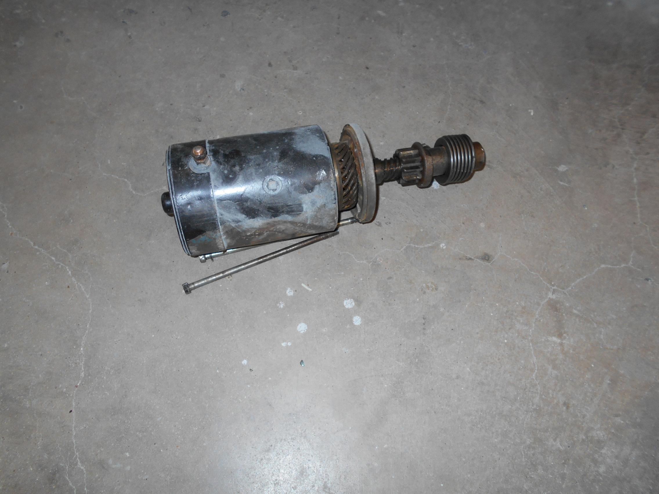

    Well, I've been fighting a starter that won't work. I'll see if I have to ask the trim guy's if they will push this thing around.

    Thanks everybody for the kind words. If things go well tomorrow, I'll get my rebuilt starter. Chris (trim shop) said that if I would bring it in Monday he would plan for it. This was on Monday last.

    The starter didn't get rebuilt for the trim shop date on Monday. It looks like they will push it around so I will prepare for it this weekend.

    Matt (46fatford) did his best but, he was unable to find those wiper parts I need. I appreciate the effort. It looks like '41 Ford exclusively for correct parts. Does any body have?

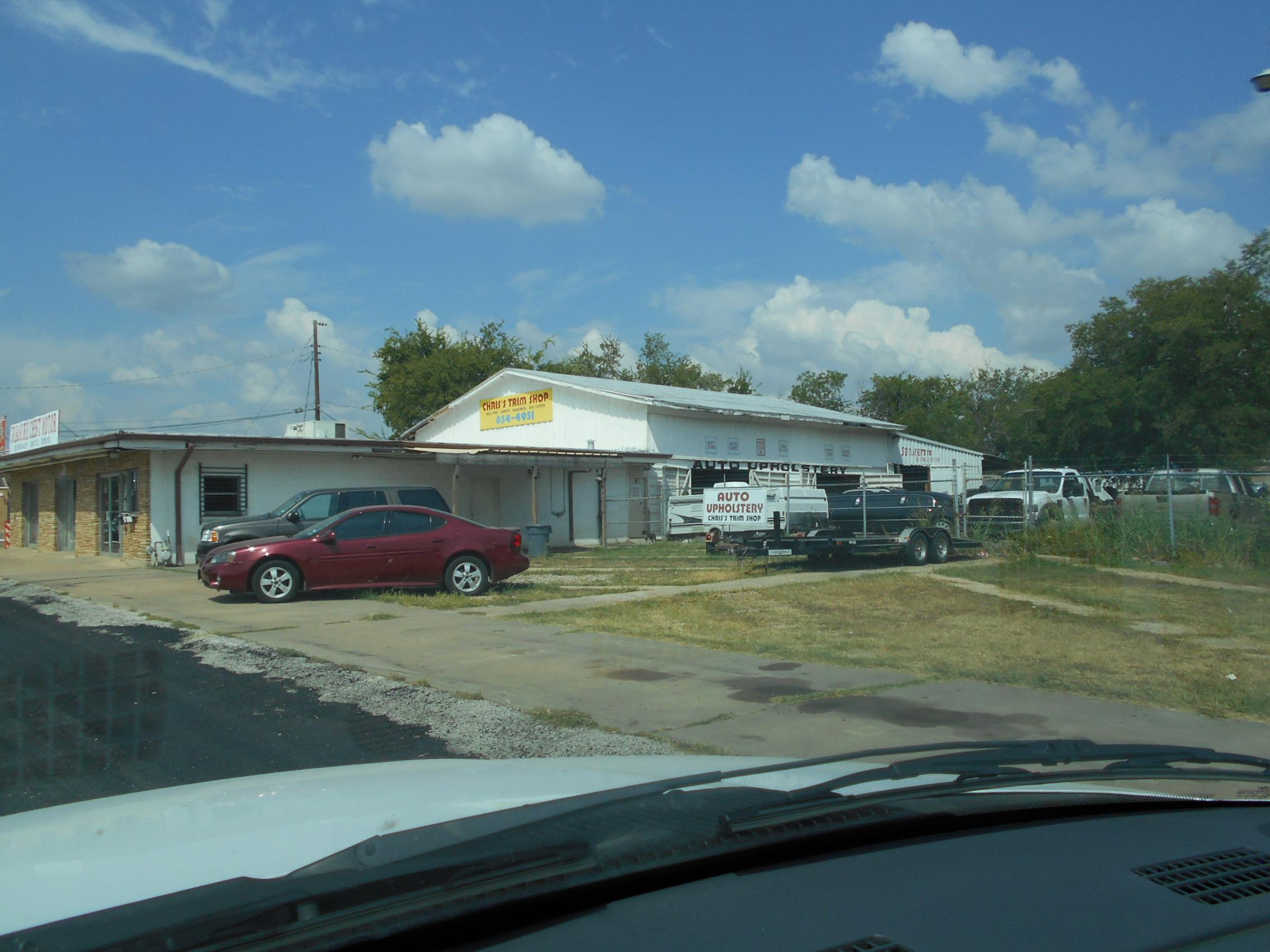

    We're in business. I went for an errand and found the roads clear and dry. I had these trim shop pics from a while ago. Mom used her camera for the load/delivery.
