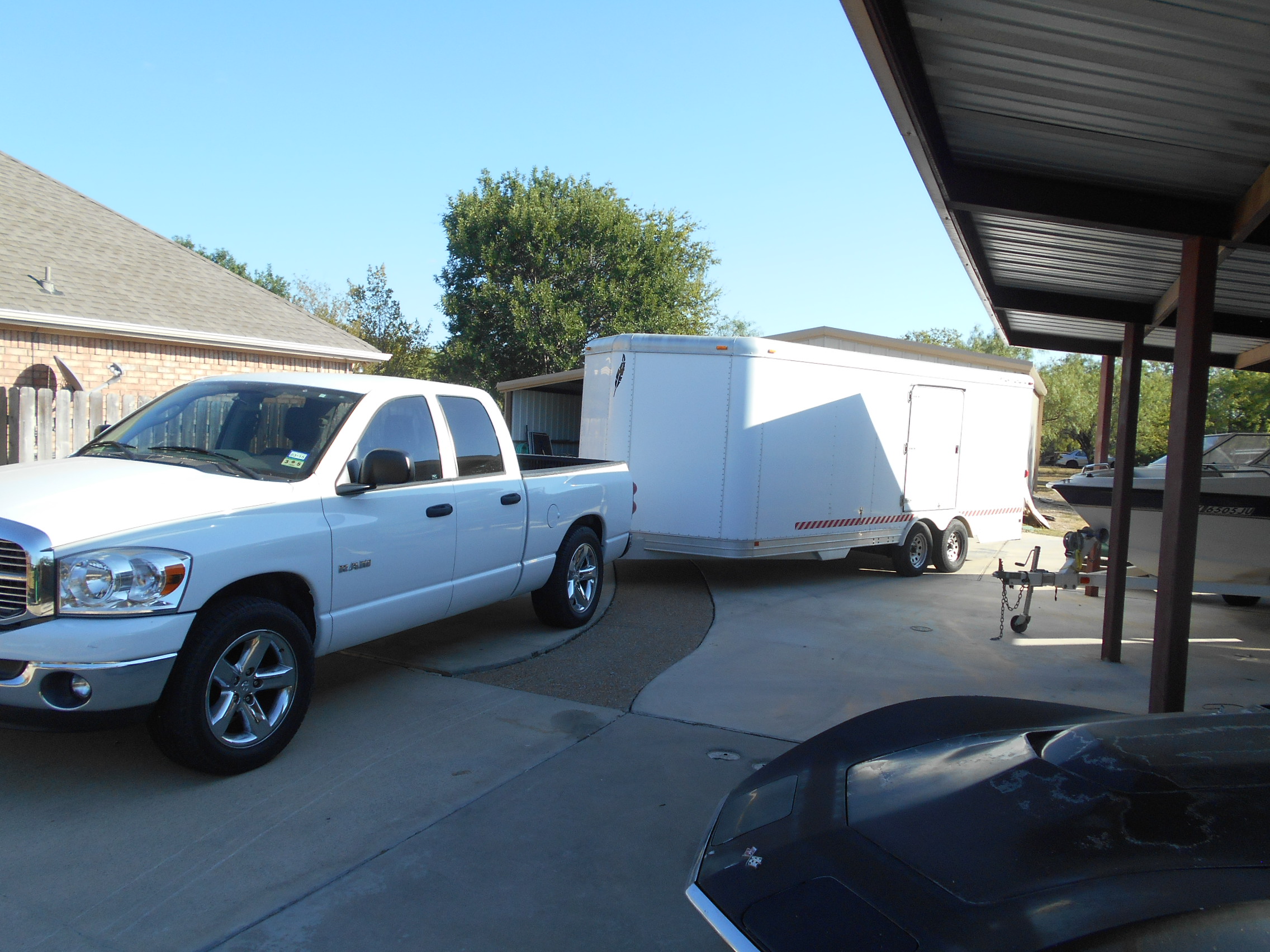

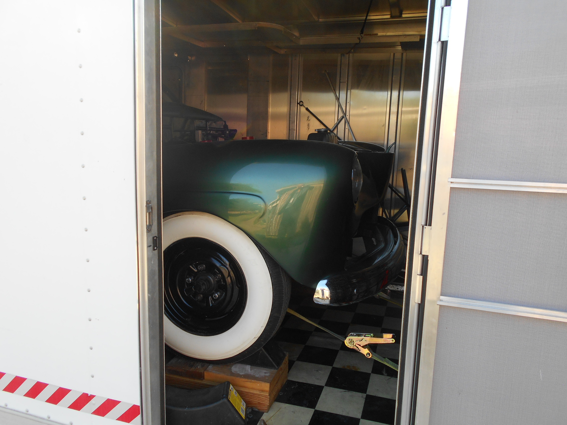

    All loaded up and no where to go. Glenn couldn't take the car today because he had to deal with problems with his wife's car. Gonna try for tomorrow. Sure doin' a lot of sittin'. Hmmmmmmmmmmmmm 001.JPG 002 (7).JPG 003 (2).JPG

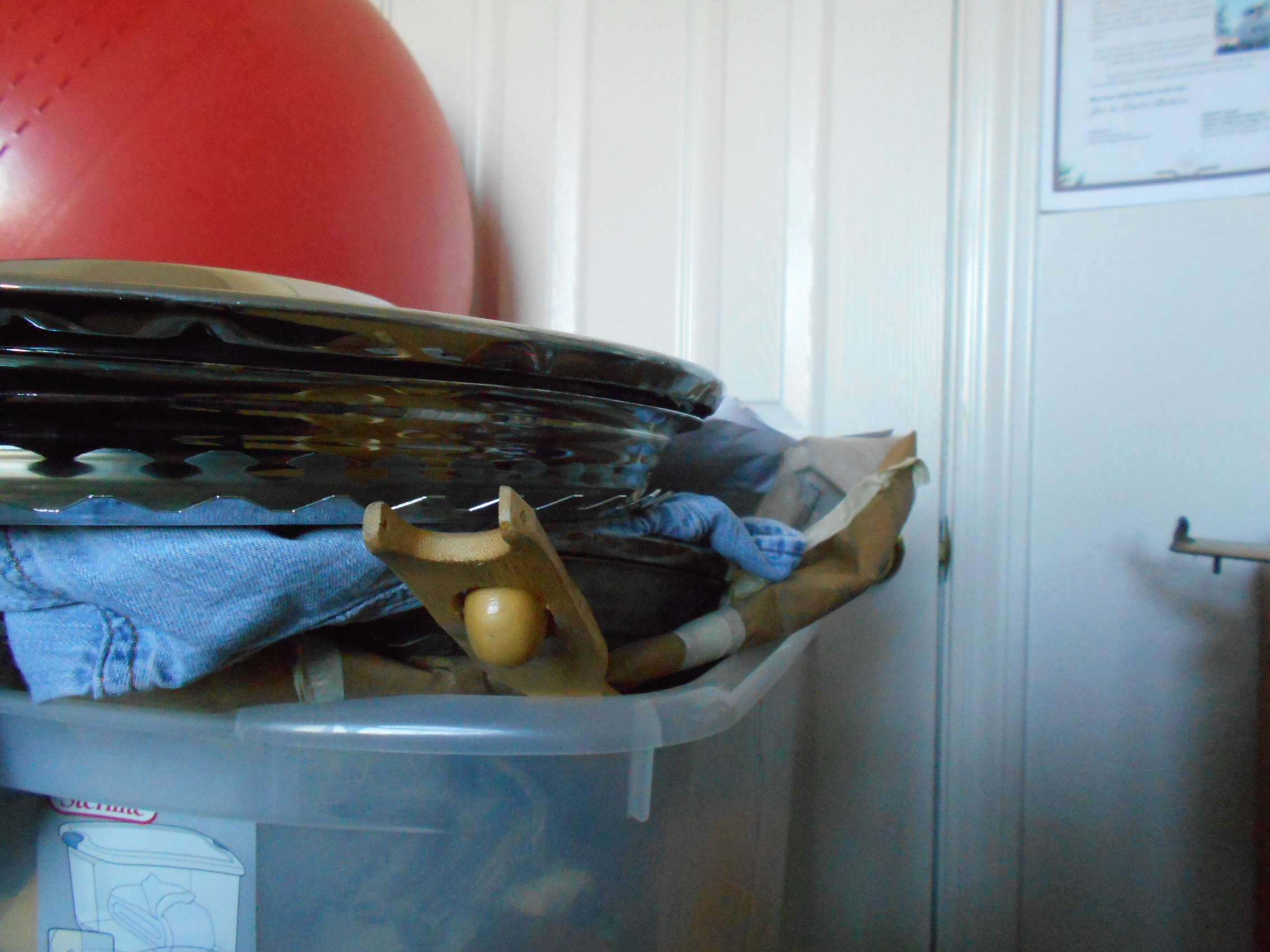

    Well, OK then...lets do the hubcaps. These are 15"er's with glued (structural adhesive) on trim rings. To get 001.JPG 002 (9).JPG 002 (11).JPG em' to look like this is expensive.

    WOW - Caddy caps GLUED to trim rings?? That really works??

    Apparently so. It's often suggested on "how do I mount sombreros" threads.

    But how did they do it "back in the day"? I'm sure there were no glues then like we have today.

    Back in the day they welded clips to them and then either had them repolished (Stainless) or rechromed.
    A lot of what you do to mount the Caddy wheel covers is based on what year you use. The early ones 47-52 I believe had an inner ring/cap that snapped onto the wheel. The later ones had outer clips like a modern wheel cover that were somewhat easier to work with.
    Regardless of the year these caps were heavy and had a tendency to fall off of wheels other than the original Cadillac.
    There is quite a few threads in regards to which year is which and the differences between them. Also in 47 Cadillac used 2 wheel sizes. 15" and 16". The 16" are fairly rare.
    The Whole Cadillac "Sombrero"thing is like a sub-culture to hard core custom fans. And I believe that the term "Sombrero" was originaly applied to the 49-52 covers only. Now it is used rather genericly. It's very interesting.
