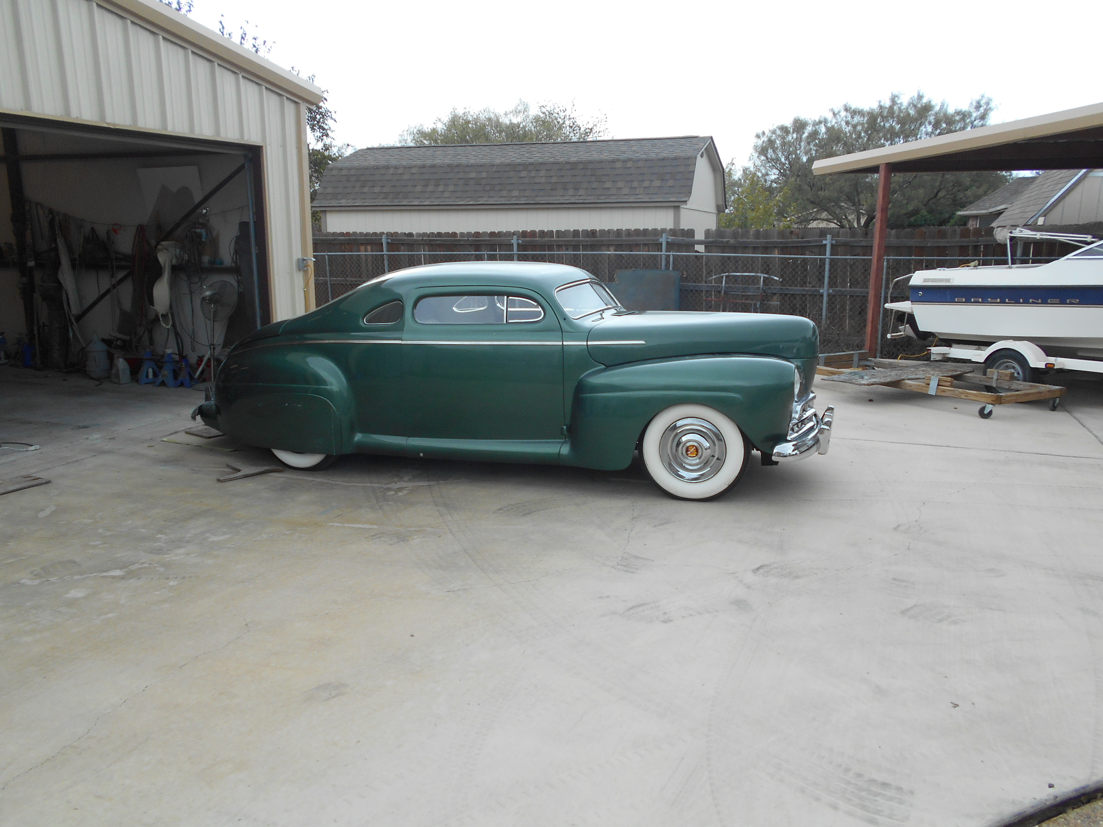

    Having been stimulated by all the activity on the last page I've been brainstorming how I would make the clone look like the original pics.
  2. jivin jer
    Joined: Sep 14, 2008
    Posts: 3,535
    jivin jer
    I think I need a 4” reduction in that space between the grille and hood latch area to make things look right. It would have to be done in small increments to keep everything else looking right.
    I could take 1” out of the brackets for the nose at the frame horns. This would give the profile a downward slant which is something that I don’t want. Hopefully there would be minimal (the fenders would have to be reattached) work that would need to be done at the cowl area for the fenders. I would then ADD a 2” wedge to the hood that would be gotten by lowering the latch area 2”. This would fix the slant. I’m half way there. I would then raise the grille opening in the frontal area by 1”. I would have to raise the gravel deflector 1” to compensate for the new grille position. The bumper ***y would of course have to also be raised (new brackets) to compensate for all this. The problem is I’m missing 1”, and I see some problems with the new relationship with the gravel deflector and the lower front wheel openings. It’s not going to look right. I am also afraid that the wheel opening (at the top) would have to be opened up to look right, and then I would have a problem with the style (reveal) line at the top of the wheel opening.
    BUT, I DO LIKE THE WAY THE ORIGINAL PICS LOOK.

    Well Torch, at two cents you are definitely selling yourself short. This "excersize" has been primarily for edification. In other words, so that there is full disclosure and this all gets "hashed out". I also think it's interesting for me to reveal my (every-body's) struggles with this stuff. We don't get that in most of the "big" build threads.
    I did ask Jesse early on where that front gravel deflector was. Did it sit in the '46 Ford position in relationship to the '41 bumper brackets? He said yes. That was all I needed to know regarding all the other components. Everything then was built on that foundation.
    The windshield measurement mimics the Zaro car. 8 3/4" windshield seal to seal at the divider bar.

    Having seen this car in person and worked on it and I can say with honesty that I have seen this car from every angle possible (even the bottom). Looking at ALL of the photos available and all of the various angles when compared to this car..... it is perfect.
    Are some things NOT absolutely the exact same? I am sure. Things like the exhaust and what the motor really looked like. There are no photos. Jer is having to go by the memory of the owner on a car that was built how long ago? It is recreated by what he can remember about the car. The rest.... you just have to ask.... how would most guys have done it back then and do it accordingly.
    It is a re-creation.... not a clone so therefore a little leway is allowed. How many "recreations" have there been of many of the factory muscle cars? Probably more than were ever built in the first place. How many Jesse Lopez cars have been re-created?
