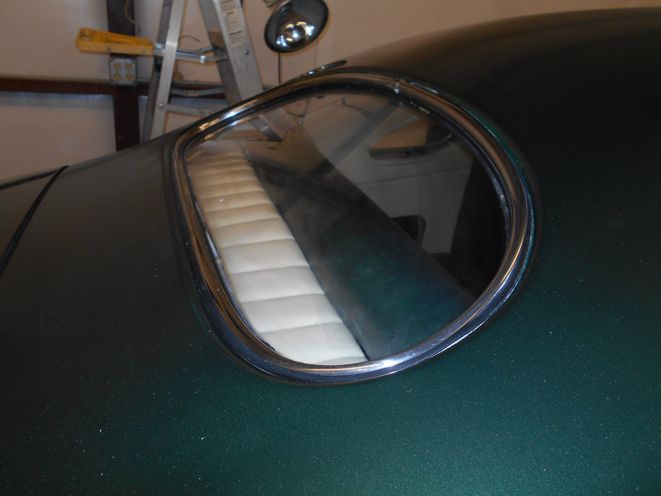

    As good as it is being at this place with this build, it’s still a ways to the finish line. I’ve got two big redo’s to make this right. The “spray on” chrome garnish moldings have some kind of a rash (dark spots) that have been spreading over the last months. I just called Don at Coat of Chrome as I’m writing this, and he said that he would redo them for me (hoooraaay).

    OK, here's what I want to say about these "spray on chrome" window (garnish) moldings. They look GREAT. If only you know that they're not chrome, no one else will know. That's the upside. The down side is they're EXTREMELY fragile. They will scratch, chip, if you try to "make" them go into an area that they haven't been in many times before.
    My problem is that I didn't have them "fitted" as well as I should have before I sent them out. I didn't realize this until I had everything together for the first time. Sometimes I get things right the first time. This wasn't one of those times. If you have interior trim that you'd like chromed, real chrome plate would probably be the way to go. This stuff is very expensive. If you have a custom situation where you don't have a person with the skills to get everything close in metal, than this is what you want to do.
    This technology would not work for anything that's going to be outside (exterior).
    Don is only going to charge me for the materials on the redo.

    Finally I'm taking off the protective covering on the rear plexi- gl*** window. I put the garnish moldings in the mail to Coat of Chrome. 004.JPG 001 (7).JPG
