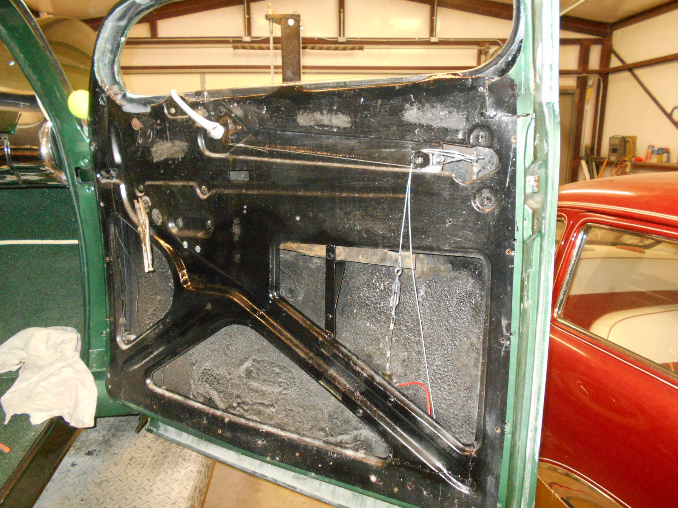

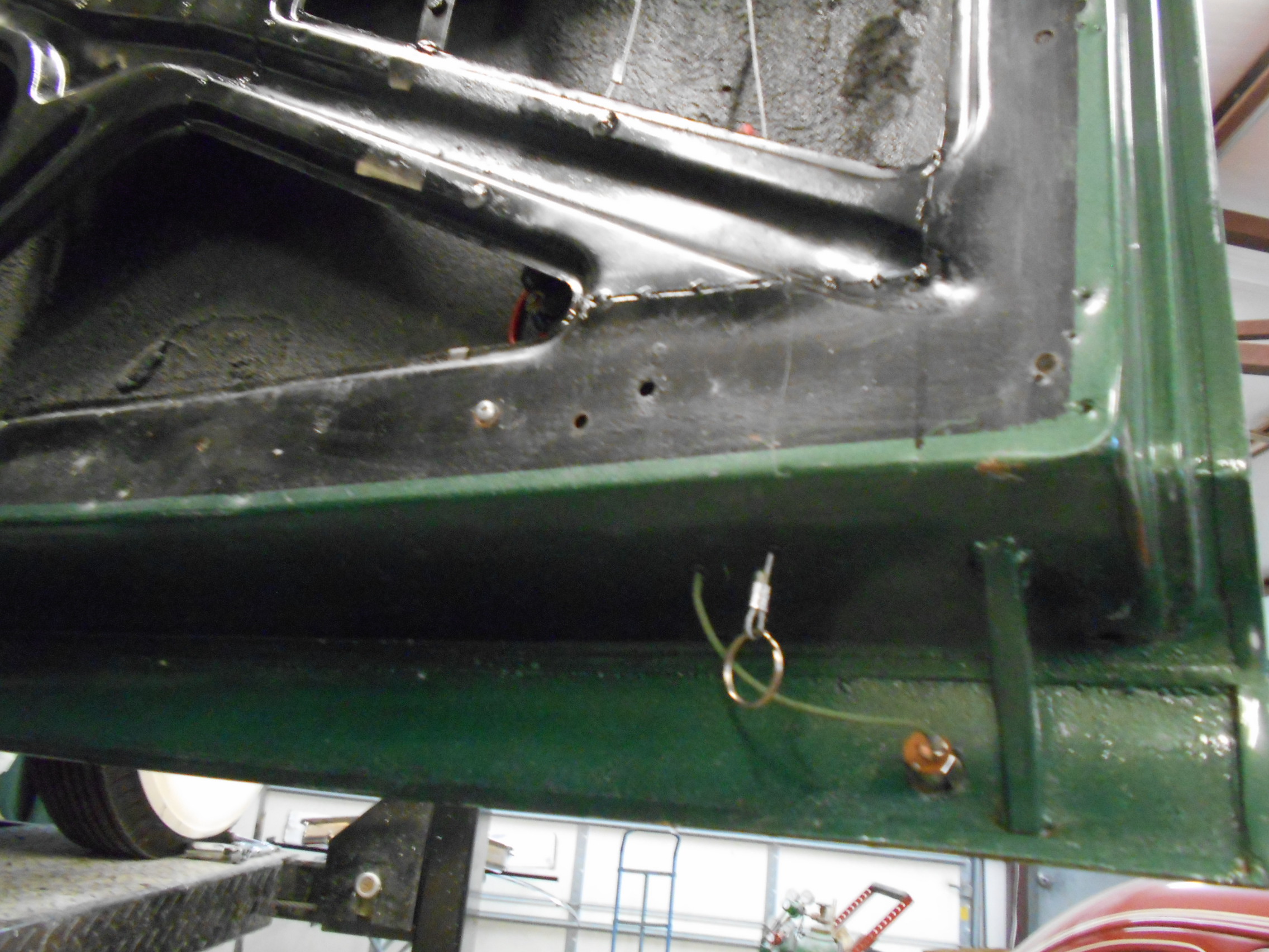

    Do you have two solenoids per door hooked up?
    Von Brush likes this.
  5. jivin jer
    Joined: Sep 14, 2008
    Posts: 3,517
    jivin jer
    I've never had cars with electric doors before. This has produced some paranoia about electrical failure. The added cable is to be able to mechanically activate the door latch. I need to clean things up a bit and snap a pic.

    That's a good move. I need to add an auxiliary cable to mine as well and keep forgetting….

    How have you set up the "emergency" access the extra cable?
  9. jivin jer
    Posts: 3,517
    jivin jer
    Here's the emergency cable.

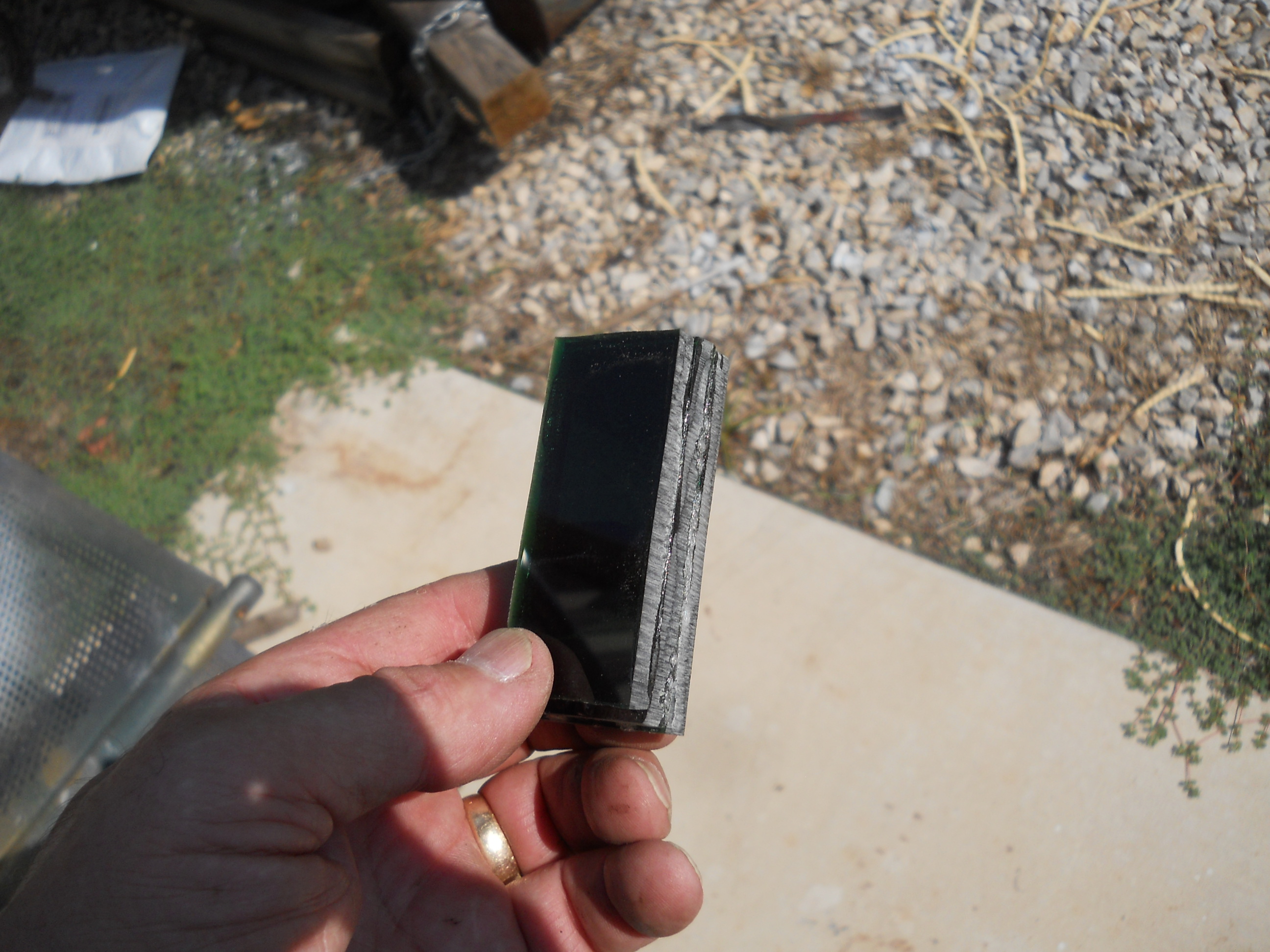

    With "things" percolatin', and waiting for some sun, lets do the dash knobs.
    Prior to this I've had some limited experience with this plastic stuff. I won't be able to say that after all this.
    This has taken a lot of thinkin', making mistakes, and finding out what won't work.

    I get energized by a question like this. I spent about 45 minutes on the web looking for something that would look correct. I'll ask Jesse if he can give me a clue to work with.

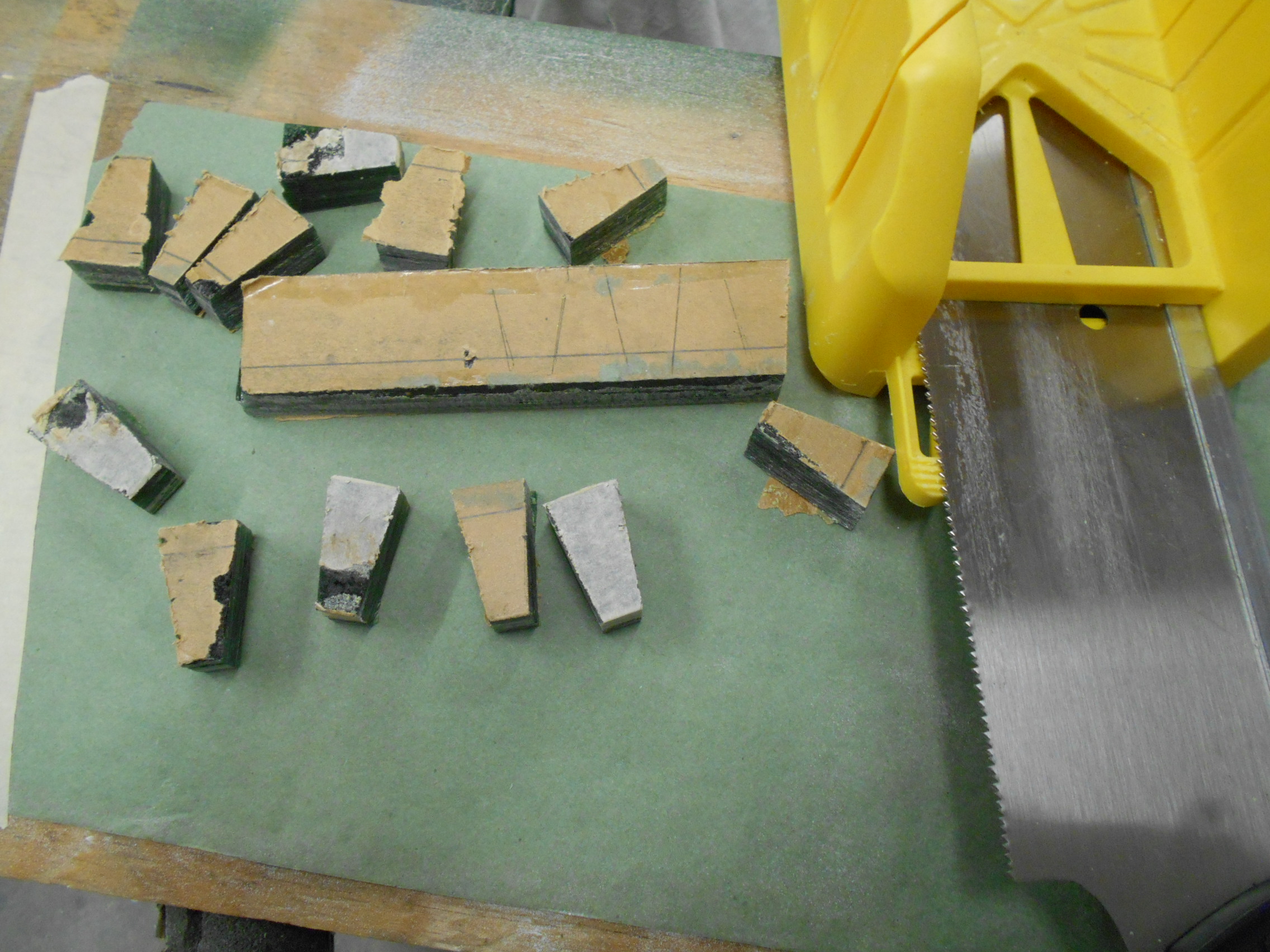

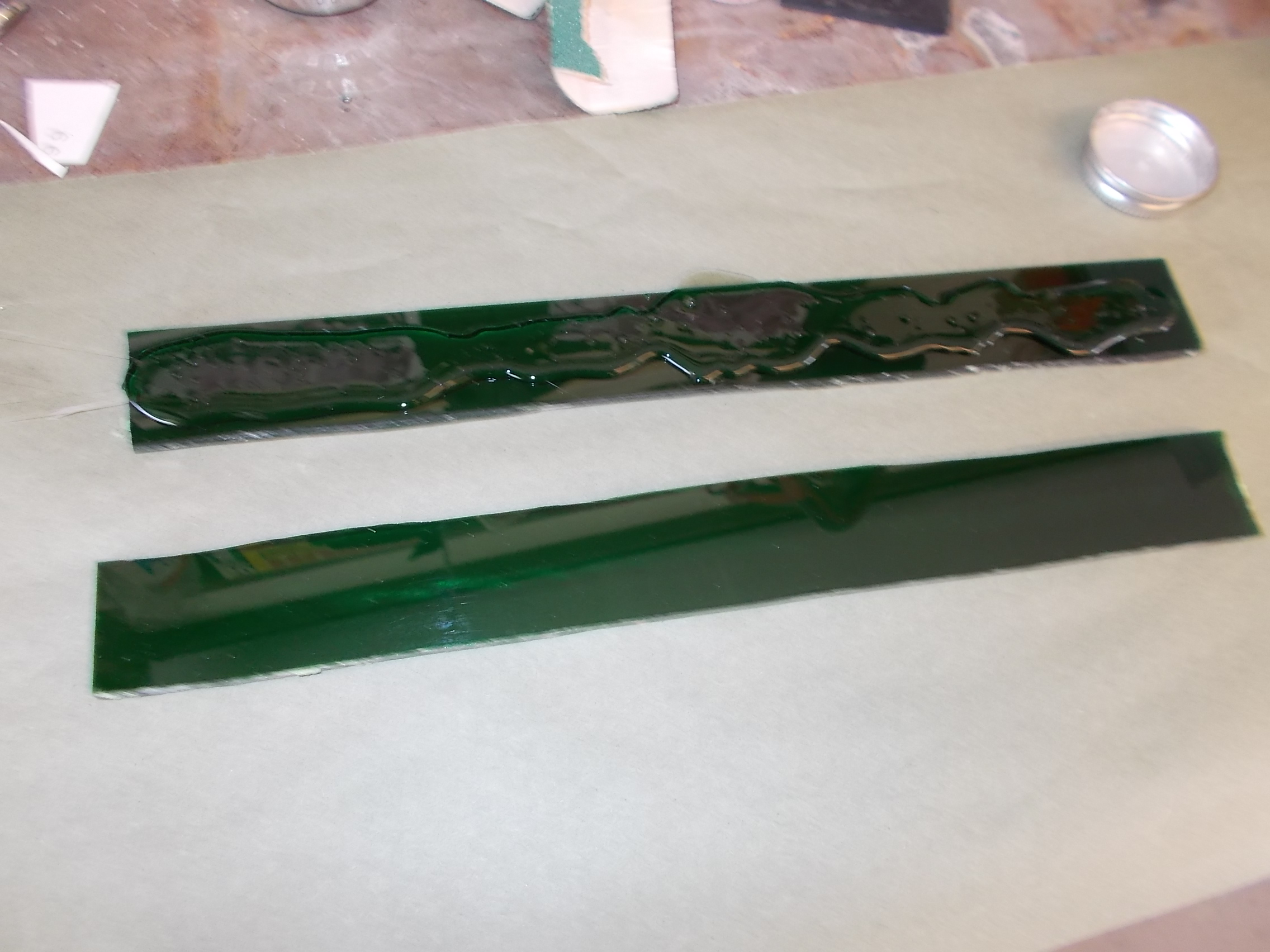

    This shows the plastic cut into strips, there's 3 of them ( not 2). They're glued together to get the width that's needed. The rough knob shown would represent a failed attempt to get it right. When you try to make a cut with an air saw everything melts back together when you think you're done. I had to cut the plastic with a fine tooth, sharp hand saw. 007 (2).JPG 008 (3).JPG 004 (6).JPG

    The cheapie miter box saw was excellent for nice, clean, straight cuts. 004 (2).JPG

    RICH B
    Neat idea. How did you set up the angle cut on the knob blanks; doesn't look like one of the fixed angles built into the miter box.
  20. jivin jer
    Posts: 3,517
    jivin jer
    008.JPG The plastic is pieces of green Lucite glued together. Nothing in the middle on these. I just carefully cut that angle by hand. When it comes to the shaping part there is some wiggle room.

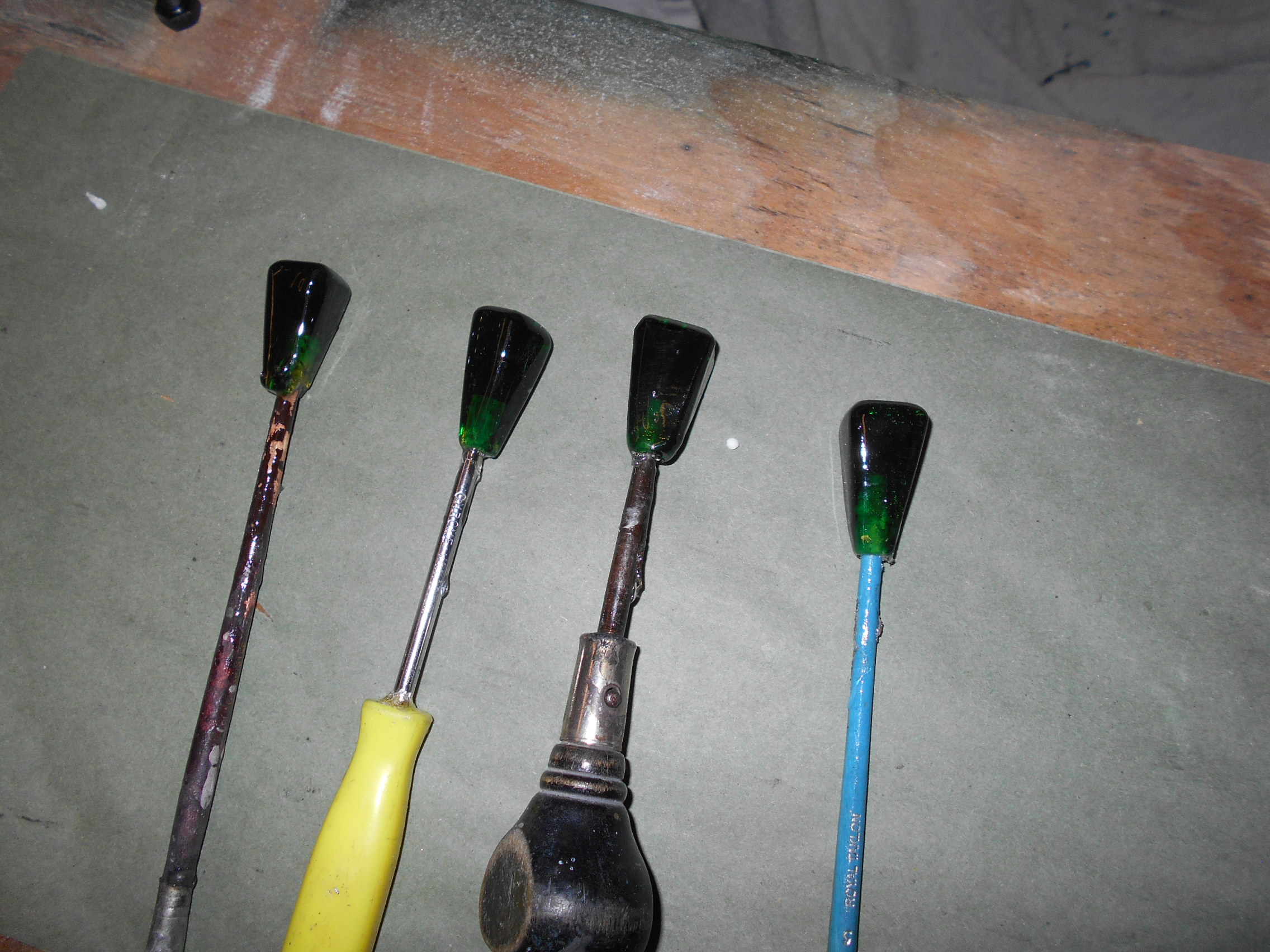

    A failed attempt that also tried to see what would, and wouldn't work. I will probably take a short break. 001 (13).JPG

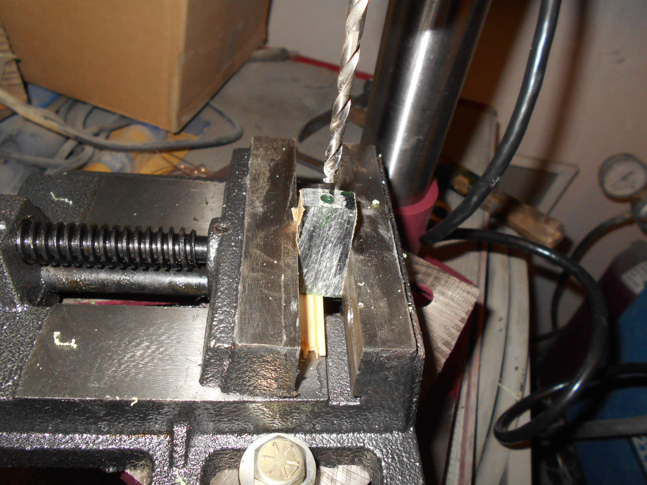

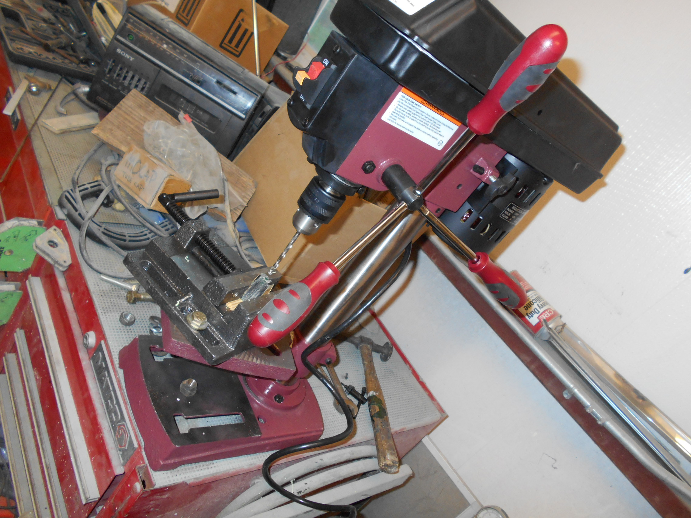

    003 (9).JPG 002 (12).JPG I need to be able to drill these knobs to fit on the window crank handles. Getting them perfectly straight isn’t as important as the dash knobs. I thought I could get them close enough by hand. I was wrong. I need to be able to drill these knobs to fit on the window crank handles recepticles.
    I really needed to find someone with either a lathe or a drill press. I wasn’t able to find either one.
    I solved this problem by finding a Northern Tool drill press and vise for less than a hundred dollars. I really don’t expect much out of this set up, but it sure does solve this problem.

    There are times when a "Cheap" tool can do the trick.
    Looking good Jer.
    Torchie
  27. rob-redm
    Joined: Nov 15, 2005
    Posts: 6,589
    rob-redm
    money well spent ! bingo !
