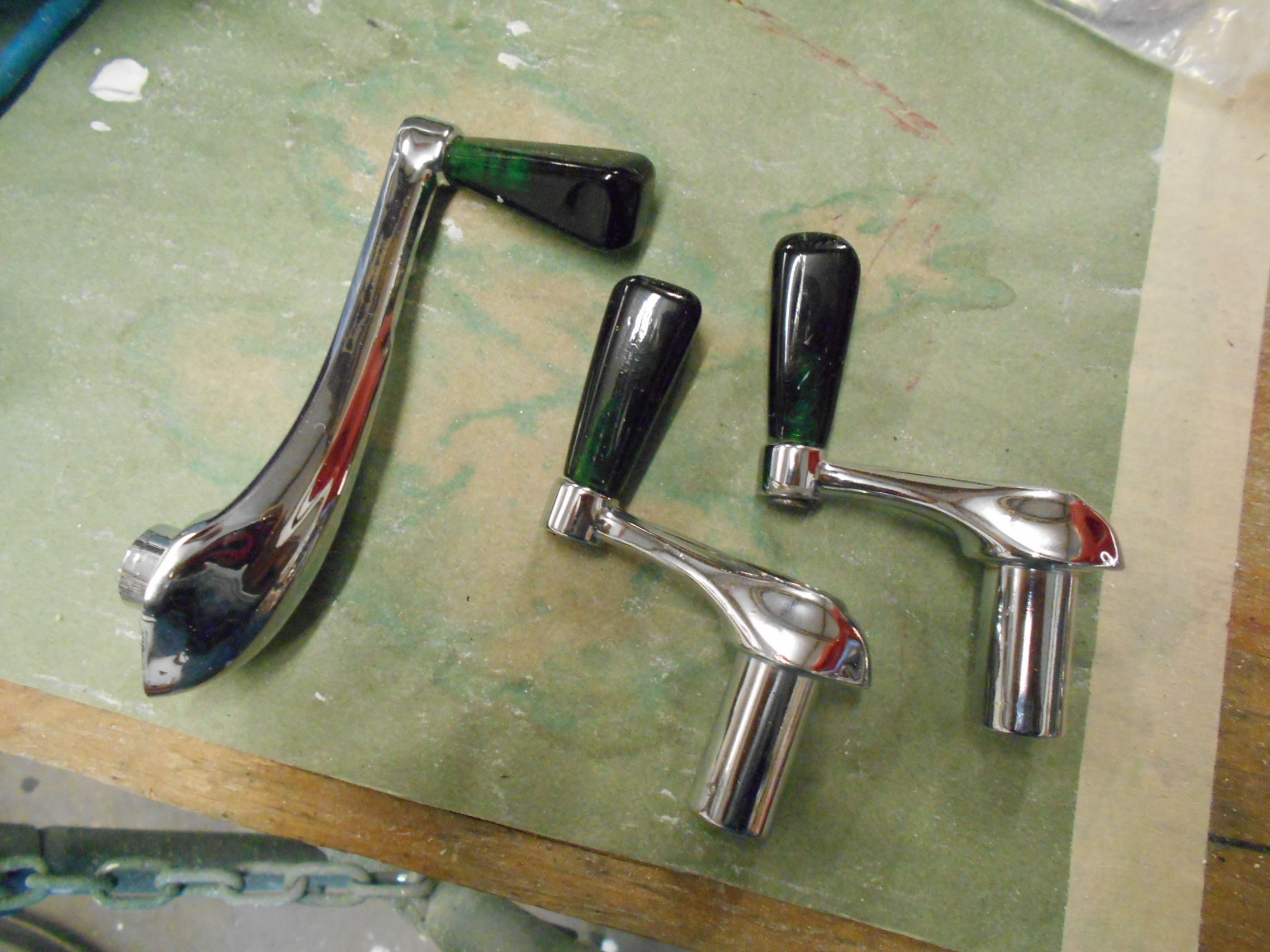

    drdave and Eric H like this.
  6. Peanut 1959
    Joined: Oct 11, 2008
    Posts: 2,189
    Peanut 1959
    Oh, so they're t****zoids and not cones!

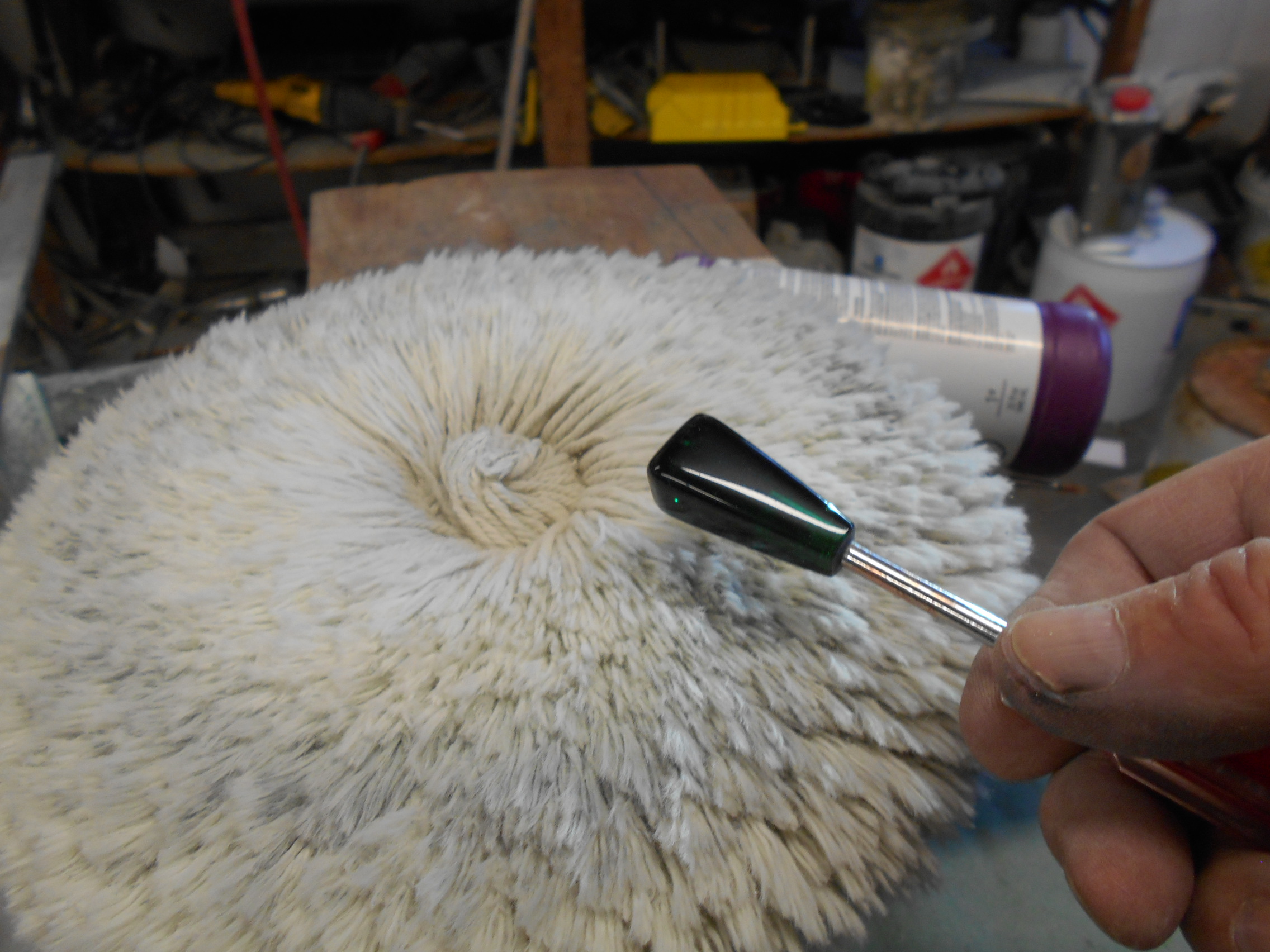

    Here's the progression (R-L). Shape on bench grinder, 80 grit (da), 600 grit (da), polish with buffer. 004.JPG

    You have to "melt" the repro knob off the repro crank handle. This reveals the shaft that you need to mount the knob to. 005 (5).JPG 007 (2).JPG

    The hole in the knob is not quite half the size of the shaft. I get the tip of that shaft cherry red with my torch. As soon as the cherry red is gone, I force the knob onto the shaft with a steady motion. When everything cools down the shaft and the knob are 'welded' together. 008.JPG

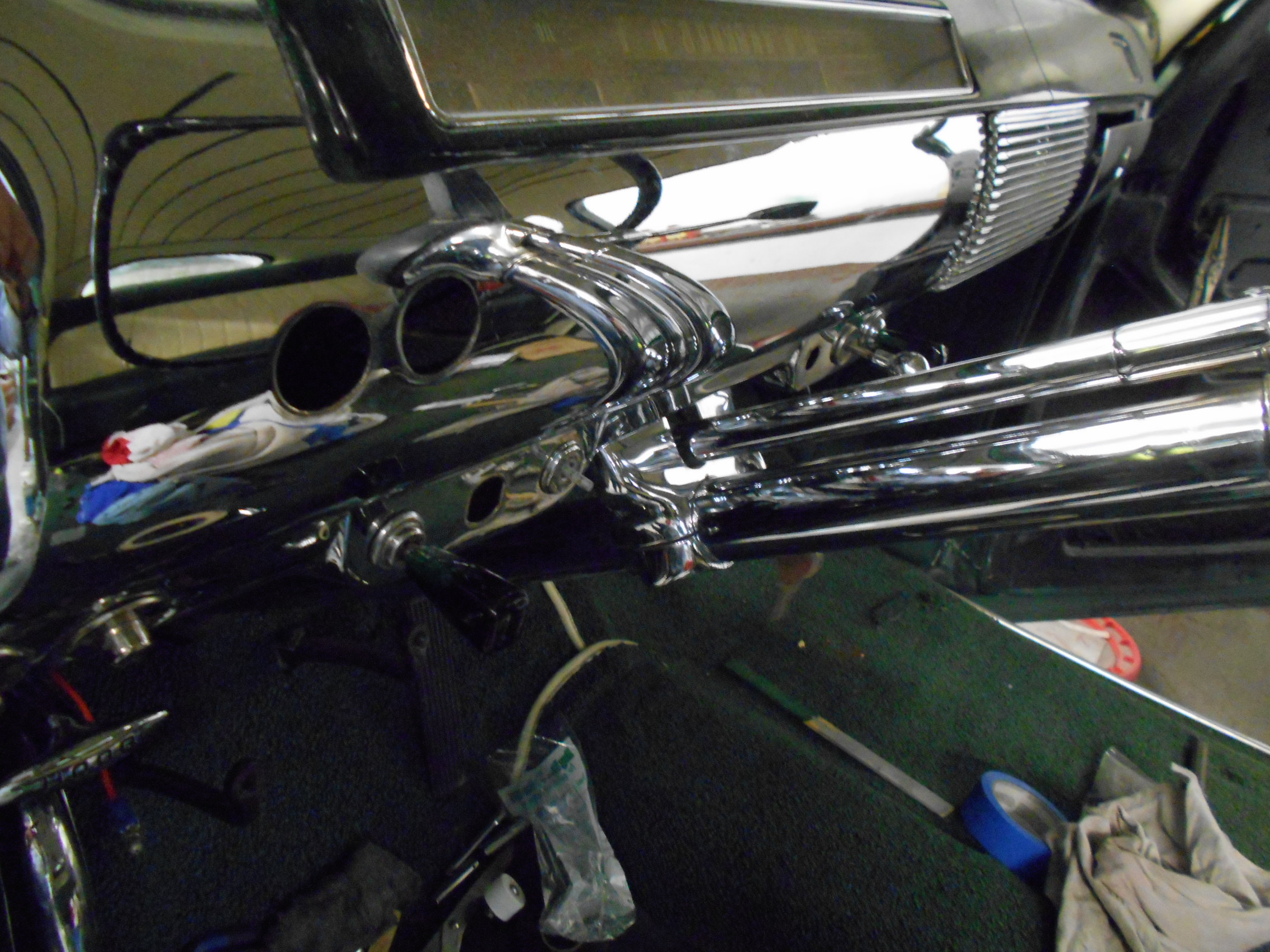

    Thanks everybody. Here's the lighter and the headlight knob. All different size shafts and problems to solve. Grandma just got her new knee, so it's going to be hit and miss for awhile as I do my 003 (2).JPG 005 (5).JPG duties for the old girl.

    Way cool, Jerry! The little things like dash knobs are kind of fun, huh? Now I know how to put the new knobs on door handles, etc! You've taught us so many things in your threads that surely they'll be used for reference time and time again. Thank you so much for taking the time to share each process! It's greatly appreciated.
