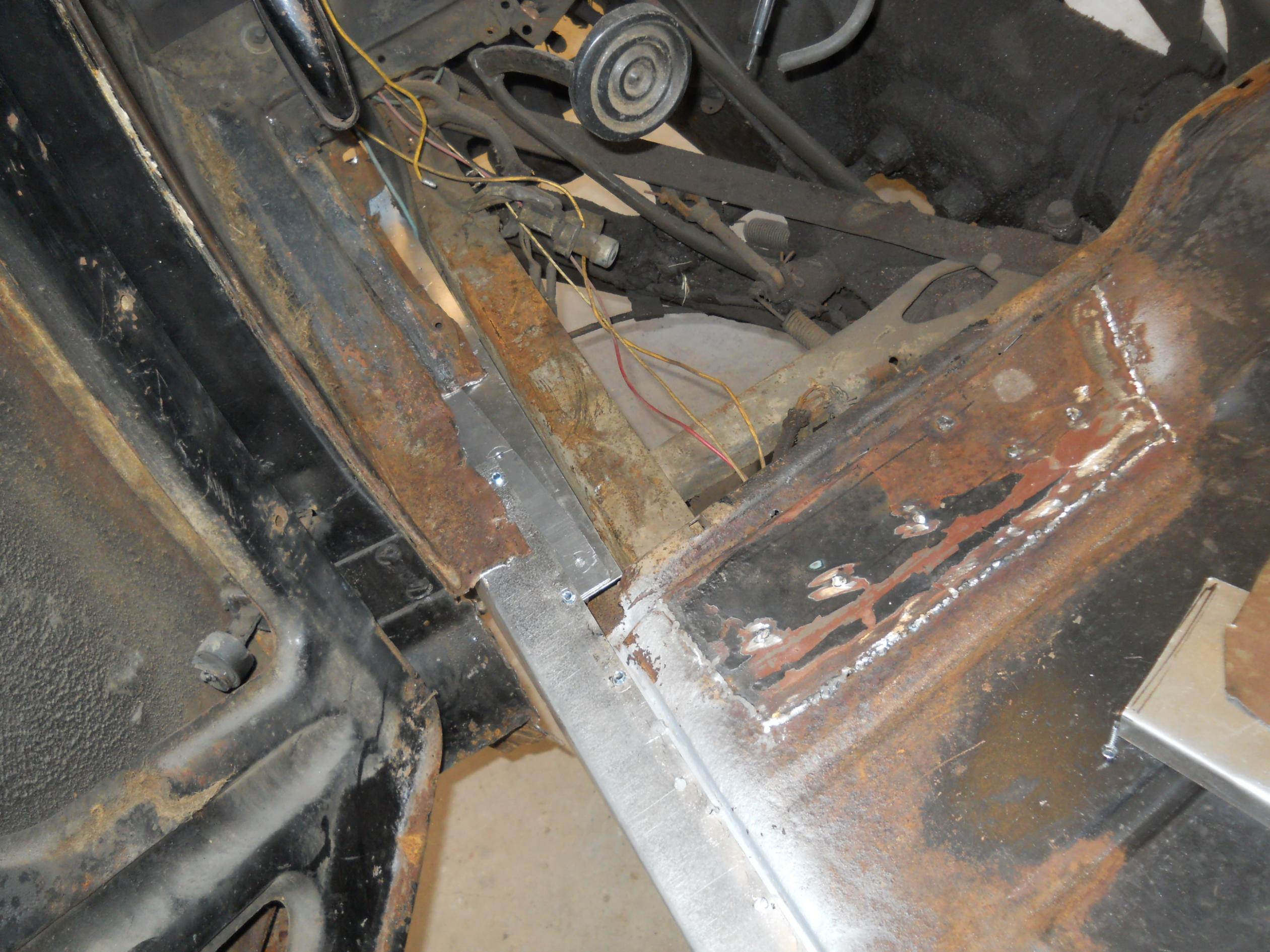

    There, just a little bigger than a dime.

    Like it was meant to be part of the floor!

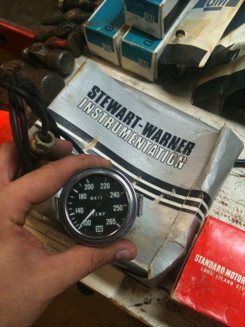

    Hey Pete, here's a pic of the face that the SW gauges need to have. I need a temp, oil and a mech tach. These wiuld be the small 2 1/4" ones.

    How exact of a recreation are you trying to do? The gauge you picture is a 1980's era SW. If the car was completed in the mid 50's, it probably had winged gauges. If it was completed in the later 50's it might have had big-logo gauges.
    At the very least, get some SW's with the all white pointer. Those with the black paint on the tail scream 1980's to anybody in the know.

    I was wondering the same thing. These gauges are pretty late for this period build.

    If these turn out to not be what you need I have some large logo gauges as well. I collect all types of them. Just let me know what you want to do. I agree with alchemy thought. These are late 70's through the 80 gauges. They don't fit the build at all. I'd that's what you want to run its cool with me. Your car, your decision.

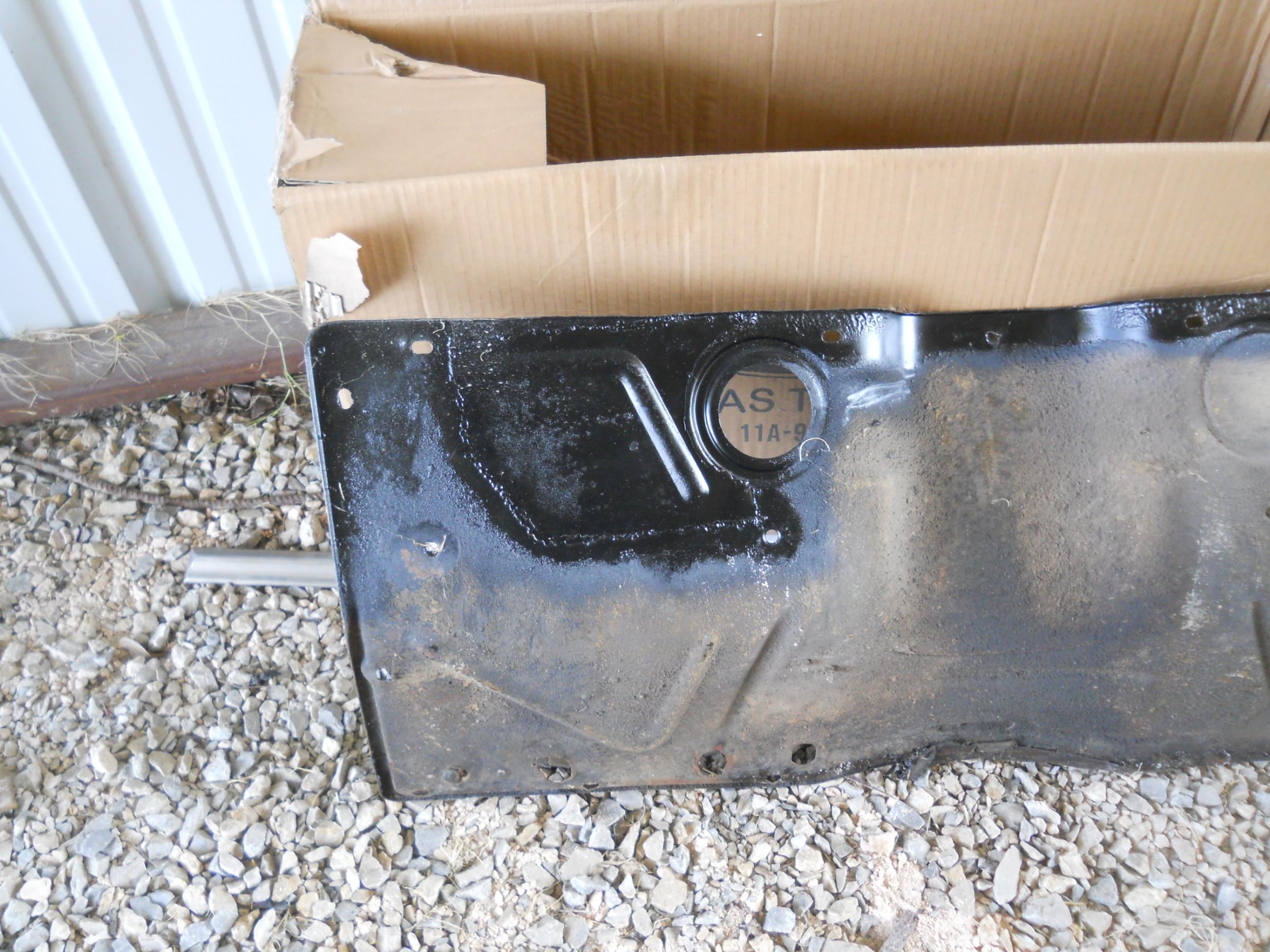

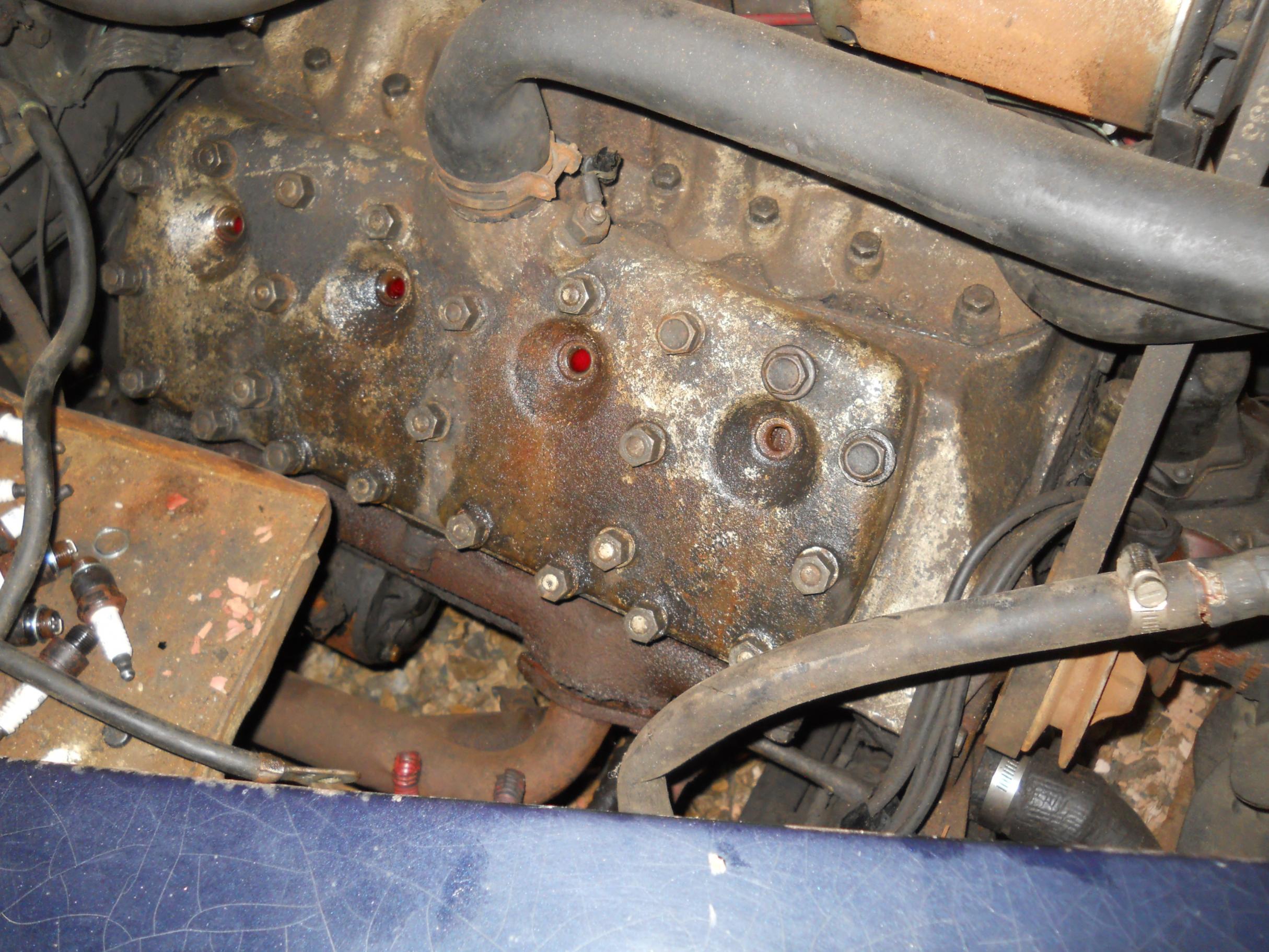

    I needed a piece with some reinforcement in it. I found it in the firewall of the "parts" car.
      533.1 KB
      577
  17. jivin jer
    Joined: Sep 14, 2008
    Posts: 3,535
    jivin jer
    That should take care of the toe board.

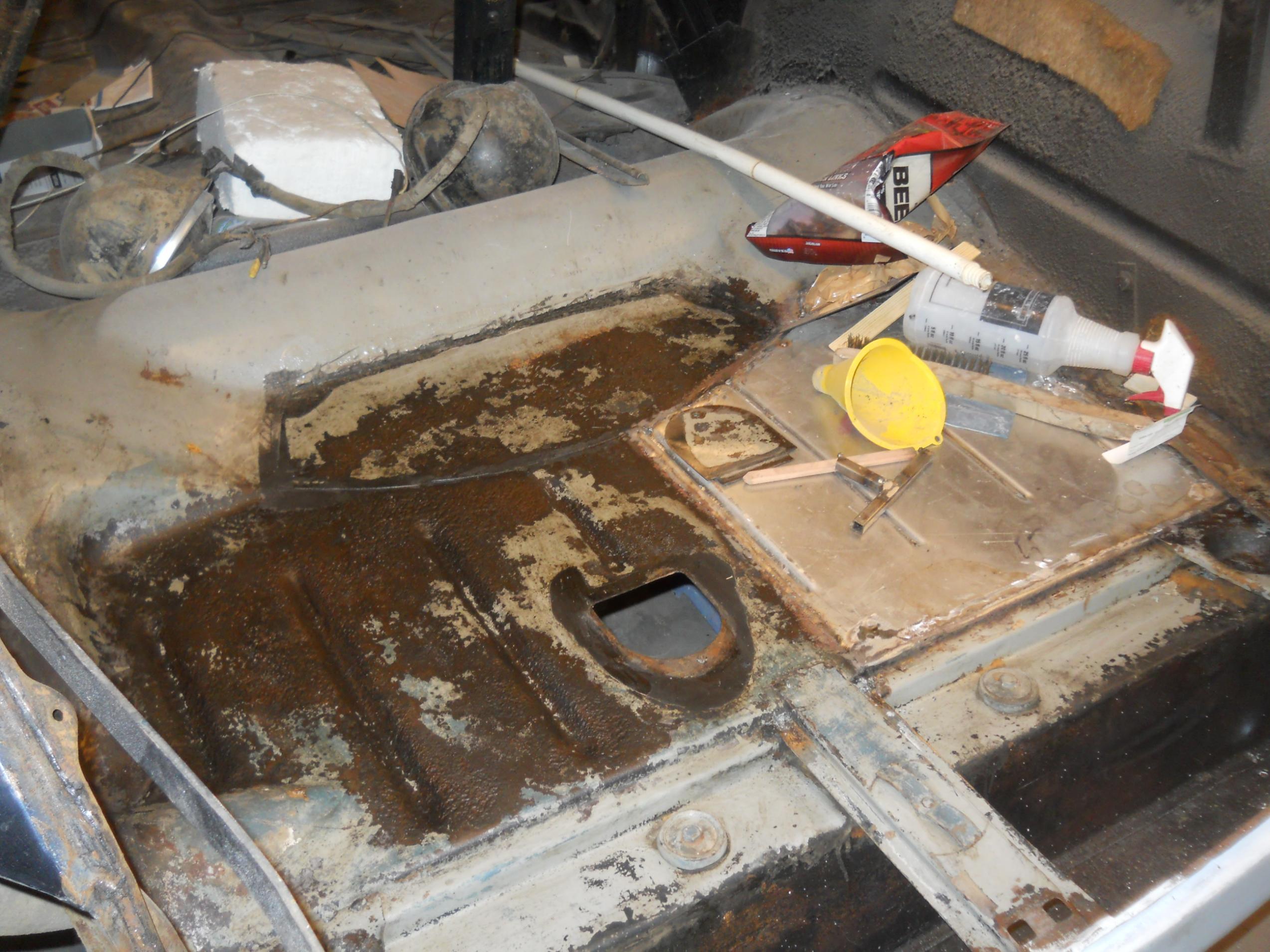

    With the trunk floor I think we're done with the rust repair.
