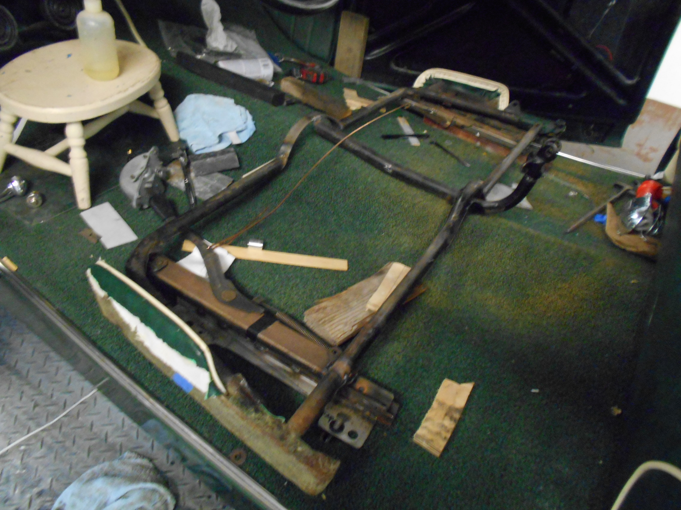

    With the potential of a lot of effort for a little gain, I'm intrigued by Rich's use of late model seat tracks. I've got my middle son's wrecked '08 Cavalier on the back forty, they are pretty slim and compact (after the long legs are removed). We'll see how it works out. 001.JPG

    I originally tried some late model tracks; but I ended up using some universal tracks from Speedway as they were thinner. I didn't C-notch the seat frame like you did, so my seat frame is probably a little higher. Floor has some been extra braces added for bucket seats
    at one time. Earlier post with the picture got lost for some reason, I'll try again.
    http://www.speedwaymotors.com/Universal-Seat-Sliders,7103.html

    The seat tracks actually fit in the stock '41 Ford bolts on the seat frame. They are really compact, so we'll have to see about this, lookin' good though 001 (5).JPG .

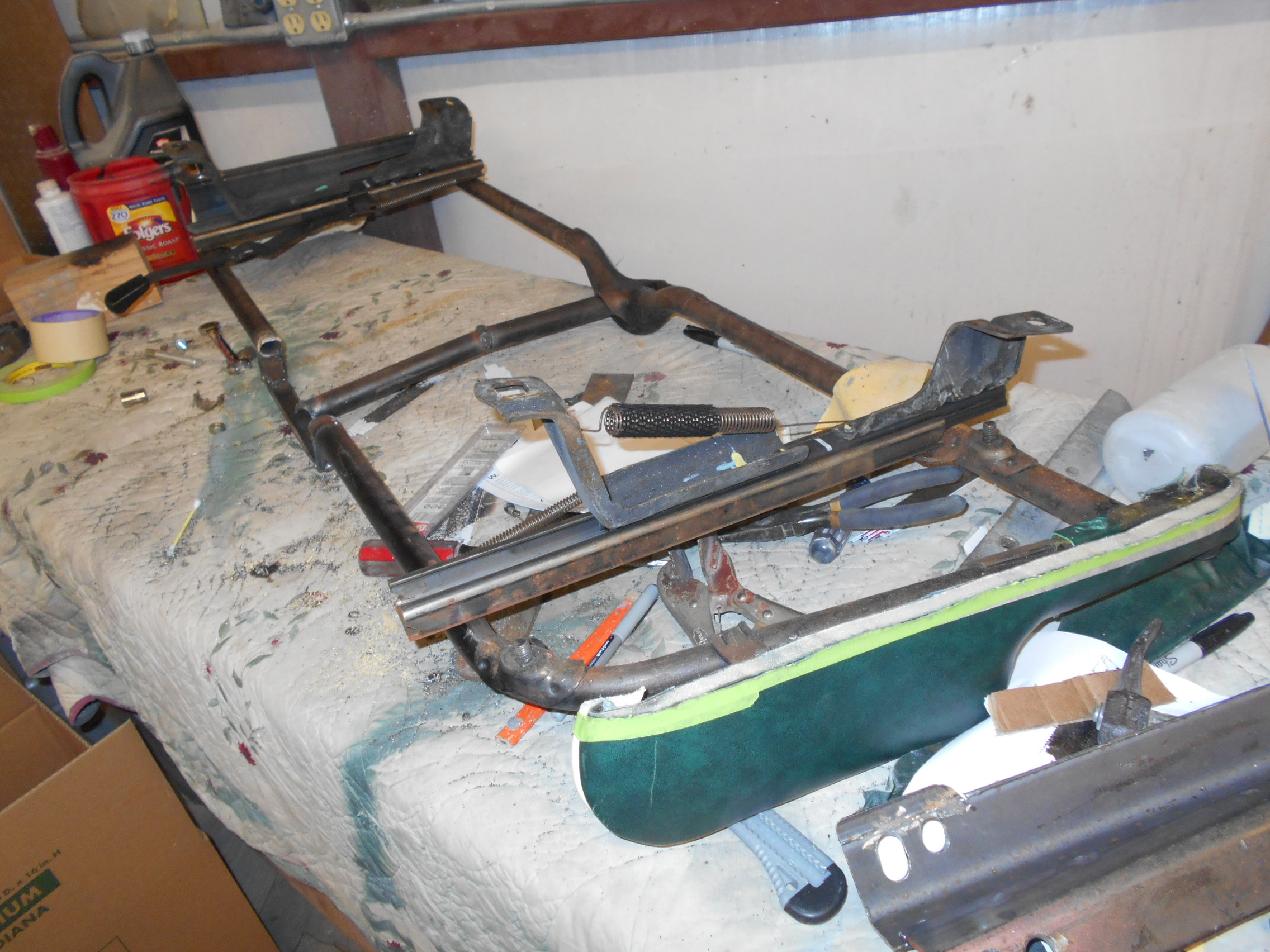

    I think I'll be able to make these work, as well as them being able to be adjustable. Sorry no pic tonight.

    Thanks guy's.This is turning into a big production, how everything relates to each other when something is changed. 001 (2).JPG

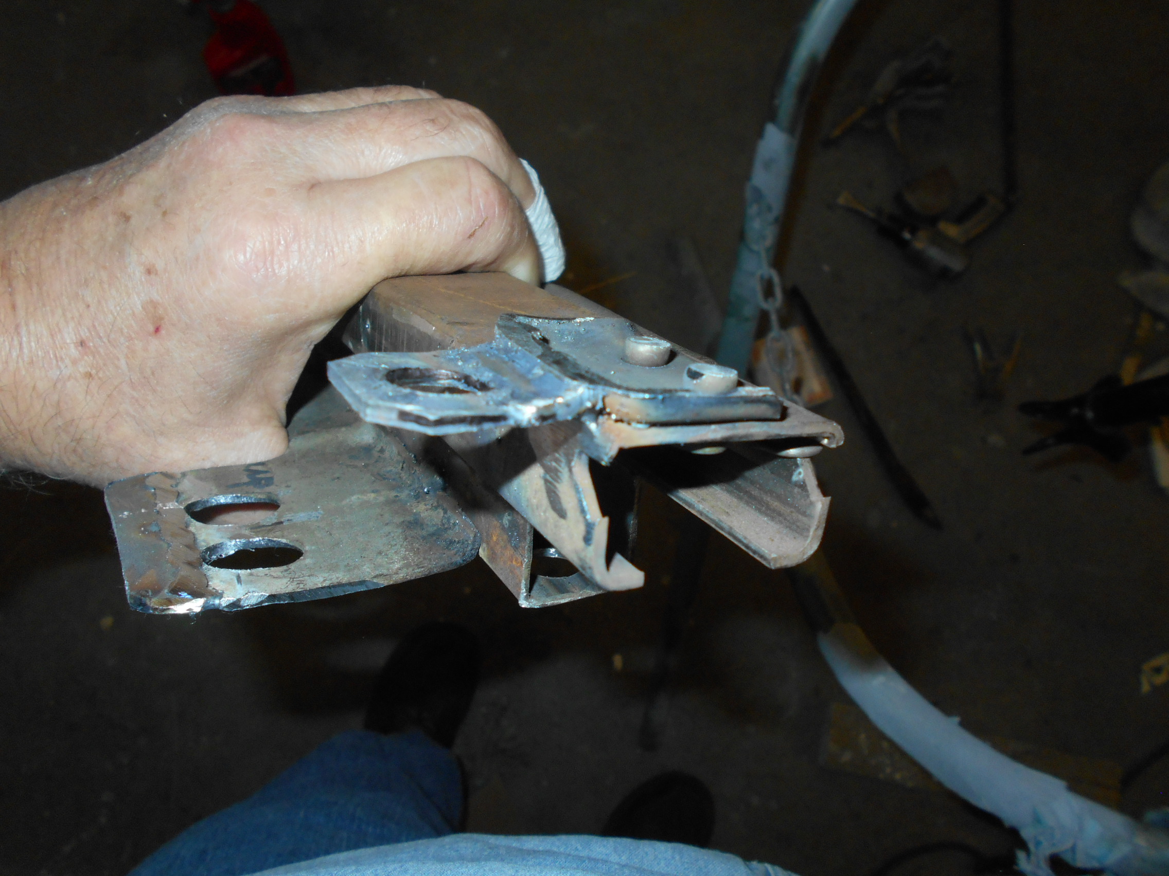

    I'm close to wrapping this up. My next priority is to go back to the trim shop and get things "adjusted" and redo the "damage" that I've done with these mods. 006.JPG 007.JPG

    The seat will no longer come together with the seat frame because of the drive shaft hump that's been put in it. I think I'll let the trimmer deal with it. I'm going to try and see him tommorrw. 005.JPG 006.JPG

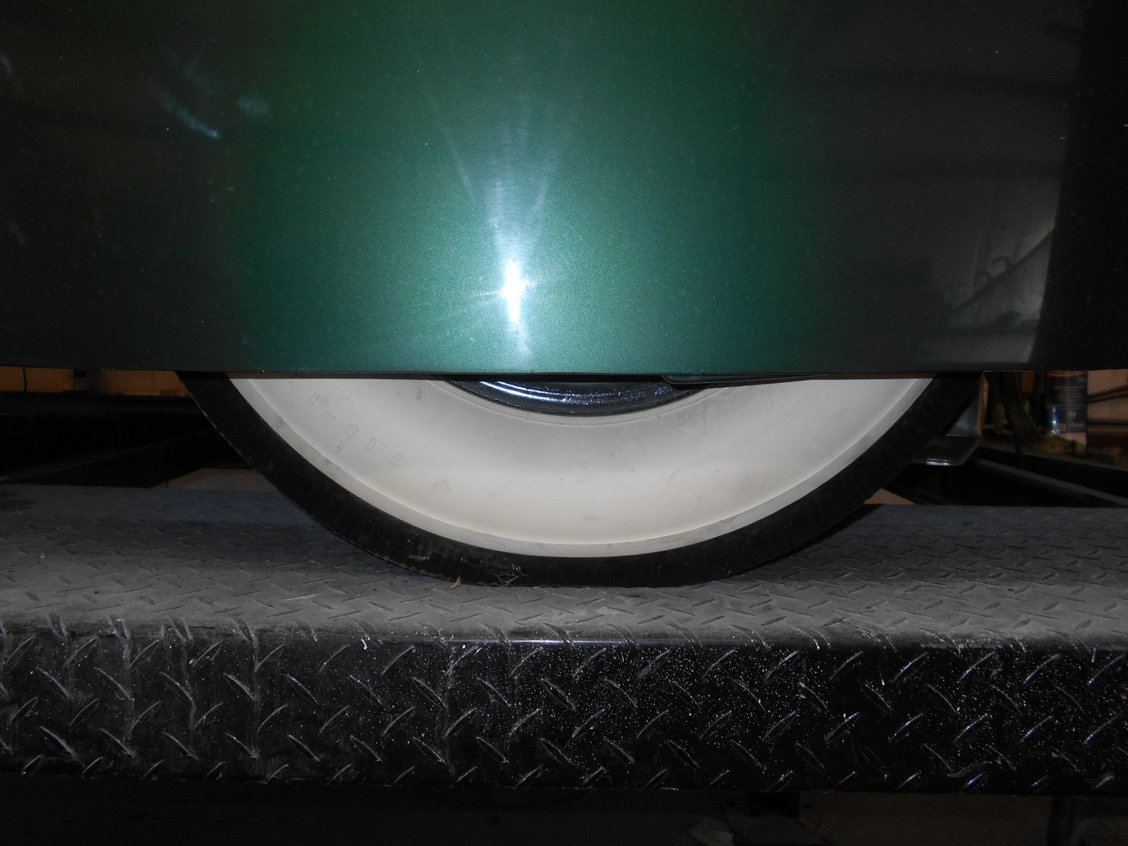

    Regarding the stance issue, this pic shows the problem. There needs to be only half of that white wall showing under that skirt. 001 (4).JPG

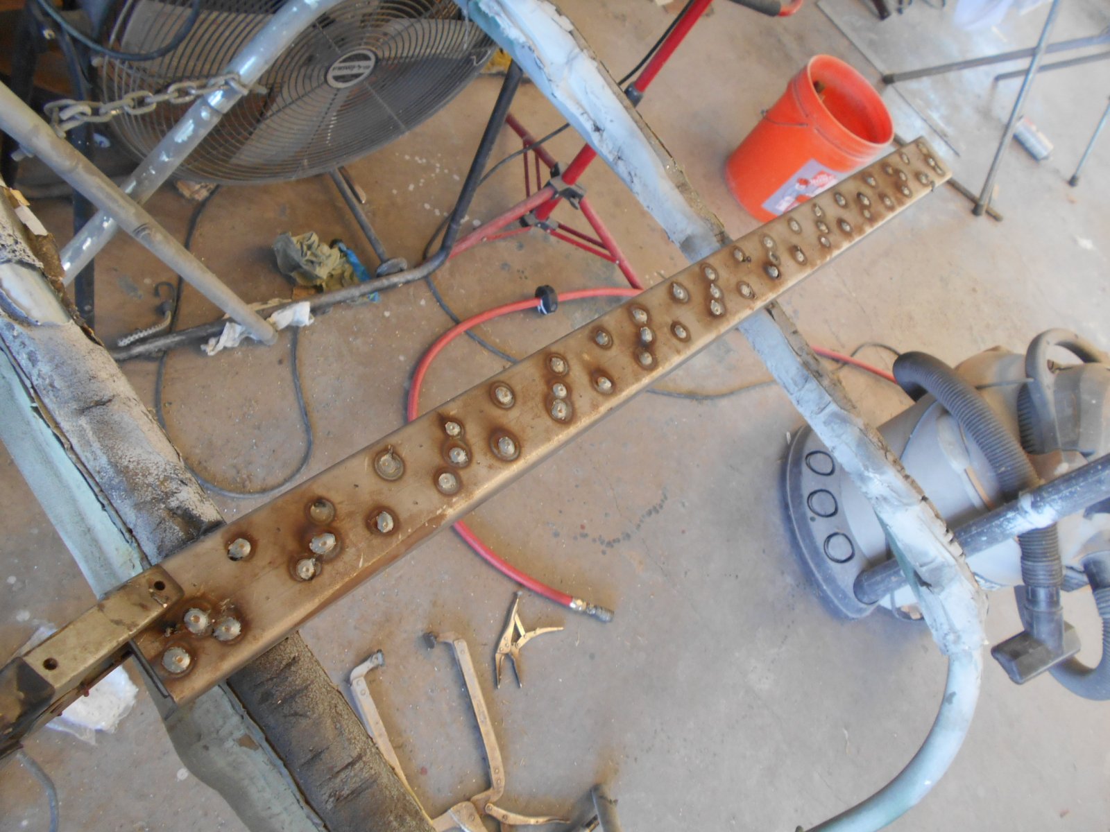

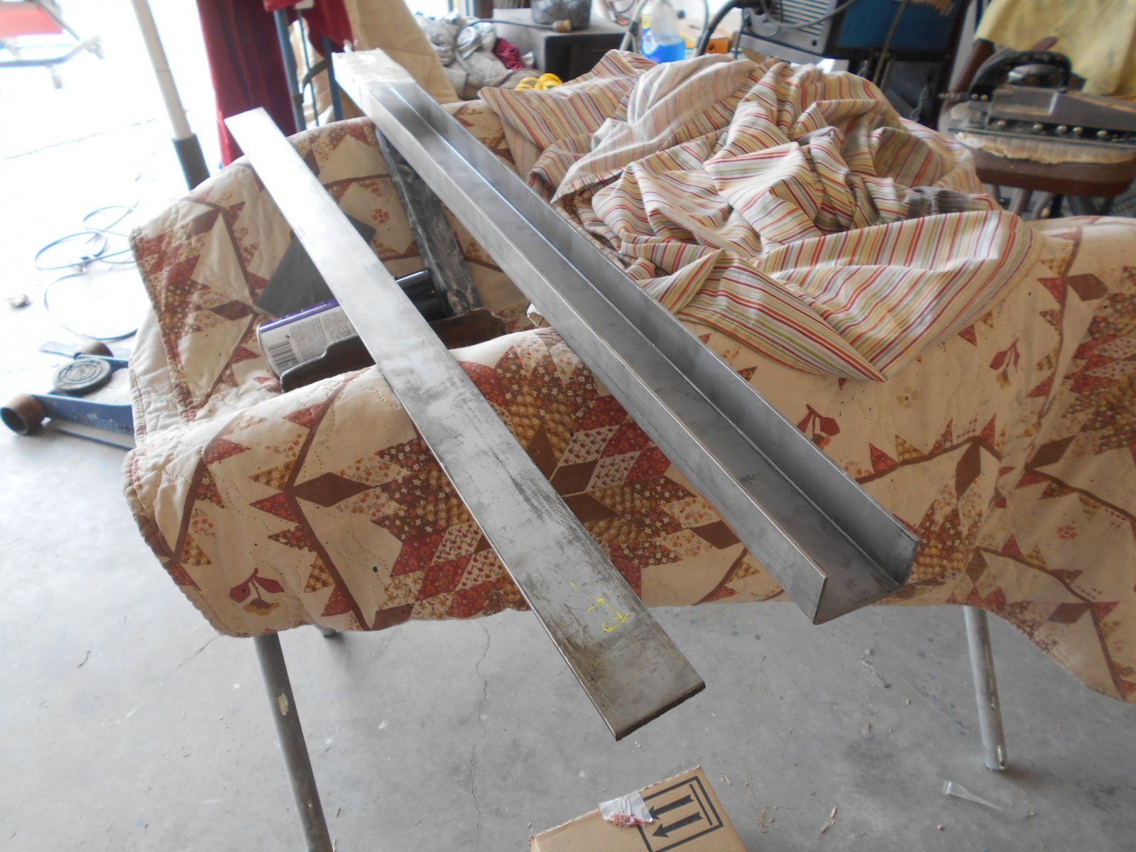

    I don’t know if Jesse told me and I forgot, or if I never asked and thought I knew, anyway this is what I’ve ended up with at this point, and it won’t get me down to where I need to be.
    When I realized that I needed to run this by Jesse, he told me that there was a local guy that he found to solve this problem of getting that rear end down where he wanted it. This guy went out behind his shop and came back with a u channel that the spring would fit in.
    Jesse says that they jacked the rear of the car up out in the dirt, and that the guy had the old cross member out and the new one installed in two hours.
    I’m sure that this will all work out, but I’m more comfortable adding a reinforcement. Here is the first configuration (mine) and the channel/reinforcement in weld thru primer.

    Are you sure that Miss California was not in the trunk when the pictures were taken?:D:D:D
    Nice work, and congratulation for your sense of detail.
  27. atomickustom
    Joined: Aug 30, 2005
    Posts: 3,407
    atomickustom
    Actually that is a good question. We do know that guys would put weight in their trunks for photo shoots. 00Mac said he'd have several friends stand on the bumpers and they'd chain the suspension down and I read at least one photographer interview where they talked about all the sandbags they'd use to lower cars for photo shoots. So it is quite possible the "photo stance" is really lower than the car sat on a daily basis.

    Here's that reinforcement joined to the rear X member. 004 (3).JPG 005 (2).JPG
