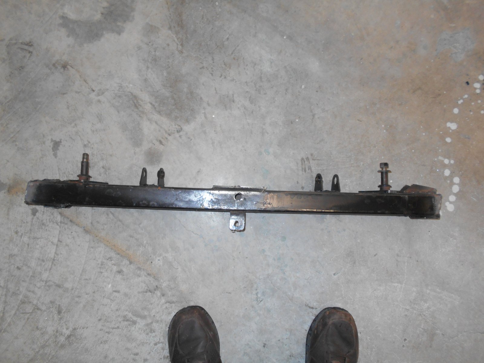

    001 (2).JPG Unfortunately the original X member is long gone. Then I realized that I probably better get another one and do the cut/flatten deal. After seeing how heavy and bulky it was I then called Jesse and desided that I would do it Jesse's way. I can use this to get the correct size hole for the spring pack.

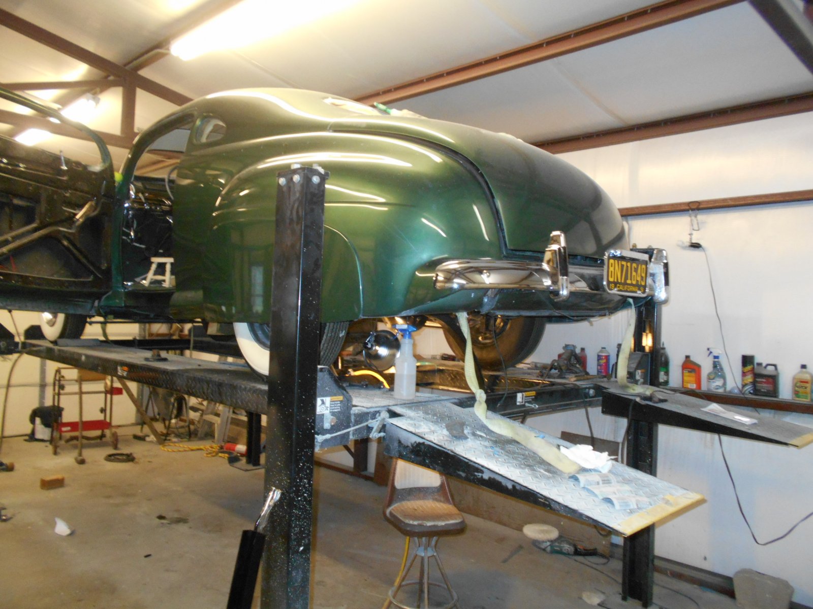

    The jack that came with this lift is very handy. 002 (2).JPG 003.JPG 003.JPG

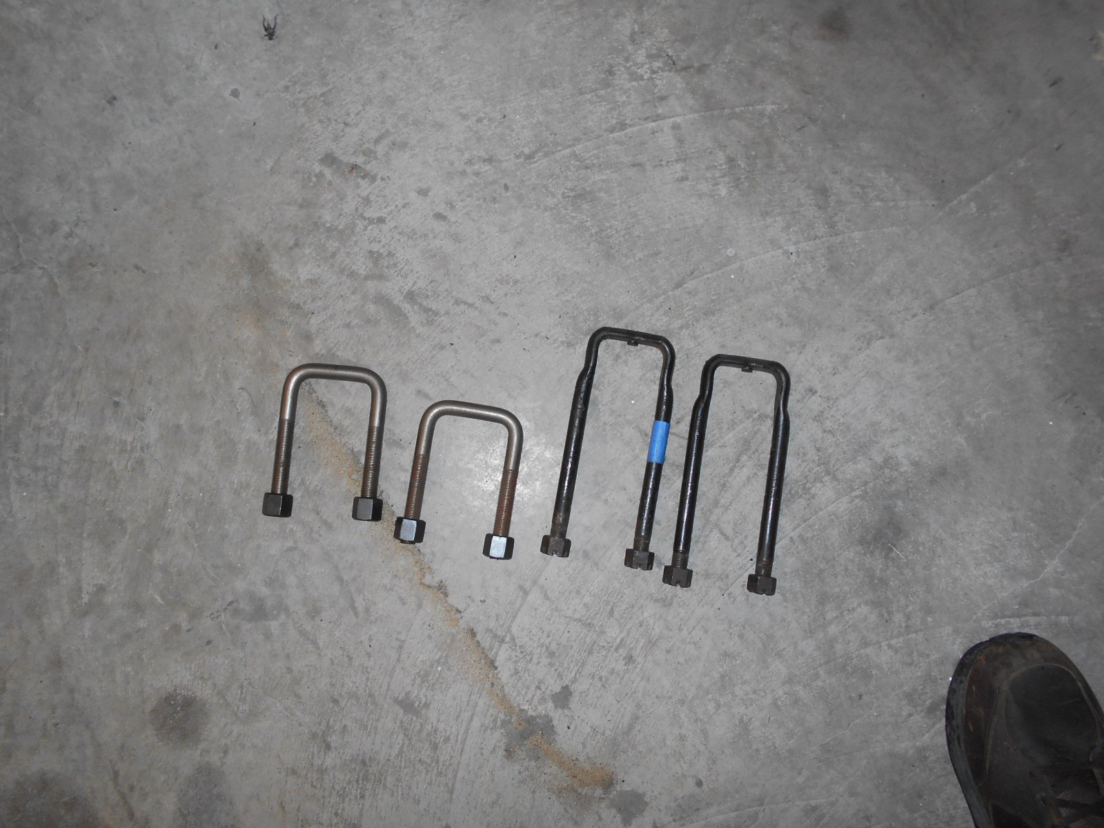

    Here's the U bolt problem with the fix, twenty bucks, while I waited. 005.JPG
  10. MUNDSTER
    Joined: May 11, 2011
    Posts: 293
    MUNDSTER
    Nice! What a bargain!

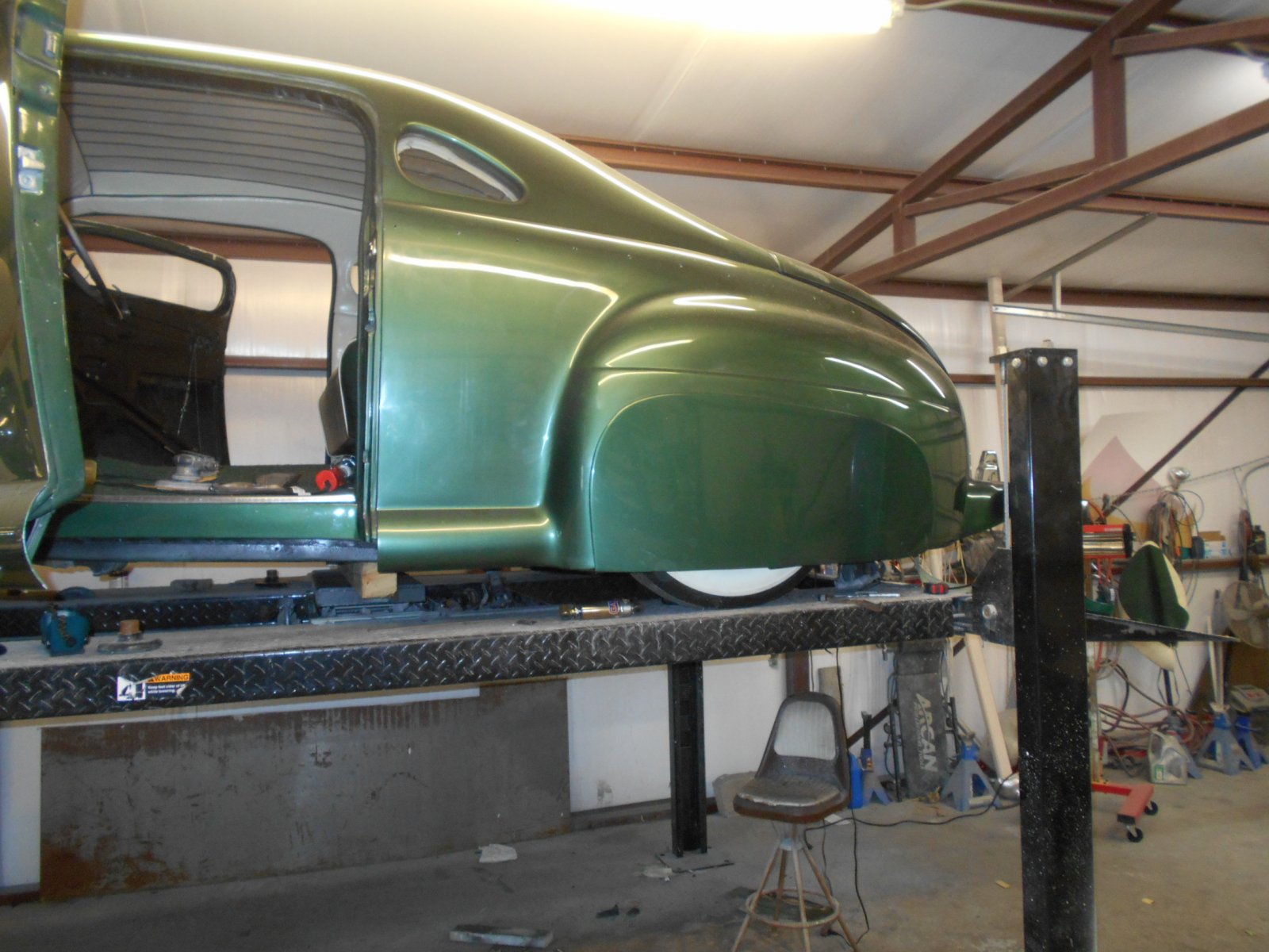

    Like the lowered seat, I'm dealing with fractions of inches. I don't think I have the luxury of this much room for the suspension snubber. 002 (6).JPG 002.JPG

    I'm guessing you are going to have to notch the frame?

    001 (2).JPG With all the time spent under the car looking things over, the C notch definitely looks to be the thing to do. I catch myself when I think thoughts like this because Jesse says that the frame wasn't cut.
    As much as I'd like to notch this frame, I would like to keep things authentic more. Driving around (almost) on the bump stops must have been part of the Jesse Lopez coupe experience.
    This is where I need to be.

    I vote no notch.

    That looks just right and makes the whole look of the car.Perfect.
    I can't believe Mr. Lopez hasn't c-notched the car back in the day.A car this low definitely needs to be c-notched if want to drive/enjoy it.That's no news.Now or 60+ years ago.Here's a pic of the Sam Barris Mercury at Brizios during resto.You get the idea...

    If Mr Lopez says it wasn't notched then it wasn't. Something like that is a little harder to forget then say some little detail.
    Notching it would be like putting bags on Juniors Ford. May make it better but then you start to open up that door to all kinds of changes.....
    This could be part of the reason that Mr Lopez ran a dual shock system it the back. Make it stiffer to avoid riding on the axle.

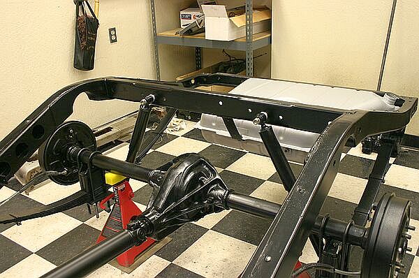

    This thing continues to expand on me. I now realize that I can't just do the rear X member without setting up the dual shocks as well. It's easier and faster to just fab up the brackets myself instead of trying to find something that will work and then wait for them to arrive.. Pics to follow.
  21. jivin jer
    Joined: Sep 14, 2008
    Posts: 3,535
    jivin jer

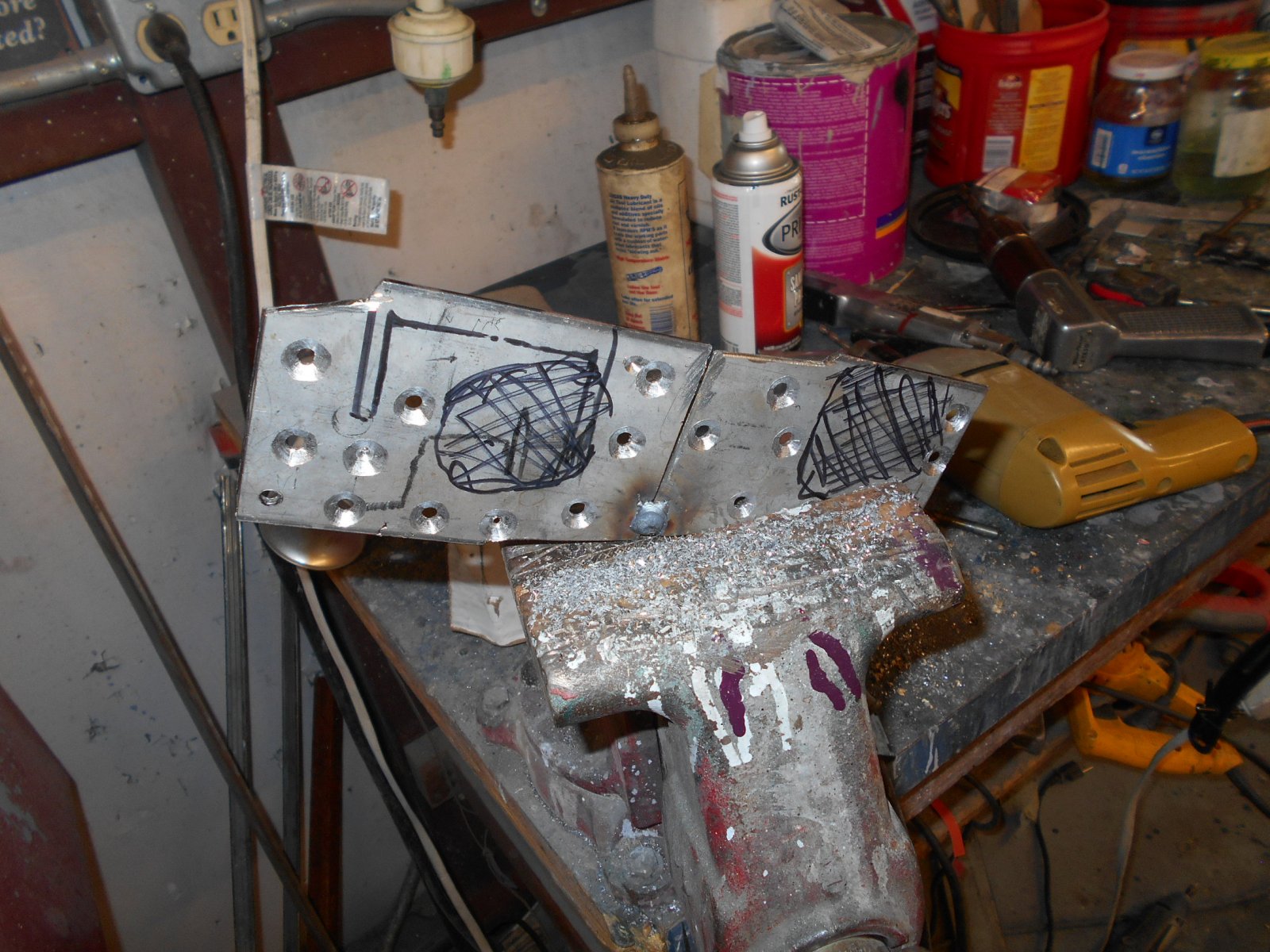

    001 (6).JPG 003 (6).JPG Here's the brackets for the L side coil over shocks. With all the big holes in the inner frame rails, I think the thing to do is "fish plate" the area.
  22. jivin jer
    Posts: 3,535

    001 (3).JPG 002 (2).JPG Here's one of the "plates", and where its going to go.

    Thanks Dave, everything is positioned correctly and tacked together. Then removed and welded up solid out from under the car.

    Here we are all welded up and corrosion protected.

    OK, almost there. I would like to install the gas tank and get this thing ****oned up, but I gotta do those inboard shocks first.
