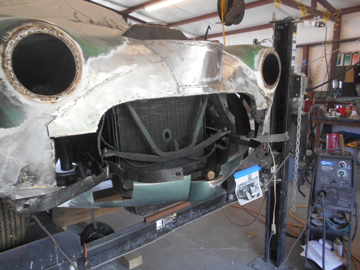

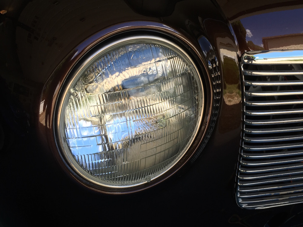

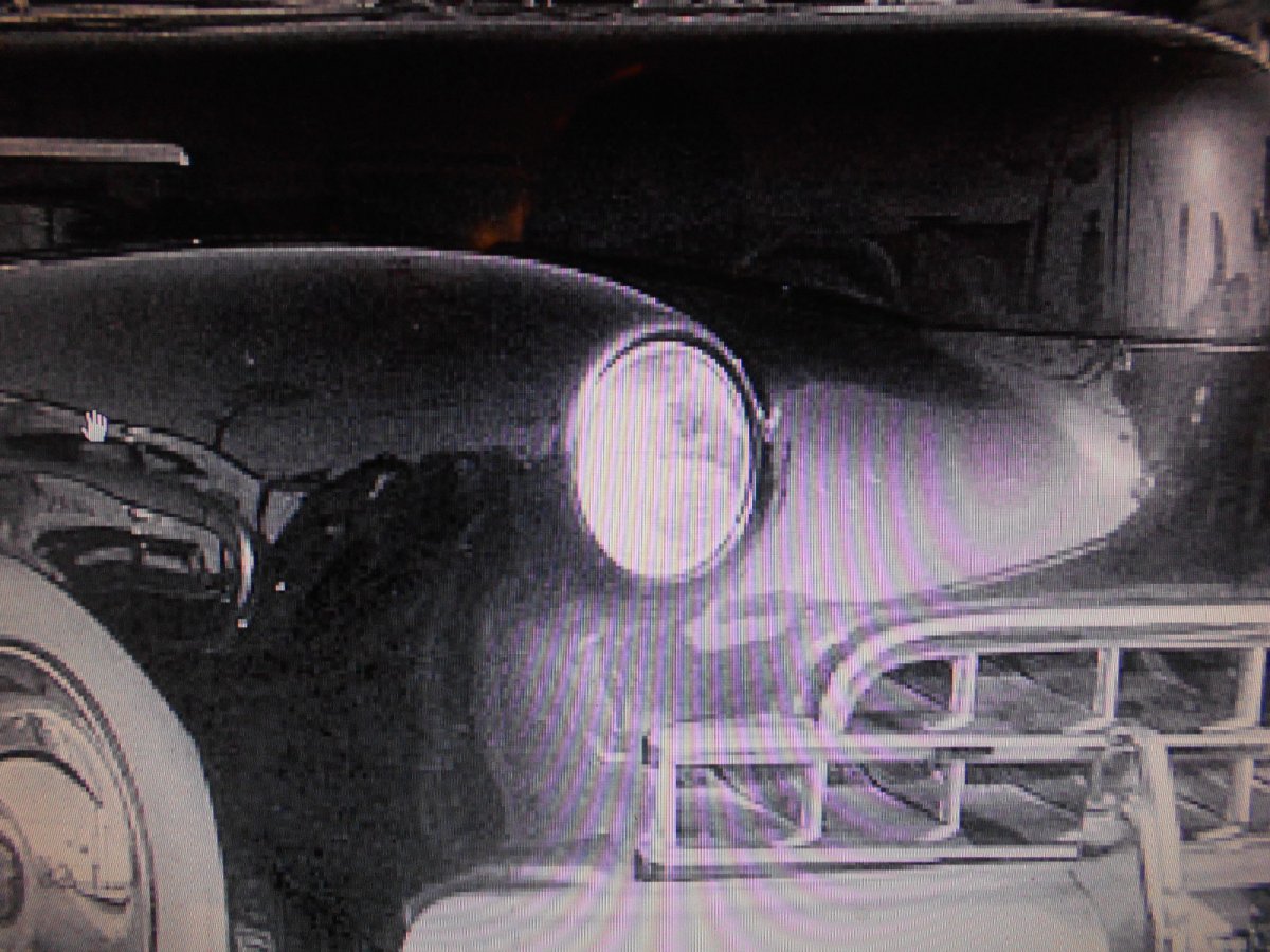

    Jesse has informed me that the headlights aren’t correct. He says that he didn’t want the retaining rings to show like they do in every frenched headlight that I’ve ever seen. Looking at the original pics they are plainly seen to have no retaining ring. Pretty cool, I missed it completely. Why I wasn’t told before, I don’t know, but I’m glad that I was told now. Jesse doesn’t remember how he did this.

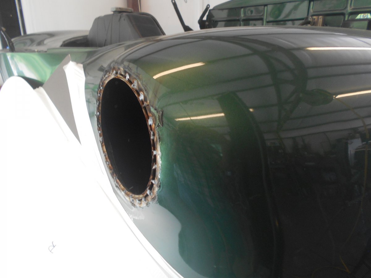

    012.JPG View attachment 2998301 View attachment 2998301 011.JPG Jesse can't confirm it, but this is how I think he did those headlights. I cut a retaining ring, reversed it, and then tacked, and welded everything up solid. I guess we could call it a "Jesse French".

    Green is on fire! ......great job, at the moment to drive the car, you burn the paint!....you've got balls! ;-)
    Peanut 1959 likes this.
  9. rob-redm
    Joined: Nov 15, 2005
    Posts: 6,755
    rob-redm
    ??? mmm, OK.... Looks spiffy Jer....
    CadMad likes this.
  10. Hey..! Make the ring part of the fender! Clever boy Jer!

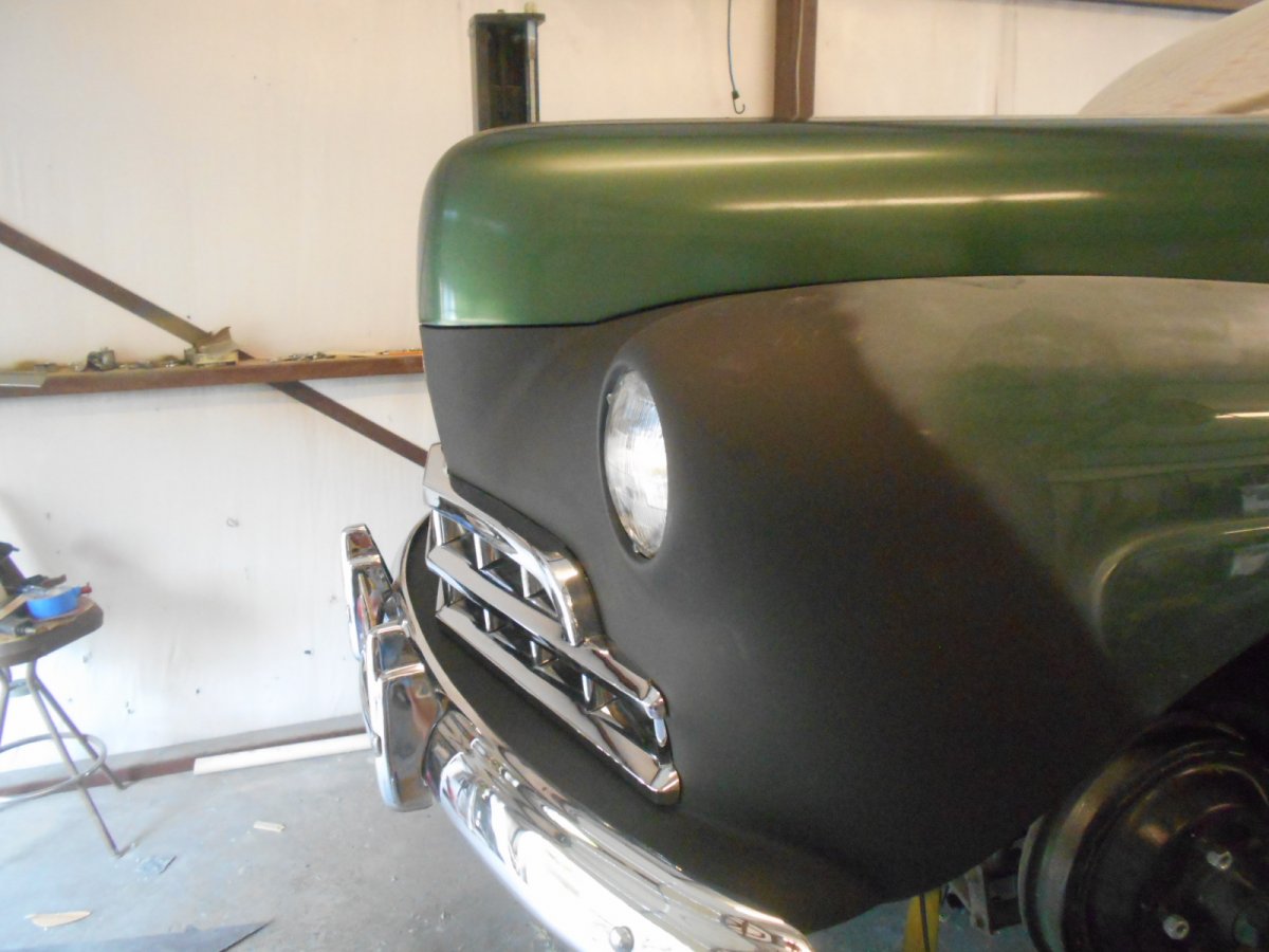

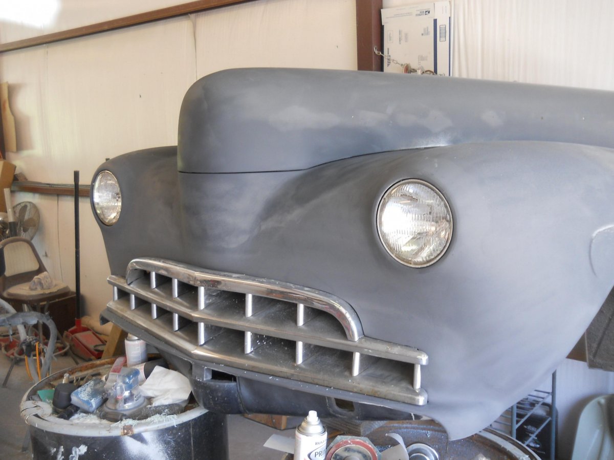

    Unfortunately we need to talk about the nose/grille thing one last time, this is it, I promise. My initial attempt to get things clarified with Jesse about this (way back then), could be described as a hit and run at best. I asked him if he used the original ’41 bumper brackets when he did the nose. He said yes and I thought I was rollin’. To me this meant that the “46 gravel shield was just above it.
    This was at the beginning of this project and after Junior’s car and all the atta boys I got I was feeling pretty full of myself and thought I had the “feel” for this job. A very dangerous condition to be in when doing something like this. Thinking that I had everything I needed for this part of the project.
    As it started to become clear that there was going to be a problem with how this looked, I was convinced that this was another example of what the distortion in the old pics can do . I brushed everything off using distortion as cover. The great comments from the guys that came to my defense were really appreciated, but only added to the problem of me actually coming to grips with this issue. I was actually preparing to proclaim to the whole world that the car we see in the original pics NEVER EXISTED.
    As this whole excrutiating experience has played itself out, and I have arrived at this place in time, something strange happened. It was as if the Kustom Car GOD held me over the cliff, let me see the bottom, and asked me “are you sure you want to continueley be fighting this battle?”
    My reply was OK, I need to send Jesse some pics that show/accentuate that long droopy nose at its best/worst, and get his reply. I got it alright, loud and clear. “What the @#%* is this?” etc. etc.
    It turns out that he did use the stock brackets as he said. The problem is that I didn’t press him further about any details because of the aformentioned mental condition. In the stock position the brackets point down. To get that grille in the correct relationship to the hood he lifted/tilted them up, still using the same mounting holes (now inlarged). This raises the gravel shield (to which the grille sits on) up into the configuration that we all have seen in these old original pics forever.
    So while having to step back and painfully realize what has happened, I am jazzed about actually being able to (now) duplicate the cool car that we all know and love.

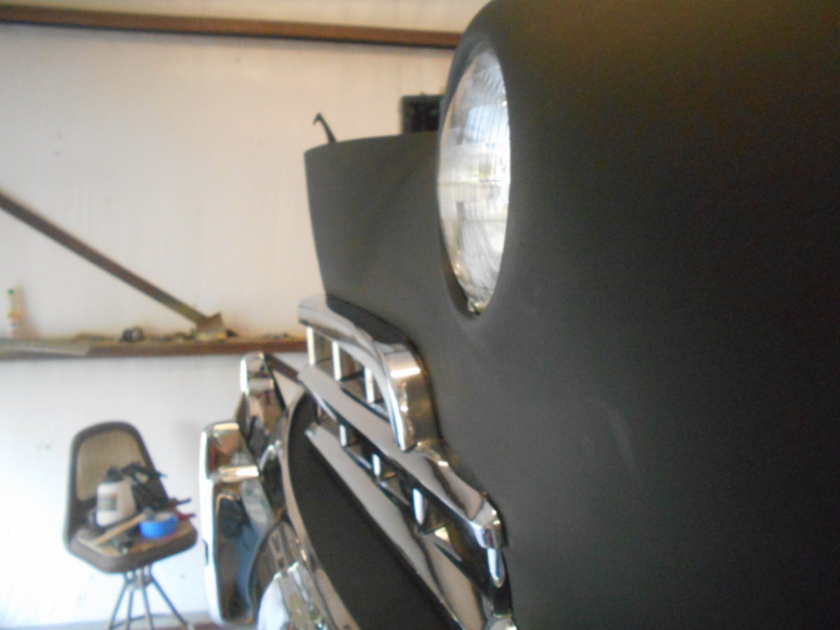

    014.JPG 015.JPG 016.JPG 021.JPG Jesse said that when Sam put the new '48 Cad grille up to the '41 Ford nose that was stripped of all the components he said " this grille looks like it was made for this car". That was difficult to see in the location that I had it in at first. The more the grille was raised, the more I understood what Sam meant. In all, the grille was raised 2" from where I had it, it sits 1/4" off the gravel shield to make install/remove easier.
    When Jesse saw these pics he said, "you nailed it". I can tell you that this is much better than being "nailed". Even worse for eternity. View attachment 3003482 View attachment 3003482
