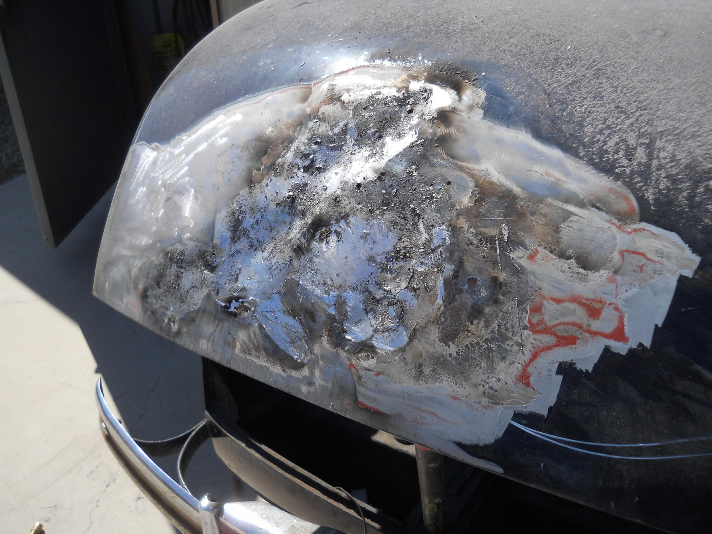

    Well aint this just fine. Not as quite as bad as Snooky's but, this is supposed to be after the "fix".
  10. koolkemp
    Joined: May 7, 2004
    Posts: 6,006
    koolkemp
    you should see what I had to do to make a trunklid :eek:
  11. PeteFromTexas
    Joined: Apr 4, 2007
    Posts: 3,837
    PeteFromTexas
    That's a fair amount of lead there. Guess they couldn't, or didn't want to, pull it out. Ill take that lead off your hands if you don't want it.

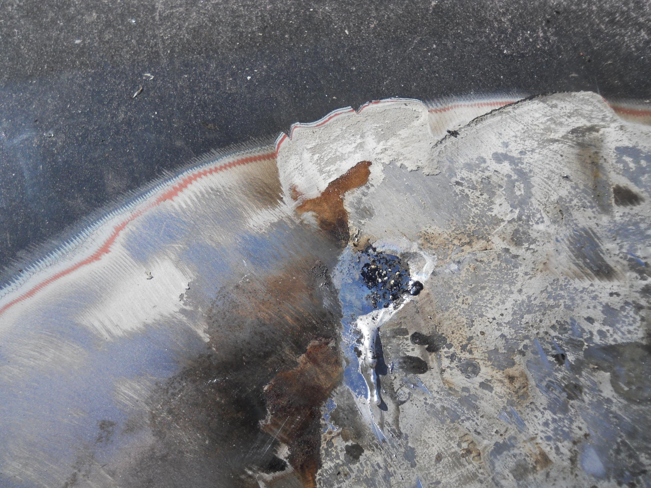

    Here it is worked out a little. I'm going to get access from the back.

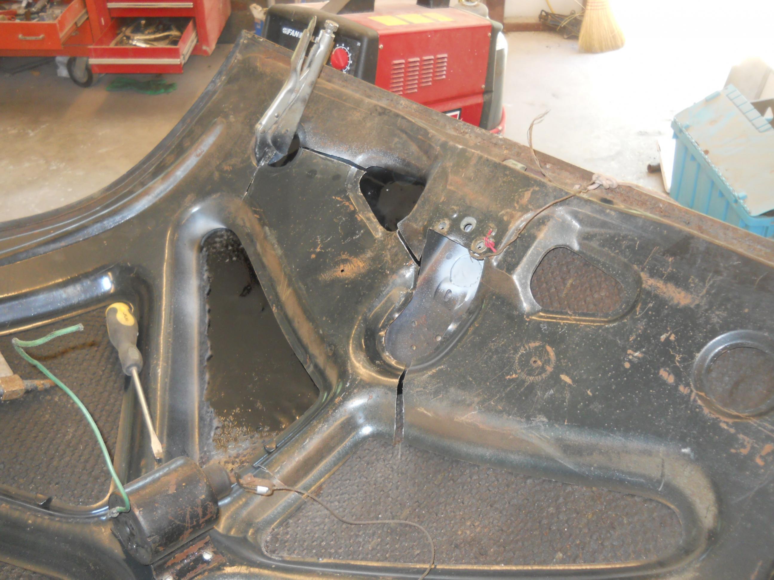

    I've welded up all the holes. I didn't want to completely remove the inner lid support. I did some more pushing and shoving. I've put more bondo on it than I'm comfortable with. I'm going to keep my eye's peeled for a better lid. I've got some cheap rattle can primer on it for the time being.

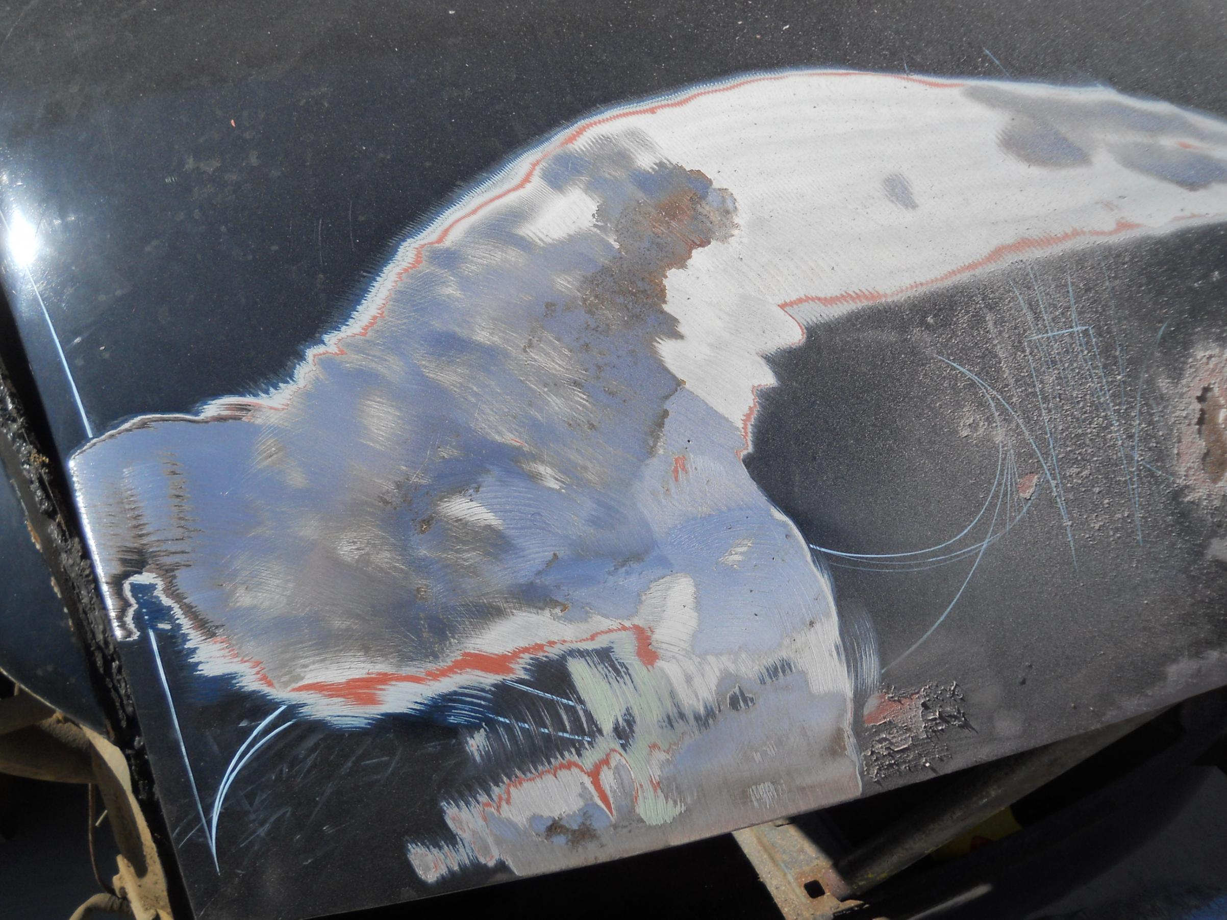

    Let's clean up the rear fenders. They're in great shape.

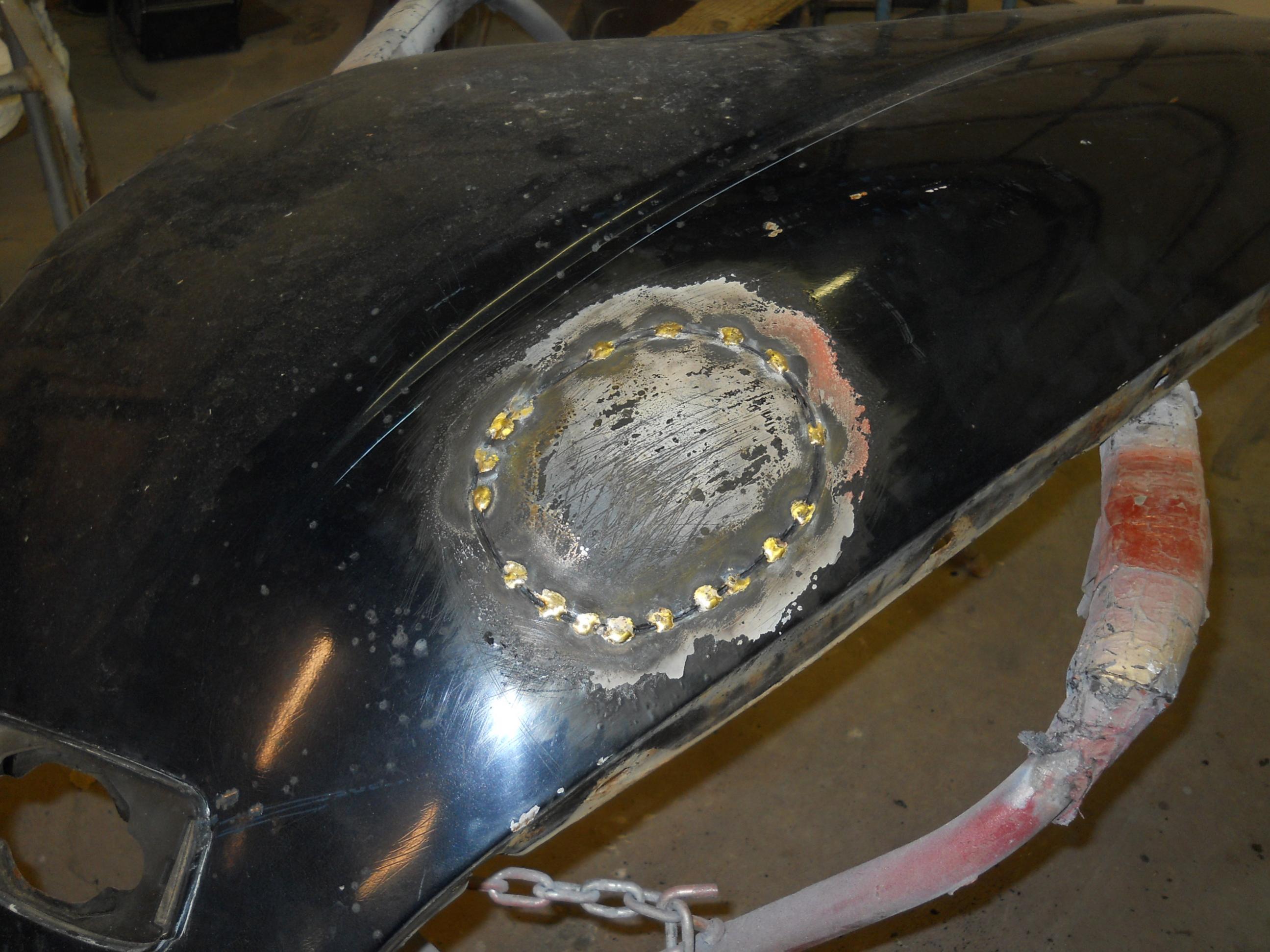

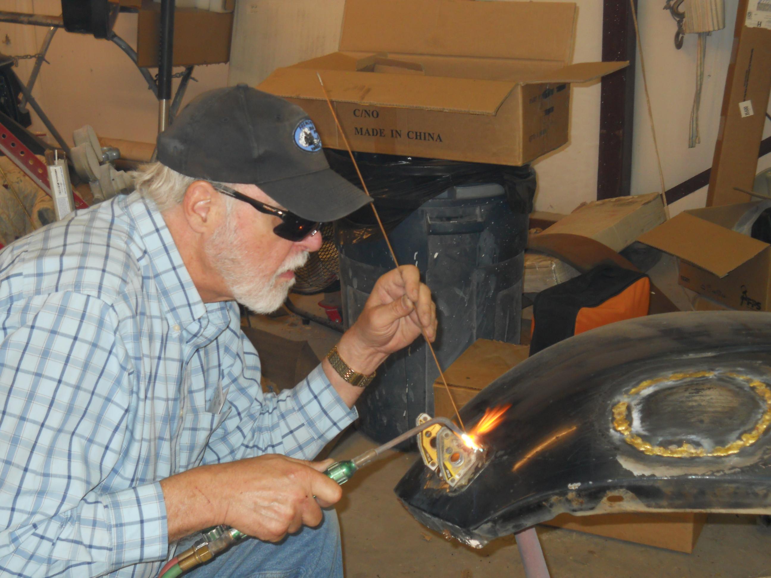

    I’m going to try and combine old school with new. For the sake of tradition. I asked Jesse how much br*** was used on his car, he said “lots, we liked how it flowed”. I’ve brazed my share of ¼’s on back in the day. So we’ll see how this go’s.
  20. jivin jer
    Joined: Sep 14, 2008
    Posts: 3,535
    jivin jer
    As in the new TRJ look at Barris Kustom, all seams are completely covered with br***.
      369.3 KB
      749
  21. PeteFromTexas
    Joined: Apr 4, 2007
    Posts: 3,837
    PeteFromTexas
    Looking good Jer. I not a fan of br*** though. I got your message. I'll try to call soon
  22. pimpin paint
    Joined: May 31, 2005
    Posts: 4,937
    pimpin paint
    from so cal
    Hey,
    Fourty years ago plus, before the days of ''squirtgun'' welders we brazed just 'bout everything. It was faster than a full gas weld, and usually required less heat- the down side was the flux:eek: Be sure you remove all of the flux and fire scale from all of your brazed areas before you go with your epoxy undercoat.
    Whata great project:)
    " A government by the people, for the people " My ***!
  23. PeteFromTexas
    Joined: Apr 4, 2007
    Posts: 3,837
    PeteFromTexas
    Yeah that flux can be a headache. I've had to fix some real nightmares having to do with br*** over the years.
