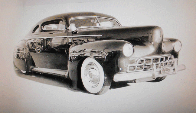

    After looking at this for a while I realized that this also solves that "so called" problem with the chop, and nails down that grille once and for all time.
