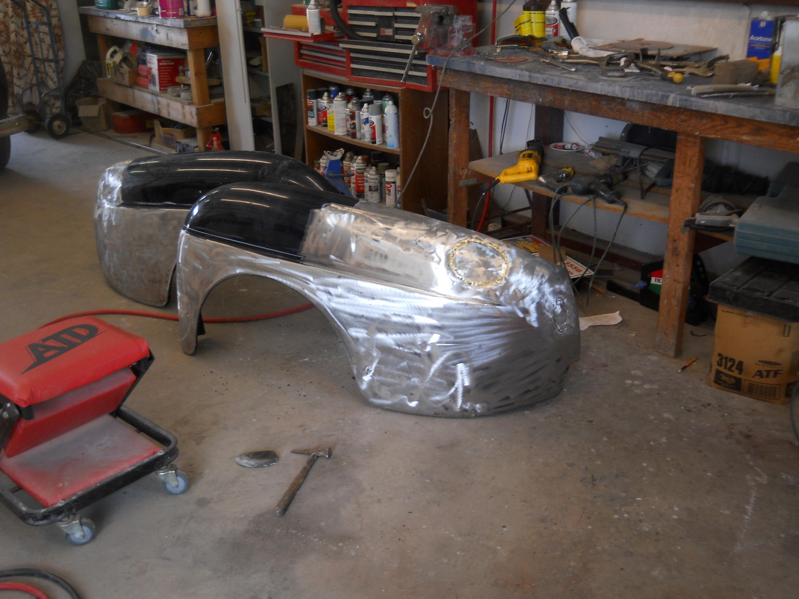

  3. jivin jer
    Joined: Sep 14, 2008
    Posts: 3,535
    jivin jer
      386.3 KB
      637
  4. PeteFromTexas
    Joined: Apr 4, 2007
    Posts: 3,837
    PeteFromTexas
    Pretty dang solid rear fenders Jer.

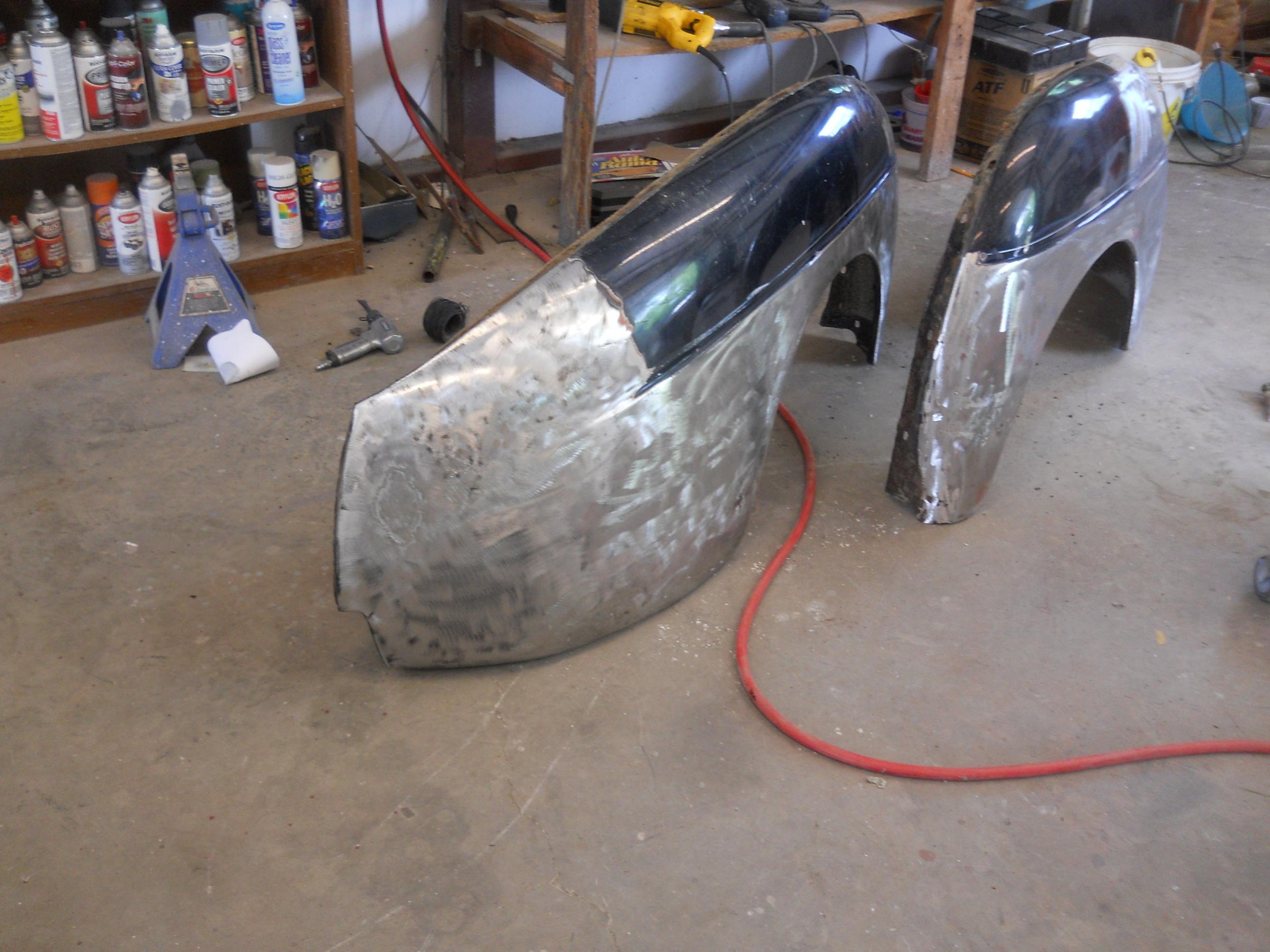

  8. jivin jer
    Posts: 3,535
    jivin jer
    Cheap rattle can primer for temporary protection.

  9. jivin jer
    Posts: 3,535
    jivin jer
    It's time to figure this part out.
  10. PeteFromTexas
    Joined: Apr 4, 2007
    Posts: 3,837
    PeteFromTexas
    Fun Jer! Molding fenders is a blast! Plus adding those skirts... A blast

  12. pimpin paint
    Joined: May 31, 2005
    Posts: 4,937
    pimpin paint
    from so cal
    Hey,
    I'd suggest you avoid the use of round stock mudded over with ''Kitty Hair'' and standard polyester filler, ditto round stock brazed into place and leaded over:D I'd instead go with 18 or 19 gage sheet formed on a bead/swaging machine or e-wheel to the exact radius of the blend from fender to quarter. With this method you'd avoid many ,many hours of sanding filler that will only cause ya paint trouble up the road, and only have to lead where the fender & quarter makes contact with the fabricated radius panels;)
    " Spending a nation into generational debt is not an act of comp***ion "
  13. PeteFromTexas
    Joined: Apr 4, 2007
    Posts: 3,837
    PeteFromTexas
    Thats exactly what I was thinking! It's the hard/long way but the BEST way
  14. pimpin paint
    Posts: 4,937
    pimpin paint
    from so cal
    Hey 235, not all that hard/long of a way when ya figger the hours guys spend gl***in, muddin & blockin in those quarters with ''Kitty hair or round stock and mud only to be bitten in the *** when the body flexes and/or does hard time for a few show seasons in the summer heat:eek::mad::eek:
    If this build winds up bein top coated with lacquer (nitro or acrylic) i.e. traditional kustom finish, ain't no way I'd pull the ''kitty hair/mud'' lever;)
    '' Do not reach greedily for the Kool-Aid "
  15. PeteFromTexas
    Joined: Apr 4, 2007
    Posts: 3,837
    PeteFromTexas
    Good point, I totally agree. It really drives the point home when you put it the way you did. Anyone can fill a panel full of kitty hair and mud. Building the transition from metal may take longer and be harder for some but in the long run it is the easier way.

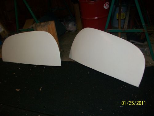

  18. jivin jer
    Posts: 3,535
    jivin jer
    This is what wer'e after.

  20. jivin jer
    Posts: 3,535
    jivin jer
    This is what I see "out there". Definatley want some thing original or a facsimale there of.
  21. chrisman
    Joined: Jun 13, 2002
    Posts: 721
    chrisman
    The proper skirts you are looking for were one-year only, and preferred when turning any '41-'48 Ford into a custom. I suppose that's the reason why they are so hard to come by. I think I found a correct set on ebay, but haven't been able to check them yet as they are stored with the car in so-cal.
  22. jivin jer
    Posts: 3,535
    jivin jer
    There are fibergl*** "long skirts", original and reproduction "shorty" types available. This is not an acceptable solution. The occasional genuine one's that become available are extremely rough or out of sight for money (or both).
  23. PeteFromTexas
    Joined: Apr 4, 2007
    Posts: 3,837
    PeteFromTexas
    If you got a set of fibergl*** ones they could be used as a template for making a good steel set.

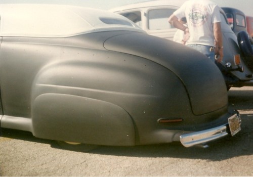

  26. jivin jer
    Posts: 3,535
    jivin jer
    This is an original that Palle Johansen (Jack Stewart Ford) had a picture of. The solution to the problem starts here.
