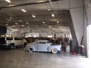

    As I was aggressively, but carefully sanding that lacquer down, I was surprised that the 80 grit paper wasn’t clogging, and/or melting the lacquer like I remember it doing back in the day. When you’re methodically careful about keeping all these p***es equal, it takes awhile before you start to see the primer just starting to become visible. How much and how even depends on being consistent with your pattern, Hey, this is going to work.
    In spite of this “setback” I’m feeling real good about “things”, and I realize that if I’m stripping the car, I must stop sanding and start removing all the trim, and applicable parts. I’m putting in four hour days, and it takes two days to remove the bumpers, grille, side trim, spotlights, and the front and back gl***. I have to remove the door garnish moldings because I have to have access to those window opening “fuzzy’s” that are against the paint on the window opening. I keep my head down and concentrate on the task at hand, so I dominate the shop atmosphere with all this noise.
    The shop part has 26 tech’s, this includes parts and the detail area. I make friends with the sweeper guy that has a big treated dust mop and makes two p***es a day through the shop area. This keeps my car from being covered in dust, what kind of a “body shop” is this? Without my racket the shop is pretty quiet with the most common thing done being panel replacement. The office has 12 employees .
    This is definitely a “culture shock” for an old “body shop” owner like me. I equate chaos to production, and it’s the atmosphere that I do best in. When you here people from back in the 50s talk about the Barris shop, eventually you will hear some one say “we couldn’t believe that all those cool custom’s could come out of a dump like that.”

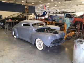

    As I have mentioned earlier this transformation took place awhile back. Once the hi-build primer and guide coat was on the car, Dan tells me that he didn’t want me to work on the prep part of this job. The car was just across from his office and was positioned there so that he could have easy access to it, when he had some spare time. So I guess you could say that I got fired for the third time, I’m beginning to see a pattern developing here.
    I did make an effort to label, and organize, all the parts that were removed. I think calling in a pro to install the windshield and back gl*** in their rubber gaskets, is going to be the right thing to do.

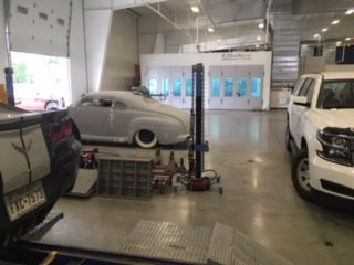

    Son Dan is blocking the primer down using 180 grit on a Dura block, the long narrow one. He's sanding it dry, using 800 wet on the edges.
    I asked him what kind of responses is he getting with car just sitting there. Shawn, one of the techs there, and Dans friend, mentioned that he was a bit concerned with the car sitting next to all the unibody bench's and heavy equipment. Shawn's dad had a shop back in the day, they're Mexicans and he knew exactly what the car represented.
