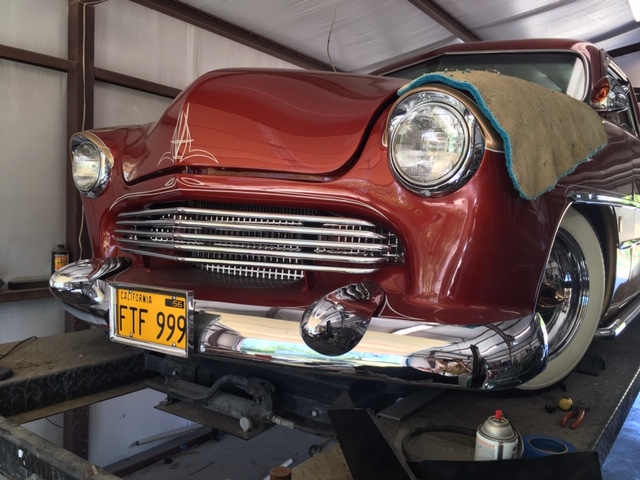

    Thanks for the comments guys. Way back when I started Jr's build I came face to face with what "tyrants" clones can be. The more detailed and accurate they are, the more "at***ude" they end up with. This is hard enough to do without having to put up with a fractured ego from a hunk of metal, and fabric.
    So I need to swap out with Jr's coupe, the space it occupies on the lift with Jesse's clone. The answer from Jr's coupe? "Naw, I like the view from up here." It usually takes a bit of persuasion to get the gas from the tank up to the carbs after it's sat for a while. After a while of cranking and priming the carbs I realize that I have a problem with no gas at the carbs, no matter what I do.

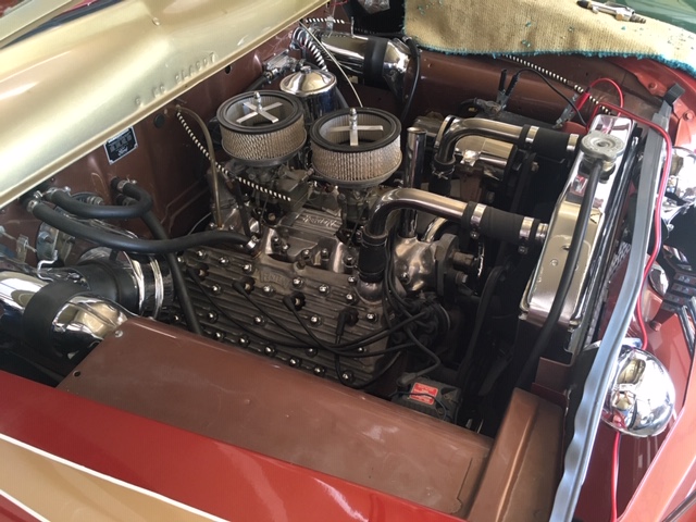

    I work my way back to the fuel pump which does work, because "we", son Dan and I have removed it and it pumps gas. So I'm at the line from the pump to the gas tank which is new.
    So stay tuned, the "perils of Pauline" continues, with pics.

    Well, all the lines are clear, which leads me to think that what I need is a USA made replacement pump. I have a regulator near the carbs thats set at 2.5 psi, which is what's recommended for this application. So, does anybody have a good recommendation as to where I would find a made in USA inline pump for this application?

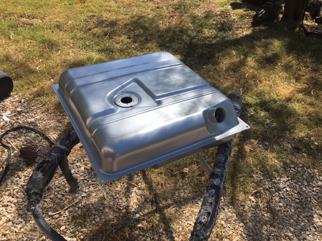

    I've worked my way back to the gas tank, I can't get any gas to come out of it no matter what I do. This tank is a Bob Drake product and is about nine years old. I'm going to try to call them and see what they have to say.

    With the exit tube removed from the tank, I have the threaded hole just looking at me. I take my blow tip and blow into that hole and "walah", I have gas and lots of it. I drain all the gas out of that tank, about 10 gallons. I could just put it back together and start the car, but I'm asking for trouble if I don't drop this empty tank and try to flush out whatever was clogging that outlet.

    Well, thats the purpose of buying a "new" one. I wouldn't think it would go dirty, just sitting there. I need to go look this am inside the rinsed tank, the pick up tube extends to the middle of the tank. I thought I saw what looked like tape of some kind rapped around the length of that tube. It also looked like it was unraveling at the end, that could be the source of the obstruction.

    The "unraveling" turned out to be a distorted tab on the pick up tub that connected it to the floor of the tank. In trying to force gas out of the tank by blowing air into it I turned a rectangular shaped tank into more of a bulbous one. So it's time to get a new tank and make a fresh start.
    One of the things that's always bugged me right from the start waaay back then, was not being able to know how much, or how little gas I had in that tank. I can't remember now what I did, but I thought that I got it to where it was registering a 1/4 tank at the gauge. You buy a "new" repo tank with a "new" sender you got it, right?
    Wrong! I can't think I have a 1/4 tank of gas, if it fills up two 5 gallon gas cans, now can I? I've spent hours on line looking at forums about vintage Ford gas tank sender/gauge issue's, including Ford Barn, and I've come to the conclusion that unless I can find an original sender thats in good shape, and works, I'm Sol.
    I might as well just put every thing back together with the new tank, and keep enough gas in it to be able to tell by "knocking" on the bottom of the tank. What a helluva place to be in, but I didn't see anyone that had a better idea.

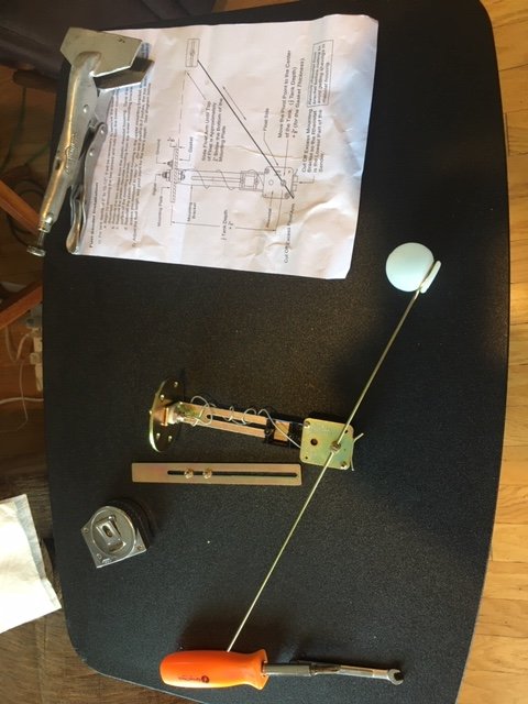

    I’m getting ready to install the new, Tanks inc. tank. I’m modifying it to accept a Bob Drake fuel sender, the one out of the old tank. I did notice that this sender doesn’t operate freely, it’s like it’s in a bind. You can hear and feel the tightness as you make it swing through its top (full), and bottom (empty) function. I took a screw driver and pried the mechanism open, just a bit. It now actually will fall through it’s normal range as I manipulate it , this might be what was keeping it from functioning, we’ll see.

    When I have help it goes pretty good, otherwise I'm subjected to my need to go inside and "take a break". Nevertheless we "press on". I purchased a Tanks inc sending unit and i'm glad I did, as you can see here, it's a pretty substantial piece, compared to the old Bob Drake unit. I hope this gives me a reliable fuel gauge reading.

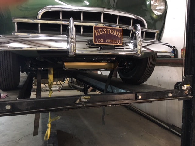

    Looking at the grille from inside the fender there is a problem that needs to be dealt with. I’m calling this an apron extension. A work in progress. IMG_0610 (1).JPG IMG_0608.JPG IMG_0612.JPG

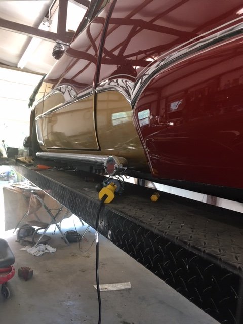

    Well, I was forced to install an update on my computer. I hate these things. I wanted to show the lower scoop that was fairly common on these cars from this period, my computer ate it. So, here it is installed from the bottom, and from the front.

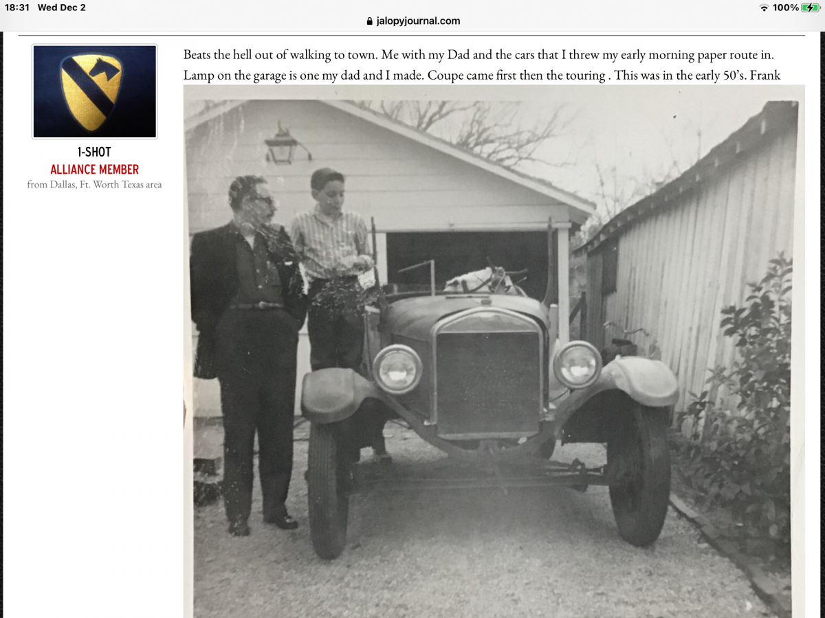

    37A51E6E-4950-439E-8B26-2C6458DC692C.jpeg 7DF187CB-4F6A-48FC-889A-0728BA936DB7.jpeg Pic. Of our bird taken by Joe Galloway and the bumper sticker on my truck
