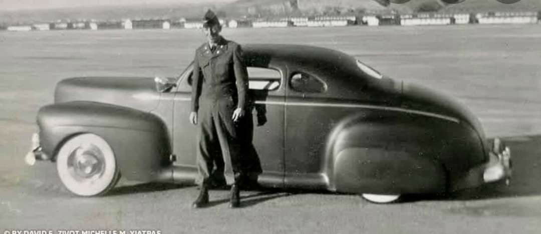

    This pic popped up on one of my Facebook groups, today. According to Rick Hoving:
    "Original Jesse Lopez photo from the David Zivot Collection."
    I don't recall whether it was previously posted on this thread, but it's good enough to share again! FB_IMG_1607317091589.jpeg

    This is one of the pics that were very helpful to know where I was at as I struggled to see if I was accomplishing my goal of "authenticity". The shadows from what looks to be intense morning light shows the shapes that all those side panels that were modified to capture Jesse's iconic coupe looked like. It starts at the front extension from the gravel shield to the lower front fender. Especially the side from the door back. This let me know that the molded fenders were correct, including the lower portion were everything came together just in front of the skirts, and that extension from the lower rear portion of the fender that connected to the gravel shield was also correct.
    You need to know that it was a thrill.

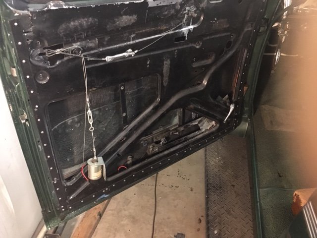

    I started putting the doors together, doing the r side first. I had to take them apart to remove that thin piece of trim around the opening so that it wasn’t masked when everything was repainted. Back in the day you would mask this instead of blowing everything apart, but not on this car/job
    When I came to the l side, the mech sounded like it was dry when I rolled up the window, not good. So I tried to partially dis***emble it to be able to get at the innards to white lube it and I’ve created at bit of a conundrum. It got all jammed up and with the car on the floor I couldn’t get the leverage to be able to use my long arms. This was one of the reasons that it had to be on the lift.
    Now I’ve got the gl*** separated from the mech thinking that I can slip that gl*** up into the channels and then attach the mech with the gl*** up and out of the way. Not as easy as it should be. When things like this happen I go inside and take a break and think about it, and come back out and go after it again.
    So far I’m still thinking about it. We talked about this earlier. IMG_0625 (1).JPG

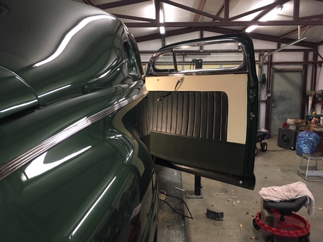

    When your at this level you sometimes get interesting views. Finally I have the gl*** in place which lets me start the ***embly process.
    The thought came to me that I should inspect that door gl*** carefully for any damage with all this crashing around stuff. Sure enough, a very small chip on the upper inside edge at the vent window. Its off to the local gl*** shop and maybe I can get it back tomorrow.
  26. jivin jer
    Joined: Sep 14, 2008
    Posts: 3,535
    jivin jer
    I did get that gl*** today, and this is what I want to duplicate on the l door, unfortunately Murphy’s law has struck a blow. I am eleven percent Irish.

    So, what is that clip for?
  30. redzula
    Joined: Jul 6, 2011
    Posts: 1,366
    redzula
    Jerry I've called my Iowa old parts guy looking for your clip with no luck. He things that 41 window regulators we're a 1 year only thing. And I don't know enough to know if that's true or not. But I'll keep looking.
