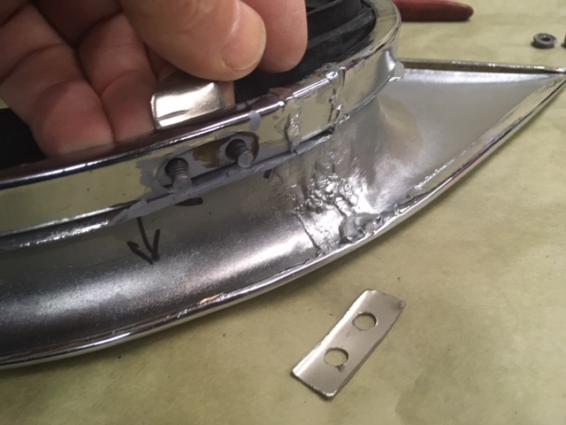

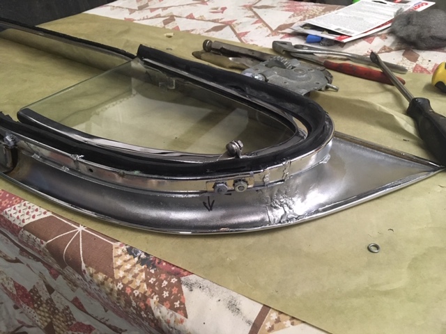

    Well, I thought that just showing the r. door would be sufficient, not quite. The drivers door was a bear, so lots of adjustment was built into the ***embly, and I'm able to show it better here.

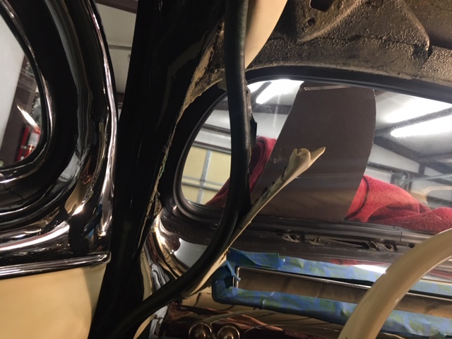

    Well, I contacted the trimmer that did the upholstery (Chris) today. He lives very close by. I had to remove the windshield along with the back gl***, when I stripped the paint. The guys that reinstalled the windshield had to remove the "header" that was installed just above the windshield because it didn't leave room for that gl*** in the rubber seal to be able to clear. I need Chris to look things over and show me what he used for sealer, and what else to help me either to install this thing myself or he installs it in my shop. He wants me to bring it to his shop in downtown Fort Worth in my trailer, something that I definitely don't want to do.
    This is another big deal because with this done I can install the stainless/chrome trim on the windshield (inside and outside), along with the wipers , AND the spotlights.

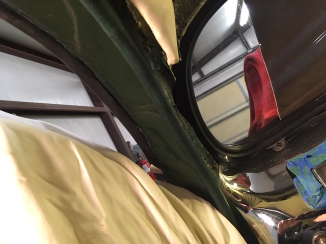

    Chris was a no show on Sunday and I was a little surprised, I had interacted with him a couple of years ago about having the front seat bottom built up a little, when I took it down to his shop. The problem was mentioned and explained to him at that time. He gave me a deal on the seat repair as a result of the conversation.
    The only explanation that I can think of is that he has never had this happen before, which I translate into him not being around chopped tops much.

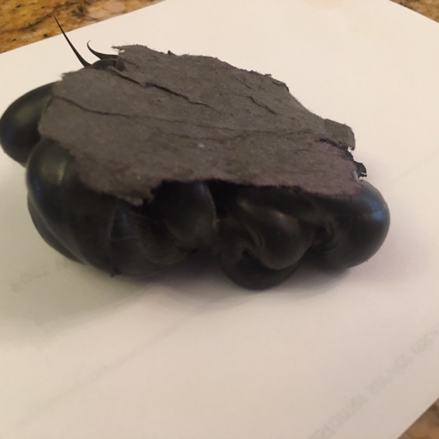

    Anyway, I think I can fix this if I can find out what the black heavy substance was that was behind that header panel above the windshield, he had it across the front and really large amounts in the corners. It would have been in a cartridge in a cartridge gun, a glue of some kind.
    We are having the coldest weather in two years which means I may have take a break out in the shop.

    Is it windshield urethane glue or silicon? I am leaning toward windshield urethane
  16. 1-SHOT
    Joined: Sep 23, 2014
    Posts: 2,920
    1-SHOT
    from Denton
    How hard is it to trim urethane is harder than silicone. Both come in tubes.

    Here's what the big m*** that was on the right side looks like. Its semi rigid and will give a little when twisted.

    Looks like windshield urethane to me

    My process has been to go slow and do waay more thinking than doing, and I think I’ve arrived at a good place. The most intimidating part of this header is the use of this windshield sealer, because of what it is, it has the potential to create a colossal mess that definitely would put the car into the trimmers shop. If all I had to do was position it correctly, I could “snap” it in place using the plastic “push in” type fasteners. I see the holes just above the windshield that the four fasteners are forced into.
    The big revelation is, I am now certain that Chris snapped that header in place, AND THEN used the sealer as glue to make everything “tight”. I was trying to figure out how to put the sealer on the header edges and then lift it up into position. A sure fire formula for disaster.
