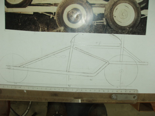

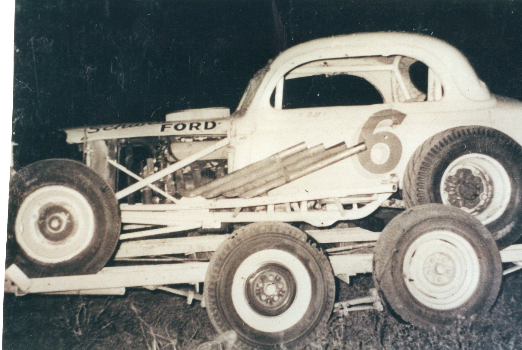

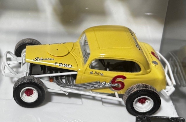

    img581.jpg Schwister built tube frame  1957.jpg Phils model # 6 Ol Yeller.jpg 2023-08-04 13.53.50-3.jpg 2023-08-13 20.39.40-2.jpg Driver Billy Schwister. F E power. Finished 2nd in points overall, Four 1/4 mile tracks. Quite an accomplishment what with the S B C engine takeover was complete in 1958 and many of the S B C 's where running Hilborn fuel injection & methonal. 13 fast times at Hales Corners track. I have the rear axle****embly & front axle****embly finished. Waiting for delivery of mandrel bent 2 1/4" round tubing to arrive. Yellow model by Phil, Milwaukee.

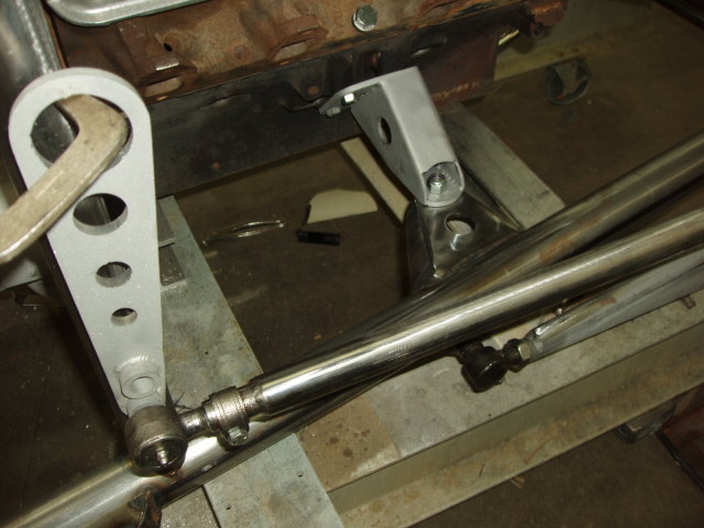

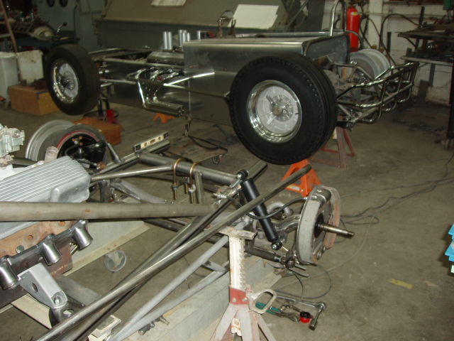

    Mopar tube front axle widened 4". Radius rods just like the originals. Solid adjustable rod ends. 35 Ford 1 ton spring mounts. The stock curve outward allows for a longer spring & lots of turning radius without the tire rubbing the radius rods. 2025-05-24 09.28.08-1.jpg 2025-05-24 09.28.08-3.jpg

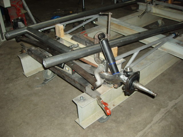

    I built the rear frame section first on the center of the frame jig. Then transfered it to the makeshift jig over the rear axle. Seat mount is done. Very sturdy. I used 7/8" OD X .156" wall 4130. I have lots of it in stock to build hair pin radius rods. 2025-06-08 08.35.18-1.jpg 2025-06-08 08.35.18-2.jpg 2025-06-08 08.35.18-3.jpg

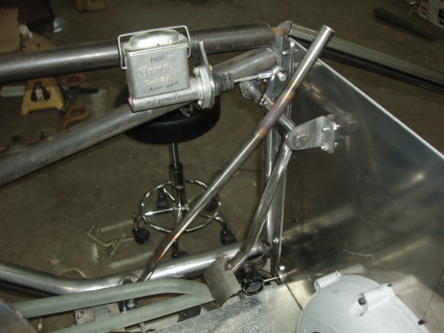

    Hydralic hand clutch. Left foot brake. 2004-01-01 00.00.35.jpg 2004-01-02 02.17.21.jpg 2025-06-28 10.32.12.jpg

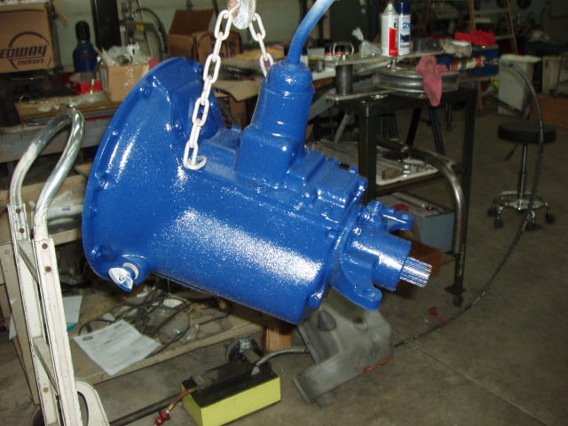

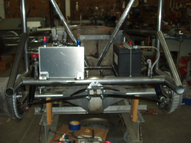

    Mounted the 5 gallon fuel cell, fuel filter and battery. Started to run brake lines. Painted trans. 2025-07-21 10.43.10-1.jpg 2025-07-25 09.53.16-2.jpg 2025-07-25 09.53.16-3.jpg

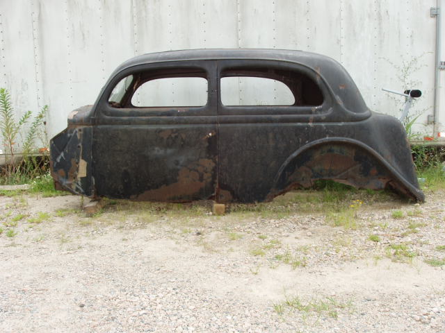

    The transition in 1958 from the hard tops to modifieds found a lot of guys not installing floors or firewalls. I think # 6 was one of them. My recreation will be present day legal. The left torque arm inside the frame made for a time consuming seat mount and sheet metal. Waiting for a reply from my carb specialist if it is 2025-08-15 14.58.39-1.jpg 2025-08-20 14.51.19-1.jpg 2025-08-20 14.51.19-3.jpg 2025-08-22 11.44.45.jpg I think it is OK to run the carbs backwards to clear the distributor.
