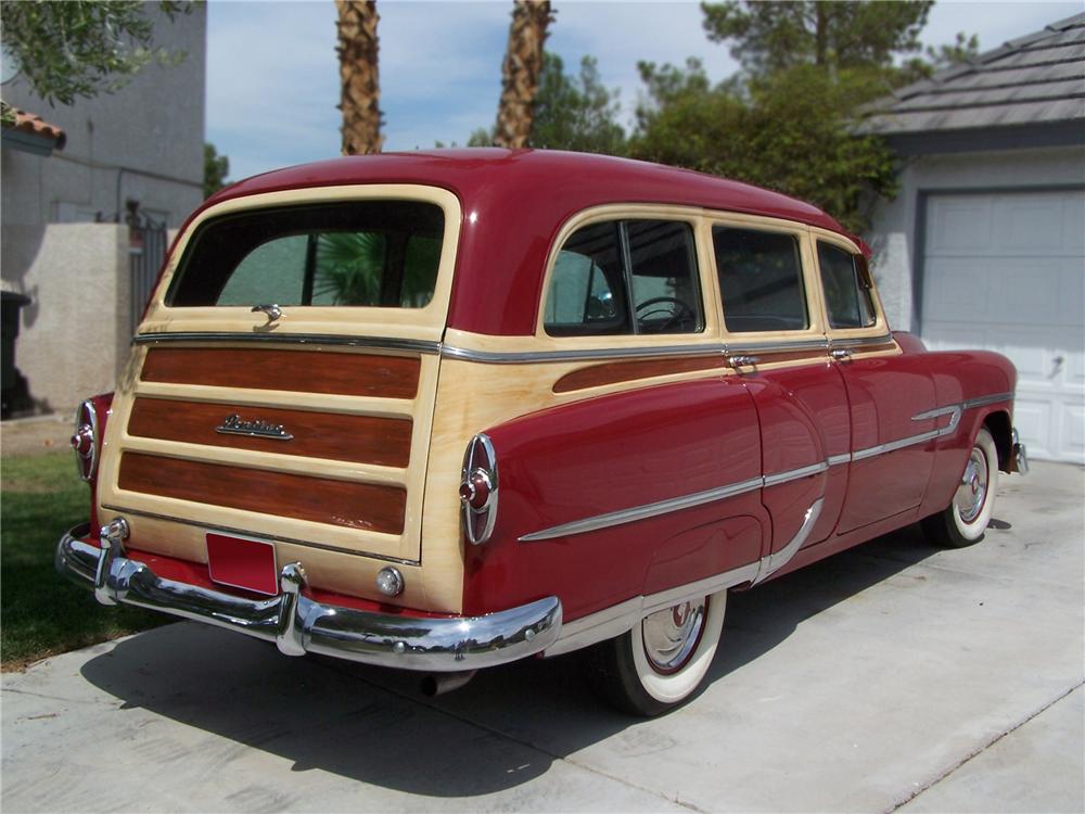

    If your just looking for a lens, make a mold and pour your own.. if your looking to modify something...here are a couple 1952 Packard, 1953 pontiac wagon
