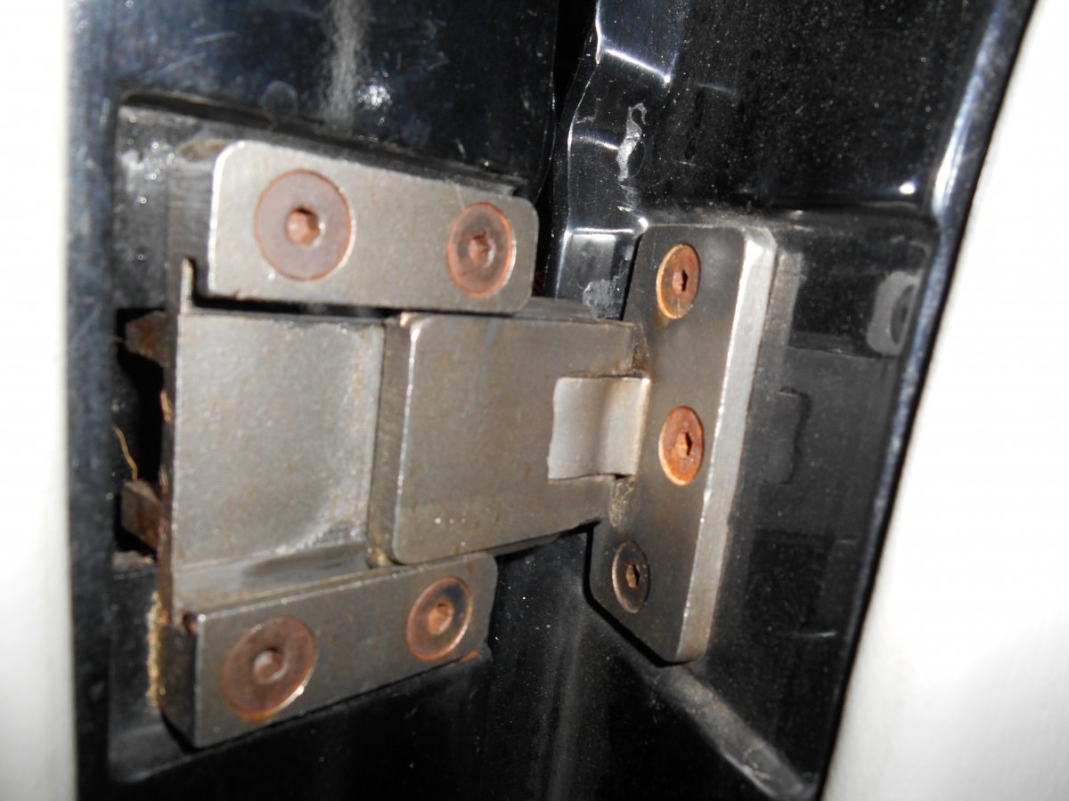

  1. I recently purchased a Fiberglass 33 Ford Coupe. The car was originally bought and built in 1997 - 98. The body is from Redneck. The hidden door hinges on the car are wore out. Does anyone know where I can find a new set of hinges for a reasonable price. I have contacted Redneck directly and they do have replacement hinges - but they are VERY expensive - $680 for a complete set of 4. I can not find who manufactures these for Redneck. Any help would be greatly appreciated. I have attached a photo of the hinges. Thanks guys. DSCN0829.JPG

  3. I could. I am not sure exactly how these hinges work? There seems to be a lot of play not in the pin area - but in the area where they slide? Anyone have info on exactly how these work?
  4. Do they slide when opening the door or is the slide just used to adjust the door? HRP
  5. I would take them off, see how they work and what's going on and figure it out from there. What do you have to loose?
  6. They slide when opening the door while at the same time pivoting on the pin - never seen a hinge like this before.

    looking at the picture, can't be sure, but those might be bronze - either cast or machined from stock. $$$. re-bushing might be your best option. If the slide portion is where the wear is, buying a new set might be the path of least resistance. do the hinges / hinge parts hold a magnet?
  8. That's the other thing - I can't tell what these things are made out of. Redneck tells me that the new replacement ones are made of stainless steel - I do not believe that mine are stainless - they look almost like they are cast. They hold a magnet - but not strong like steel - very slight.
