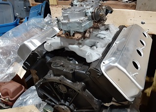

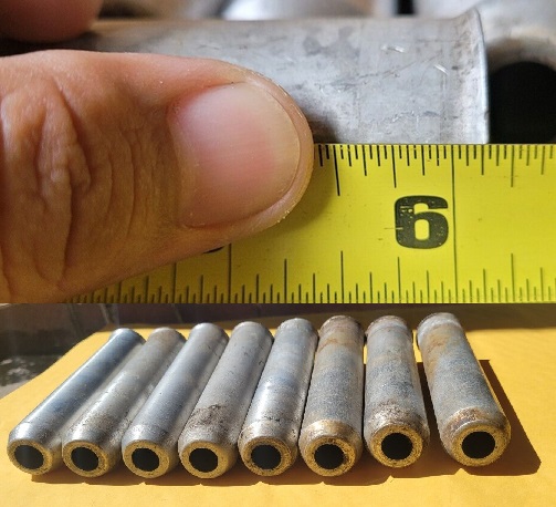

    Doing some looking around I find these on ebay. A couple look sketchy at the plug ends but looks like they could be trimmed .150-.180" at top and carefully flared to work. ***uming 5 15/16" is correct for the valve covers.
    Summit offers these for 426 but the square shoulders at the tops would make them hard to shorten unless they are long enough to trim off the shoulders and flare to fit.

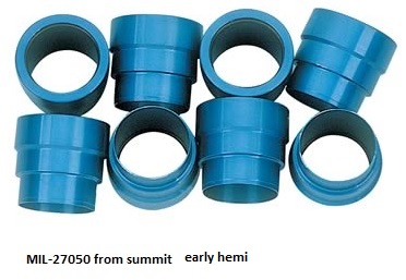

    Summit also offers these seal kits but don't say whether machining the head for fit is required like the ones from Hot Heads.
    Hot Heads offers these for Chrysler but the image doesn't make it clear whether they are flared at the top or "square shouldered". Maybe just have to ask them.
    Anywho, just looking for what others have done to make tubes work with Red Ram covers. Of course when it arrives in a couple days and I can measure, maybe I find that with these being obviously after market covers they were made to use more commonly available tubes. My mind races trying to solve issues I know are going to come up. Took three yrs to complete the Big Boss Ford during covid even constantly trying to think ahead. I really don't want the Red Ram project to stretch out that long. Thanks for any and all input.
