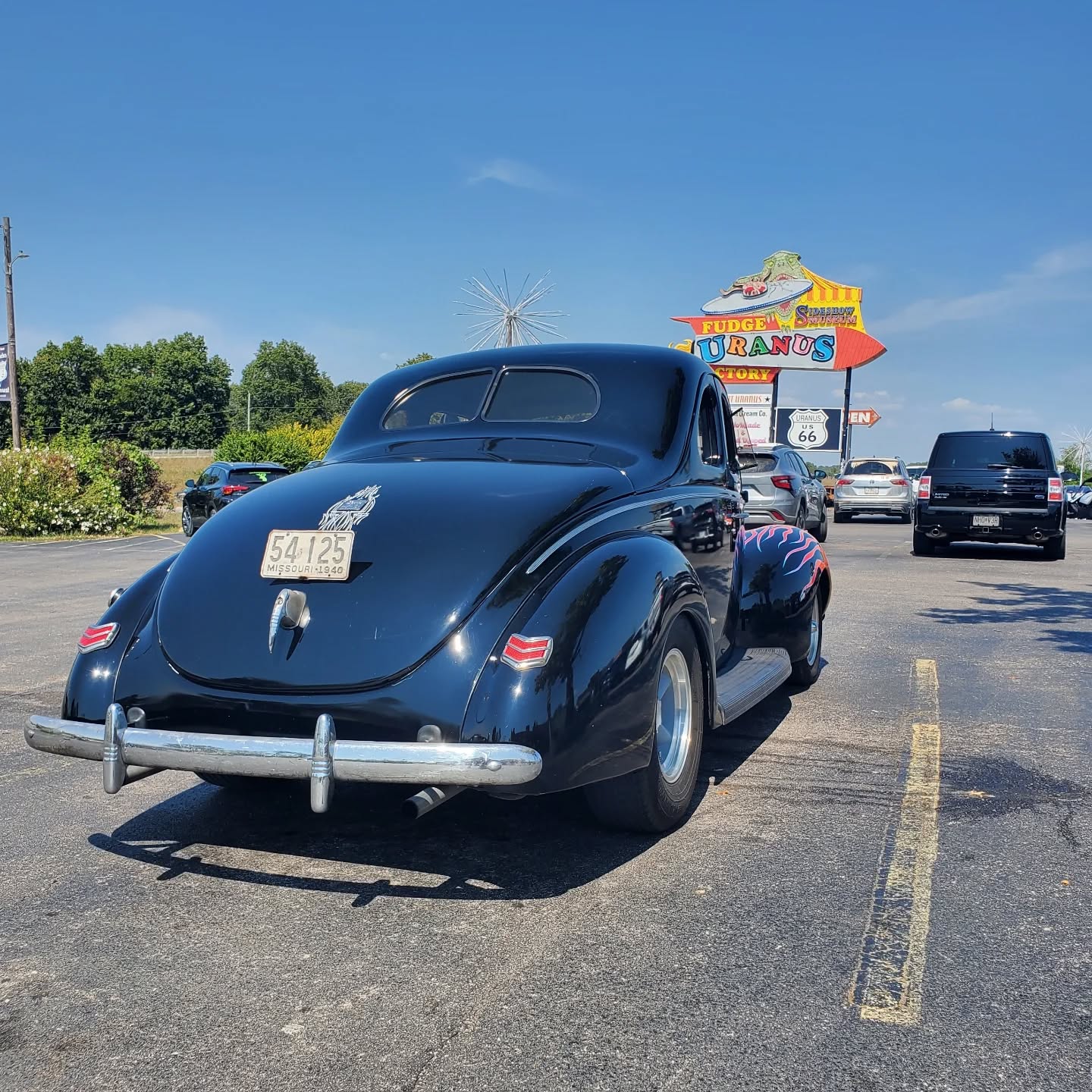

    And now for some fun stuff.
    It's not a trip up Hwy 44 unless you make a stop at Ur**** and take at least one photo to send to your boss.

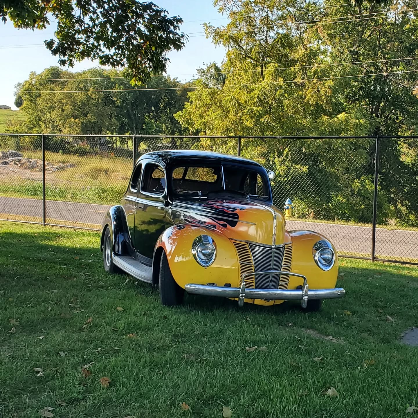

    I parked under the big shade tree next to the pavilion in the Washington, MO fairgrounds to allow the birds something to aim for.
