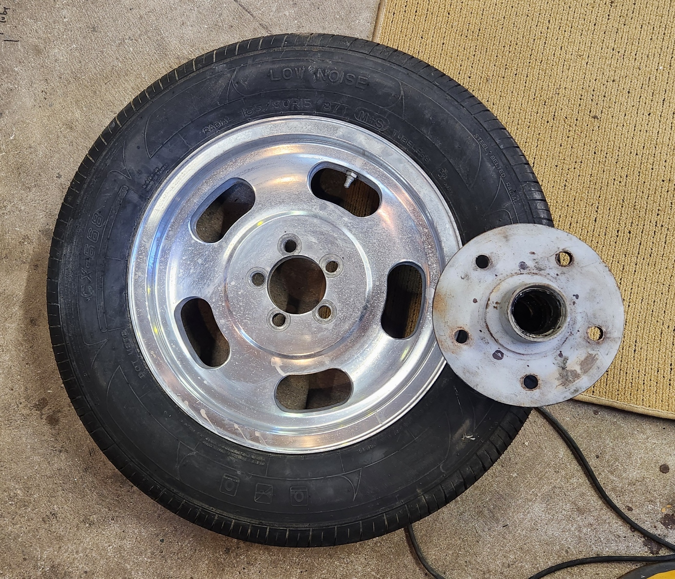

  2. RICH B
    Joined: Feb 7, 2007
    Posts: 5,984
    RICH B
    How about the inner side of the hub?
    Hnstray and '52 F-3 like this.
  3. '52 F-3
    Joined: Sep 30, 2007
    Posts: 961
    '52 F-3
    from Central PA
    It looks like it's going to be close.
  4. FrozenMerc
    Joined: Sep 4, 2009
    Posts: 3,420
    FrozenMerc
    Getting the bolt pattern centered is the tricky part. Do you have a mill?
    '52 F-3 likes this.

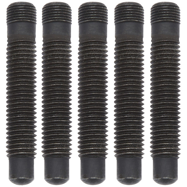

    anyway, I figure I have 3 options,
    1. Buy aftermarket hubs with correct bolt pattern.
    2. Re-drill hubs bolt pattern and decrease size of hub for wheel center. 3.125 to 3.00"
    3. Re-drill wheels bolt pattern and fill in existing holes.
    There is an area on back of wheels that will accept 5 on 5 1/2" holes, but will be very close to existing holes.

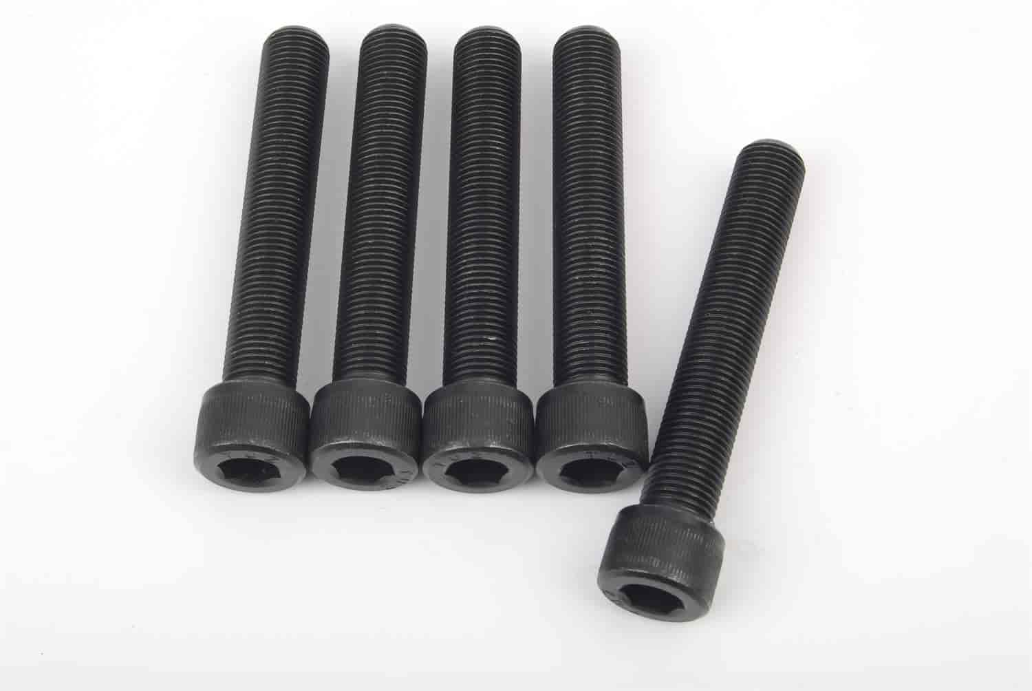

    I'm leaning towards re-drilling hubs and using screw-in 1/2 x 20 studs. (either double ended or Allen head) BUT, hubs don't have alot of material between bearing races either.

    Double studs , I would use a High grade studs instead of whats shown , ARP etc.
