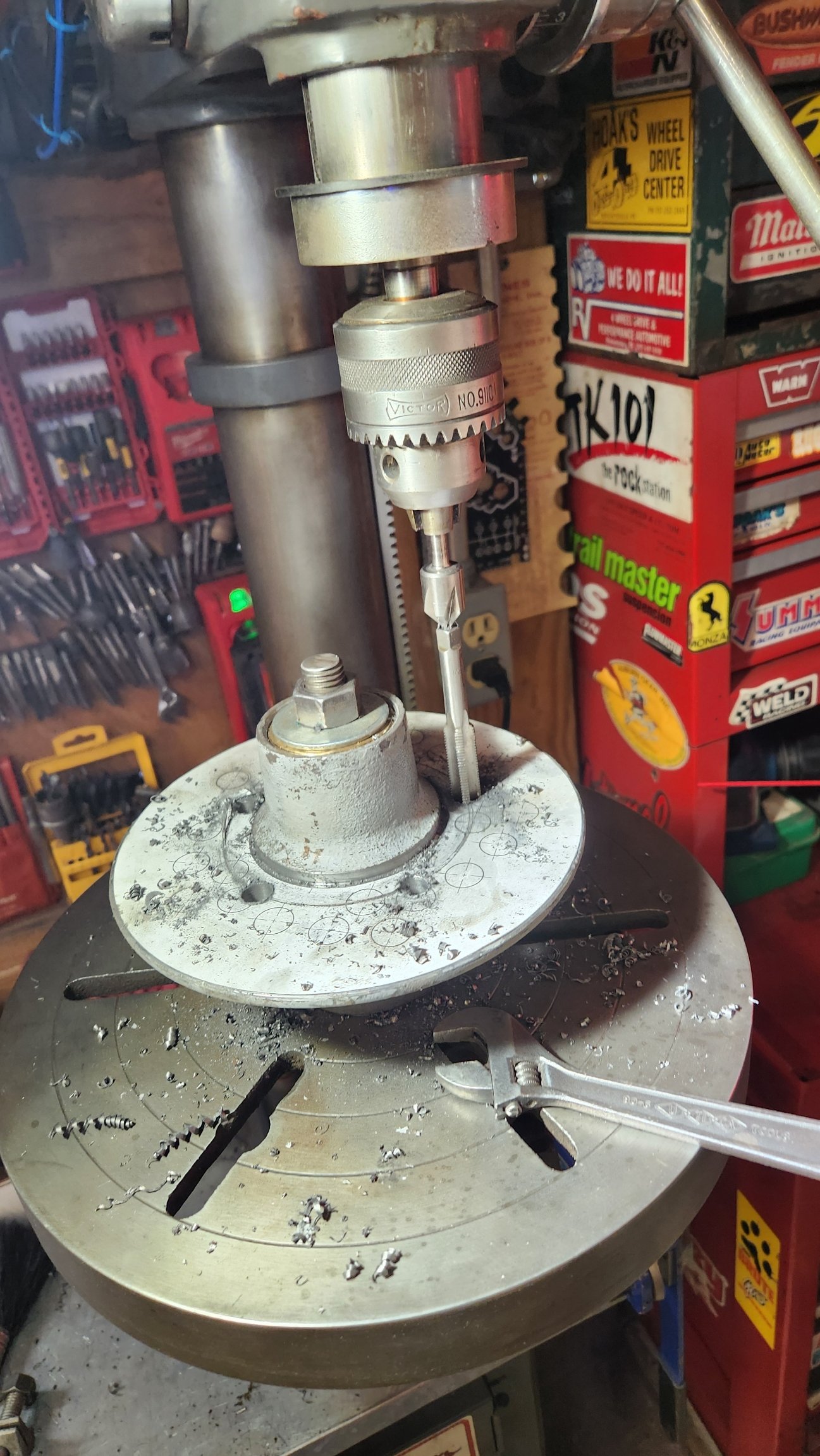

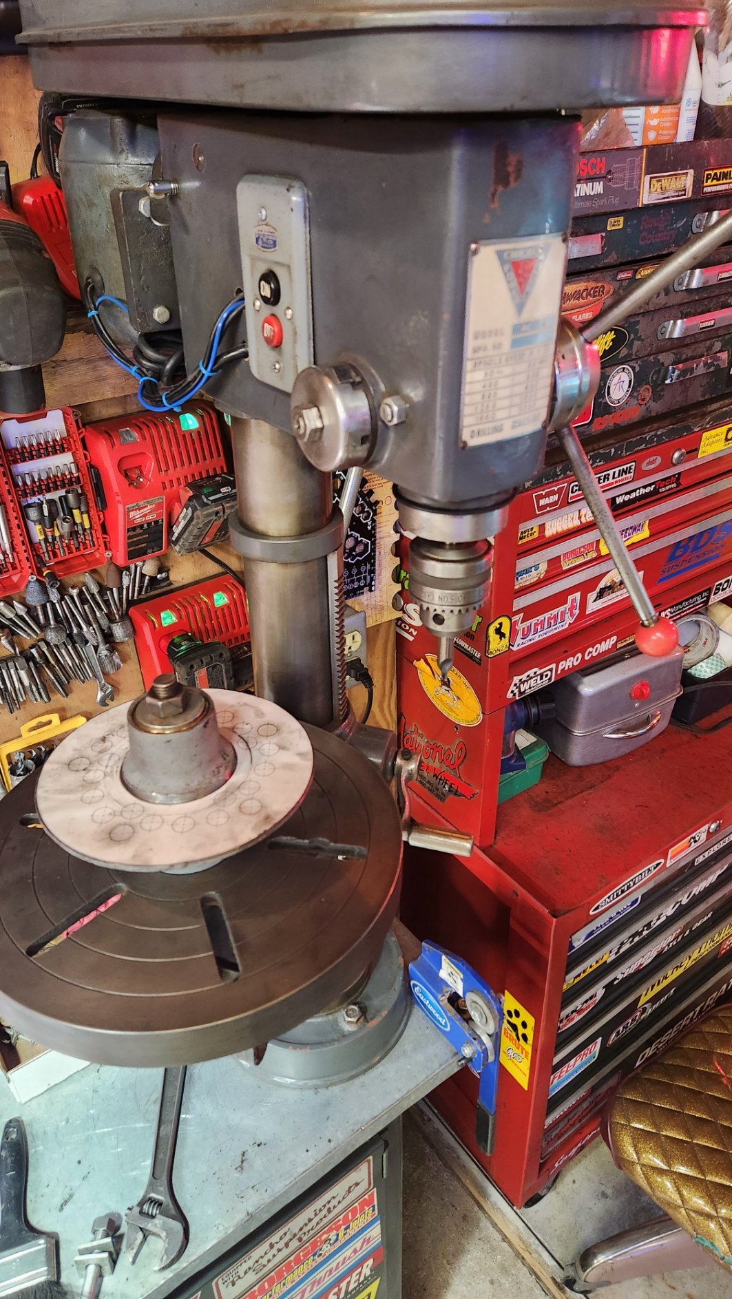

  9. Budget36
    Joined: Nov 29, 2014
    Posts: 15,303
    Budget36
    Mill or
    Drill press?
    '52 F-3 likes this.
  10. Budget36
    Posts: 15,303
    Budget36
    @‘52 F-3
    Would you take a pic of your rotary table for your drill press please?
    Thanks
    Hmmn, that page didn’t work!
    @‘52 f-3
    Or that one!!
    '52 F-3 likes this.

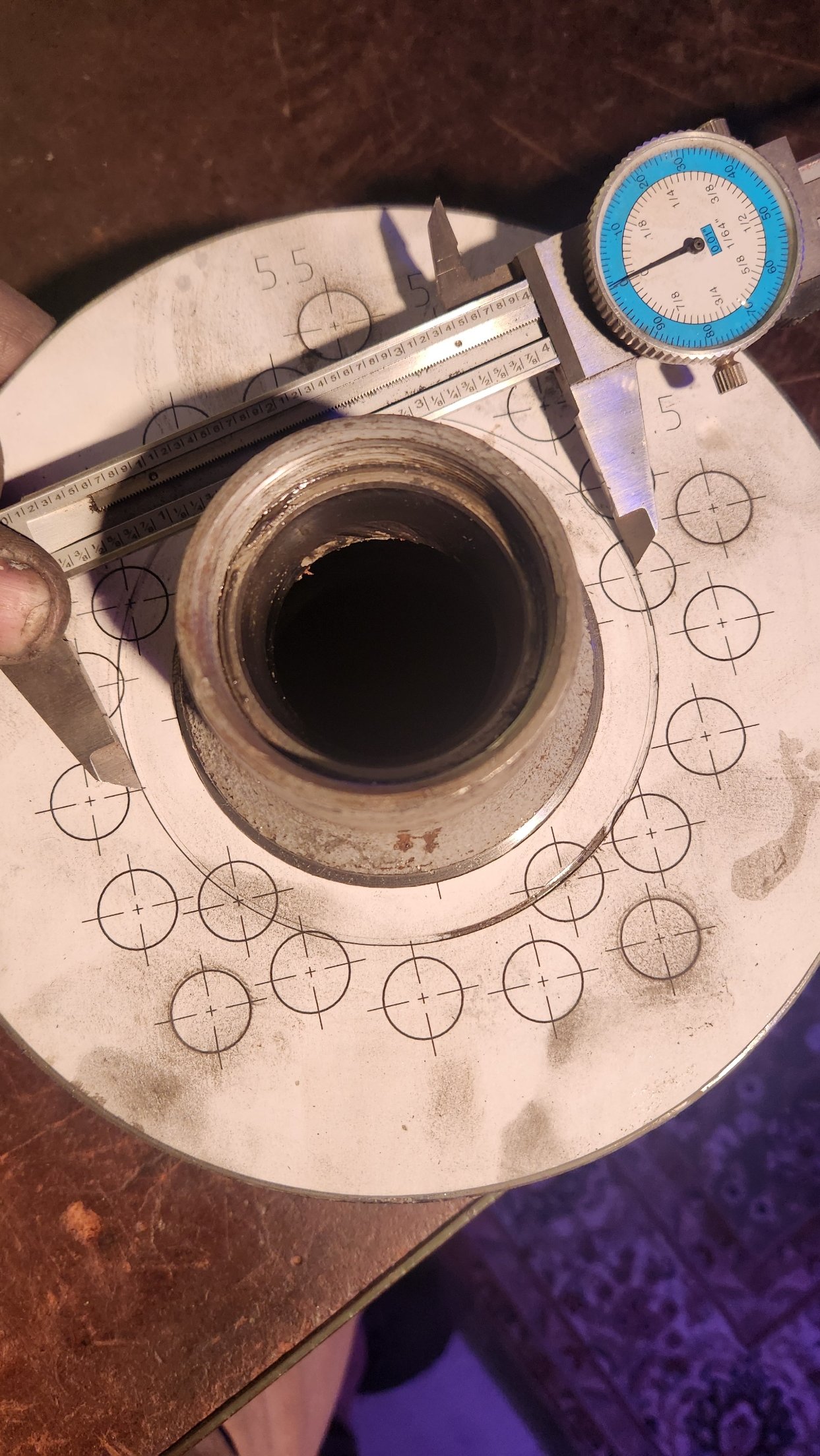

    I would just buy a wheel adapter that fits both patterns, pop the studs out, bolt it to the hub and use an appropriately sized drill bit as a center punch to transfer the holes.
    This is hand drill type work, not something you need a mill for.
    Algoma56 and '52 F-3 like this.

    Like was said, it's not rocket science, I redrilled my hubs and rotors from 4.5 to 4.75 using a plastic wheel bolt pattern and a drill press.
    Car was over 120 mph several times, wheelies all the time, street/highway driven without issues.
    Use the pattern, account for the built in slop to fit over the lugs, find center, quadruple check your measurement and drill. I do think it's a good move to redrill the hub versus drilling the wheels, especially with the way they are cast.
    I've did several drums the same way
    lumpy 63 and Budget36 like this.
  15. Budget36
    Posts: 15,303
    Budget36
    Oh snap! I didn’t see the relation of the press table as a rotary table until you brought it up.
    I asked for a pic of a drill press rotary table because I was just recently looking at options and was curious what others were using.
    '52 F-3 likes this.

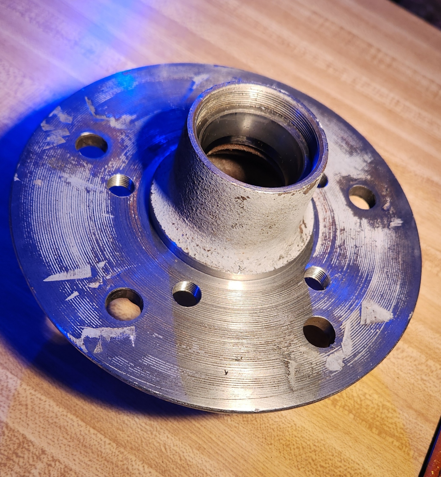

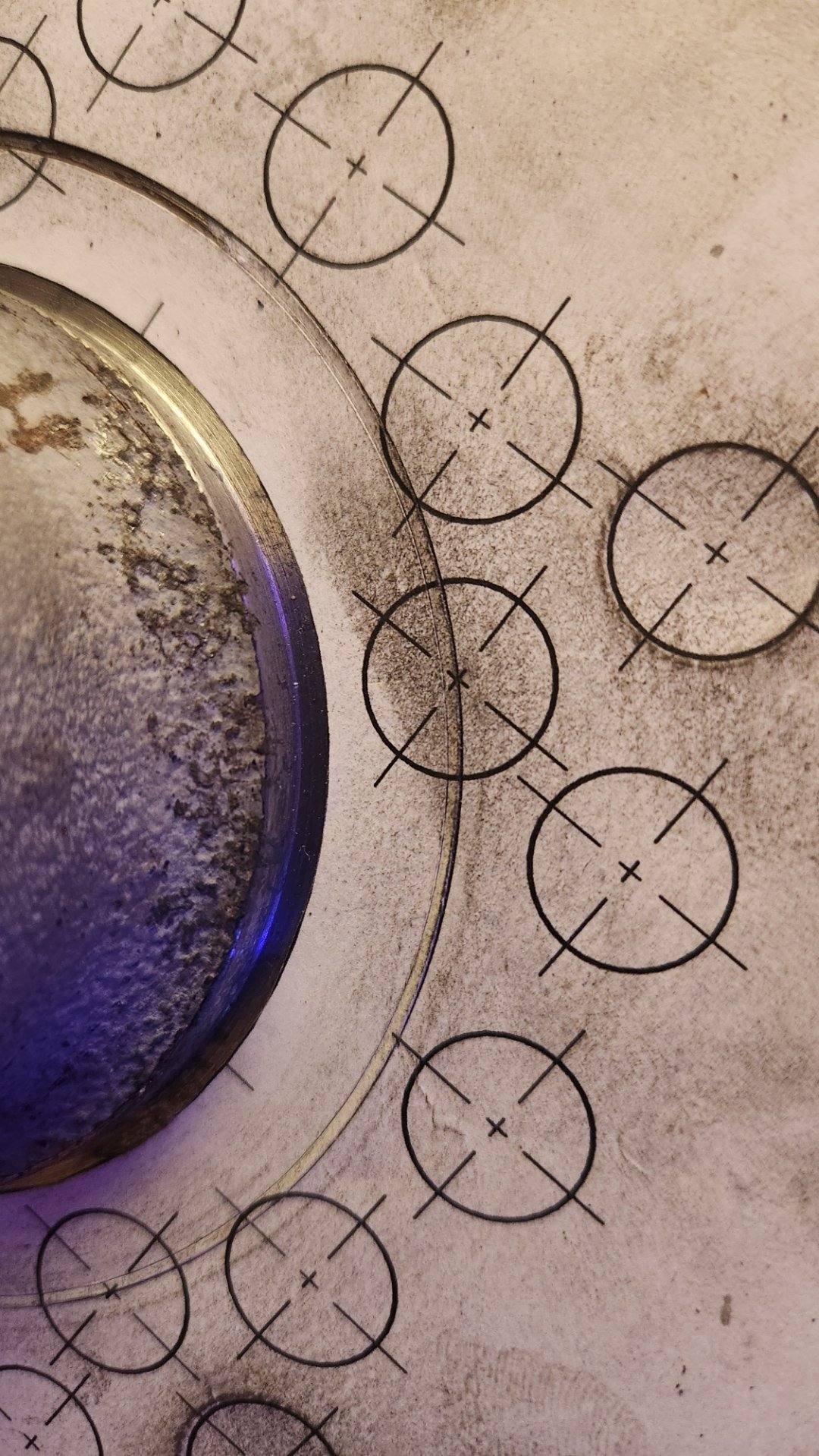

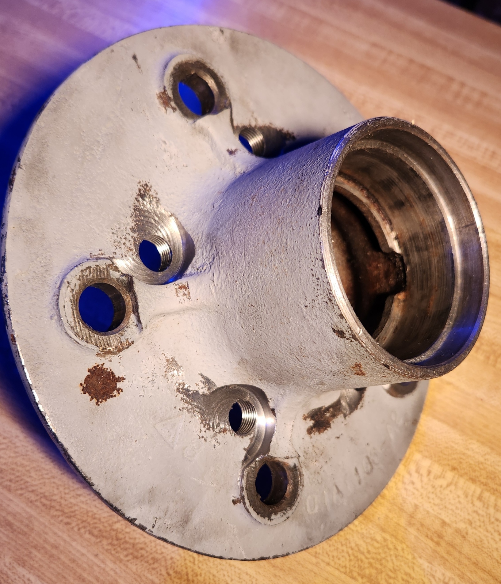

  16. '52 F-3
    Joined: Sep 30, 2007
    Posts: 961
    '52 F-3
    from Central PA
    Waiting on Studs to be delivered. Decided to drill holes next to the web on backside of hub, inner wall thickness seems to be thickest here. I guess I have a "Turn Table", not a Rotary. My mistake.
    20250203_174801.jpg 20250203_180719.jpg 20250203_185635.jpg 20250203_185714.jpg
    swade41, seb fontana, twenty8 and 4 others like this.
  17. About to do similar on a pair of 9 inch axles

  19. Sharpone

    Nice job, I believe drilling the hubs is better than drilling the wheels. It will look much cleaner.
    Dan
    '52 F-3, Algoma56 and Budget36 like this.
  20. Johnny Gee

    This is messing with my OCD. :eek: IMG_3802.jpeg

  21. '52 F-3
    Posts: 961
    '52 F-3
    from Central PA
    I consider a little OCD a good thing.... If these 84 year old hubs could talk, looks like someone hammered in some studs at some point. It spun true on my lathe, hoping 2nd one goes as smooth.
    vtx1800, swade41, seb fontana and 2 others like this.
  22. arse_sidewards
    Joined: Oct 12, 2021
    Posts: 344
    arse_sidewards
    from Central MA
    This way he has room for 5 on 5 if he wants to run that in the future or if the next guy does another 80yr from now.
    I would have used normal wheel studs with the shoulders ground on one side if needed to clear the barrel of the hub though.
    Regardless, what he did will be fine.
    seb fontana and klleetrucking like this.
  23. Johnny Gee

    Yes it’ll work just fine. But this looks so much better. :D IMG_3803.jpeg
