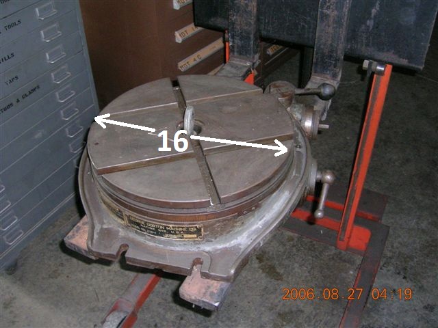

    I borrowed a friends table of that size once [it was enough:confused:] went and bought the eight incher:D

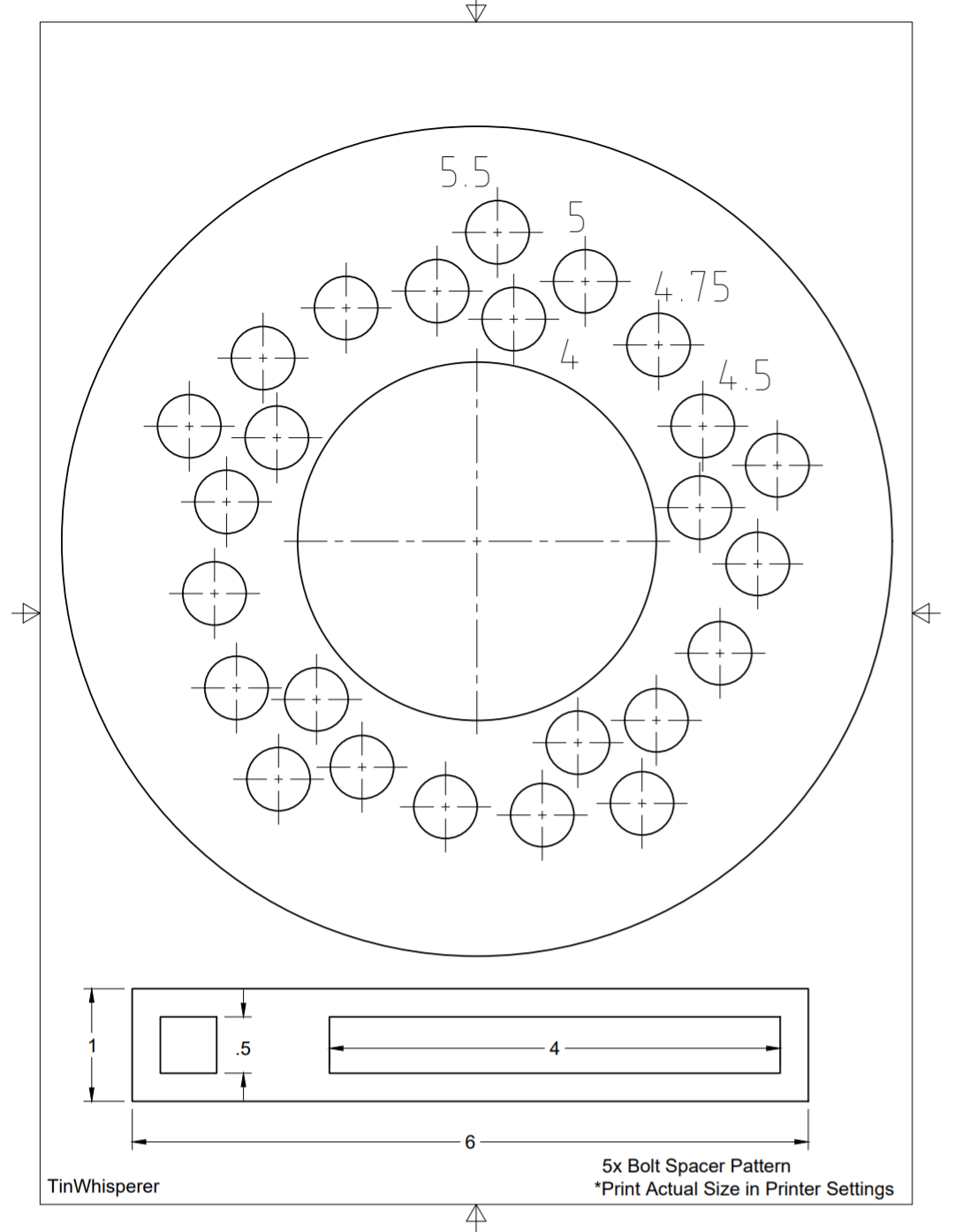

    Ensuring hub is chucked up true in the lathe, which took more time than turning it down to be "Hub Centric", is very important. That and double-checking center punch holes are evenly spaced on a 4" circle.

    How did you locate center of the hub to make a 4 inch BP?
    I’ve an idea, but would like to know what you did to think on it as well.

  10. '52 F-3

  11. Budget36
    Joined: Nov 29, 2014
    Posts: 15,341
    Budget36
    Know I see it! :)
