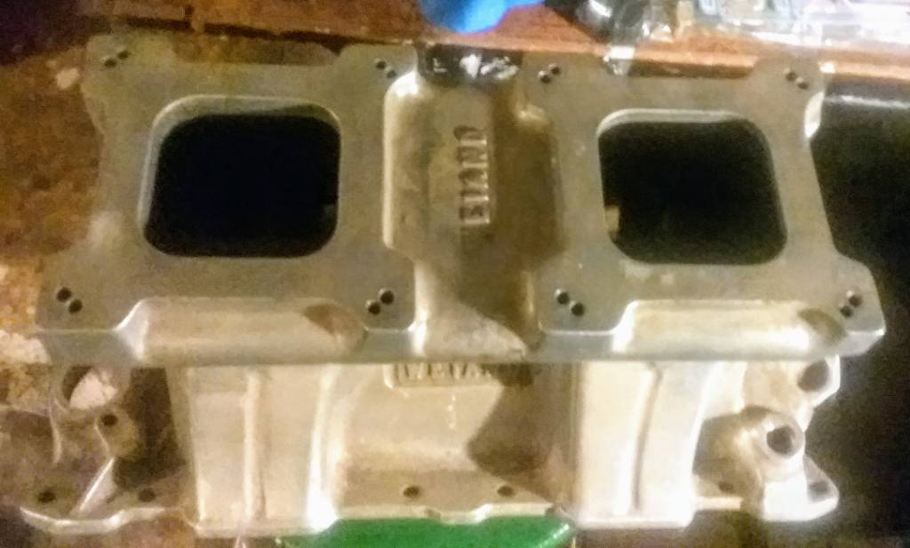

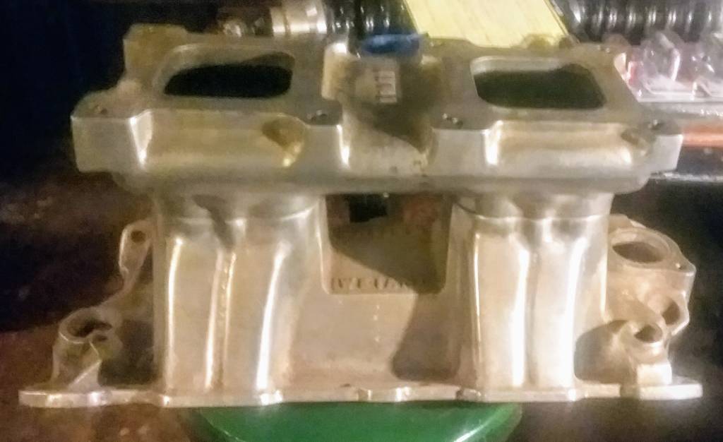

    I have a old Weiand tunnel ram that used to run and it is drilled so that the carbs will mount either way...but it depends on the carbs.
    When I first ran this manifold it had 2 Holley 600 single feed auto chock carbs inline on it ...fit fine and worked great.
    This time around , new car ..new engine , I'm planing on a pair of duel feed double pumpers ...they will not fit inline so they will have to be mounted sideways...no problem..mines aready drilled.
