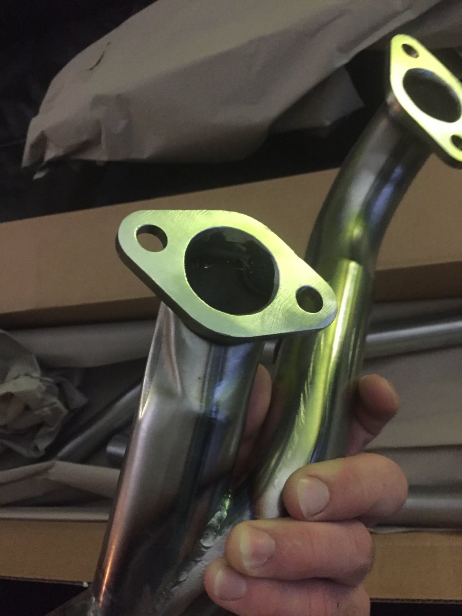

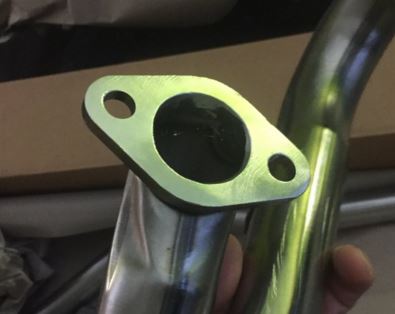

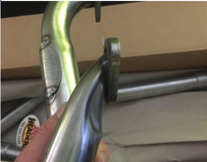

    Also, ironically when I ordered these pipes, the guy told me that he was having difficulty finding someone to make the downpipes and tailpipes. It really sounds like this guy just gives everyone the same excuse when they find low quality and that isn't cool. I mean seriously, how can you have trouble with your welders and fab guys for over 10 years?? Maybe the problem isn't the fab guys at all??

    I have always felt that header tubes that are not welded around the outside of the flange/tube joint look unfinished and less professional. I do tig weld the tube to the flange on the inside, but also have then tig welded the outside with silicon-bronze rod. This not only provides a finished look, but also adds additional support to what can frequently be a potentially weak spot(s) in the interior weld, especially after port matching. The lower temp of the silicon-bronze flows out to a wider bead than a conventional steel tig bead, and looks quite similar to a gas welded bead. Win/Win I have no comment on the Red's headers.

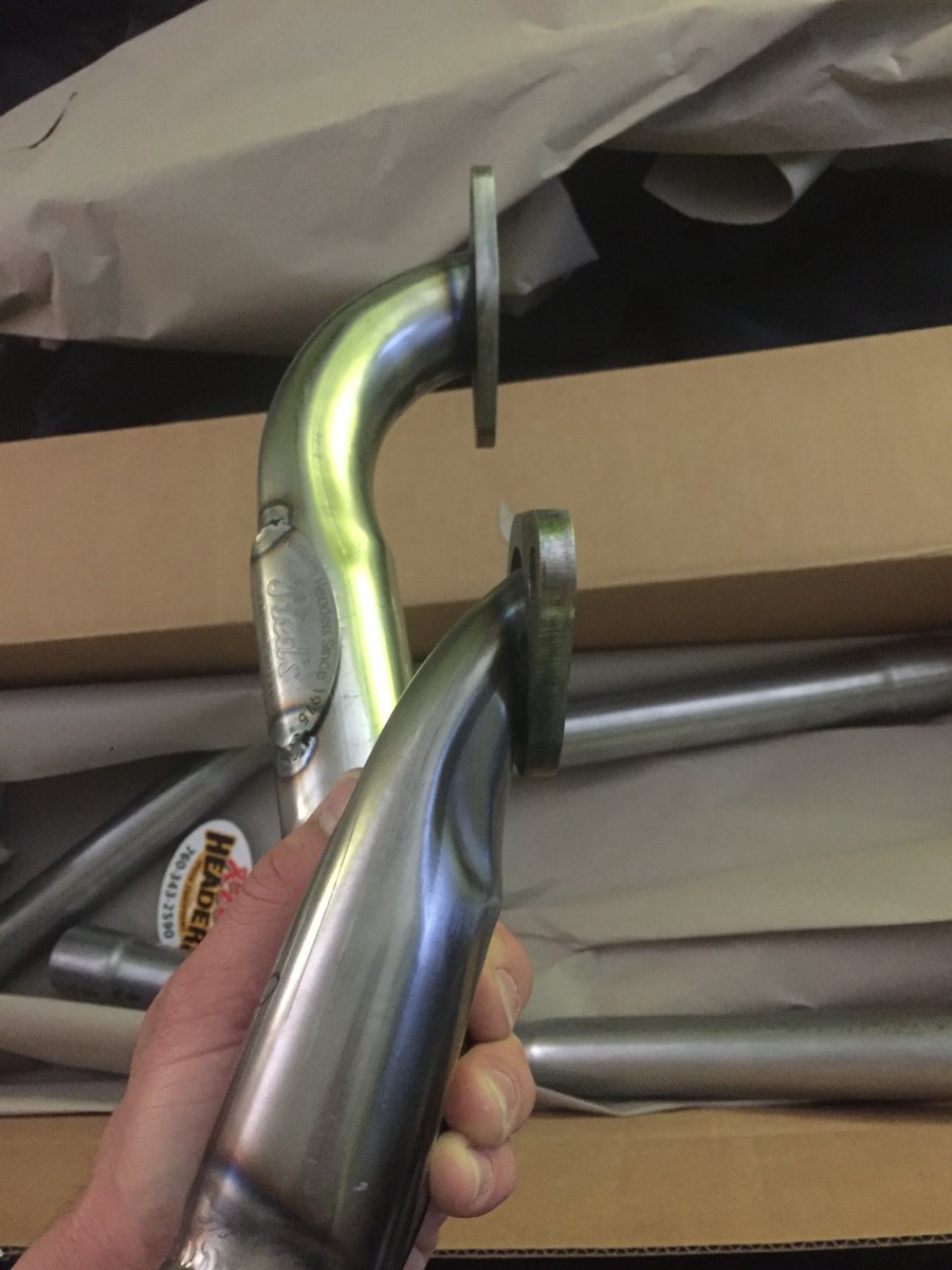

    They don't look like the quality that I would want to put out. The crush on the one leg is just pathetic , IMHO . A shame.

    Red's is a good old company that seems to have served the old Ford community well for years. I've seen lots of Red's headers on cars at shows and they looked just fine, not sure why yours look so different. It may well be that a small specialty company like Red's can't afford to pay what it takes to keep a talented weldor on staff.
    Like Hot Rod Don, I worked in the header industry for many years and we had fixtures to make that ugly "0 radius" bend when absolutely necessary. While I was there they were engineered out of the ***emblies to eliminate a "hand made" step and reduce costs (I really just thought they were ugly and unnecessary but you have to justify a redesign of a successful product in a way that the bean counters understand)
    Applying a bead around the outside with silicon bronze rod became very popular and I agree that it makes the header look more finished, especially if they are to be coated. I'm not sure that it really adds much to the strength of the ***embly but in my own shop I did it to a lot of my customers headers as an extra cost option.

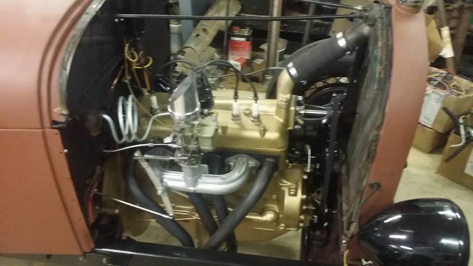

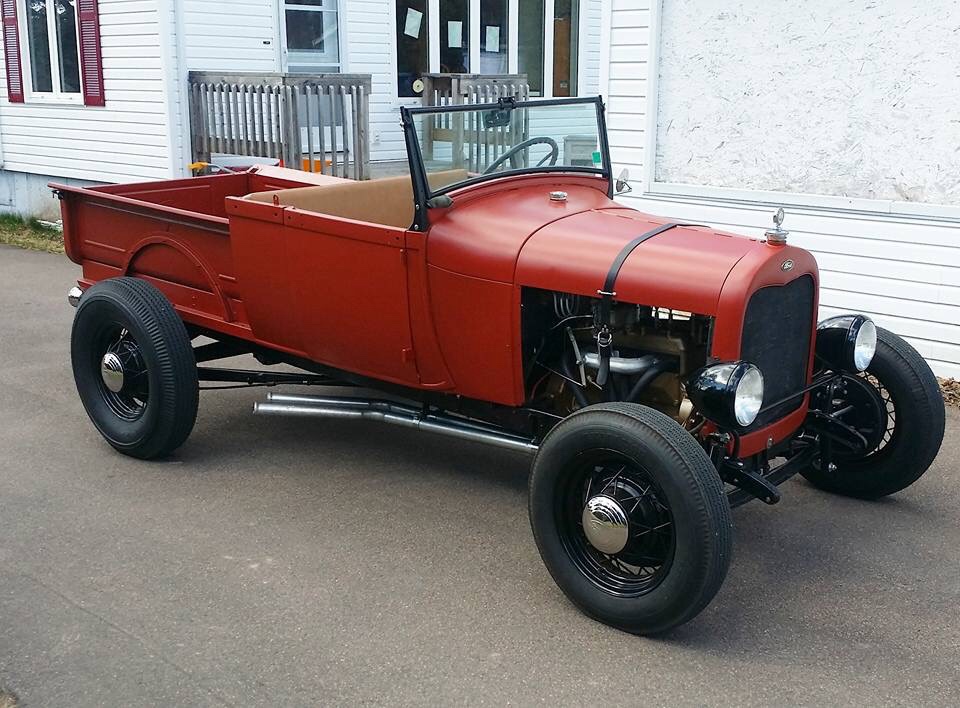

    I'm running the dual reds headers

    I really like the tail pipe treatment. What did you do to the ends Tedders?
    Tedders likes this.

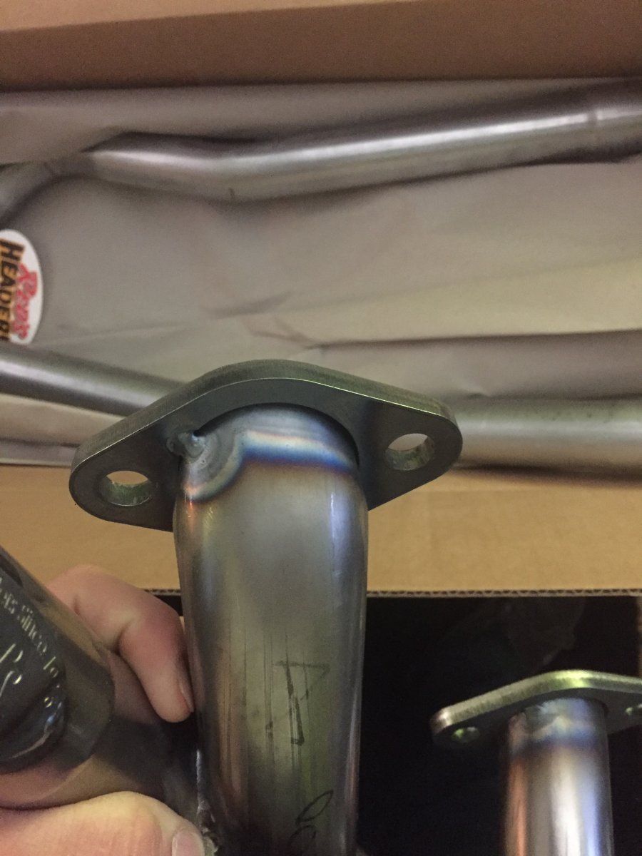

  19. Well I am certainly no header expert but I have been around some headers in my time and there are a couple of things that come to mind.
    One is that rumpled pipe would cause me a certain amount of consternation. The other is the tack welds on the p outside of the flange, I have certainly tacked some in my time, but it is not normal for pro made headers. The tube should p*** through the flange and be welded around the mating surface of the flange at least any quality set of off the rack headers you buy are done that way. No weld on the outside at all.

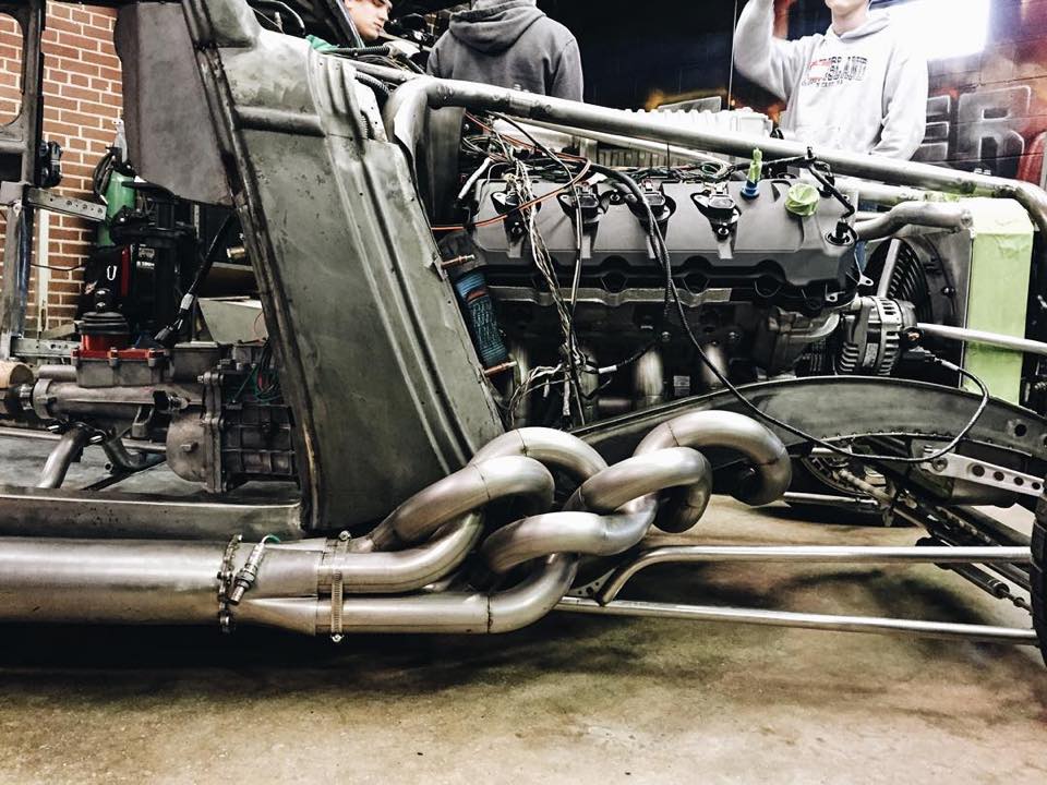

    You think you've got problems!;)
  21. Now that's a bunch of snakes. :D

    They are probably put on the fixture to hold everything in alignment and tack welded on the outside then removed from fixture and finish welded on the inside..Hard to just weld on inside if you use a flathead block for the fixture...o_O
  23. Probably so but not very professional is it.
    These days I try to use square port flanges or oval port flanges when I can, if I am using a head or block for a fixture I fit my tubes then remove the flange from the head or block and weld it up from the other side. If I were going to tack the outside and sell it I would do one of two things. I would either finish the weld it I would grind the tack out. That obviously could change if it were my car I don't have to put a decent looking product out on my own car.
    All that said I have heard good comments on reds headers before, those may have just been Monday headers.
  24. Tedders
    Joined: Oct 18, 2012
    Posts: 419
    Tedders
    Thank you appreciate it
  25. Tedders
    Posts: 419
    Tedders
    Just expanded the ends

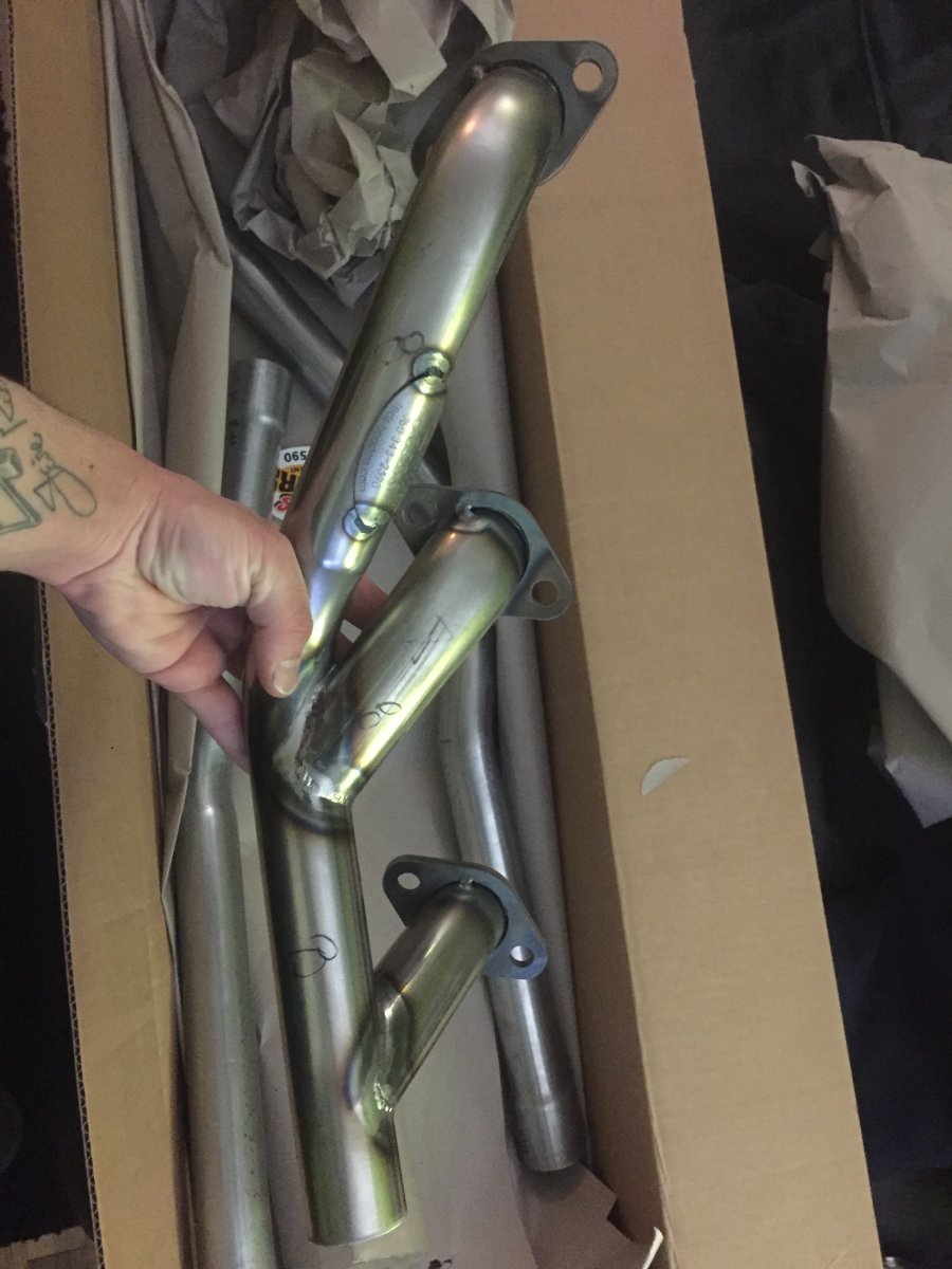

    So, I spoke to the guy who owns Red's now, and like many other companies, he bought it lock stock and barrel. He didn't design anything. He just farms out the fab work to whatever shops he can find. I was able to head up and stretch the middle pinched pipe to a more acceptable opening, BUT, I'll say this.
    REDS DOWNPIPES DONT FIT. I tried absolutely everything and they either hit clutch and brake linkage, the floor, or some combination of both. Also, the downpipes are bent to run both sides UNDER the crossmember. This means significantly decreased ground clearance, which ****s on lowered cars. I am going to bring my car to an exhaust shop and have new 2" (not 1 3/4 stretched to 2" at the joints) downpipes and tailpipes made. I'm just happy the **** downpipes that I only used to break in the motor only cost $50, otherwise I'd be returning them.
