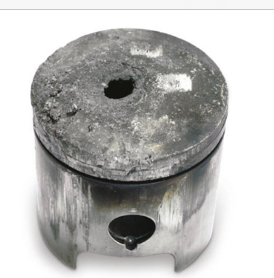

  5. Lust lean it out a bunch. The compression will eventually drop on its own.

    Wrong AF ratio, hole is off center;)

    This is what I to not want to happen.
