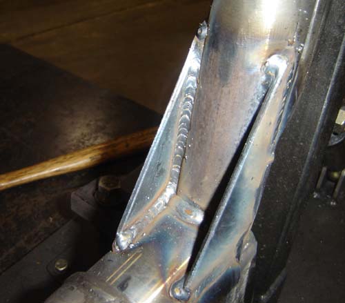

    I've been doing alot of Mig welding lately, lots of tight inside corners. I'm getting alot of spatter on my parts. They all get powdercoated, so the spatter needs to go away. I can knock it off with a chisel, but that takes time that I'd rather not spend. I use anti spatter spray, but by the time I'm finished welding, the piece is so hot, the spray's pretty well burned off. Is there a general machine setting that will spatter less? Any tips are appreciated. Here's an example pic of the type of welds I need to do. The gap between the gussets is about 1 1/2", so I don't have alot of room to work with, and I need 3/4" of wire extension in the corner:(

    Good looking welds, but why are you welding all the way around the gussets?
    I have welded the same type gussets on aircraft frames and the most that is required is one side and 3/8-1/2" around the ends. Anything more is overkill and doesn't add any strength to the gusset.:) :D

    Maybe the wire speed is a little fast? I've noticed that if I get spatter like that I can slightly bring the wire speed down and get rid of it.

    He is using Gas and Solid wire. Flux Core would have spatter on my front porch (I live in Oklahoma), it spatters so much.
    Good looking welds.
    I agree with the turn the wire speed down. Itll help a little, but your welds look good.

    I just looked at the photo full-size. That's NOT a lot of spatter.

    Thanks for the tips, and the compliements on my welds. Tig is out of the question, budget doesnt allow it. I know that much weld isn't really necessary for a strong gusset, but it looks prettier:) I'll try playing with the wire speed some more. Can't slow it down to much though because it starts popping, then the weld plain ****s. Also, I do use the Anchor brand anti spatter spray. It works well in most areas, but 4 of the welds on the piece are multip*** V welds, and the whole area is glowing red by the time the weld's finished, and the spray's long since burned off

    Kevin Lee, kirk and some others here are right about the wire speed and gas choice. For what it's worth, that aint **** for spatter that you've shown here. Also to solve the burn off problem try giving it a break instead of continuous welding. That red glow might mean too hot, then a brittle piece when done. Just some ideas to consider. I weld all the time on my job and those you've shown are ****in near as good as it gets.

    Seriously, what splatter?
    I see some flecks here and there, but thats just inherent with welding. It like changing oil in your car, and when you check it its dirty. Do you change the oil again? NO
    I don't see a problem, if you want splatter free metal, you have to clean the metal after the weld.
    Also if you are spraying your metal, and you are evaporating the spray surrounding the area before you get ot it. SPEED UP. As well as don't try to weld the entire seem at one time if you are trying to accomplish less splatter by applying a spray. Me personally, I would rather run a nice bead with no start/stops and then worry about buffing off some splatter. I figure you are probably the same way.

    All good info others have posted. One other thing that can cause spatter is too long a stick out. 3/4" is a bit on the long side, and that will cause spatter, especially when starting a weld. The wire will sit and "pop" a bit before the bead starts, giving you spatter to clean up. Just a thought. But the welds look fine, don't look like excessive spatter at all though
