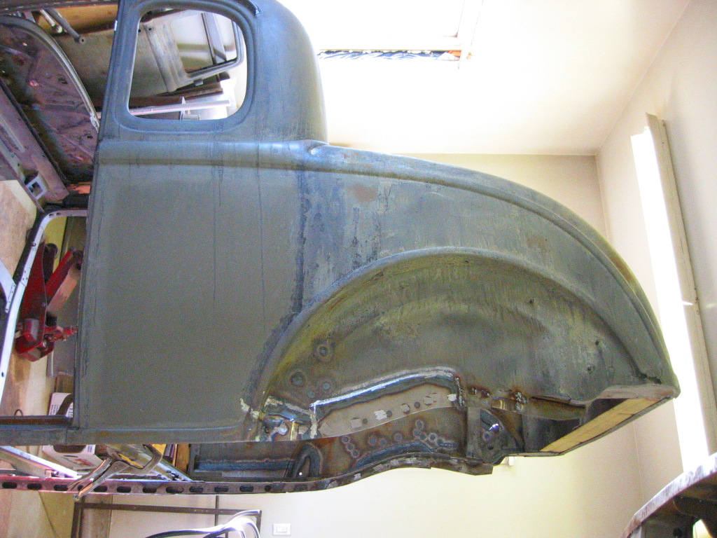

    I'd be glad to help with any images you need. I'm only new here but if I can help I'd like to.
    I just bought an unchopped 32 5 window and have uploaded many shots into my album.
    http://www.jalopyjournal.com/forum/album.php?albumid=10927
    Have a look and if you need extreme close ups of anything just let me know and I'll crop tightly at full resolution.
    I haven't actually taken posession of the car yet but when I do I'll be only too happy to go and take a shot of anything you need. It's not pristine but I'd call it "pretty solid". I should have it in my garage within 7 days. It's a tough wait.

    Yes thank you. They all are helping very much and I am starting to get an idea of what should be there but is not.
    32Ford5 and alfin32 those pics are great!!!!!

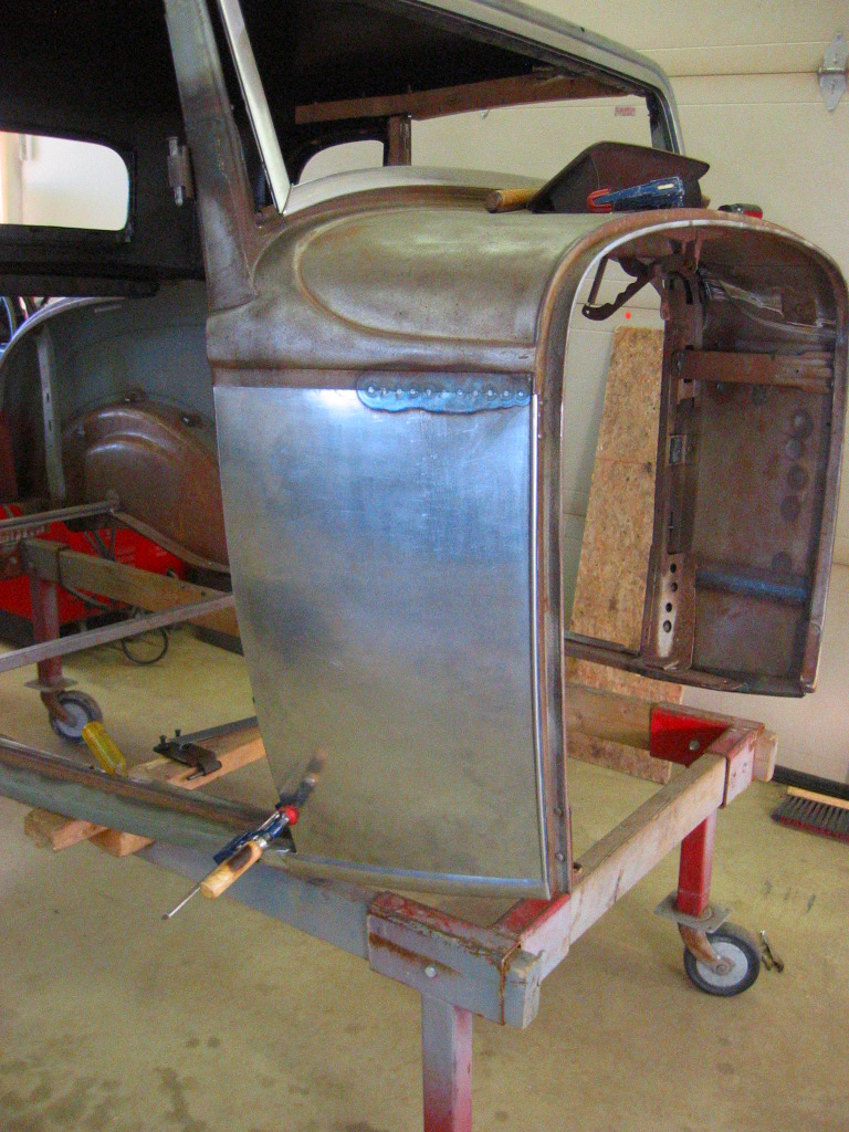

  24. These are some panels I have made for 5 windows
    kidcampbell71 likes this.
  25. JeffreyJames
    Joined: Jun 13, 2007
    Posts: 16,626
    JeffreyJames
    from SUGAR CITY
    Those look great "MMS"!!! That full length cowl section is looking like an option. Any idea on a price on those?
