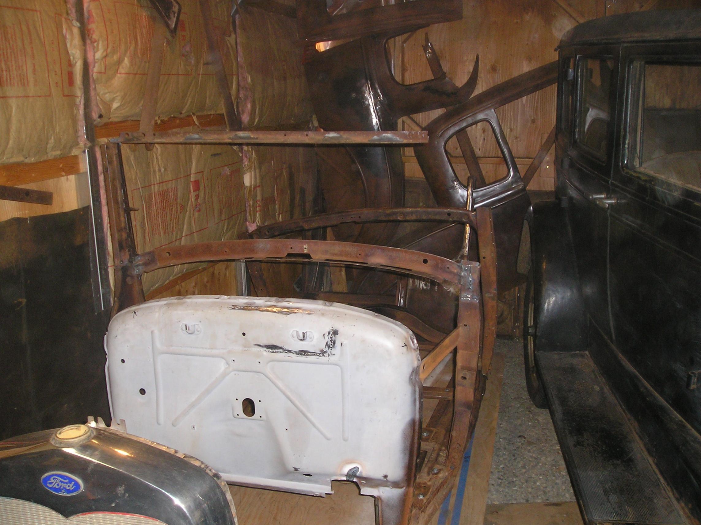

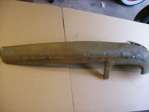

    Finally found a top for my driver's side rear quarter. Huge POS but I can can piece it back together. I must be sick in the head to get excited over a crumpled up wad of tin like this.

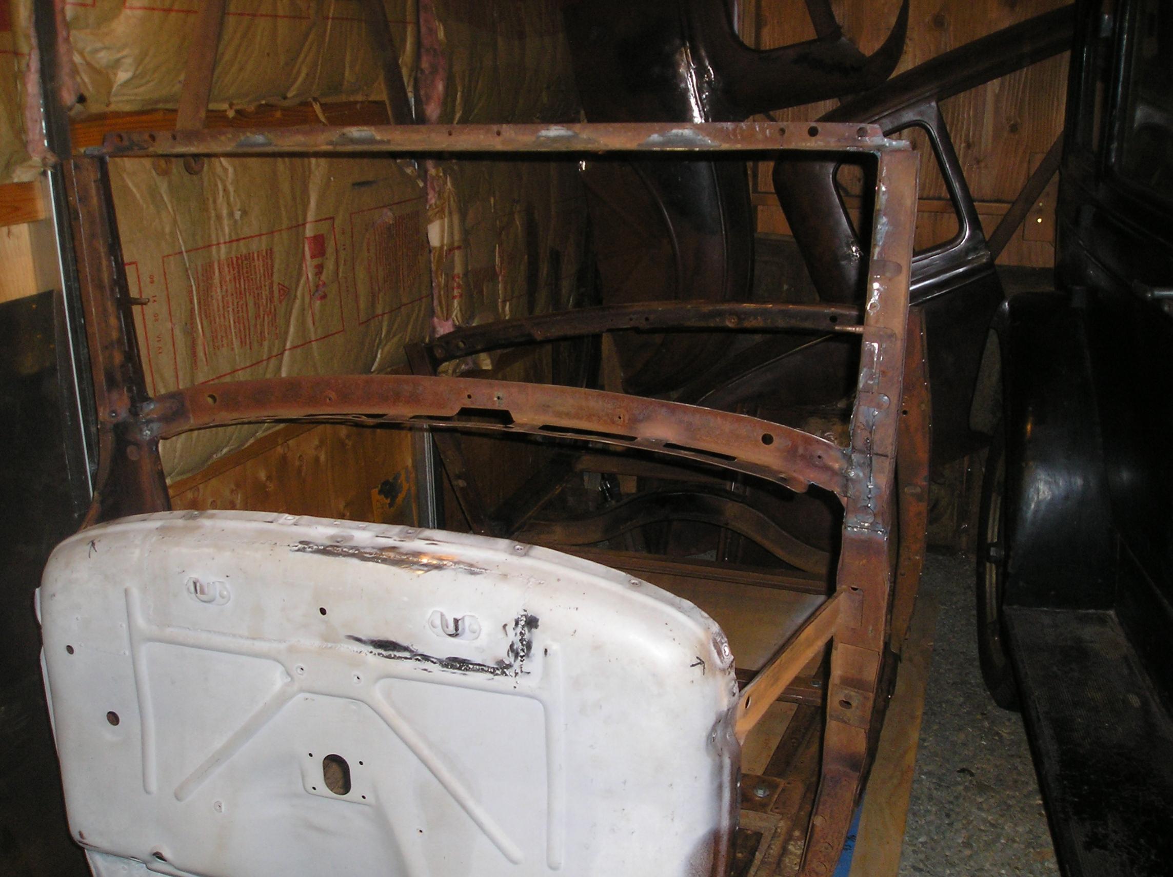

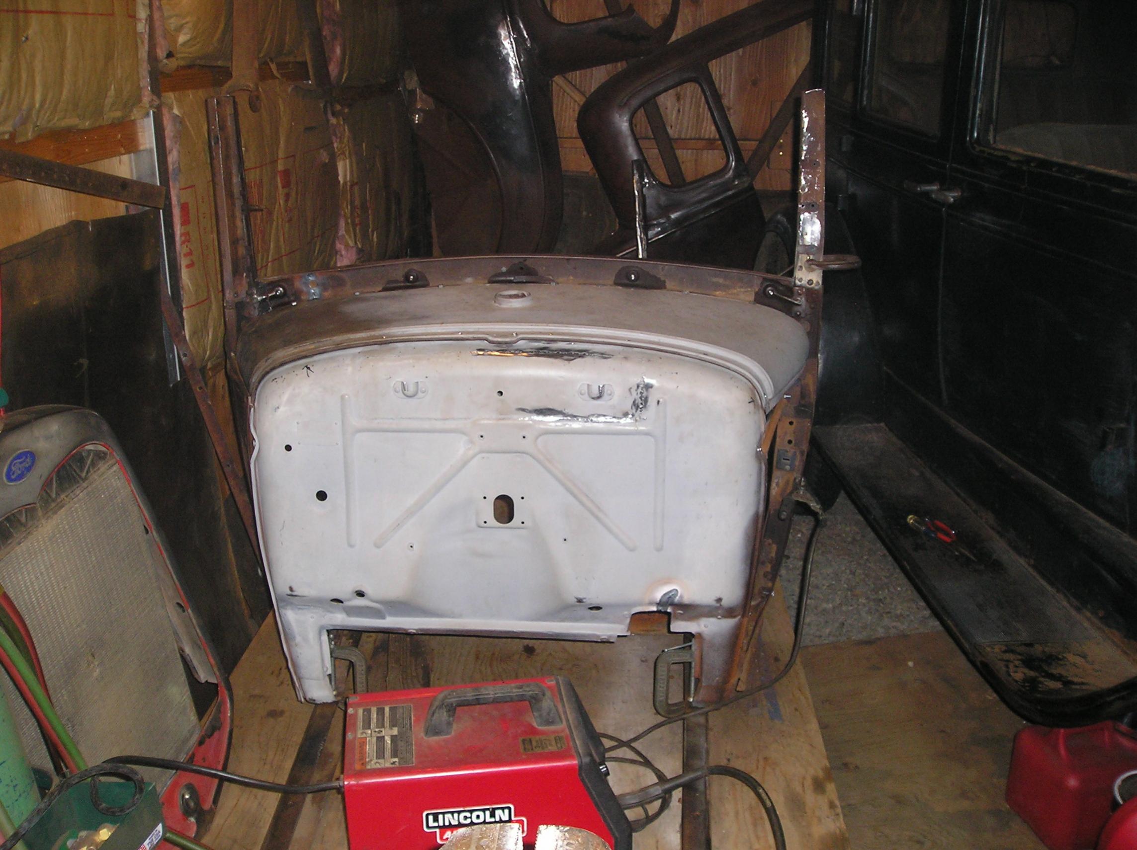

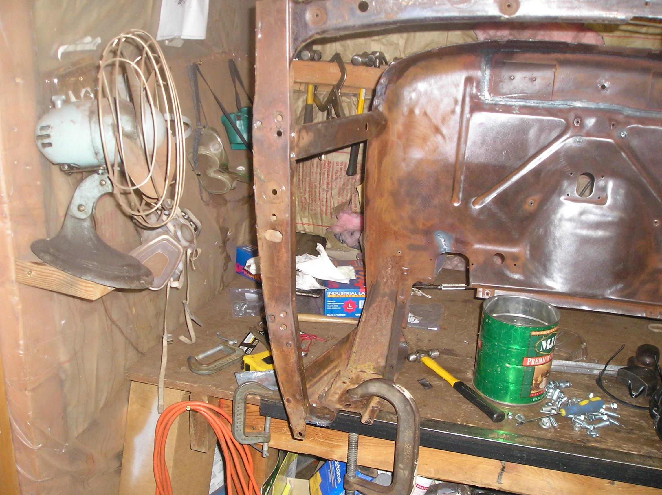

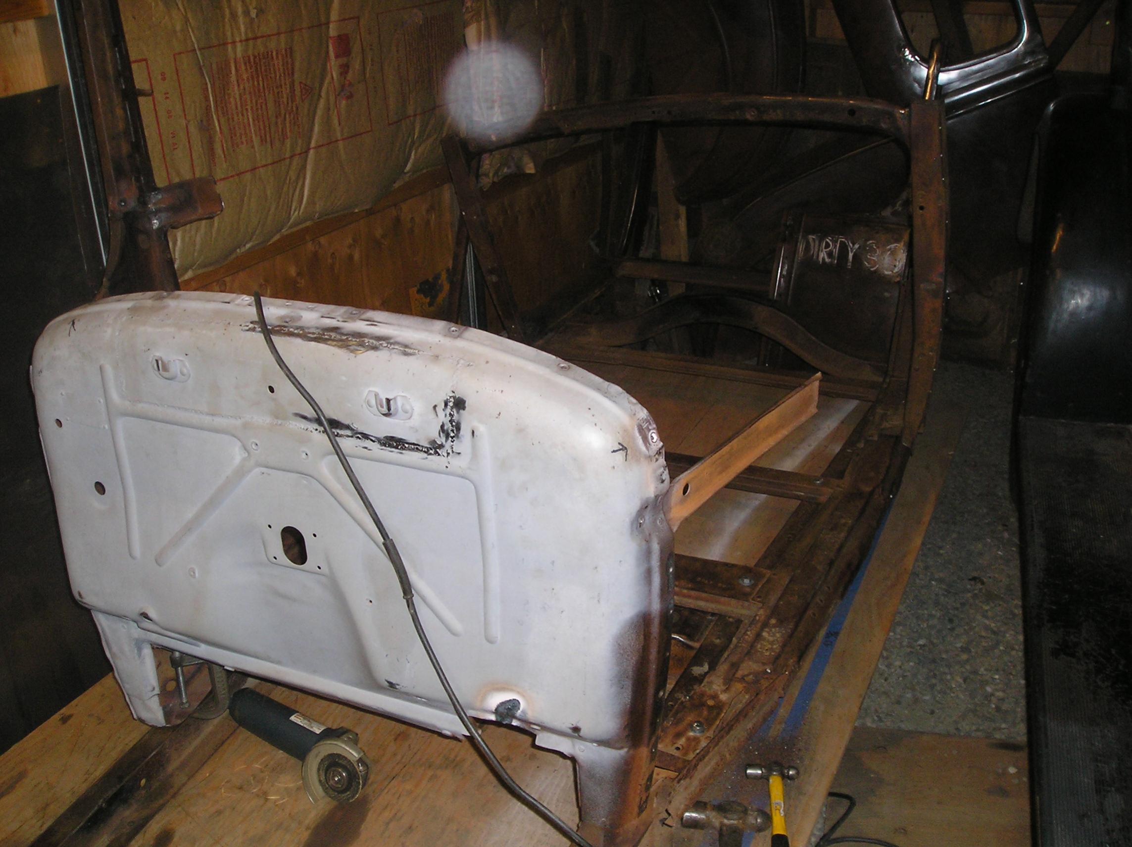

    1. Northwest HAMBers

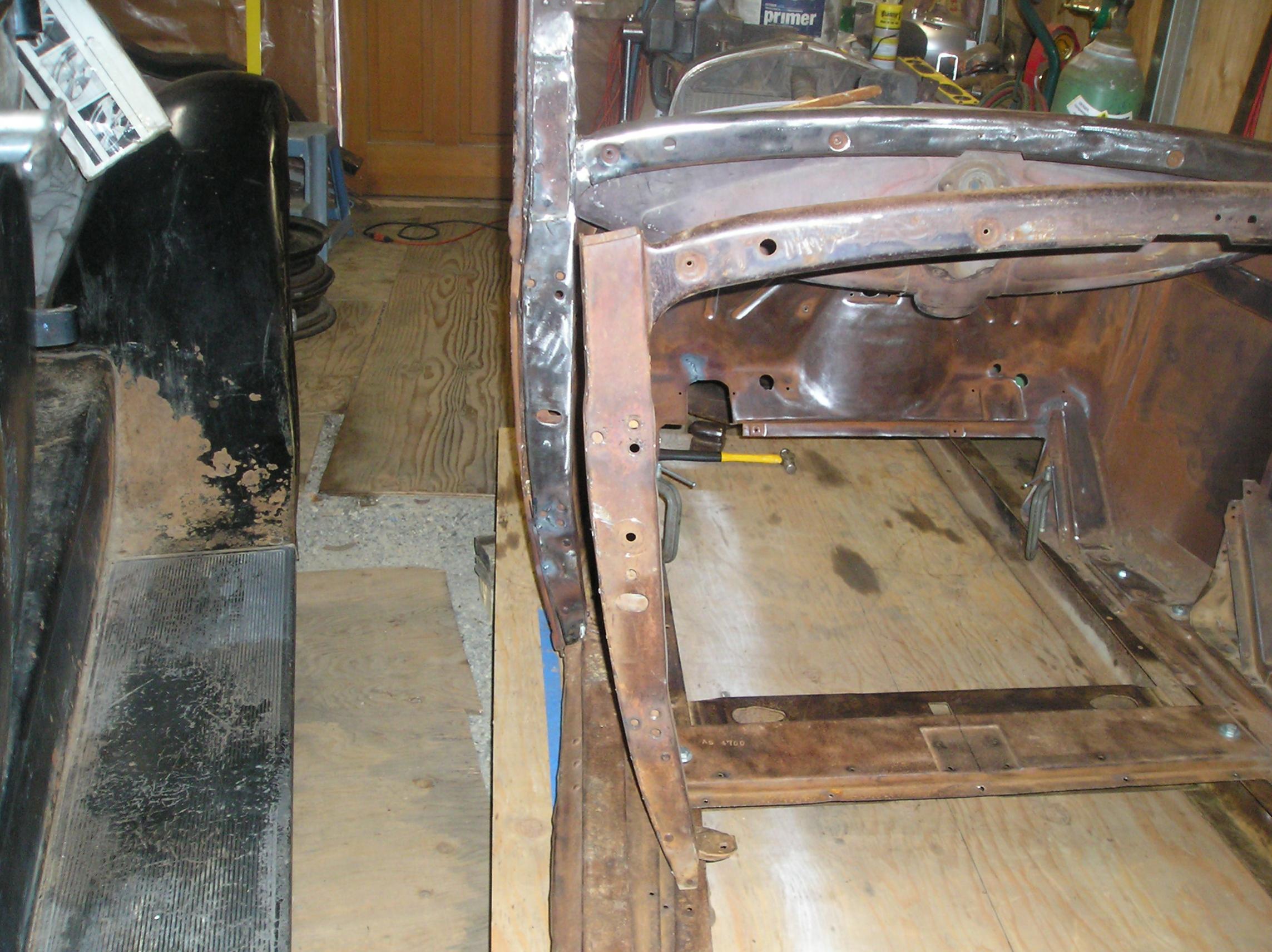

    The driver's side A pillar was wanged pretty good at some point. I've been trying to get the cowl squared up on the frame so I can start assembling the body. Damn thing was bashed in at the bottom, twisted, and pushed out and forward at the top.
    I got a little pissed at it last night and cut the thing out all together. I'd nearly cut through the top of the pillar trying to get it strait anyway, so I went ahead and just replaced the lower portion and the majority of the cross beam with what I had left of my other cowl section.
    I still need to bolt up the front of the tank and get it down to match with the front quarters, tack up the rail, and replace the top of the pillar. Its a bit of a mess, but it feels good to be rid of the bashed up portion.

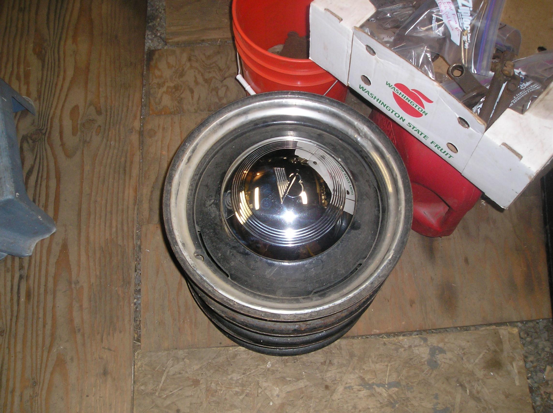

    Also picked up three 40 ford steelies and repop standard caps yesterday from another Hamber (great guy). So I'm looking for a fourth 4 x 16 if anyone has one laying around. Great start to the weekend.

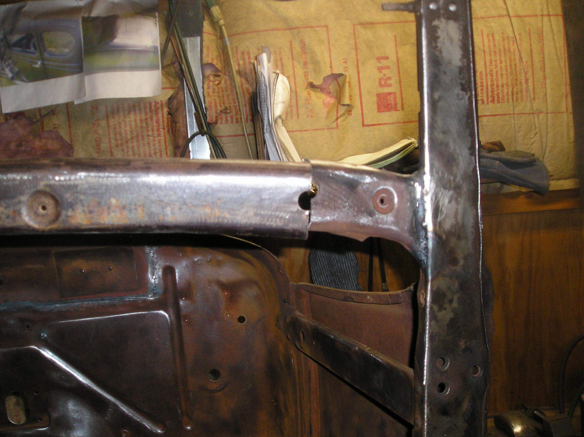

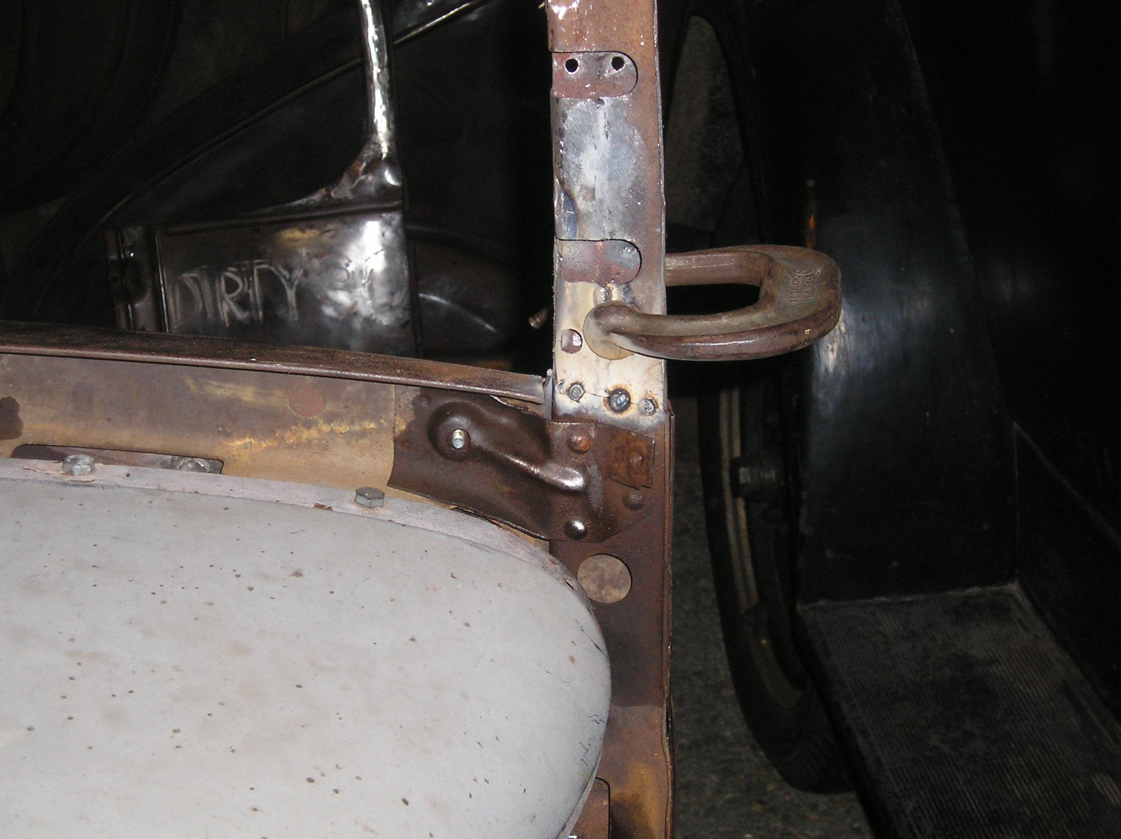

    Finally had time to work on the coupe a bit yesterday and thought I'd post a little update.
    I got the center brace welded up and then got the A-pillar tacked in. I used an angle gauge to match the top to bottom angle offset of the passenger side both front to back and side to side. The tank fits much better with the front quarters now and the windshield frame looked good from side to side, so I think I'm close. Once I get the fit right I'll hang the doors and see where I'm at with fit.
    The cowl repair seems to be taking forever. I feel like a 1930's collision repair man.

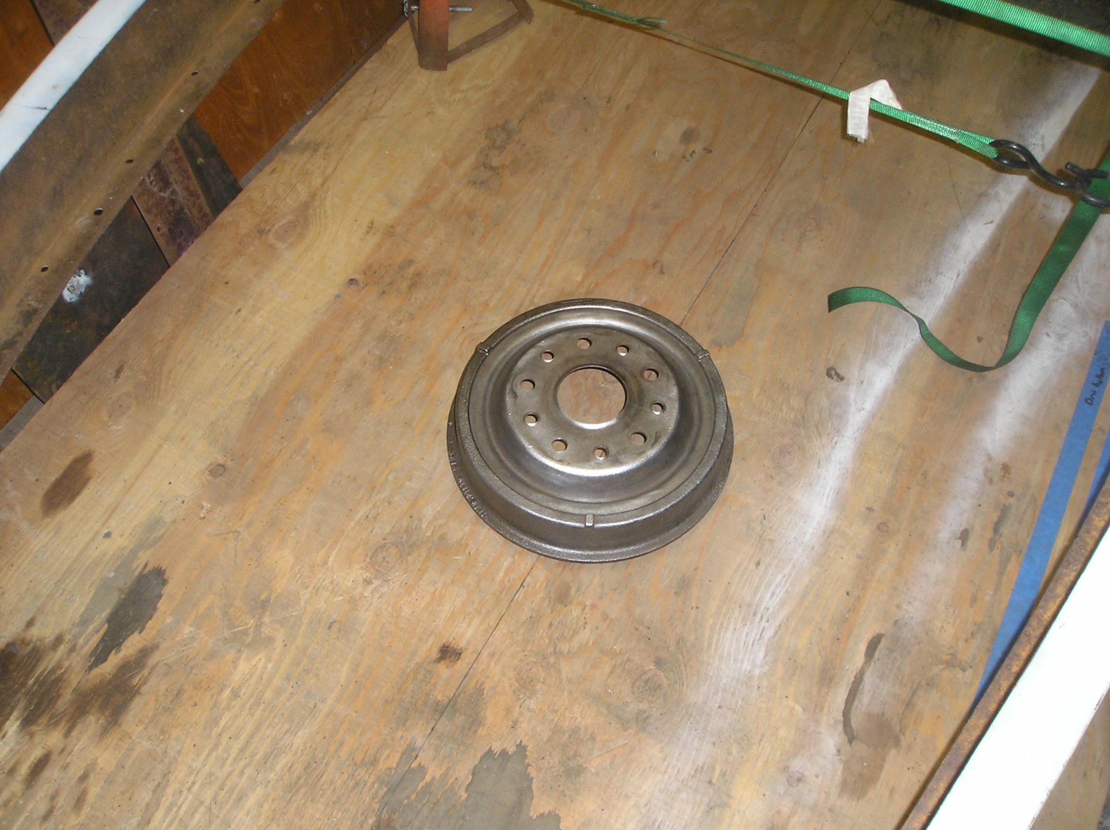

    I did score a complete F1 front end, steering box, and a set of shock mounts a couple weekends ago. Not bad for $50. Just a few blocks from my house, so I couldn't pass it up.
    I'm hoping to trade off the f1 axle and spindles for a good set of round backs.

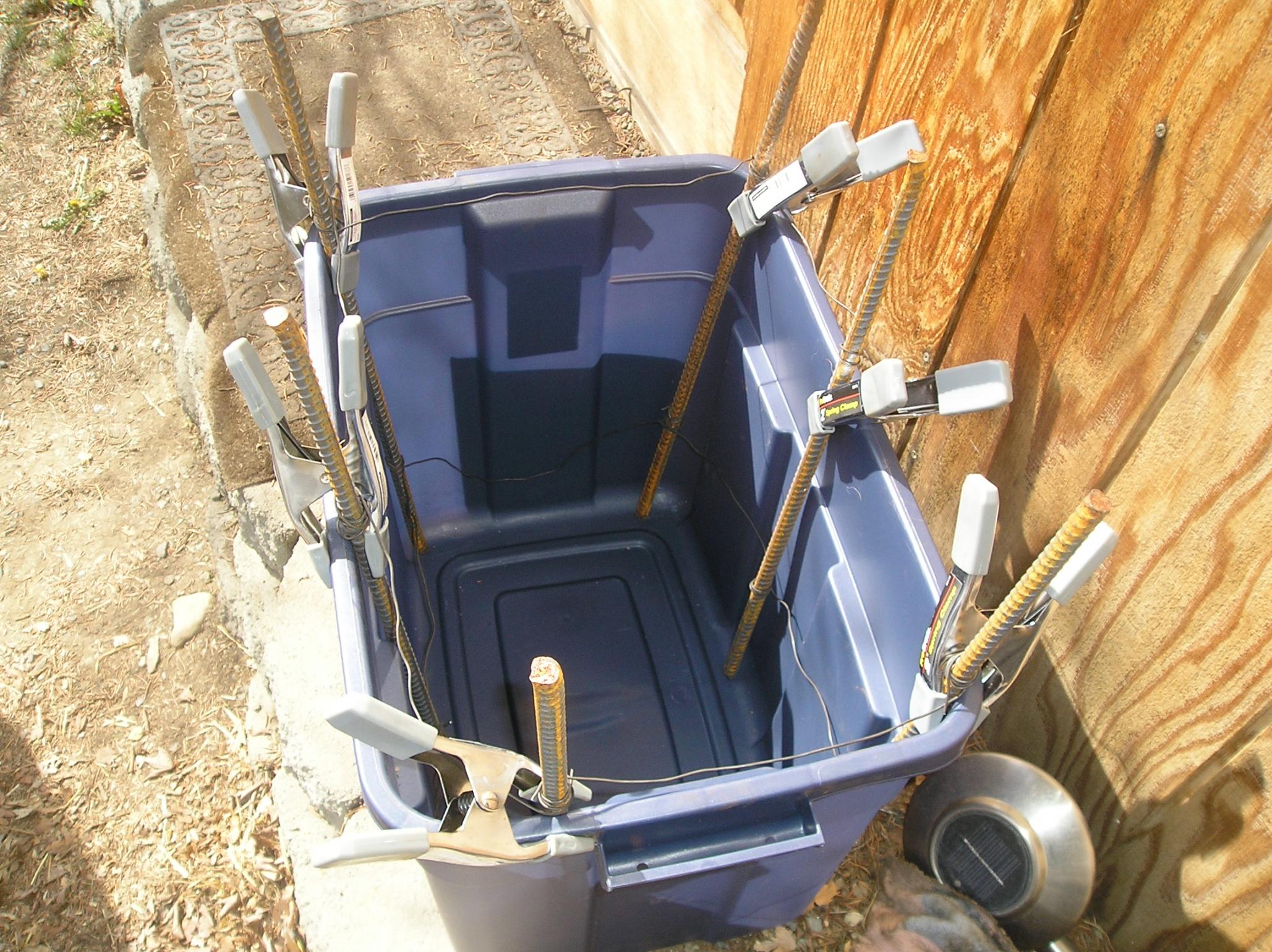

    I was reading the recent thread on electrolysis the other night so I thought I'd give it whirl on the hubs and backing plates. I don't want to oversell this technique, but damn! An overnight soak and a few minutes with a wire brush made a huge difference.

    Looks like you got serious with the ground rods??? Yea, I'm sold on using electrolysis for rust removal also...

    Battery charger, 6v or 12v, 2, 6, 12 amp? Thanks.

    12v 6 amp seems to work well. I also switched to larger clamps..seemed to work better with the increased surface area making contact. Cool stuff.
    Do a search, there's tons of additional information on the process in various threads.
