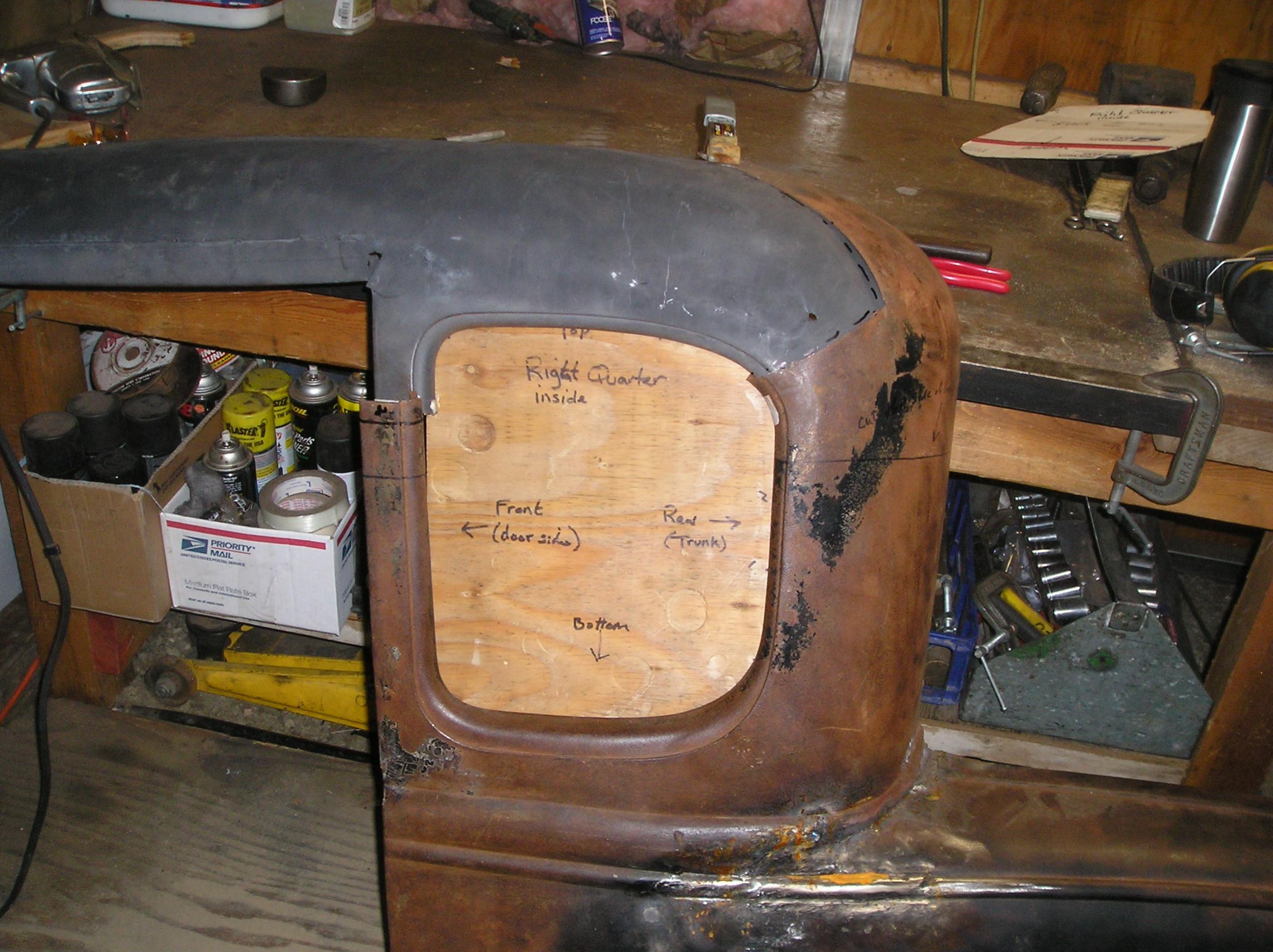

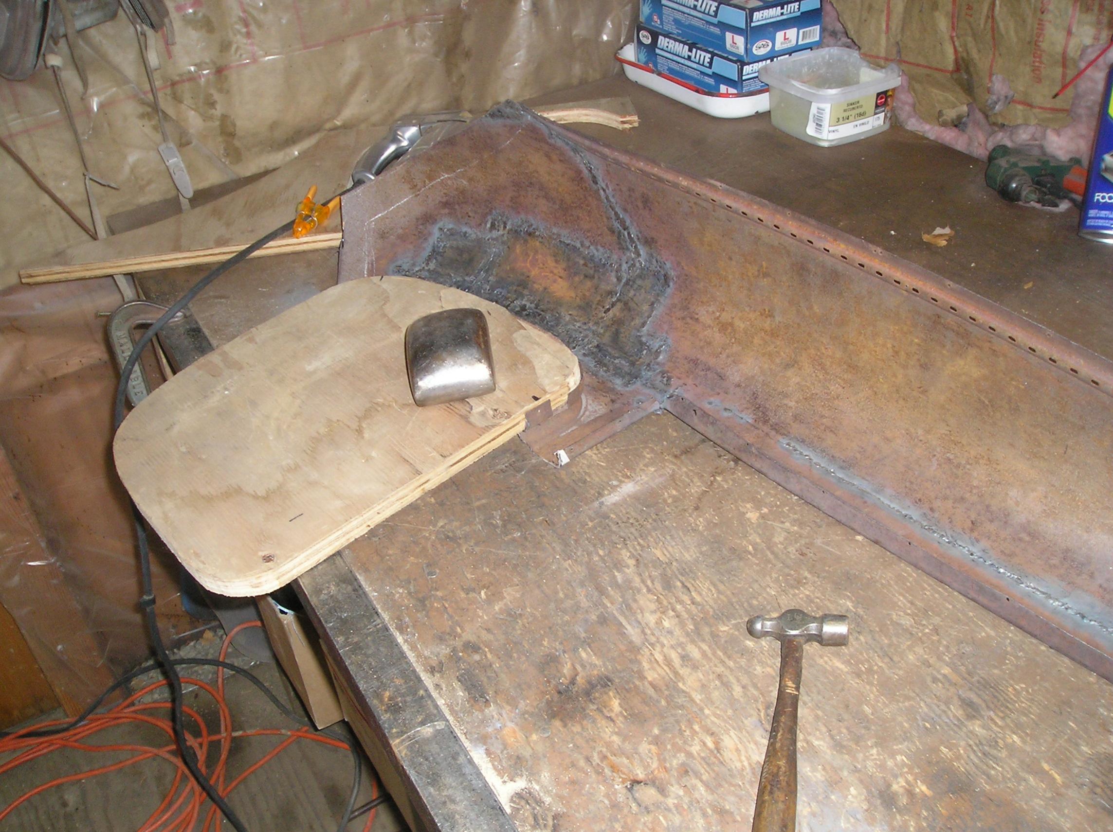

    A bit of an update.
    My shop build has set me back quite a bit, and move in day is still a ways off.
    Still, I've been working a bit as I have time. I'm planing to assemble the body over the winter.

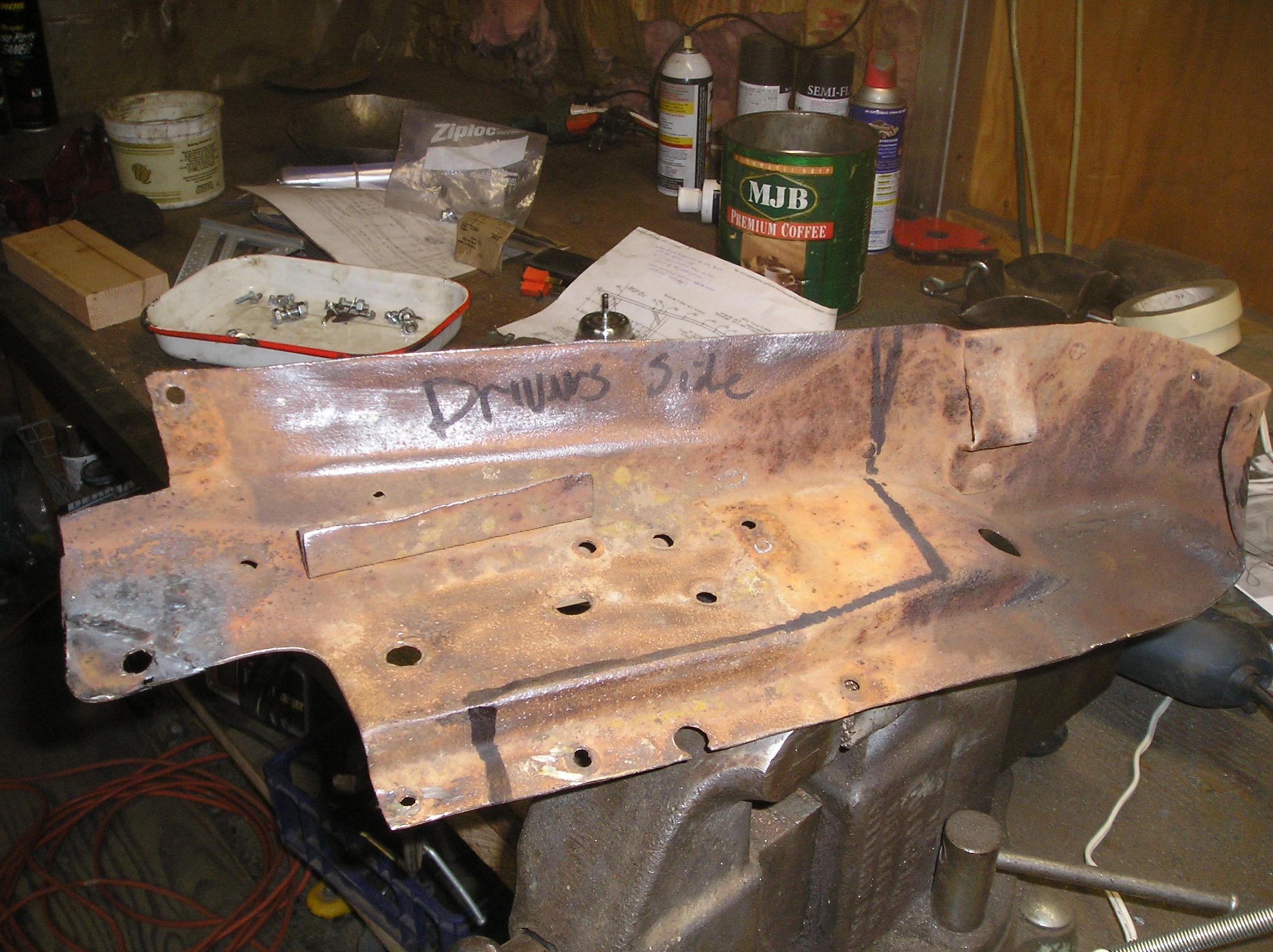

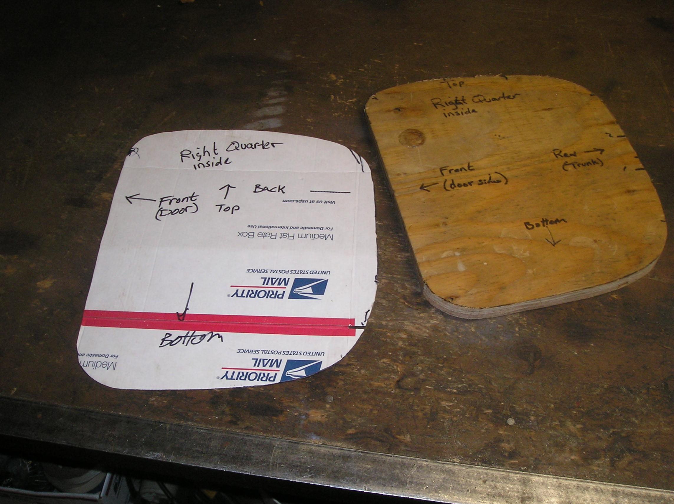

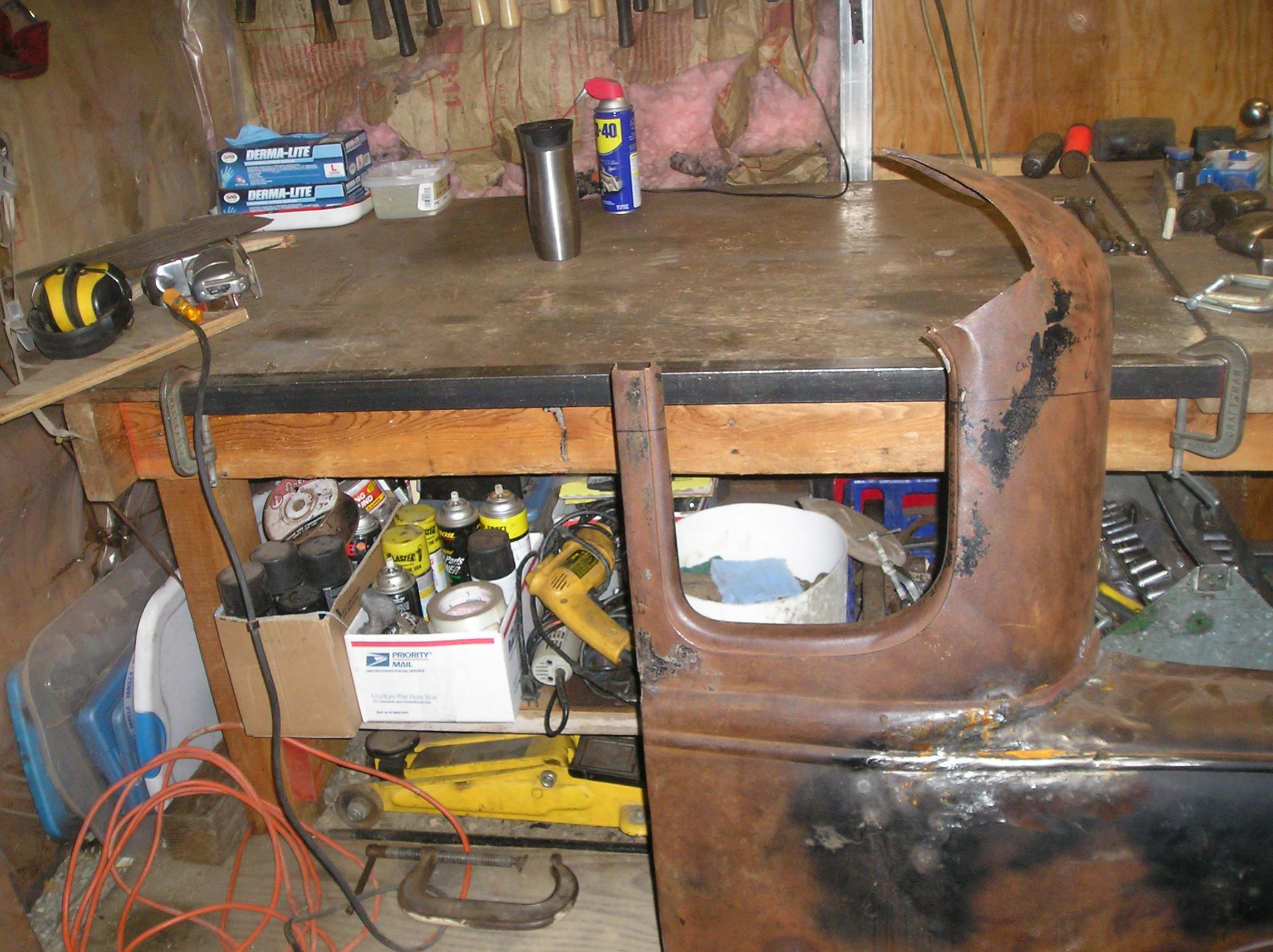

    I worked the worst of the thrashed metal and stick welds out of the drivers side top, and cut out little template to help line everything up. Its still very rough, but its coming together slowly.
    I'm going to level the subrails on the A-frame and hang the posts etc. with the wood kit, and then begin the patchwork.

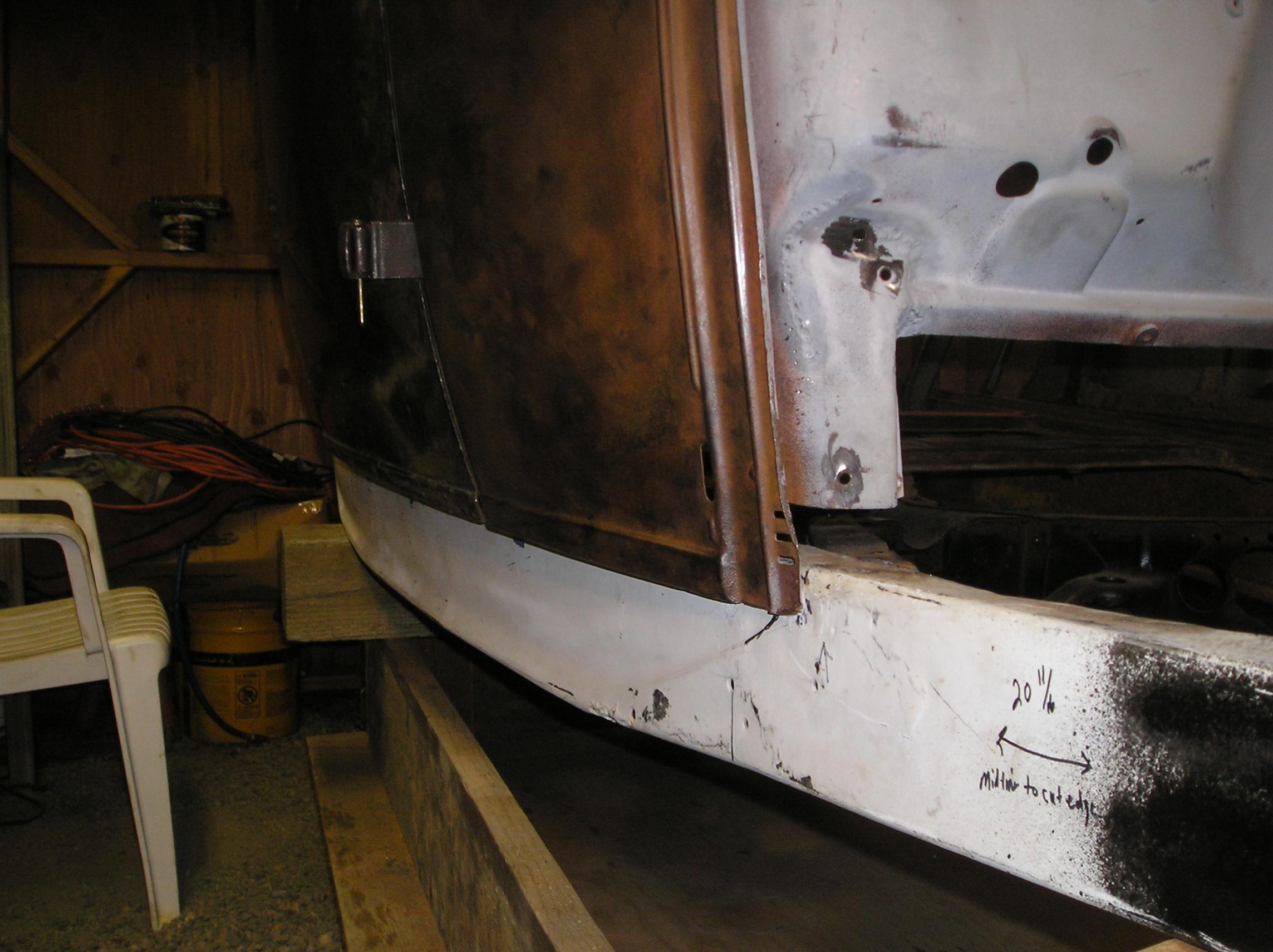

    I started working on the new real subrails yesterday and, while I was at it, decided to go ahead with a mini-channel for a better fit to the 32 frame. I'm going to cut down the front legs of the firewall, curve the lower edge etc. so that it retains a stock look. I'll use the existing rivet holes on the top edge.
    It fits and looks much better on the frame now, no gaps.

    Once I started to pull the body back, closer to where it should be I found (as I suspected from other threads) that I needed to spread the fire wall to make up a bit of the width difference.
    Crazy teenager with a camera
    Split firewall, now its roughly where it should be on the frame and the channel is just about 3/4 of an inch
    started modifying the firewall "feet". I'd like it to look as stock as possible when they're finished.
    these small mods so far really helped get rid of the gap between the subrails and the frame

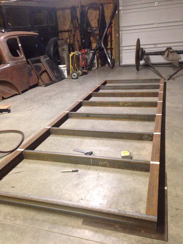

    Frame table in the works!

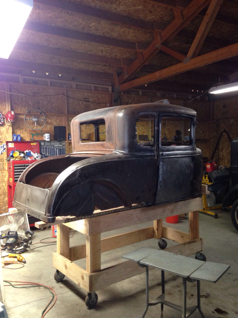

    Okay, so I think this might be the longest running build on the HAMB, and with no end in sight...in my defense, I did build a shop, and enter grad school.
    I have a few more years before my boy is driving, so here we are : )

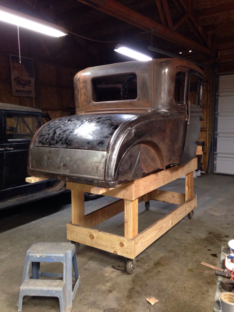

    Striping fixing and fitting the body panels this winter. The doors seem great so far, lots of work yet to do on the quarters .[​IMG]

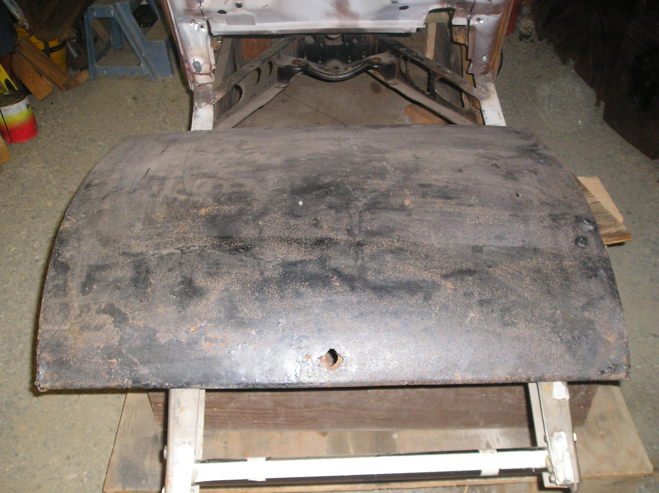

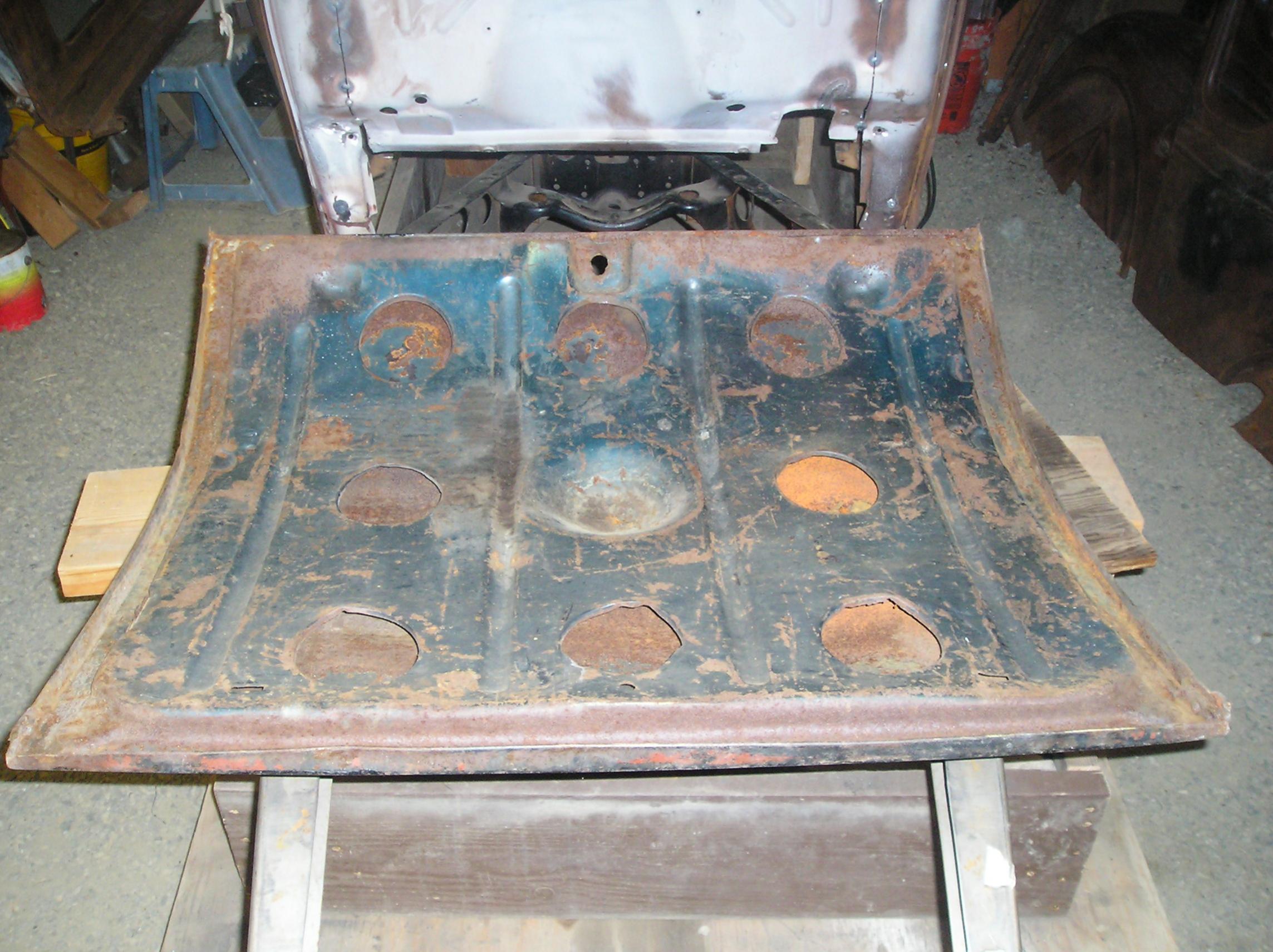

    1. Northwest HAMBers
    Finally some time to work on my project!
    I pulled the skin from the deck lid and worked out the largest of the dents. All four edges need to be replaced, so still a lot of work to do.
    I'm missing the passenger side trunk drip rail/channel in case anyone has a lead.
