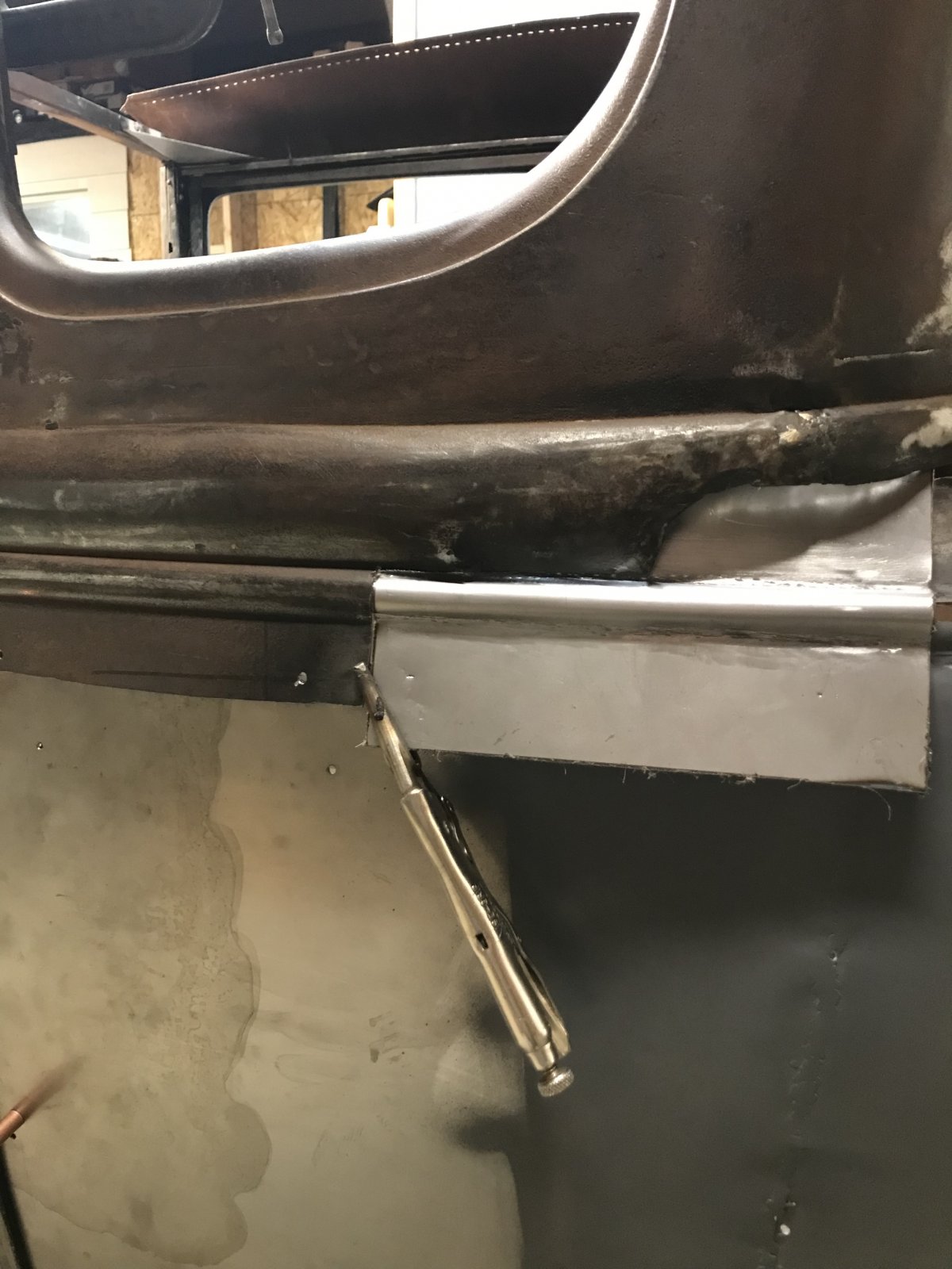

    A patch panel weekend. Many more needed. :)

    Four patches so far and still a long way to go! No complaints though, any day without blowing holes through ~90 year old 19g is a good day. [emoji4]

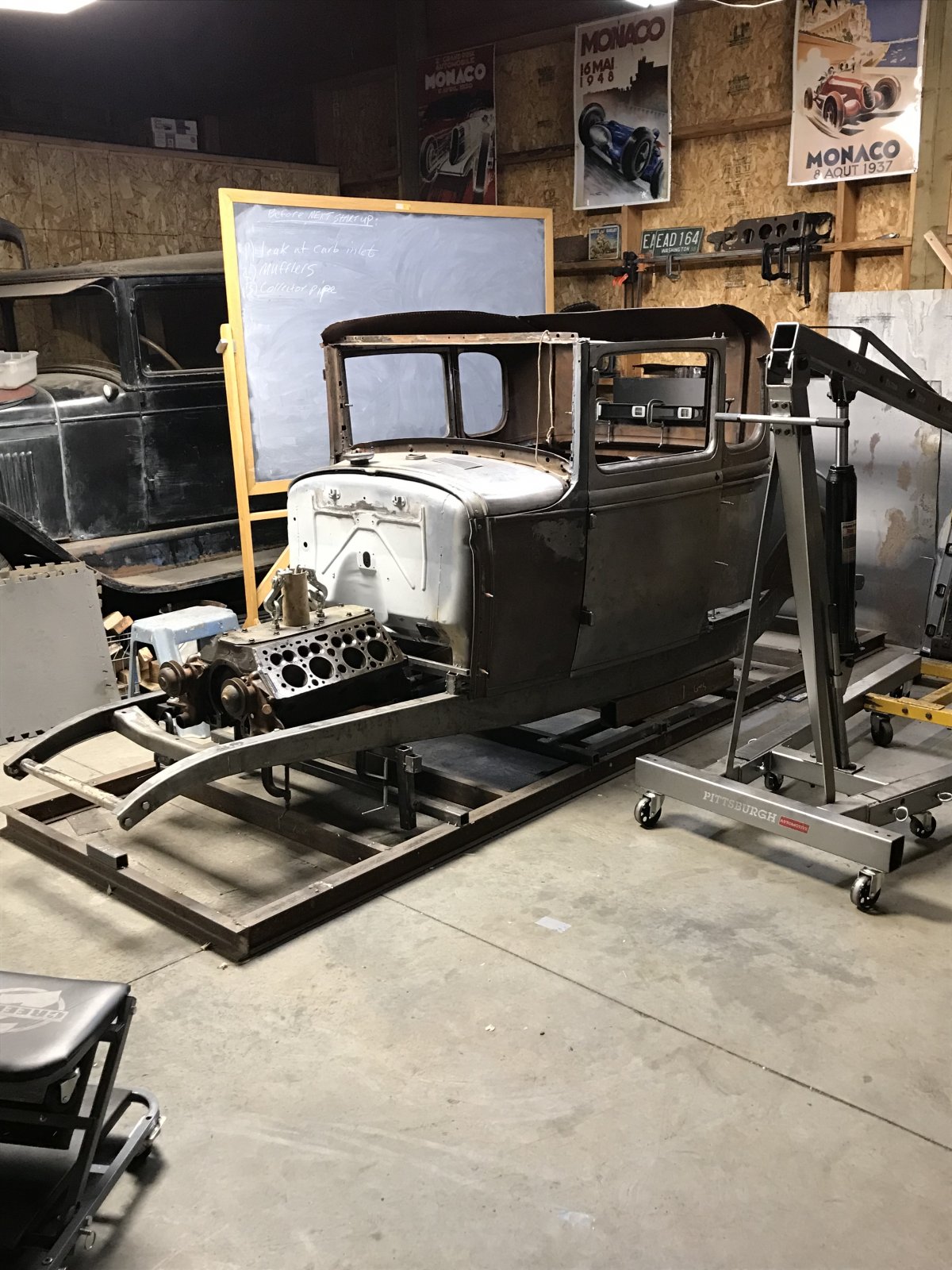

    I got the rear crossmember placed and tacked in for the moment. Then modified the jig a bit so that I can rough in the placement of the X member. I measured the block, bell-housing, and trans to the mounts. Giving 6“ from the front of the block to the center of the crossmember gives me 47“ from trans mount to center crossmember. Hopefully close anyway.

    Put the body on the frame to get an idea of where it will sit when aligned for the rear axle. I’m building feet for the firewall now, but won’t drill them until I know where the body will live exactly. I’m using a portion of the Model A subrails for the feet in that they have an exact contour to the outside edge of the firewall, and I think will retain a stock look after the slight channel. 1/4 in stock at the mounting point for strength. We’ll see how it looks.

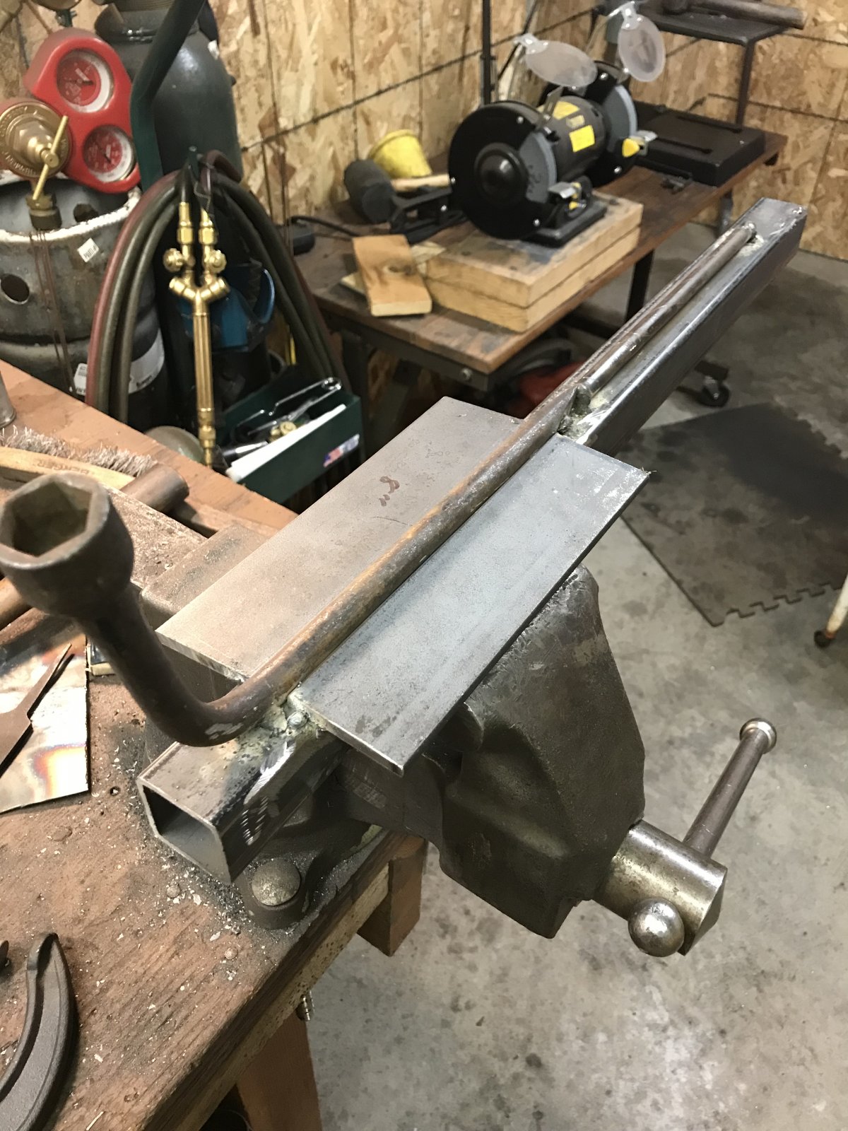

    I’ve been struggling for some time with the 3/4” belt line bead. I have a 22mm HF bead roller, wich works okay, but as far as I know no one makes a die set that big for the low end rollers. I don’t have a lathe or the skills to make a set. But I did have an old tire iron that is 3/4” round and some 1/4” flat bar. And so I made a quick hammer form. Turned out pretty good I think.
