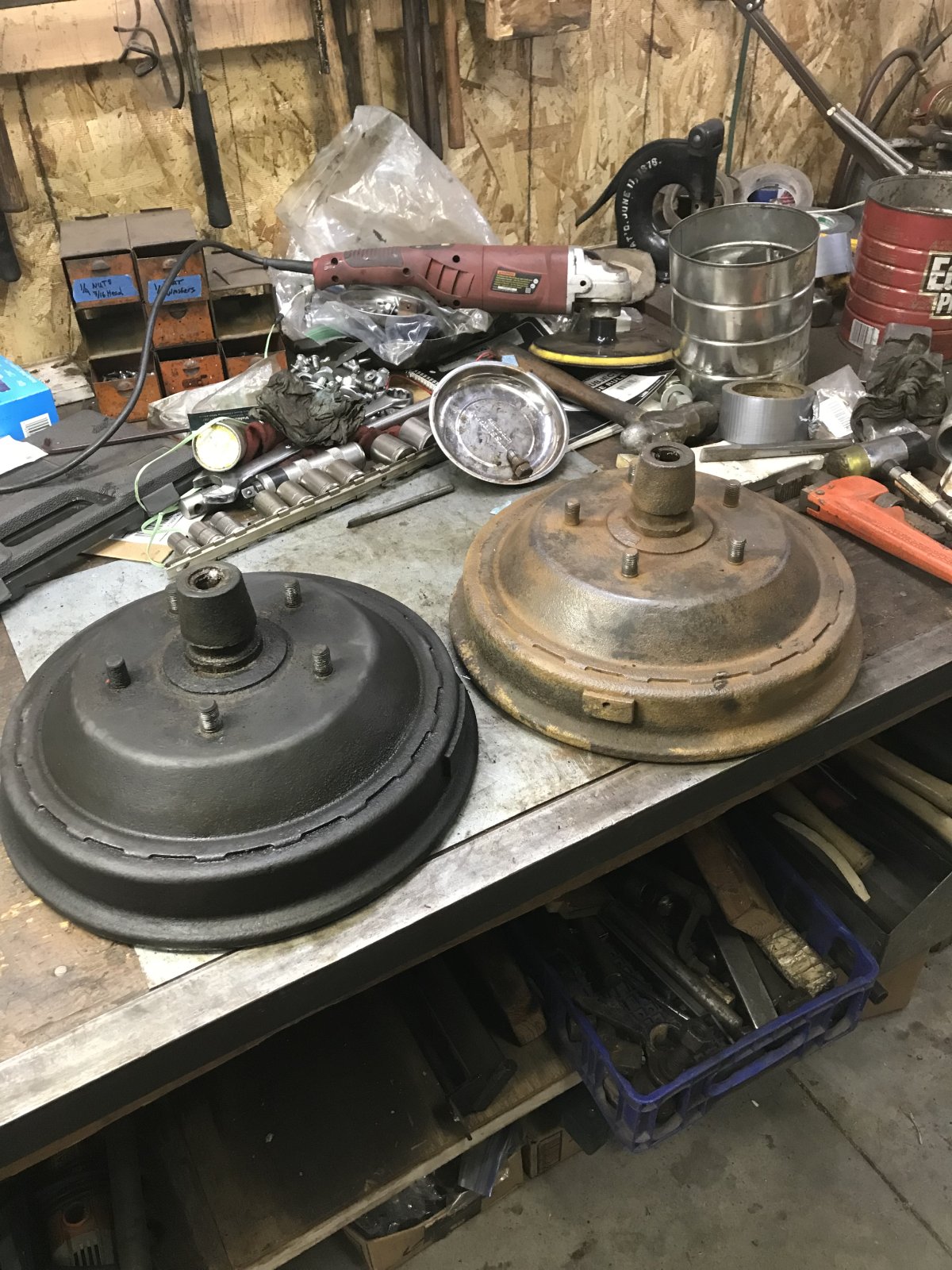

    Gotta love electrolysis.
    Here drums off the same rear, wire wheeled and Evaporate-rust soak on the right, 10hr 6 amp electo on the left:

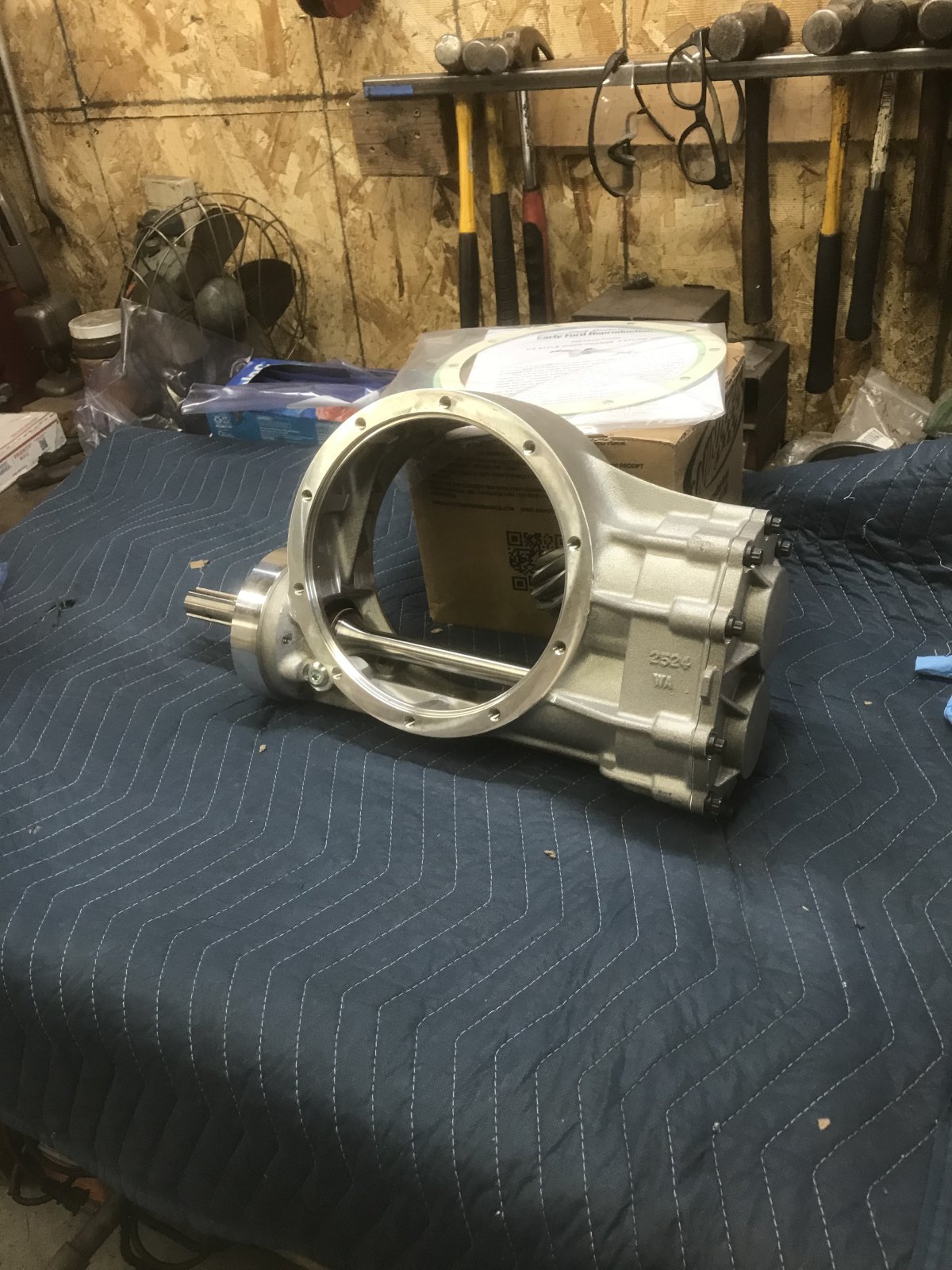

    Project for this Fall:
    69fury, brEad, Outback and 2 others like this.

    It’s my first QC, and so will be a learning experience. Winters SR3620 Center section that @krylon32 set me up with on my minimal budget. I have to decide what year bells I want to go with yet. I felt a QC was a must-have and I’m looking forward to learning about them as I piece this together.

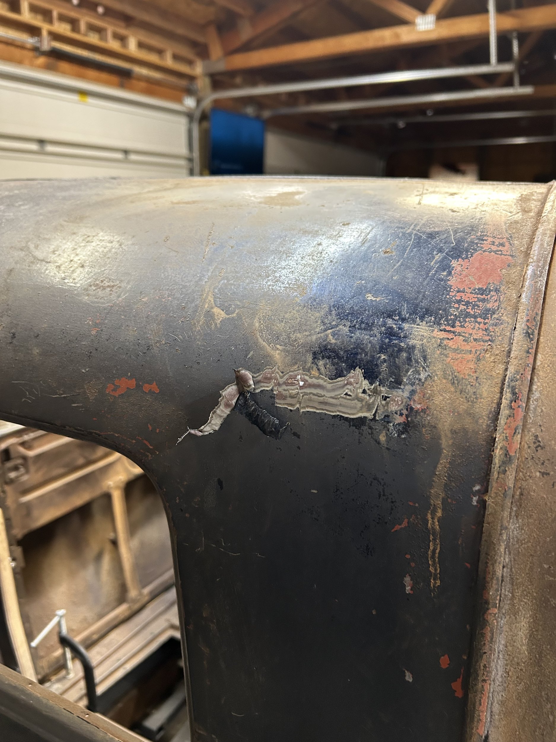

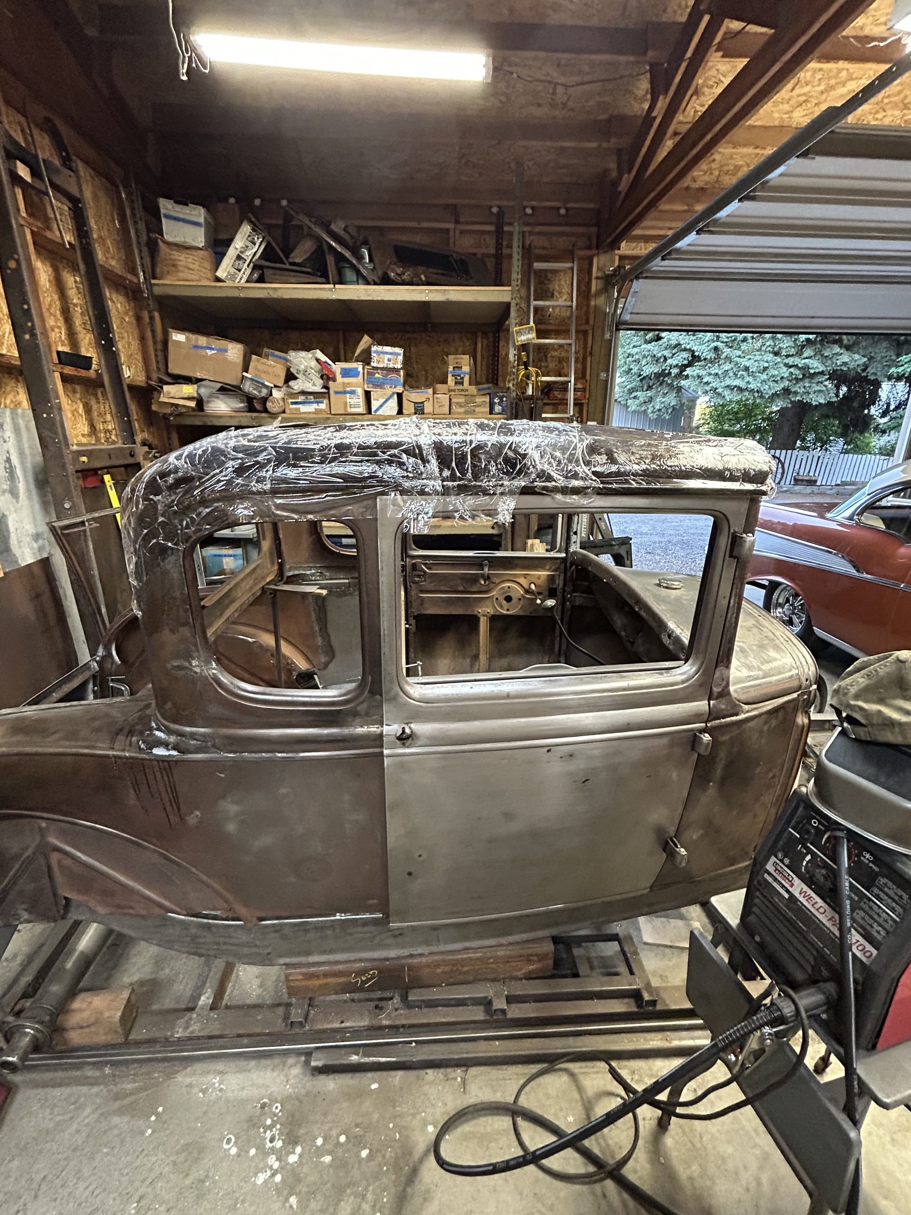

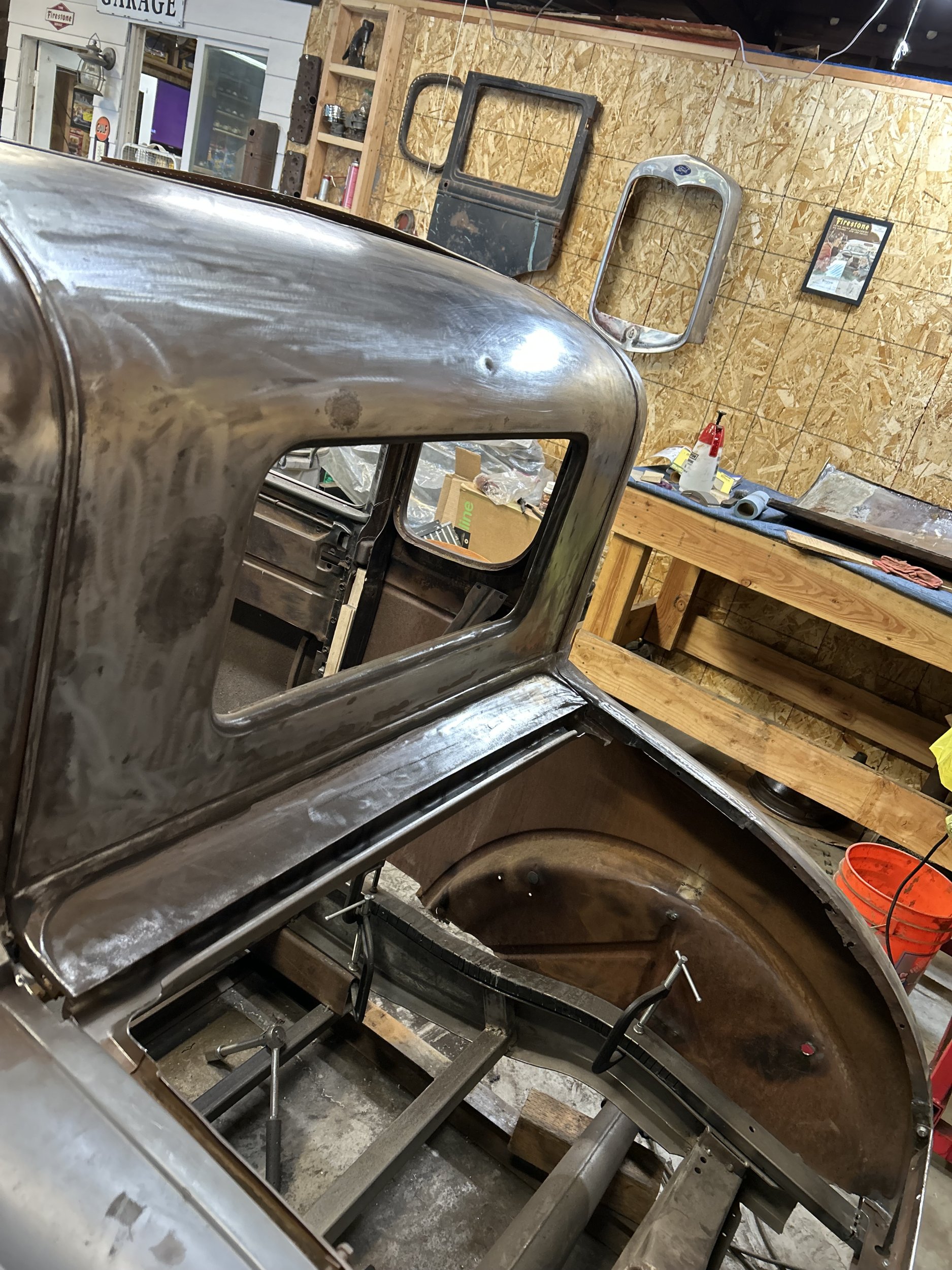

    The 57 has been taking all the time and money recently. Not to mention the new seat upholstery for the 53 and a Fenton split exhaust found at the swap meet. But, I now have 100 amp to the shop (pending inspection) and so hopefully very soon a real welder, good psi etc. so that I can turn my attention back to the coupe chassis. In the meantime a little surface rust removal. I need to strip the tulip panel too. So if anyone has suggestions on a stripper that works well and that won’t kill me let me know.

    Yup, the little stripper disks work well. One disk stripped the full panel. Found a couple of small dings and a little pitting, but it’s an honest panel overall.
