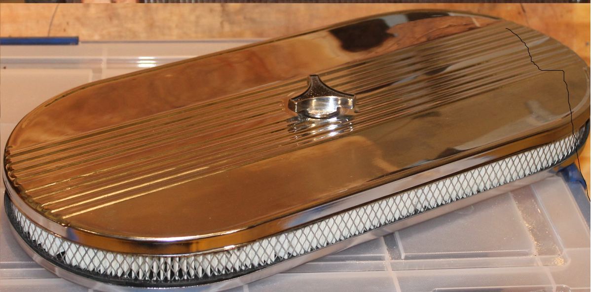

    Executive summary:
    I turned one of these:
    Into this air cleaner:
    The various intervening steps required a number of shop tools and equipment. Heat and sandpaper were also involved.
    Details of the various processes will be covered in individual chapters.

    Concept and design requirements.
    I realized that an air cleaner of some sort was required to complete the 455 Pontiac engine that is currently under construction in my shop. The engine has an Offenhauser dual quad intake manifold and a pair of Carter AFB carburetors.
    After reviewing the several available air cleaner ***emblies I determined that none of them were really acceptable to me. The problems ranged from ugly to didn't fit the theme to that will never work.
    So I bought this air cleaner so that I would have something to cover the carburetors until I found something that was more acceptable.
    eBay special ^^^^^^^^
    What I found was I hated the air cleaner so much that I decided to remove the parts that I didn't care for . This resulted in having an air filter element and nothing else.
    At this point I needed some direction and so made a list of what my goals were in relation to the air cleaner. (this would be decision making 101)
    Firstly I wanted a single air cleaner that matched the theme of the other accessories on the engine. I already had fined aluminum valve covers that I liked and most of the engine parts that could be removed were powder coated yellow.
    So a finned aluminum air cleaner with fins similar to the valve covers became the first non negotiable item.
    Other design elements were considered at this point; how the air cleaner fit (height above the carburetors, hood clearance, etc.) I also decided that if at all possible there would be no visible attaching hardware; that is no wing nuts on top.
    The air cleaner top also needed a “clean” appearance; no names or logos. Perhaps I am in the minority here but having someone else 's name cast into the top of my air cleaner seems a little gauche. Especially since my name isn't Holley, Edelbrock or even Cal Custom.
    Also, I am allergic to small, loose hardware inside an air cleaner. Something to do with “once burned, twice shy”. The eBay special has a number of small screws etc. just waiting to get ****ed into an expensive engine.
    So with my requirements firmly in hand I revisited my air cleaner search and again came up empty.
    At this point I decided that the Grinch was right......”if I can't find a reindeer I'll make one instead!” or in this case a traditional looking air cleaner.
    Next episode: making patterns or back to the woodshop.

    Making the patterns (Woodworking 101)
    Foundry work is something that I always wanted to try but had never attempted before. It was one of those things that only really skilled and experienced people could do, or so I was led to believe. Since there were none of those types of people around I figured that I would just go for it, what could go wrong?
    The first thing that I needed were casting patterns made of wood.
    I've never been too good with woodworking and so approached this step with some trepidation.
    My first thought was to carve the patterns on my CNC mill. I was saved from this nontraditional insanity by the timely failure of the Z axis servo motor driver. Thanks, Geckodrive!
    I made the top patterns out of naughty pine. This isn't the best choice of wood as I discovered. The board had a slight warp to it that I eventually sanded out (I don't have a planer, yet). The naughts also had holes and low places that needed to be filled. Don't you just love spell checkers?
    I cut the pattern fins using a table saw. I then sanded them so that they had some taper (draft). The inner corners were shaped with Bondo and considerable sandpaper. I was careful to make the pattern as accurate as possible knowing that any errors would be faithfully reproduced in the casting. Then when the inevitable revision occurred I was sure to have the maximum amount of work to redo.
    After rough cutting the oval outline with a circular saw the basic pattern was ground to shape on a 12” bench mounted disc sander. Once it was shaped I ran the router around it to make the curved outer edge. Right after that I found that Bondo is also good for fixing the place where I didn't want the router to go.
    It was during the pattern making phase that I made my first major mistake. Well... second if you count deciding that it was a good idea to make an air cleaner.
    I had read that aluminum castings shrink as the molten metal cools. This makes sense. The information that I found listed the shrinkage as anywhere between 1.5% and 2.5%. Since the locating rib in the air cleaner needed to fit the air filter element relatively closely I needed to account for that shrinkage.
    This is important since the air cleaner ended up being 22” long and that would result in a noticeable dimensional change due to the shrinkage, even at 1 1/2%. As a compromise I made the pattern 2% bigger than the finished dimension needed figuring that would be close enough. This turned out to be an error.
    I briefly toyed with the idea of casting a length of aluminum from a pattern with a known dimension and then calculating the shrinkage. I decided that wasn't necessary since I found the shrinkage percentage on the internet, what could go wrong?
    As cast the air cleaner overall shrinkage was very nearly zero resulting in an interference fit between the air cleaner and the filter element. This is a long way to say that I had to fix the mill and learn how to cut an arc in G code. I wasn't about to try to file off the excess.
    At this point I still was not sure what fin spacing and style would look the best and so made two top patterns figuring that if I had both tops I could swap them back and forth. As the project dragged on I abandoned that plan due to the amount of labor involved. As a result I am required to say that the top pattern that I used is the best one.
    The top pattern is a two piece affair with the filter locating rib part detachable to facilitate ramming the mold. Having it detachable also allowed me to use one rib pattern on both tops. The screws for attaching the rib pattern are intentionally asymmetrical so that the pattern is always installed in the same orientation.
    The bottom pattern was pretty straightforward and made out of 1/4” plywood. It wasn't until later (during the actual metal casting) that I discovered my second major mistake. That will be covered in the metal casting chapter.
    Feeling pretty frisky at this point I carved the pattern for the air cleaner hold down latch bracket in one go. If I make another bracket I will “tune up” the pattern a bit but all in all it went pretty well. I think that I also need a shorter name for the part.
    The latch bracket is installed between the carburetors and is held in place using the carburetor hold down bolts. It is needed to meet the “no visible top hardware” requirement. As a result of the bracket being installed on top of the carburetor mounting flange the hold down bolts need to be longer.
    The ***y dog bone shape is to make sure the bracket clears the idle mixture adjusting screws, etc.
    After getting the patterns sorted out I needed a cope and drag to put them in. I put angled brackets on the cope so that it would be somewhat self aligning with the drag. This turned out to be a good thing since the cope is pretty heavy when filled with packed sand. It is also fragile and so needs to be handled gently.
    While researching how to make this stuff I discovered the various names for foundry equipment. I hope that I am using the terms correctly.
    There are ribs around the inside edges of the cope and drag to help keep the sand in place when handling the mold.
    I made top and bottom boards out of 1/2” plywood. These boards are for convenience when turning the cope and drag over; since they also help keep the sand from falling out. They are also handy to keep the mold covered so that stuff don't fall in.
    When I cut the gate and vents I found that having a board on the back acting as a support helped keep the sand from “blowing out” and making big craters in the top of the mold.
    Also needed was a screen for the sand. I made the screen frame to fit onto the top of the plastic bin that I was using to store the sand. Then I got a different size bin, such is life.
    The screen is just a double layer of 1/4” hardware cloth. It seems to work OK as long as the sand has cooled off some after a pour. Not surprisingly the sand is pretty hot after dumping molten metal into the mold.
    So on to making the sand mold.
