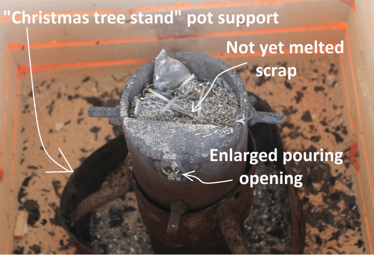

    Aluminum cupcakes
    Since I wasn't going to get far pouring without having a supply of aluminum I scouted out the junk pile and found a broken wheel from my truck. It was broken due to the railroad track incident (don't ask). I figured that if I melted it down I wouldn't have to explain how it got broken.
    I also thought that it would be good experience in using the melting and pouring equipment before the actual project.
    This is where I discovered that my melting pot was not big enough to contain the amount of aluminum required for the air cleaner.
    So off to the weld shop. I hadn't stick welded for at least a couple of years and so had to learn all over again. It really isn't like riding a bicycle, it's a lot hotter.
    A friend donated a 12” piece of schedule 80 4” steel pipe to the project, thanks Tom.
    Note that if you don't get good penetration on a melting pot bottom seal weld it can result in an aluminum puddle in the bottom of the kiln, just saying.
    The new pot holds about 12 pounds of aluminum, three times what the old one did. This is enough to cast any of the air cleaner pieces with some left over.
    Now all I needed to do was get the wheel into bite sized pieces that would fit into the pot.
    My plasma cutter was pretty good on the wheel hoop but the disc was too thick being nearly 2” near the lug stud holes.
    I ended up using my wood cutting miter saw with a carbide tipped blade. It cut really well; I have actually had wood that was harder to cut. The down side is that it is incredibly noisy (wear ear protection!) and throws hot chips everywhere (wear eye protection!) Fishing hot chips out of my shirt was kinda fun.
    At this point my wife donated an old cupcake pan so that I could cast ingots shaped like aluminum cup cakes.
    The kiln that I am using is an old pottery kiln that was given to us some time ago. I made a new control system for it and doubled the control range in anticipation of someday using it to melt aluminum. The controls appear to be reasonably accurate in that the aluminum begins to be soft at an indicated 1,350F and was fully molten by 1,500F. The kiln is about a 12” X 12” X 12” inside so the new pot just fits.
    Be advised that 1,500F is very hot! I opened the kiln once with out gloves or face shield and now need to regrow my back of the hand hair. The hot blast to the face was also educational. My son discovered that after the kiln had been turned off for a day it was just the right temperature for hand warming.
    After several “dry runs” (cold runs?) I was ready to make cupcakes!
    The first thing that I noted was that molten aluminum is very runny. The next thing I noted was smoldering plywood stinks. Naturally the wind direction ensured the smoke blew into the garage and stank it up. This was so much fun that I repeated the burning process several times during the project.
    The cup cakes don't require anything to help them come out of the pan. As long as there isn't too much spillage on top they will fall out of the pan after they cool a bit. Be advised that just because they are cool enough to come out of the pan they are still plenty hot.
    I was able to make a dozen cupcakes in the first batch and found that they weigh pretty close to half a pound each. Knowing the weight meant that I was able to make a somewhat informed decision about how much aluminum was in the pot.
    After the first batch I enlarged and modified the pot pouring spout. I found that the long spout was not needed to control the pour. It also reduced the speed that the molten aluminum could come out of the pot resulting in the spout clogging.
    One broken truck wheel makes about three dozen cupcakes.

  20. nrgwizard
    Joined: Aug 18, 2006
    Posts: 3,155
    nrgwizard
    from Minn. uSA
    Nice start on the safety equip.
    Didn't see leggings. For those who don't know, pants go on the *outside* of the boots, leggings go on top of those. Since I don't post pics yet, leggings should be made out of leather if you can't find the good stuff, which, IIRC, was a metal tapered tube that snapped around the leg(spring-loaded, so you didn't have to tie them on) & went from the boot top to just above the knee. They only went on one way, as they snapped around the back of the leg, the knee portion was higher in front than in back, & they also had a flap that covered ~ 1/2 of the front n top of the boot while also d****** over the side to ~ the ground level. These are very important, to the point that I'd make my own, or not pour. You ain't gonna get the boot/shoe off fast enough to stop damage from 1400* molten metal if it spills/pours/splashes into the boot/shoe/flipflop/etc. If you think welding spatter hurts... Oh, & pour over sand. IIRC, the school had a metal grate that was placed over sand, 'cause the floors were concrete. Everything was very stable. Spills didn't happen very often, but when I saw them, the molten Al just quickly froze over the steel grates n sand, didn't spatter like wicked frying eggs, & was easy to clean up since the Al didn't stick to any of it. When pouring :
    Safety (yours) First!
    Instead of a hole in the side of the pot, you could also cut a V in the flat top cover you have. Or make a lip w/a point (like a pouring "spout" on a pyrex pot or any measuring cup. Doesn't need to be long or big, just distort the round edge to a slight point w/sorta-flat sides going from the point to the round edge, to encourage controlled flow. Just use a torch to heat some of the edge & use a needle-nose pliers to bend/form the pour spout.). The fully open top of the crucible will make s****ing the dross/gunk off that's floating on top of the melt. I don't remember what we used as a de-gunker to purify the Al, but, iirc, when we were out of the commercial stuff, we used a small handful of borax stirred into the melt. When I did lead bullet castings, I found a pinky-tip-sized squeeze of patch lube worked well. They all seem to smoke. Nothing that you want to breath in. Ventilation is your friend here. :D .
    Cupcake tins work well, as you found out. We made ingot "pans" from angle iron welded together maybe ~ 6" long. Looked like VVVVV, w/the ends capped. Don't remember the weight, but they were uniform size. They stacked well for future melts. Small engine cases cut up work well, too. For some reason, pop cans didn't work well at all, at least for me.
    HTH.
    Marcus...

  21. '51 Norm
    Joined: Dec 6, 2010
    Posts: 881
    '51 Norm
    from colorado
    When I built my shop it was intentionally placed over 100 feet from the residence so that I am only likely to burn down one at a time. I am pouring over sand just outside of the shop door. I used an old sheet of plywood so that I would have a level and steady place to put the molds. The plywood had been used as a concrete form and had a bunch of release agent soaked in it. As a result it smoked a lot and naturally the wind blew the smoke through the open door into the shop.
    I now have an exhaust fan for the shop.
    I have the leggings but for some reason they didn't make it into the picture.
    After hearing various horror stories about spilling molten metal I am willing to do what ever is necessary to prevent burning off something that won't grow back!

    I actually had to cast several before getting a usable one. Its a good thing that aluminum can be re melted or I would have run out of wheels.
    As for healing up; I'm just sore from all of the pounding.
