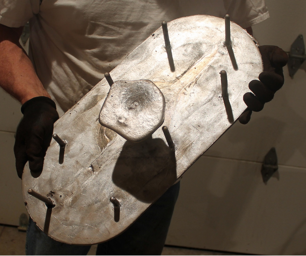

    Molten metal
    I was finally ready to make the attempt.
    Using what I had learned from making the cup cakes I put on all of the safety gear and did several “dry runs” to reduce the chance of spilling molten metal on something that would take a long time to heal.
    After melting the aluminum I s****ed off the floating junk and was ready to pour.
    I had some difficulty with the pot on the first pour and that resulted in a couple of modifications before the second pour. The spout was removed and the pouring hole enlarged. Then I was able to fill the mold gate and funnel and things looked pretty good.
    I had several interested tourists watching since it was the big day. No one wanted to wait around to see how it came out and so we all went to lunch. This turned out to be a good thing as it prevented the onlookers from seeing the first failure. Having extra people around made it so there are pictures of the process. I'm not coordinated enough to pour aluminum and take pictures at the same time.
    While I was digging out the sand and getting it ready for the next attempt my wife noticed that I was using her garden trowel. I carefully explained that garden trowels look a lot alike and this was unlikely to be her trowel. Then she pointed out that it said “Becky” on the handle. To which I explained that I name all of my good tools.
    I now have a trowel with no name on it.
    After carefully examining the failed casting it looked like the mold collapsed near the gate. This prevented the molten aluminum from getting to the center of the casting.
    So on the next attempt I put a couple of pieces of all thread across the cope near the gate to support the sand. I also made sure that the sand was well packed.
    I cut up the first attempt so that I would have enough aluminum for the project. I really didn't want to find another rail road track to hit. That and the first casting was ugly enough that I didn't want it around.
    On the second attempt I had fewer onlookers. Apparently they figured out that I wasn't going to set myself on fire so why bother?
    The second attempt was an improvement but still not usable. Ditto for the third and the fourth.
    After some additional forensic ****ysis of the failures I determined that the thin casting (1/4”) and large area (10” X 22”) was causing the metal to freeze before reaching the ends. The thin casting was the second major mistake.
    I used several methods to overcome this. I modified the pattern with a rib down the center from end to end so that the hot metal would have an easier time reaching the ends. Then I increased the pouring temperature from 1,500F to near 1,600F and before trying to pour I used a MAPP gas torch to preheat the mold by shooting the flame down the hole for a couple of minutes.
    The fifth try resulted in a usable casting. Notice I didn't say a good casting, it still had some flaws but I'm pretty sure that I can hide them.
    I was really happy to finally get a casting since it was taking me about eight hours to make a mold, pour, etc.
    This is where I decided that one air cleaner was enough.
    Since I had a usable bottom plate I moved onto the top plate. That went a lot better since I knew at least some of the pitfalls and I was getting pretty good with pounding sand.
    The only real issue that I had with the top casting was that the gate clogged at the end of the pour and so there wasn't enough molten metal available to prevent a shrinkage crater in the middle of the top. I was able to sand down the top to remove the low spot but it required a bunch of labor and sandpaper.
    The latch bracket was a lot easier. Since it was smaller there wasn't so much sand pounding. The mold was also light enough that a normal person could move it.
    At this point I began to wonder why all of my raw castings look like the star ship Enterprise.
    Please note that I didn't make all of the possible mistakes; just a fair representation of them.

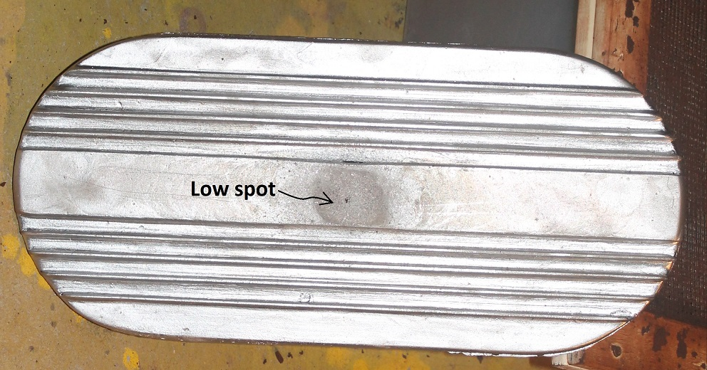

    After completing the lower plate it was time to attack the upper plate.
    In the center of the upper plate there was a low spot caused by shrinkage. I believe that it was due to the gate clogging up at the end of the pour and so there wasn't enough metal to compensate for the shrinkage. Regardless of the cause it needed to go away.
    Using what I learned on the bottom plate I got out the belt sander and promptly made some discoveries. The sanding belts that I used came from the place everyone seems to love to hate, Harbor Freight Tools. The store that I frequent had two styles of sanding belts in 80 grit, expensive blue ones and cheap red ones. The blue ones work pretty well; the red ones like to shred right away. After the red ones shred some of the remains can be cut to fit a hand sanding block where they work really well.
    Shredding the sanding belts wasn't a problem on the bottom plate since I did all of the sanding before cutting the holes. With nothing for the belts to catch on they didn't shred.
    On the top there are all of those fancy looking fins for the belt to snag on.
    Regardless, I was able to sand the top o' the top down even and make the low spot go away.
    Naturally I also had to redo the filter locating rib like on the bottom plate. This went better since I had already learned the difference between G2 and G3.

    You are "spot" on. I didn't expect the low place and so had to sand the entire area, a smaller raised piece would be much easier to deal with. The nice thing is that after sanding it down the top was ready for polishing!
    As you pointed out the shrinkage in thickness seems to be more that the length/width. I don't know why that should be so but that is what happened.

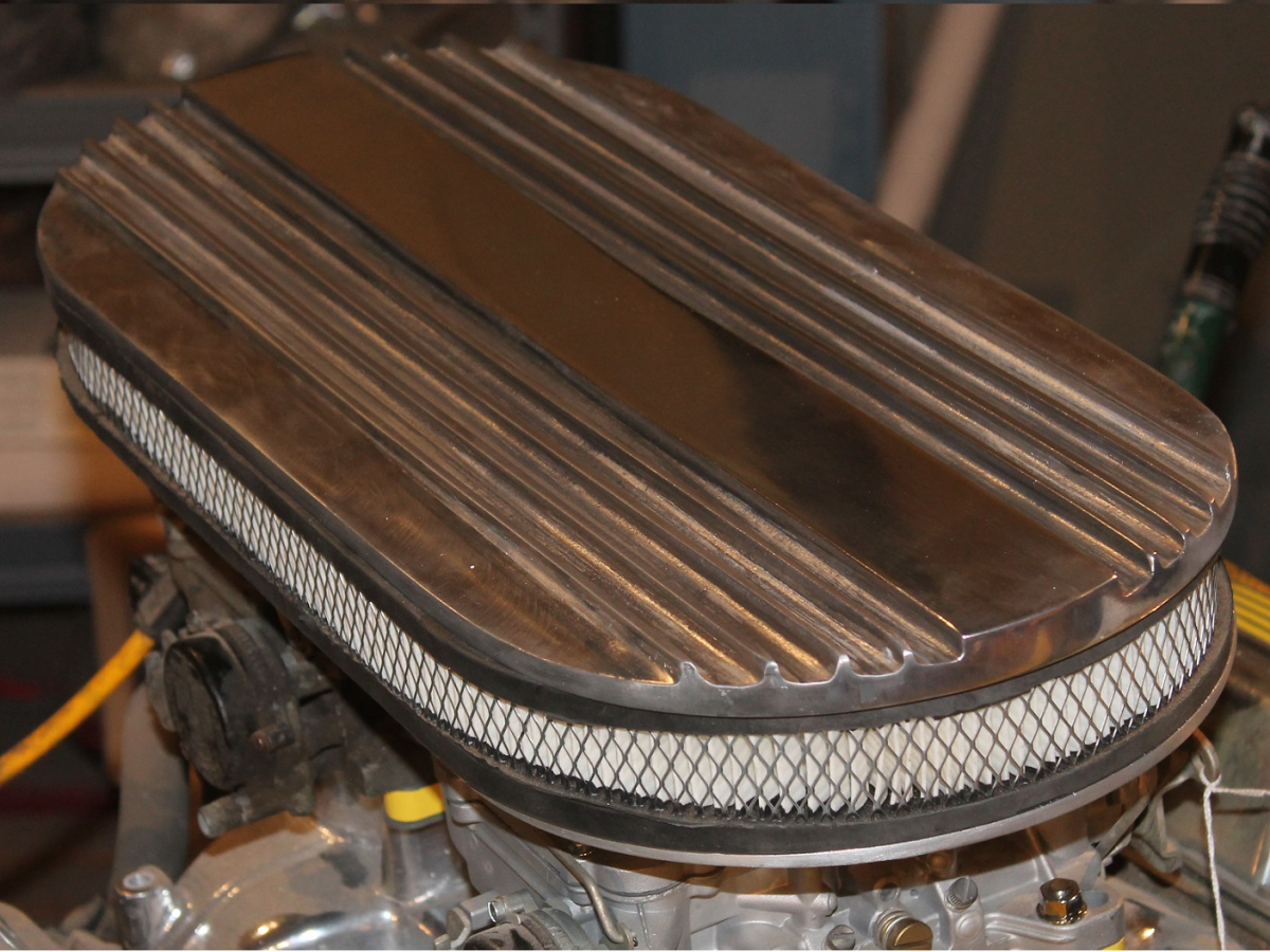

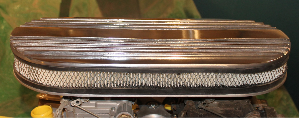

    Finish work
    At this point most everything fit together and the ***embled parts resembled an air cleaner. I wanted to make sure everything was right before the paint/polish/powder coat since I really didn't want to do that over.
    I used the inner carburetor hold down bolts to install the bottom latch bracket. Naturally I needed longer hold down bolts since they were now doing double duty. Then I was surprised by the fact the carburetor hold down bolt spacing was not equal side to side.
    I am using TransDapt carburetor adapters since when I started the project I didn't have any original Offenhauser adapters. I was told that the Offenhauser adaptors are no longer in production and that TransDapt had taken over manufacturing of the adapters.
    After having the TransDapt adapters powder coated I accidentally came across a set of original Offenhauser adapters (I bought another manifold and they were installed on it). Long story short; the original adapters are way better than the later ones. I would use the original Offenhauser adapters but I am too far down the rabbit hole at this point.
    I sanded the parts that were going to be polished until I got through the 1000 grit paper and then buffed them. I thought that they looked pretty good. I need to say that they are good to justify the effort in them.
    Sanding and polishing can be a bit tedious but at least it is quiet enough to hear the rock and roll radio. I also enjoyed seeing the parts coming out of the mist and looking something like what I imagined when starting the project.
    The parts that were to be powder coated I sanded with 220 grit. The areas between the ribs that were to be painted I cleaned with a file and 80 grit.
    When I took the bottom plate and latch bracket to the powder coater I was informed that they could powder coat over JB weld. Meaning that I could have filled all of the remaining casting flaws in the bottom plate. I may try that next time, I was just wanting to be done at this point. If I leave the air cleaner installed the bottom is hidden anyway.
    I was very happy with the result. Yes, the bottom plate isn't perfect but it is a lot better than I expected it to be. The reason for powder coating the bottom plate is to provide an accent line around the edge and I believe that I have succeeded with that.
    Powder coating the latch bracket also provides contrast with the silver parts. To me there is such a thing as too much shiny. Of course my tolerance for shiny is a lot higher than most.
    I painted inside the ribs with Rustoleum using a small brush. It took several coats to fill the streaks left from the brush strokes. I'm hoping that the paint lasts and that it doesn't need to be redone in the future. This is the same procedure that I used with the valve covers.
    When planning the air cleaner top I used the valve covers as an example for the fin spacing and height since I wanted a coordinated look to the engine. You know, don't wear tennis shoes with a tux.
    Next up is to put it all together and make the hidden hold down latch work.

    One of the goals that I made was to have no visible hardware on the top of the air cleaner. This resulted in making a hidden latch ***embly.
    My first thought was to use an air hose coupler with one end attached to the air cleaner and the other part anchored between the carburetors.
    Then I found these little gems:
    They cost a lot more than the air hose coupler but are prettier.
    Naturally the bottom of the latch ***embly needed a place to anchor to.
    The latch anchor is installed between the carburetors and attaches with the carburetor mounting bolts. I had to make longer carburetor mounting bolts to accommodate the latch anchor. When I made the latch anchor I was careful to make sure it cleared the idle adjusting screws and vacuum ports. This resulted in the ***y dog bone shape.
    I also had to make an extension between the upper plate and the latch pin.
    After getting it all together I decided to install a helper spring so that when the latch is released the air cleaner ***embly lifts up. I am hoping that this will make removing the air cleaner a one handed operation.
    The helper spring came from a storm door over travel chain. It is the correct diameter and only needed a little t******* to be the correct length. So far it seems to be close in the tension department. It was also cheap and available. The low cost helped to make up for what I paid for the push ****on catch.
    The release ****on is on the bottom of the latch anchor bracket. So far it is easily accessible, I'm hoping that it remains so after the rest of the carburetor parts are installed.
    The entire air cleaner ***embly comes off as a unit. Removing the hitch pin allows the air cleaner and latch ***embly to be dismantled.
    It was a lot of work to make the hidden latch for the air cleaner and so I am required to say that it is an unqualified success.
    All that is left to do is the final ***embly and adjustment.

    Wanting the air cleaner to be reasonably easy to remove and install I glued the carburetor adapters in place with clear RTV. That way I didn't have to juggle several parts while installing the air cleaner. The RTV also provides a seal between the adapters and the bottom plate.
    This was the same reasoning that I used with the clip on the latch spring. The whole air cleaner comes off in one piece. If any work needs to be done on the air cleaner (like cleaning or replacing the filter) it can be dismantled on the bench without tools.
    I needed to trim a little off of the inside of the adapters to get them to install onto the carburetors without binding.
    The pin on the bottom of latch ***embly is adjustable for length. It took a little fussing to get it where it would easily “click” into the latch bracket without a lot of play in the air cleaner. After I was satisfied with the fit the lock nuts were tightened.
    To adjust the spring tension all I had to do was turn the spring on the hitch pin so that there was more or less spring pressing on the latch bracket.
    The amount of spring pressure still isn't as good as I would like; it requires a pretty good push on the ****on to release the air cleaner. There is a larger catch available and that might be better but at this point I'm not going to change it.
    There is a felt gasket under the washer that is not shown because it wasn't made when the pictures were taken.
    I figure that this is about the point where I will find some vital part that needs to occupy the same space as the latch.
    Now that I have an air cleaner I guess that I need to finish building the engine that it goes on.
